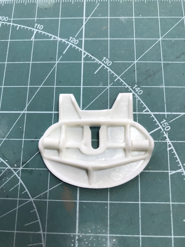

I just hate seeing US truck with European style fifth wheels on them. I wasn't sure how I was going to mount it a first as it didn't fit the Italeri mount posts at all. So i came up with a plan that involved a lot of sanding and filing.I filed the two posts down that the kit fifth wheel sits on using a round file to get the shape of 1/8" evergreen tubing.
 Then I filed and shaped the inside of the fifth wheel to fit the evergreen tubing and made sure the outside lip would fit over the original location for the kit posts. The plastic on the AMT fifth wheel is quite thick on the mounting area so a lot of sanding was required, checking fit as I went along. Don't think I didn't consider making all the underneath parts of the fifth wheel too. But I came to my senses and made just some rudimentary things to make it look better.

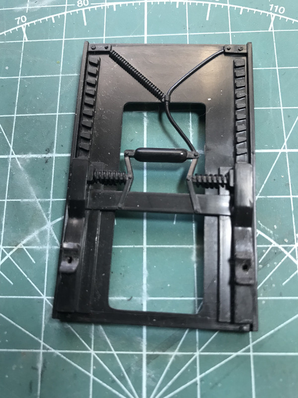

Test fit the fifth wheel on the plate. This photo shows that the molded on airline and spring have been removed from the slider plate. I thought about just making a whole new fifth wheel plate but I didn't want to make all the dog that that the locks fit into, that and i didn't have another Italeri one to cut up to avoid that. I have also replaced the unlocking air cylinder with a evergreen styrene one as I didn't like the shape. Although it was sort of correct so is this one.

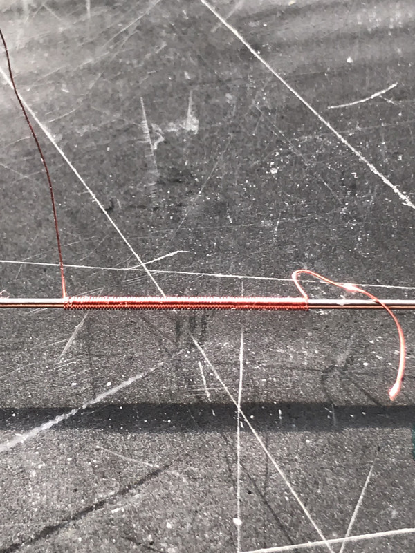

To make the spring to hold tension on the air line I wrapped #38 gauge magnet wire tightly around a .20 metal rod. Made it longer than I thought I needed then I would cut off the length I didn't need.

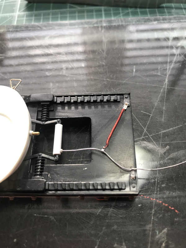

Then I added the air line and the brackets to hold both the spring and the line to the fifth wheel. The brackets are made from lead foil cut and shaped around .15 metal rod then added to the plate.
Here is another view showing the added detail on the side of the fifth wheel plate. I had to add evergreen to the side and sand smooth, as the kit didn't give enough width to add the bolts to hold the fifth wheel plate to the frame.
Here is the spring I made installed to hold the air line. I think I need to shorten the spring up some so it looks like it under more tension. I may call it good enough.(HaHa)
