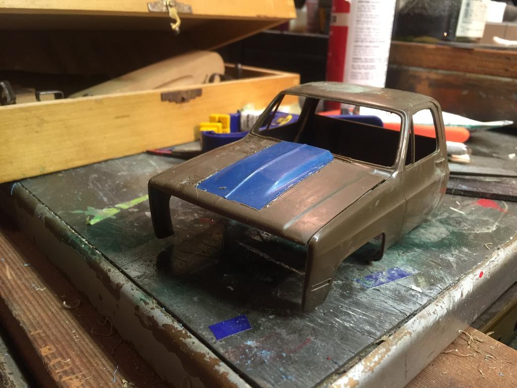

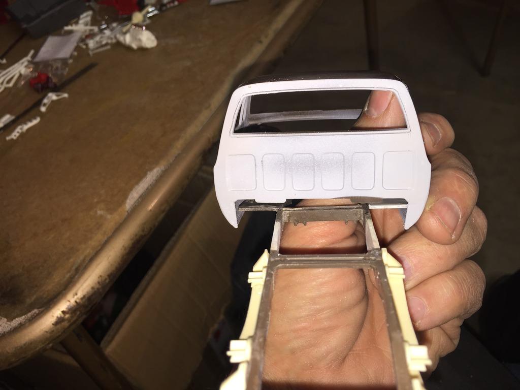

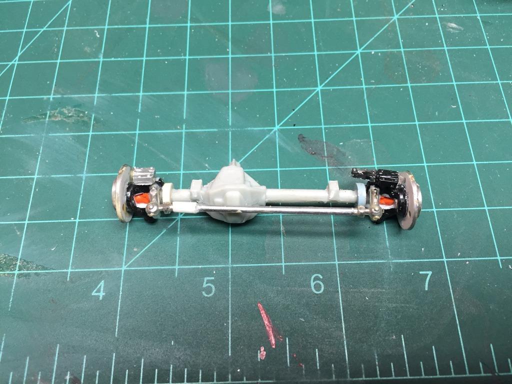

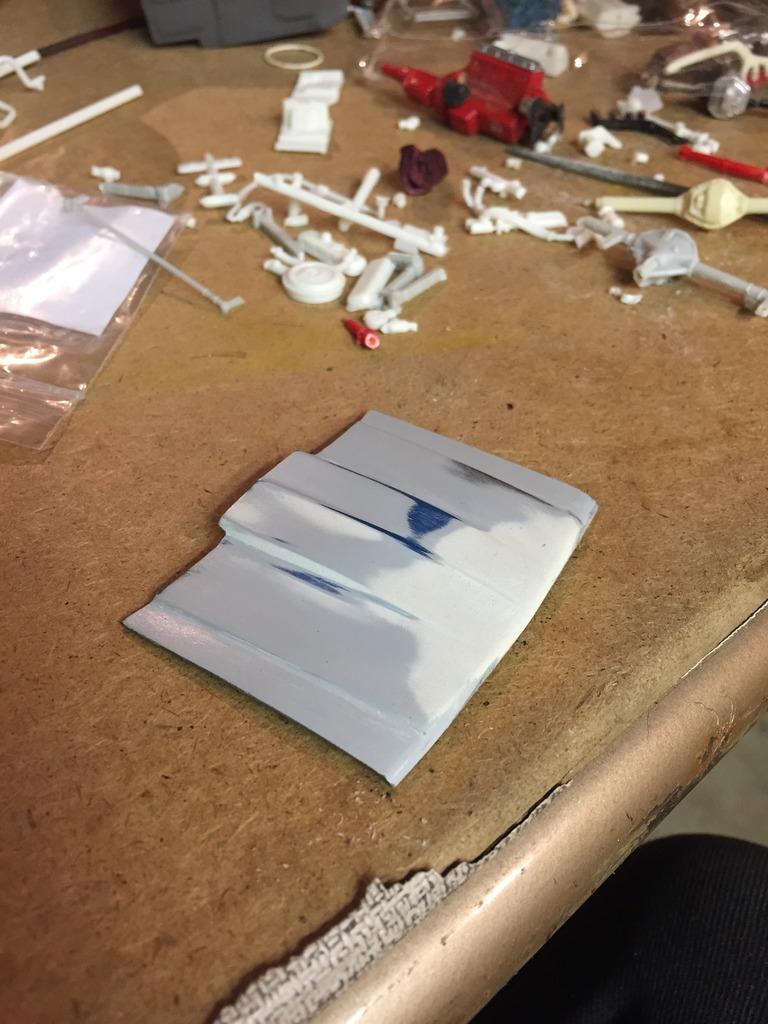

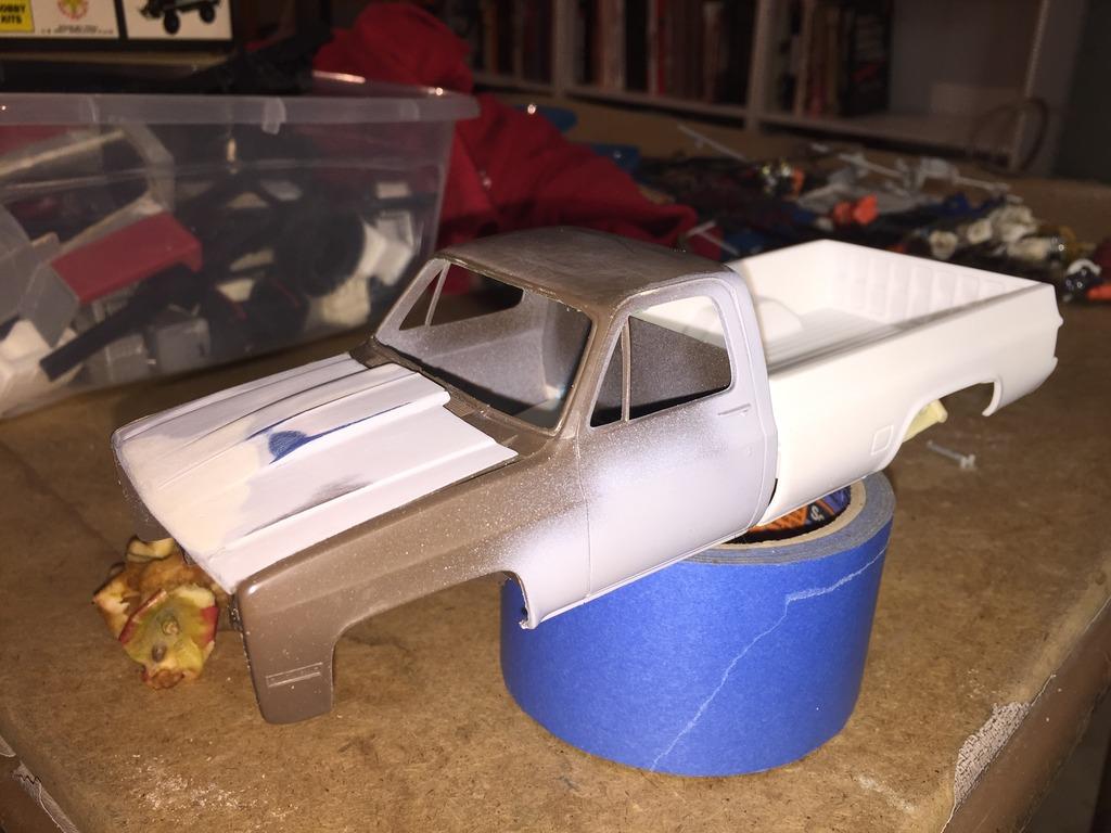

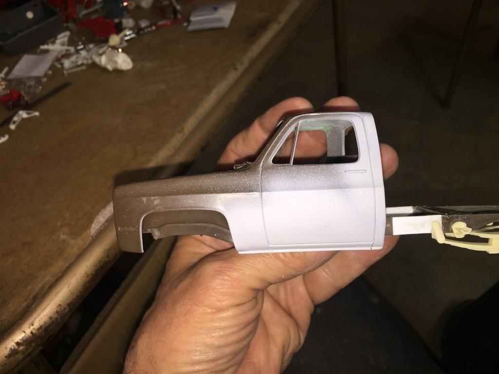

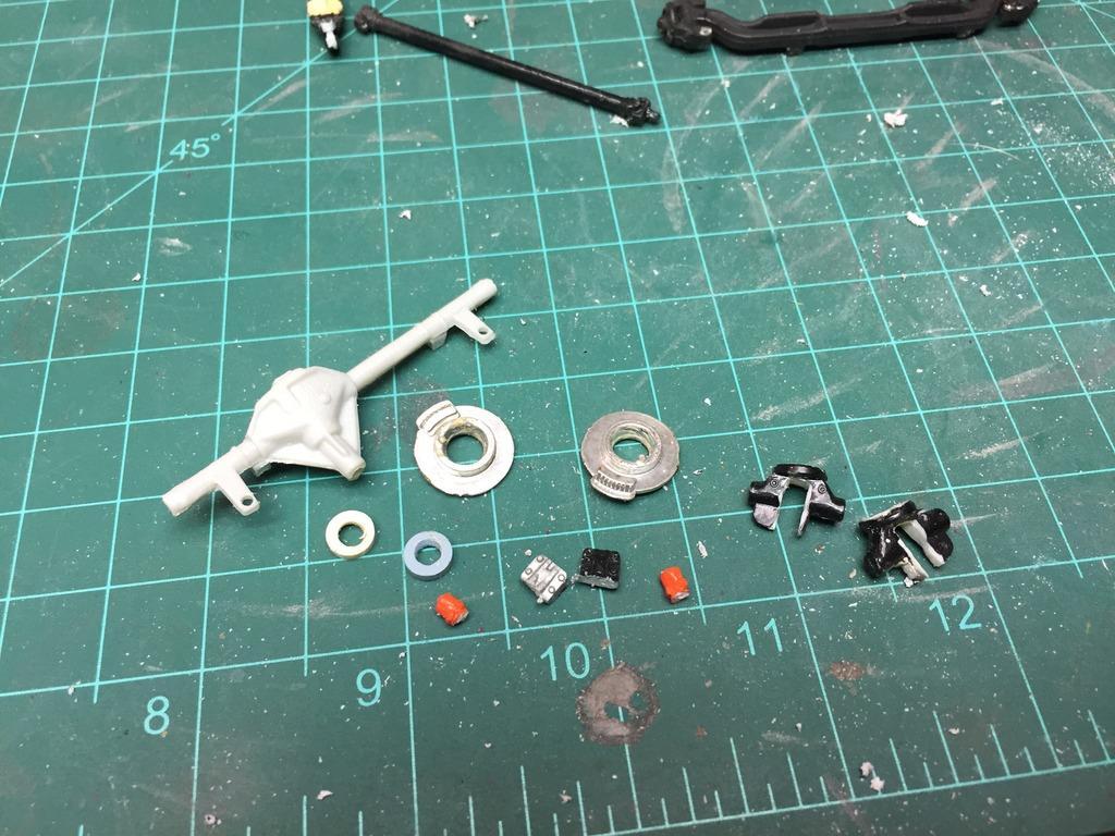

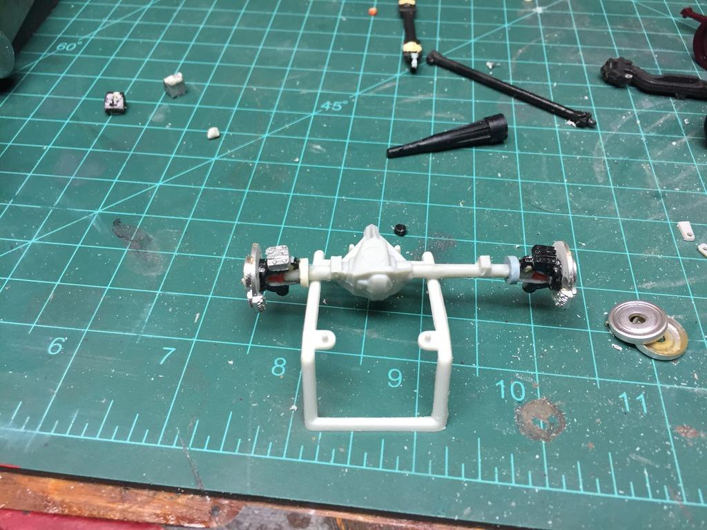

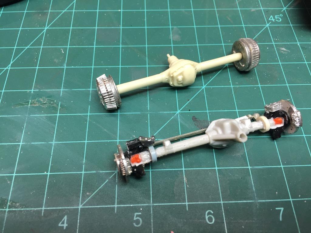

redneckrigger Posted January 4, 2017 Posted January 4, 2017 (edited) I bought a 1985 GMC K3500 pickup new back in 1984. It was a loaded truck, with the 454, power everything, air, cruise, and about everything I could ask for. It was a single rear wheel model. I used that truck up...........flat out wore it out. I then decided to rebuild her and started gathering parts. I used the engine in a wrecker I had, so I bought a 502 HO crate engine. I got all new sheet metal for her, including a new cab complete, rust free. I sandblasted the frame, put new kingpins in it, new springs, new everything. And then we decided to move. SO..........................I ended up selling almost all of my trucks, cars, and tools. I simply had no room at the new house for them............the garage I HAD was 50 x 100 and was full. So everything had to go. Ever since that day ten years ago, I have been kicking myself. I started doing the same thing but in 1/25th scale. I gathered parts.................!! So, here is the start of my replica GMC K3500. I used a Fall Guy cab, a resin 8 foot body, and stretched the frame from the Fall Guy kit. I used a resin 14 bolt rear end and built my own 60 series front axle from pieces and parts. The engine came from a Monte Carlo kit as did the 400 Turbo transmission. I added proper panel lines to the cab as shown. I also made a cowl induction hood, as that was what I was going to use on my 1:1 truck. I found the proper bucket seats and console for the interior. And I have suceeded in adding yet ANOTHER project to my line of projects vying for my time! Will add photos as soon as I can....... Edited January 4, 2017 by redneckrigger

mikemodeler Posted January 5, 2017 Posted January 5, 2017 Looking good, nice start to replicating the truck. What color is it going to be?

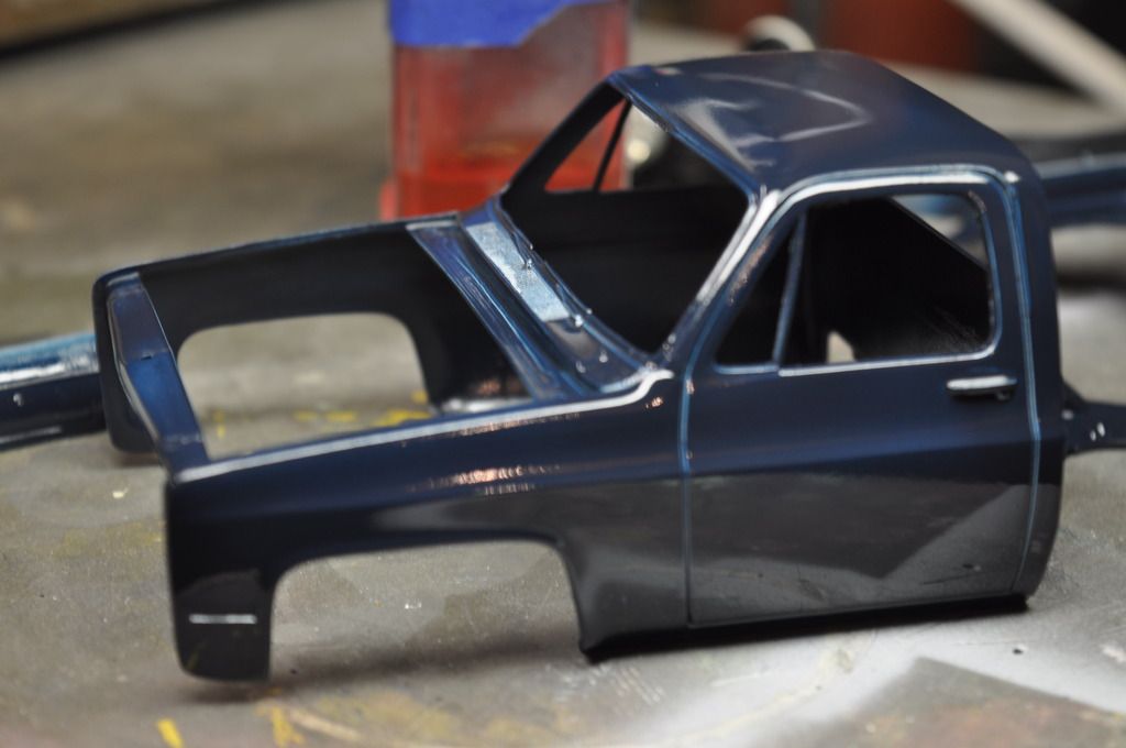

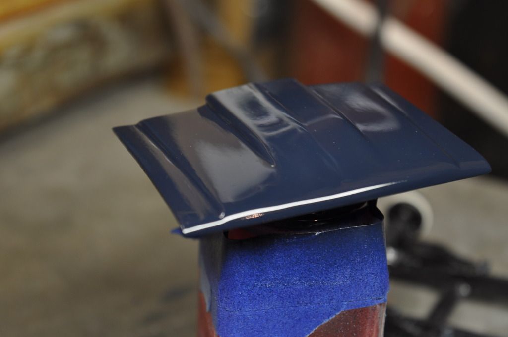

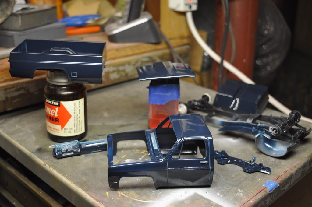

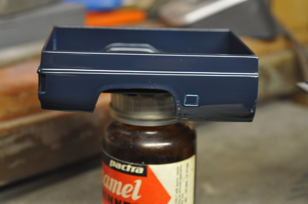

redneckrigger Posted February 10, 2017 Author Posted February 10, 2017 Shot the color coat.............came out pretty good. We will see what it looks like after drying for a few days. Did it with PPG ShopLine Enamel, GM Code 29 Dark Blue reduced with PPG ShopLine Mid Temp Reducer. Flows out very well. Will wait a week or more to dry completely, then get rid of any nibs that show up and buff as needed to get rid of any orange peel or shrinkage that shows up. Still, pretty happy with it so far. Boy, this brings back memories of my old truck! It also brings back memories of painting the many square body GMC/Chevy trucks I did over the years I owned my body shop................just like painting the real thing, only tinier! DEJA-VU!

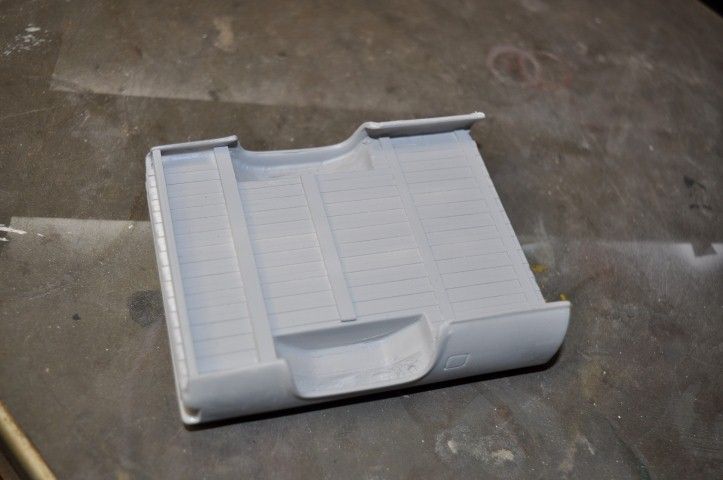

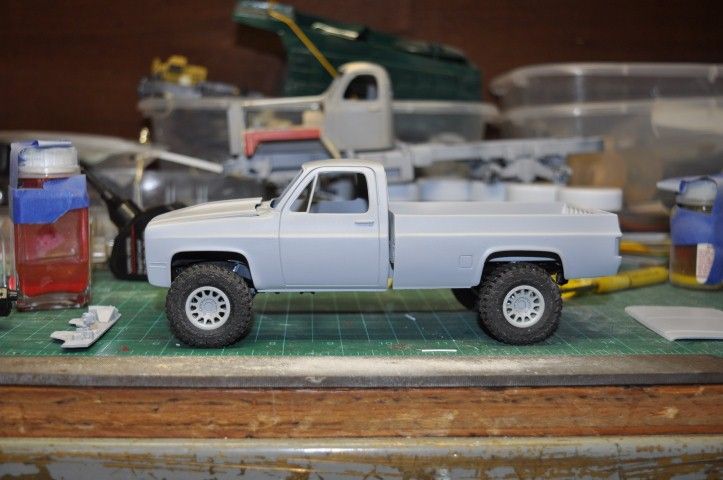

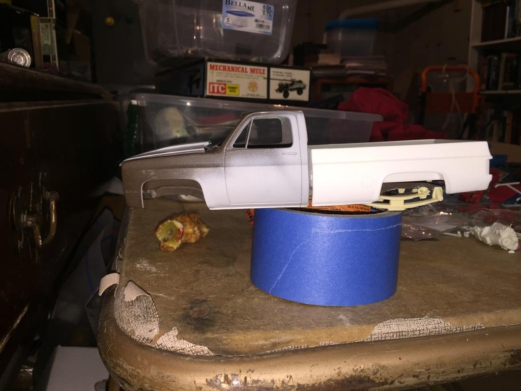

redneckrigger Posted February 10, 2017 Author Posted February 10, 2017 Seems like I have the photo problem under control.................at least for now! Here is a pic of the bed with added underside detail, and the entire thing in Mr. Surfacer primer mocked together to check the overall stance.....looks exactly like I hoped!

Foxer Posted February 10, 2017 Posted February 10, 2017 I'm glad to see you got the photos working.This is my kind of build, one you owned. Has to be what go you going again, Tom!The paint looks really smooth ... The rims look cool ...
redneckrigger Posted February 10, 2017 Author Posted February 10, 2017 I'm glad to see you got the photos working.This is my kind of build, one you owned. Has to be what go you going again, Tom!The paint looks really smooth ... The rims look cool ...Thanks Mike.............yeah, that old girl was a real beast, and would have been even better if I had ever gotten her done. But this is the next best thing, and in some ways better.....I can make it any way I want and change it at will! Paint looks good so far, but time will tell after it dries a bit. I don 't use hardener so it may have some shrinkage. Trying to get it done for NNL East.....!
redneckrigger Posted February 10, 2017 Author Posted February 10, 2017 Looking at the pictures here as well as the actual parts, I see I should have used an old armor/aircraft painting trick, and pre-shaded the panel lines and door opening lines with black to avoid the white appearance of them. Oh well, that's what they make paint remover for!

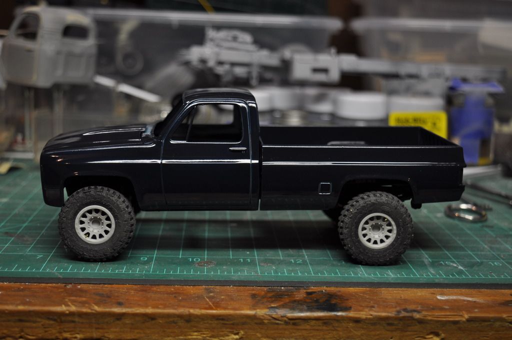

redneckrigger Posted February 10, 2017 Author Posted February 10, 2017 Mocked up.................yeah, it could use a bit more lift, but this replicates the 4" that I had in mind for my original truck....................that i wish I NEVER had let go of!
Foxer Posted February 10, 2017 Posted February 10, 2017 That blue looks really good!and I have to ask, is this the original or the rebuild?
