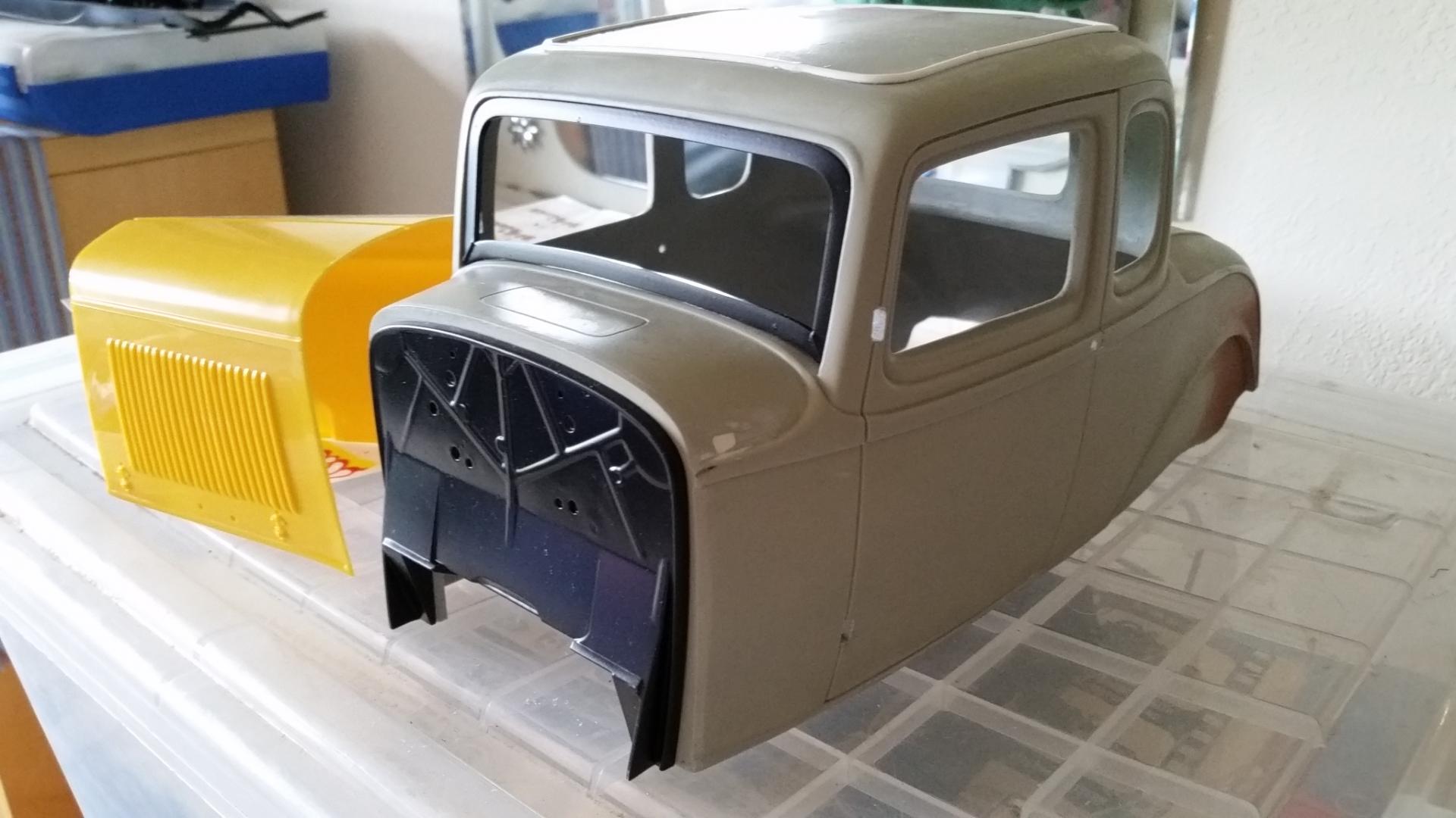

f1ford48 Posted February 23, 2017 Posted February 23, 2017 (edited) HELLO everyone, I have missed you all ,been away for a spell working on 1/1 scale cars-now I am back with another kit bash for us all to enjoy. after my last scratch build- 1906 Locomobile ''OLD 16''- I am now into even bigger scale -namely 1/8- what ever I can'' scratch up'' I located a 5 window body [second] from the late Mike Gradis. by the way- he was always very helpful to me with his large inventory of big scale parts-sometimes sending me stuff for free or shipping.he was a great guy a fellow named John Hockney I met a few years back at NNL west supplied the stock Flathead parts -he does them in resin. the wheels will be the original Kelsey -Hayes wire spokes taken from Lindbergs Hot Canary T. [had to locate 3 kits to get 5 skinny wheels and tires] so- now I will start to bring a Hot Rod 1/8 scale Big Deuce BACK to the way HENRY built it. any suggestions and critique are welcome............. Edited February 24, 2017 by f1ford48 incorrect title 1

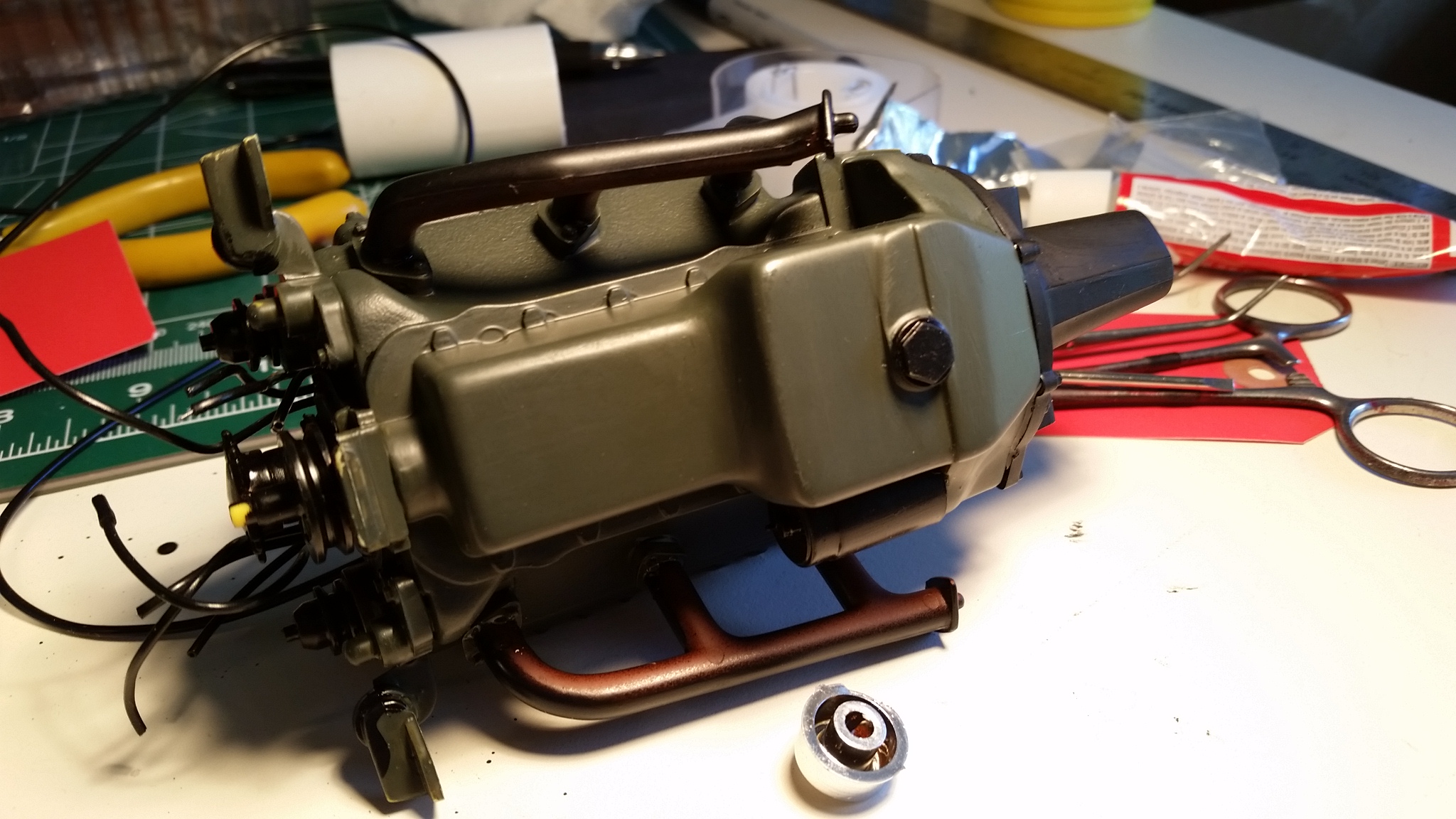

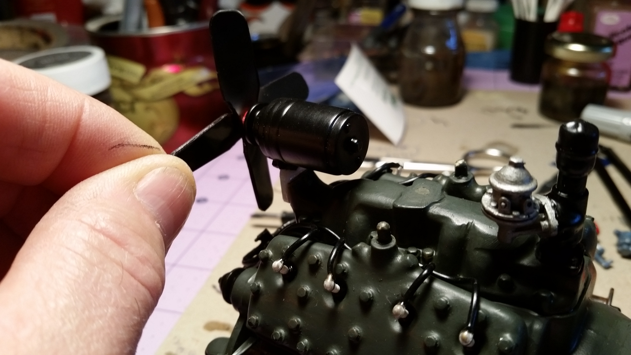

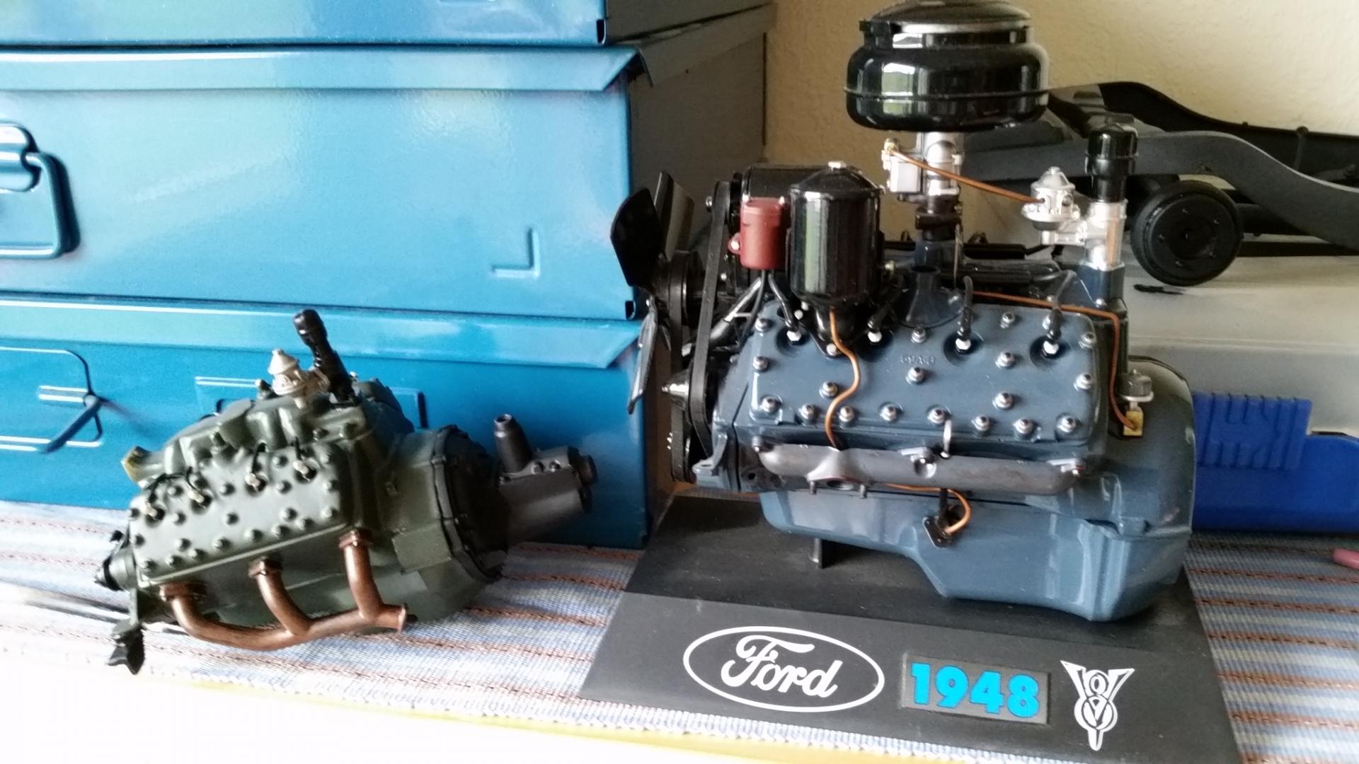

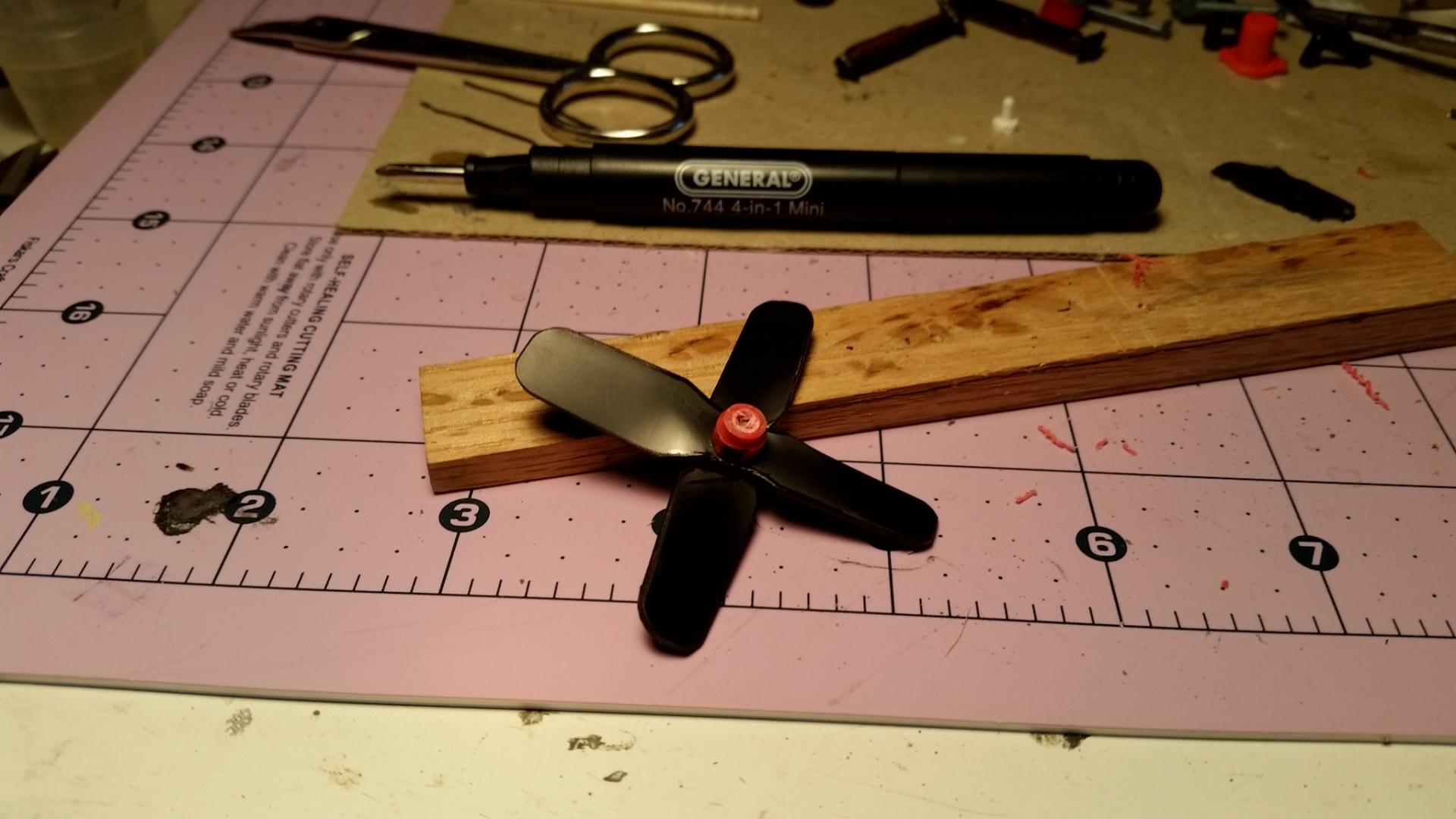

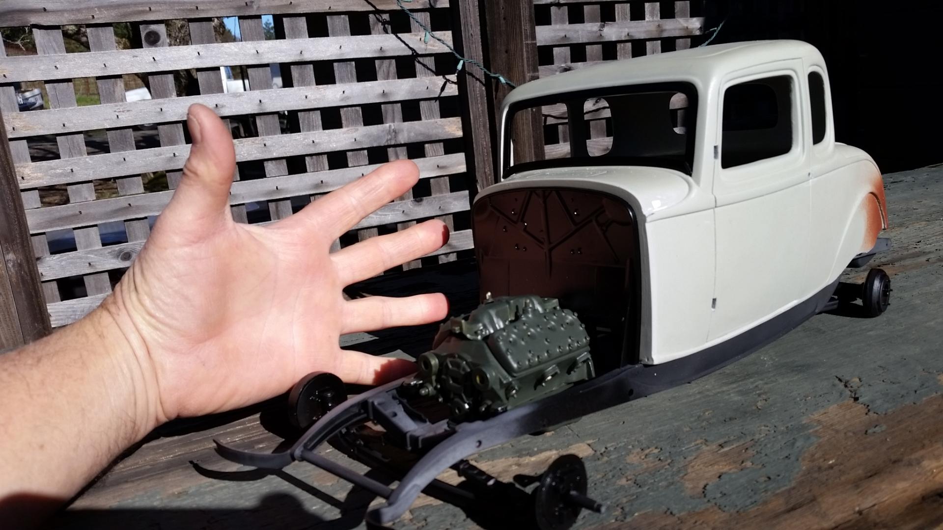

f1ford48 Posted February 23, 2017 Author Posted February 23, 2017 working on the engine now- trying to get it as stock as possible including the color. could not find a fan in the parts box so I scratch built one-easier than I thought. the intake was set up for triple carbs so the 2 ports were sawed off and filled and re contoured.the fuel pump and oil fill are also resin from John H. on the bottom the oil pan was filled and detailed around the drain plug because it was 2 piece and had a glue seam running down the length. last shot is next to the HAWK 1/6 scale 1948 V8-a very nice model. 1

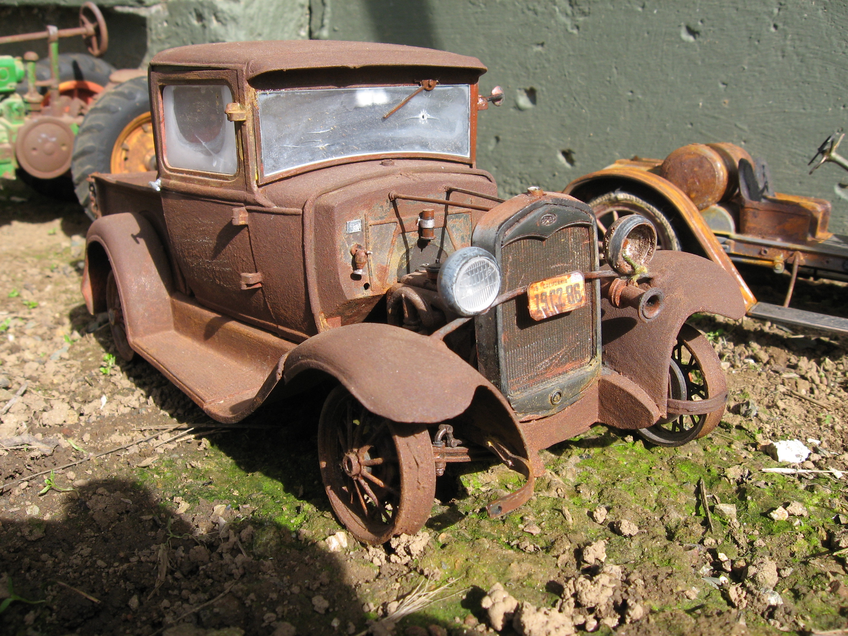

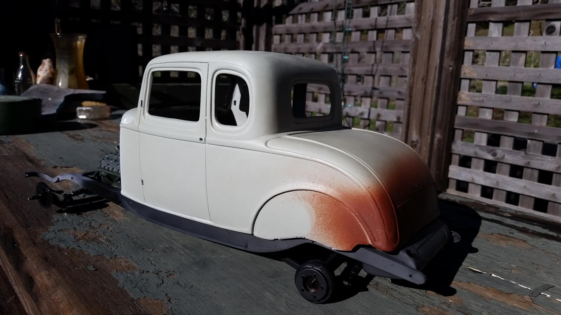

f1ford48 Posted February 24, 2017 Author Posted February 24, 2017 thanks guys and welcome..this IS going to be stock-or as close as I can get it. I like period and nostalgia Hot Rods- but that's about it. - if you've seen my other builds I tend to steer towards ''drivers'' -they look more real -I like a little rust with my dust. my goal is to take a photo of the finished model and have the viewer think its the real thing...like this A pickup I did long ago. 1
Ognib Posted February 24, 2017 Posted February 24, 2017 (edited) The color of the material on the body you're using looks very much like the 5 window that I started my 3 window project with.Nice work! Edited February 24, 2017 by Ognib

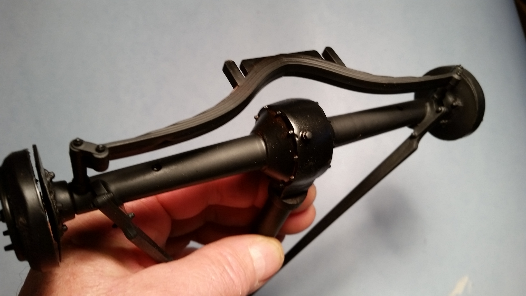

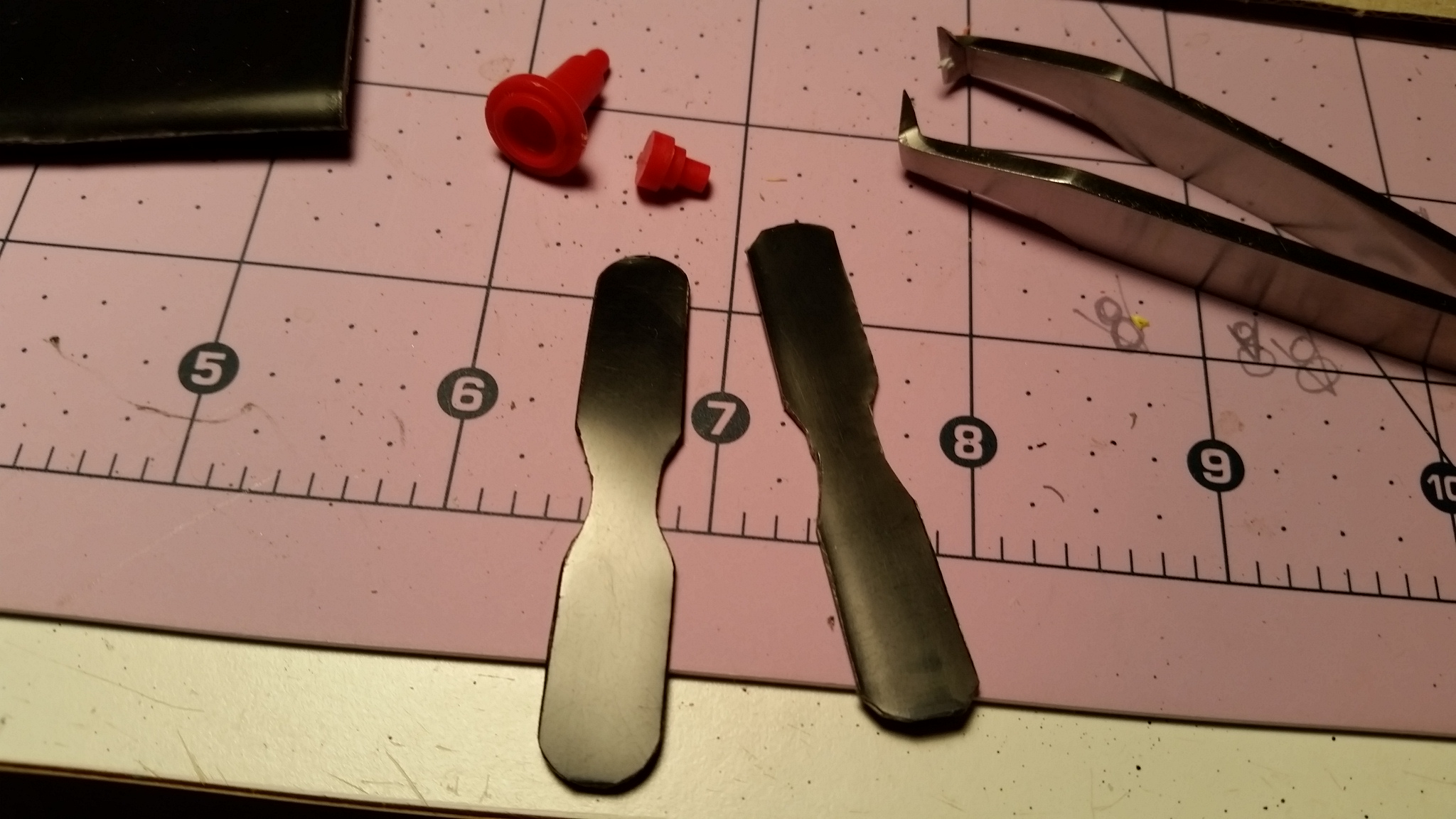

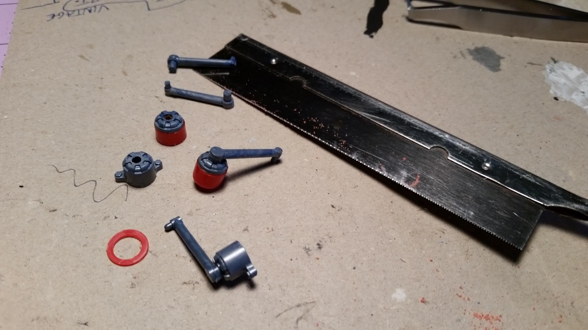

f1ford48 Posted February 24, 2017 Author Posted February 24, 2017 the big deuce frame is easy to bring back to stock. I will raise the front spring and replace the airplane type shocks with the original Ford Houdaille lever action shocks-taken from the Lindberg ''HOT CANARY T'' the rear end was a salt flat style ''quick change'' first I decromed it then cut out the quick change casting -filled it -sanded and added a gear oil fill plug WHALA! back to stock. the brake drums are too big-I want to see daylight through the wire wheels so I cut them down to original size and used PVC pipe for the drum part.also had to modify the backing plates... 1

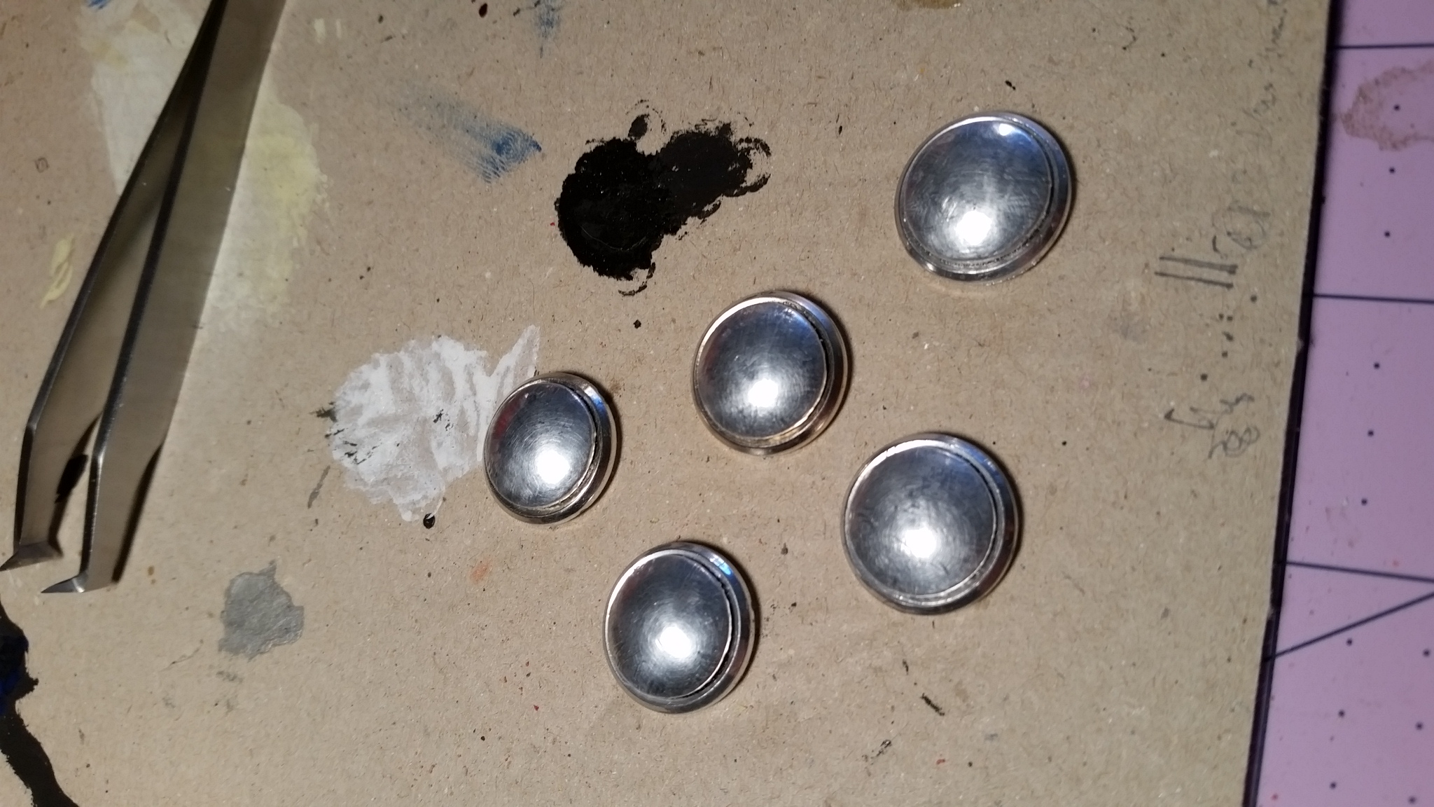

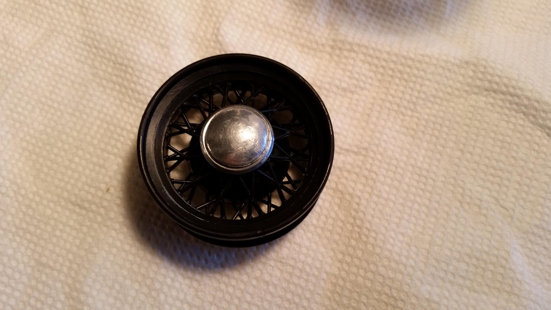

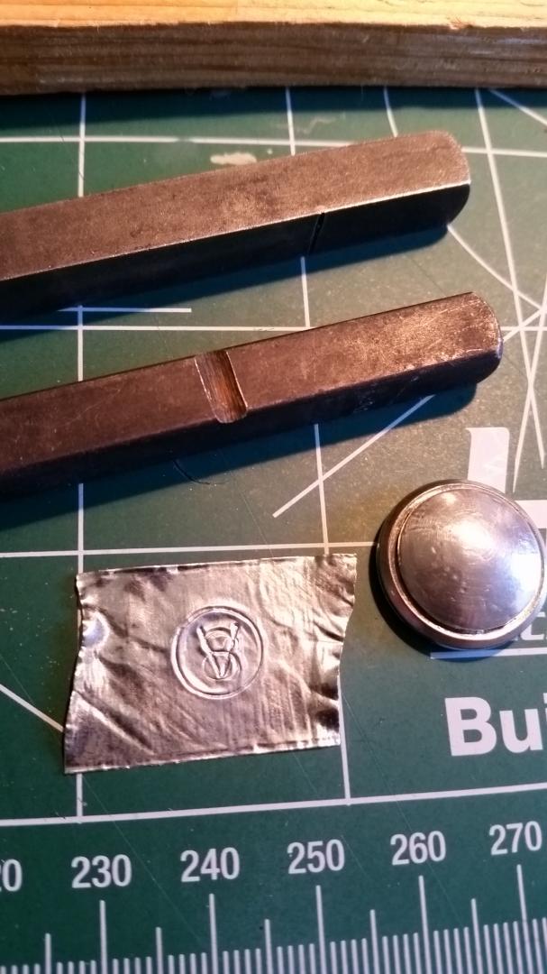

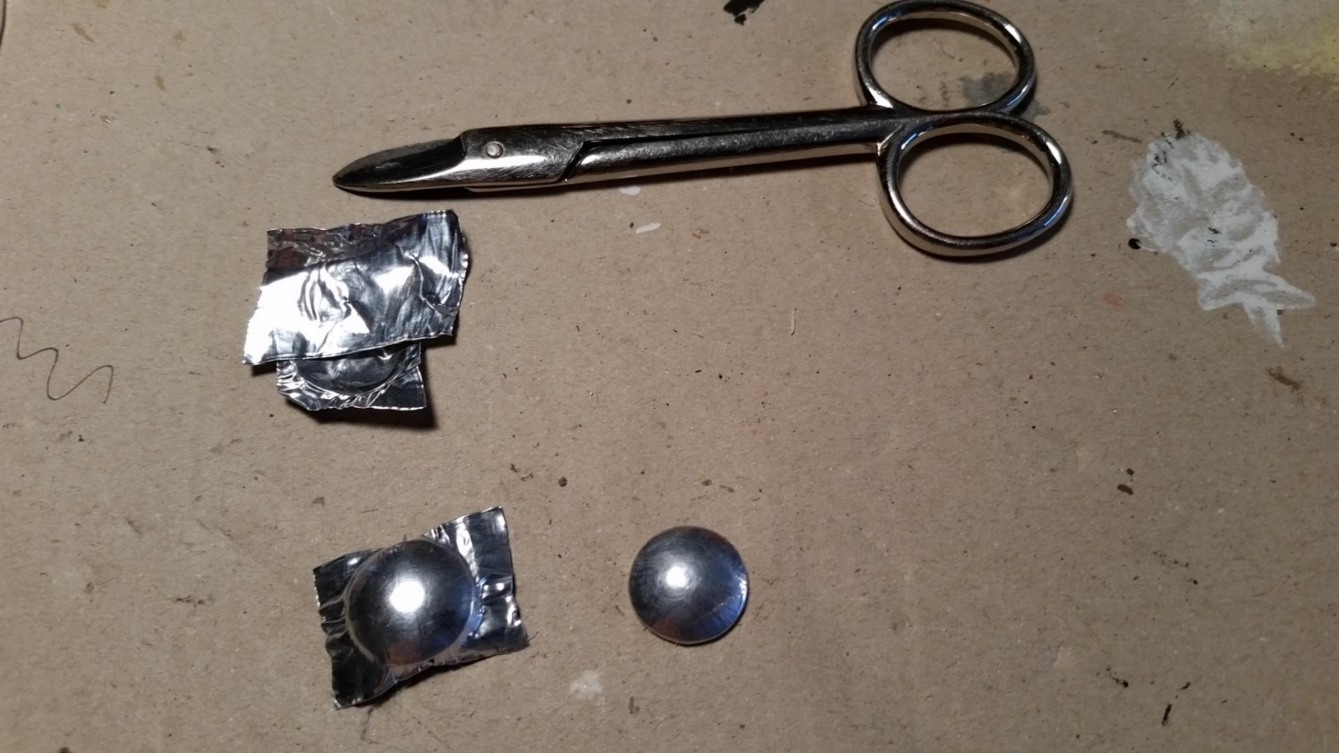

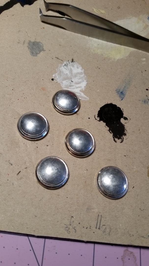

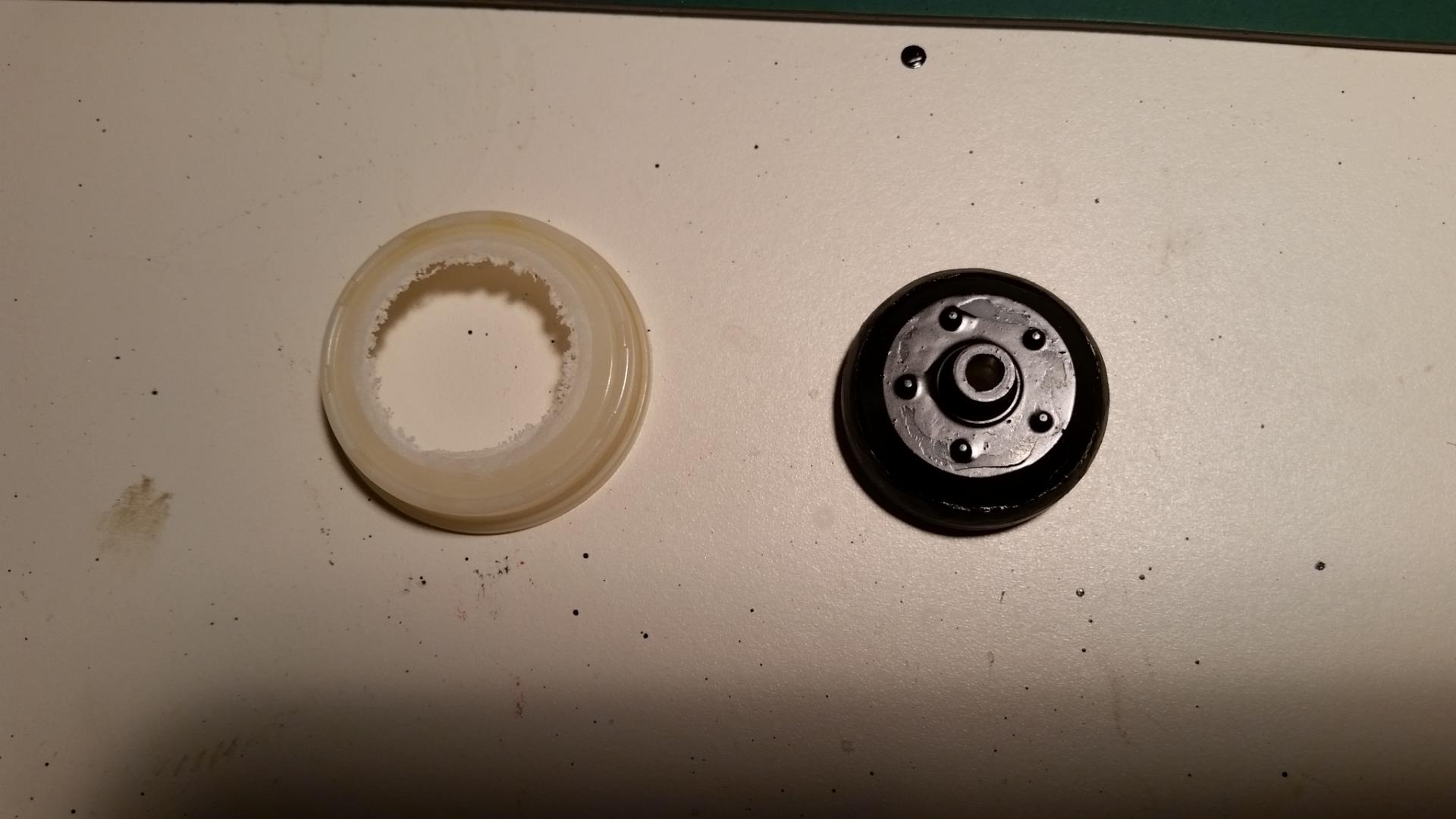

f1ford48 Posted February 25, 2017 Author Posted February 25, 2017 some wheel work today-for the stock hubcaps I cut the heads off of 1/4 inch carriage bolts-this gave me the dish I wanted, then I covered them with metal tape and glued them to the spinner hubcaps from the Lindberg T kit. the V8 logo I have not decided on yet- the debossed one is not quite'' crisp'' enough to be convincing. might need to figure out some transfers for these...... 1

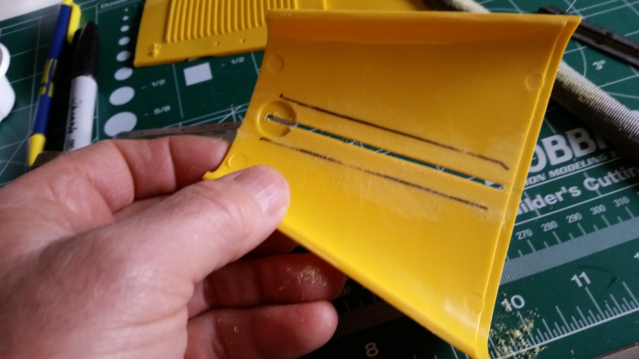

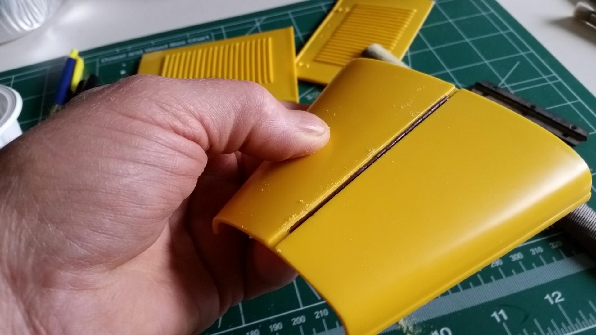

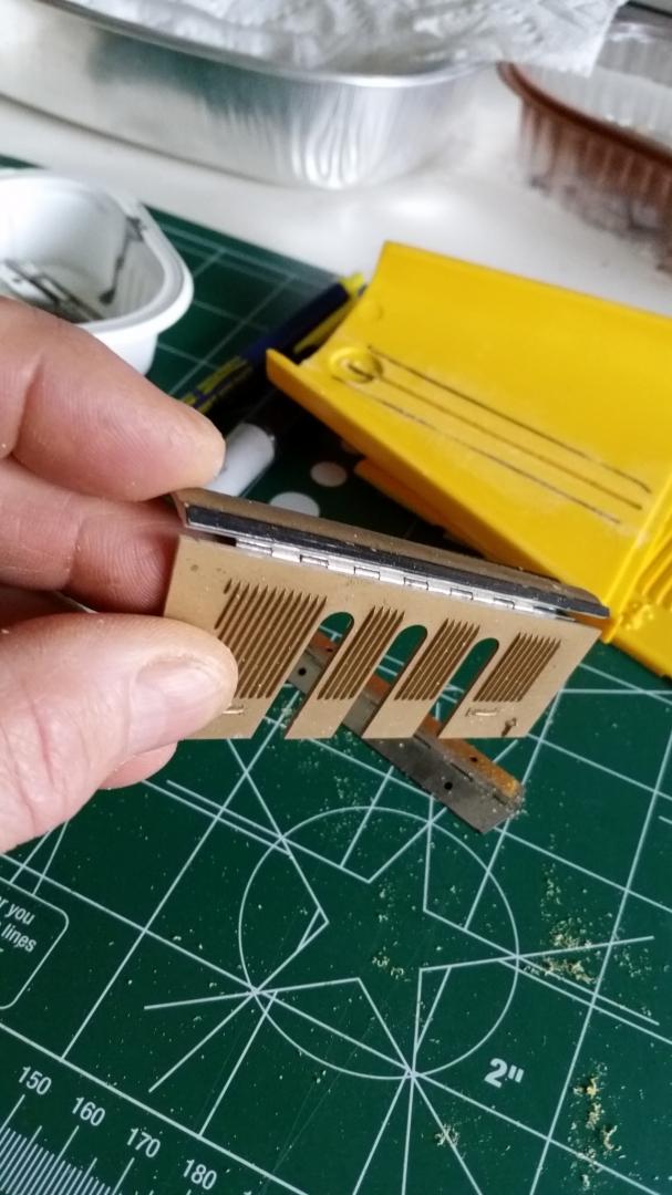

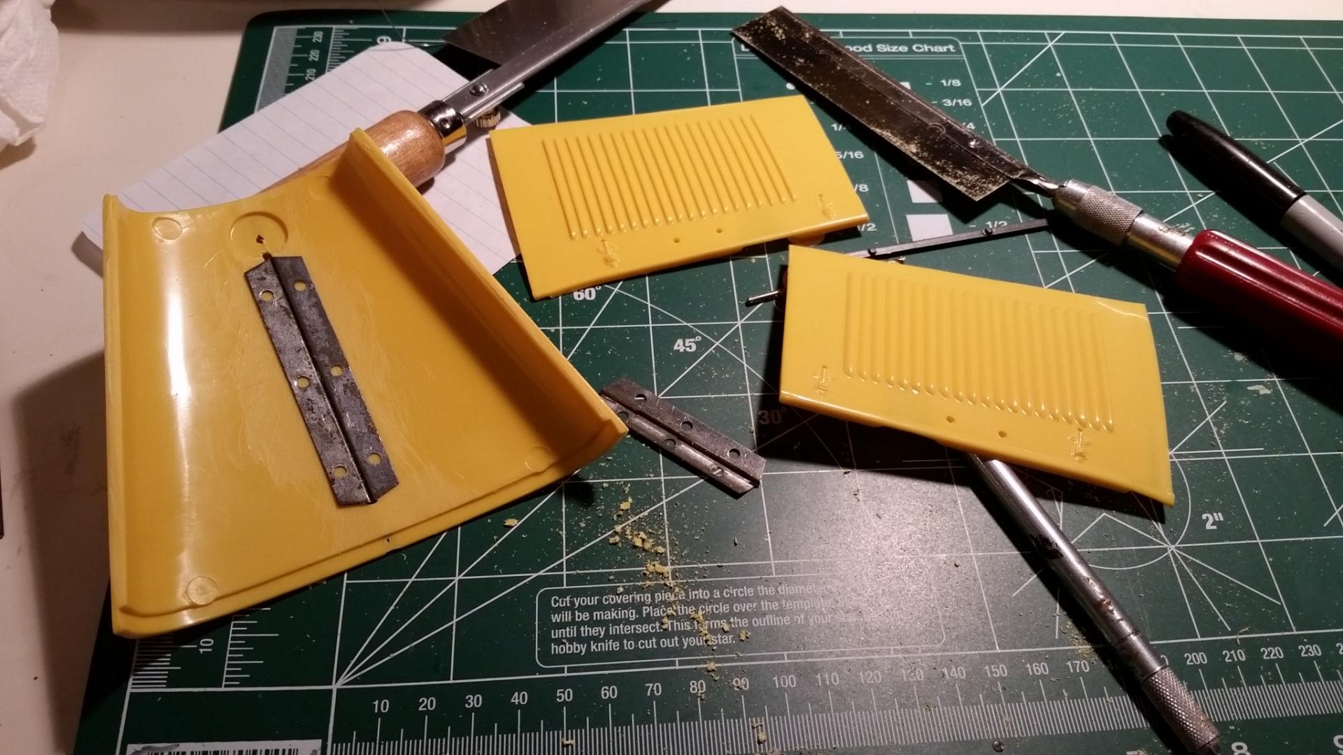

f1ford48 Posted February 25, 2017 Author Posted February 25, 2017 I decided it would be nice for the hood to fold open like the original. so I found some miniature piano hinges from the ''junkyard'' start by cutting the hood sides off-right below the molding. I left the hood top as one piece and carefully cut the center out for the hinge.this leaves the width of the hood top undisturbed. this way I can glue my hinge in and cut the ends later and everything should be in line-the sides don't matter as much because they fold inward 1

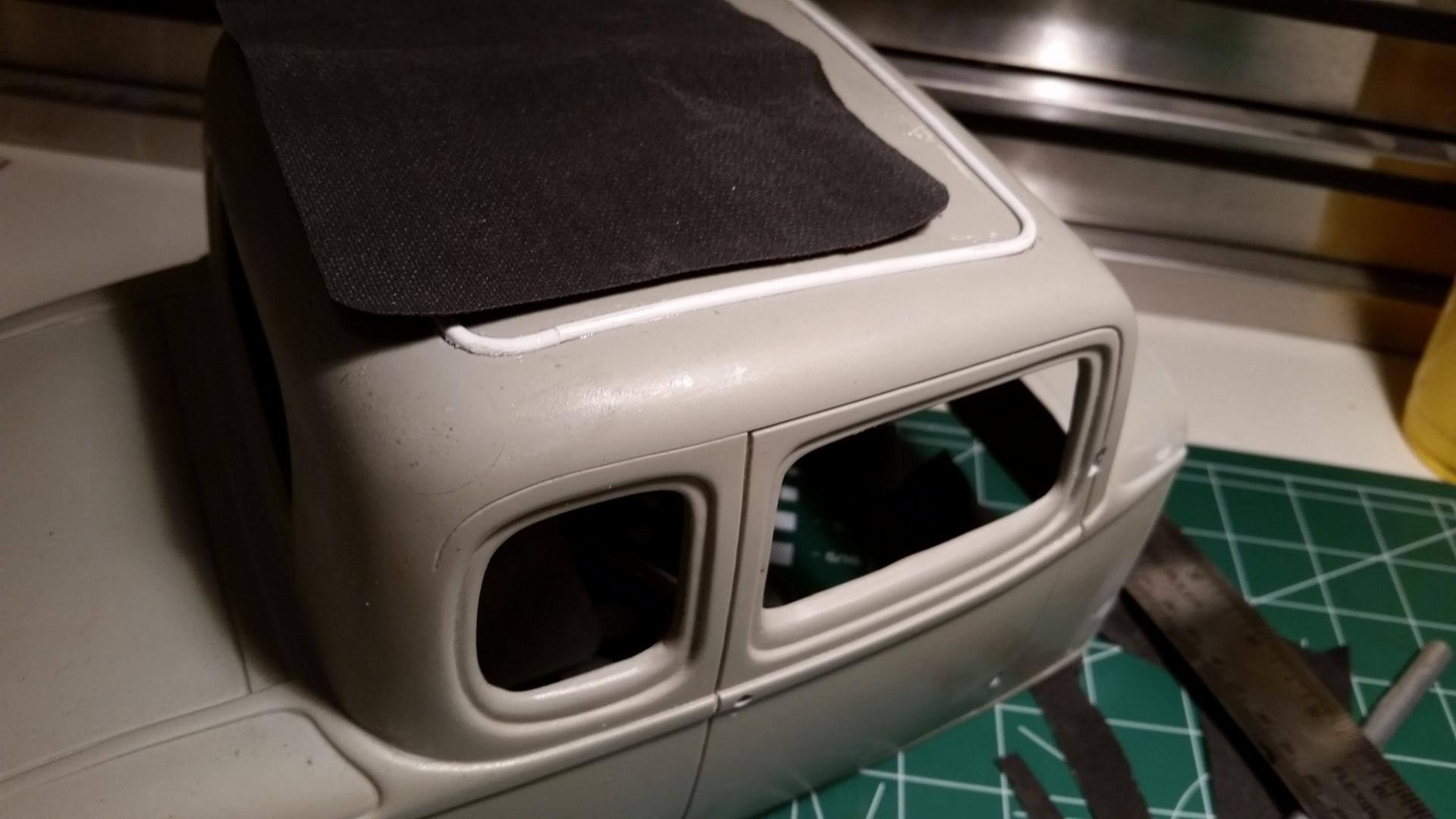

f1ford48 Posted February 25, 2017 Author Posted February 25, 2017 to bring this 5 window back to stock is just a bunch of small added details- looking at period factory photos helps a bunch in creating the details. here the firewall has been filled where the Hot Rod ''beehive'' oil filter was. then I built the windshield frame with styrene-note the small finish moldings at the lower corners. holes are cut to add the door hinges and door handles [which I will also make up] the closed cars had a wavy door handle-much different than the open cars. then the 1/2 round molding on the roof for the top insert-and some grained material for the insert. 1

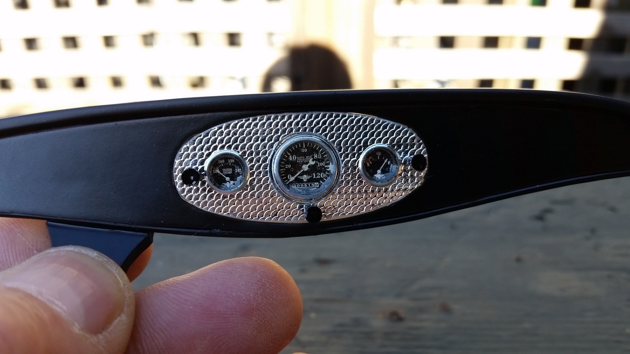

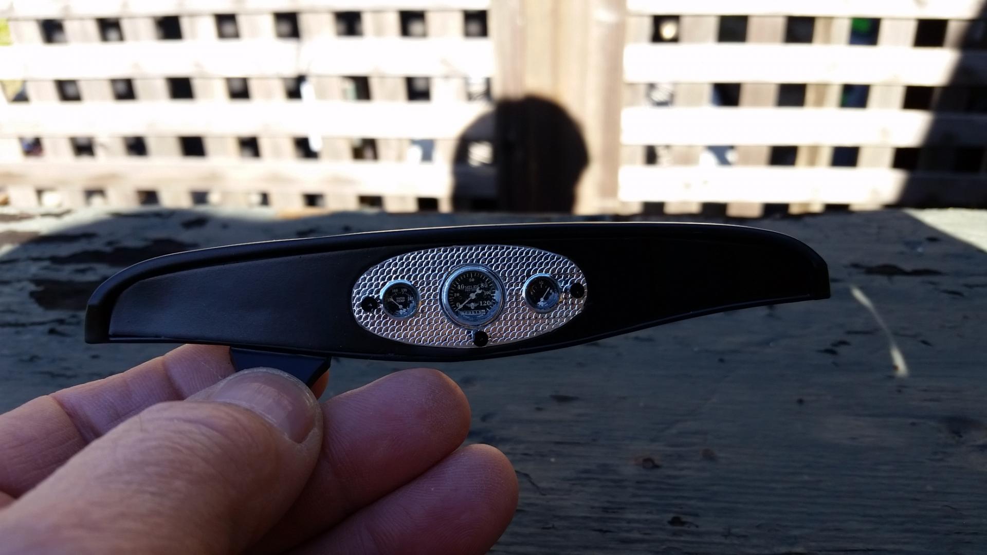

f1ford48 Posted February 25, 2017 Author Posted February 25, 2017 on the dash board I wanted to keep the MACHINE TURNED background.[it is stock] so I took the chrome Hot Rod firewall and cut out an oval around the 3 gauges. then drilled out the center gauge hole . then I cut the bezel out of the speedo on the 5 gauge panel. that was glued to the center-larger hole in the new panel. then I glued in the instrument faces and epoxied over the faces to simulate lenses. the dash board was covered with sheet styrene-to fill the void of the larger Hot Rod panel- then outlined with my new panel and the hole cut for the new oval panel. then I added the choke,throttle and panel light switches...... 1
peekay Posted February 25, 2017 Posted February 25, 2017 This is looking great! The dash is exceptional.
Reeves Racing Posted March 3, 2017 Posted March 3, 2017 Great work on the dash. I thought the original 32s had a little red filled thermometer for a temp gauge though?
CometMan Posted March 4, 2017 Posted March 4, 2017 Very cool idea Frank! Always love seeing stock '32s. Your choice of sheen of black on the engine accessories and chassis parts, and especially the green on the engine, looks pretty close to dead-on correct.

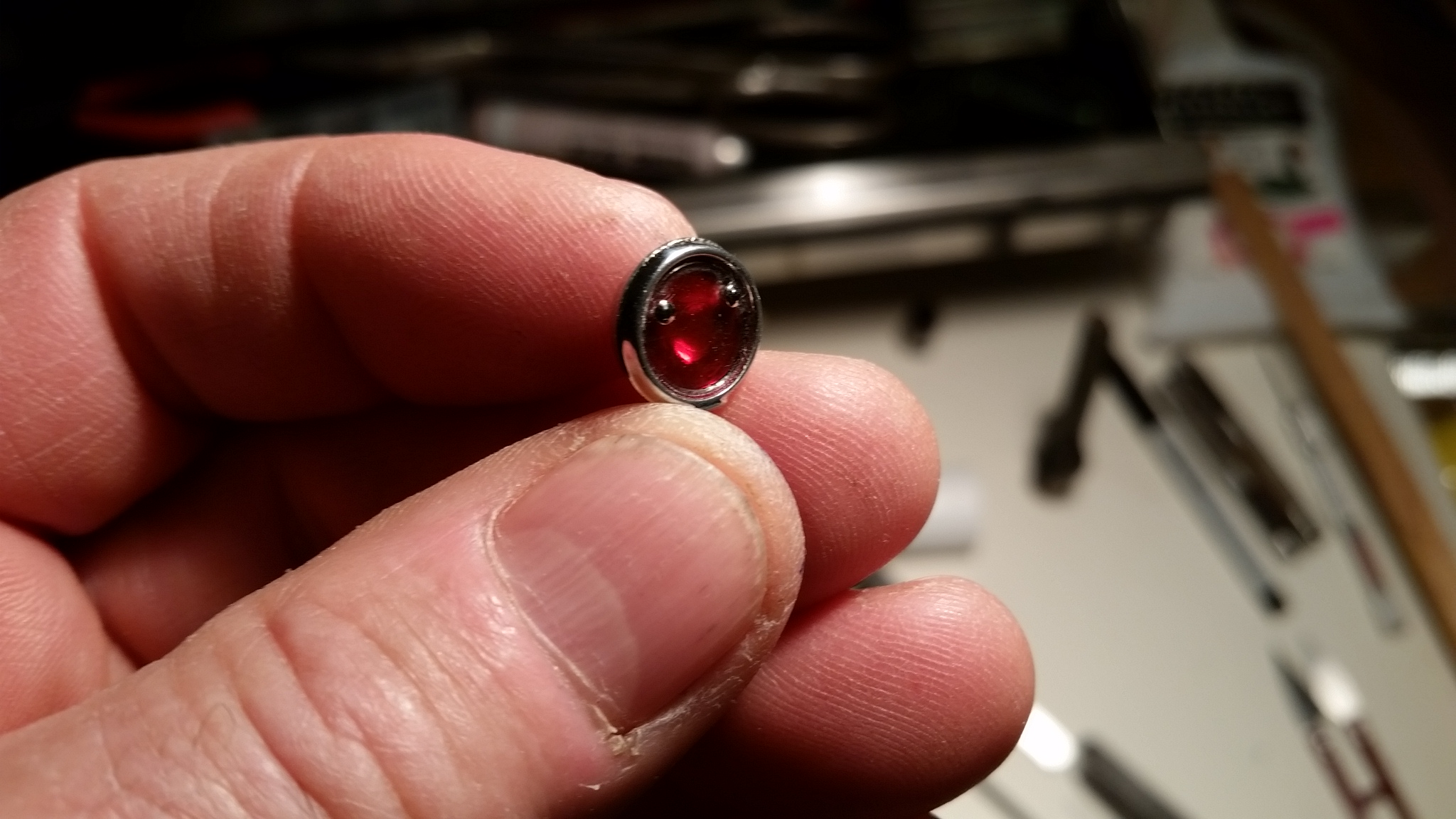

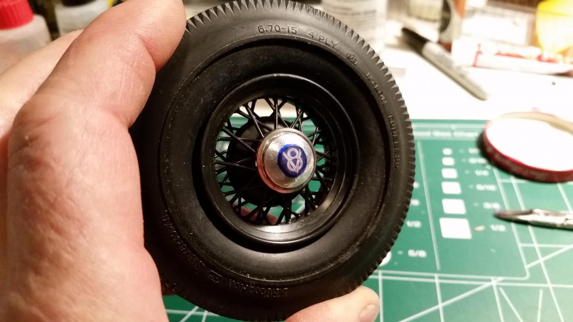

f1ford48 Posted March 4, 2017 Author Posted March 4, 2017 Thanks Guys- I am building it close as I can ....real Flathead Aficionados will notice its a later engine as well. the model will represent a car that has been on the road for 15-20 years. I worked on the hubcaps tonight-still not 100 percent satisfied with the ''V8'' I had insignias scaled down from hubcaps in a parts catalog and printed on glossy paper-but they are tough to get perfectly round cutting them out.. I sure wish there were some decals out there-would be sharper than this- but searches turned up nothing so far. also made up the taillight using the cowl lamp.......... 1
f1ford48 Posted March 4, 2017 Author Posted March 4, 2017 Yea Mitch-that is correct on the temp gauge. the speedo on a stock 32 only goes to 90 mph as well. with the doors not opening on this model you will only get a glance at the dash anyway.
