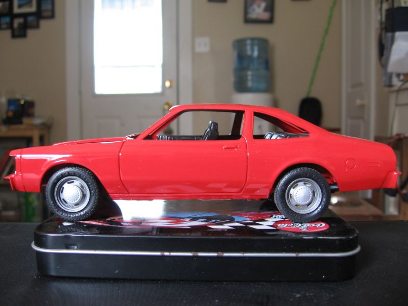

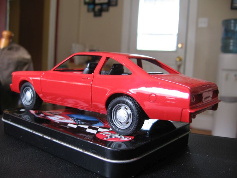

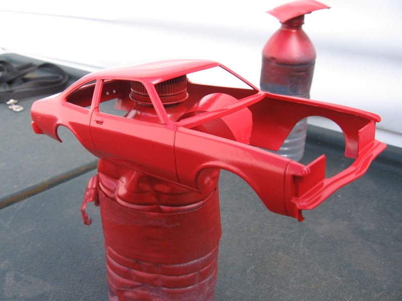

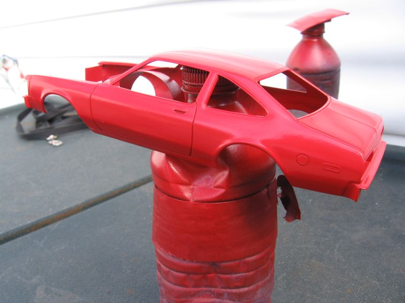

restoman Posted April 4, 2017 Posted April 4, 2017 I've been playing around with this kit for a couple months, off and on. The very first thing I did was eliminate the molded-in T roof and then spent a little time adding some better detail around the quarter window/ drip rail area. I scribed below the taillights where the flexible ruber filler pieces go, and down the edges of the lower quarters the way they are in real life. Scribed some panel lines on the front fenders to replicate the fender extensions, and did the flexible filler pieces there as well. Sanded away some of the too-high body contour on the sides and scribed in a fuel filler cap, instead of the goody glue-on one in the kit. Also deepened the existing panel lines and sharpened up the rocker molding. Painted with Testor's red enamel, it's ready for polishing. I've done away with the kit's rear end and used a 8.34 rear from my home-cast collection. Ditto with the driveshaft. Thought about trying something with the front suspension... and decided it would work as-is. The kit's V8 is tiny. I'm going with a Duster engine and trans from my home-cast pile, along with some slimmed down headers from the '67 Hemi Charger. Need to still scratch- build some engine mounts. The molded-in headlights will be replaced with some clear ones, as soon as I get around to making a mold. The pad printed tires are ok, so I'm using some of Fireball's cop car wheels for that tough look... One of his Holley carbs is going to sit on the 360 engine as well, topped with a copy of the dual snorkel breather from the '71 Charger.

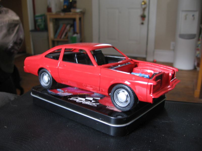

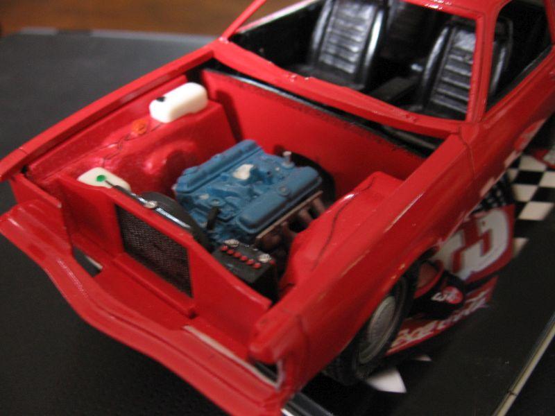

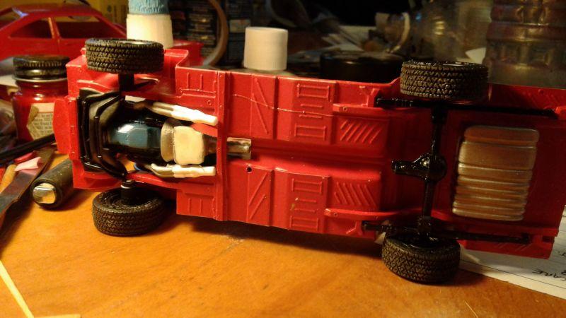

restoman Posted May 31, 2017 Posted May 31, 2017 Some slow progress on mine... I used one of my cast copies of the Duster engine and I'll top it with a Fireball carb, a MAD distributor and one of my dual snorkel breathers. The headers are from the '66 or '67 Hemi Charger. Not quite right in the size or port department but good enough. Replaced the kit rearend with a cast of an proper 8.75 and used the kit springs. Lots to do still but I'm happy with how it's looking so far. Not a bad kit if some time is spent on it...
stavanzer Posted May 31, 2017 Posted May 31, 2017 I really like what you have done so far. Are those FireBall Resin wheels?
