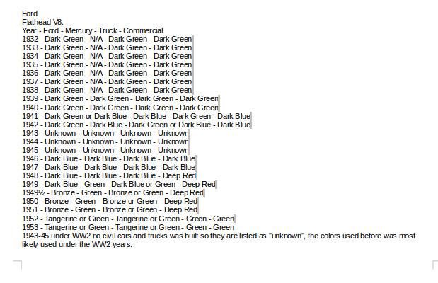

my66s55 Posted May 11, 2017 Posted May 11, 2017 (edited) Some years back, someone posted a link to engine colors. I made a file of it and don't have the web address. Here are the flathead engine colors by year. Edited May 11, 2017 by my66s55
espo Posted May 12, 2017 Posted May 12, 2017 On 5/11/2017 at 3:48 PM, pharoah said: It seems like factory speca are not always carved in stone.David,I wonder if there was a parts 'overlap; when changing from one year to the next.I doubt if they worried about engine parts matching exactly. Most people never opened the hood. They would have used leftover parts from the previous (or the next) year .Just my .02. ThanksThe "overlap" you mentioned is more common then you might think. In late '67 I ordered a new '68 Chevrolet Bel Air tudoor. To get around insurance charges at the time I found that the insurance company only wanted to know if the new car would be a 6 or an 8. They didn't seem to care which 8 and my insurance dropped almost in half from my '66 Impala SS 396 & 4-speed. They insured my new Bel Air 385 hp 427 cu in 4-speed with no problem at all. The point is when this car would throw it's fan & Air Con. belts which it shredded on a regular bases the engine took '67 part number belts and '68 part numbers wouldn't fit. In the '70's working for several different Chevrolet dealers it was not uncommon to get new inventory that had hub caps and often trim and grills from a Pontiac or a GMC truck. It was like what ever was handy at the time.
