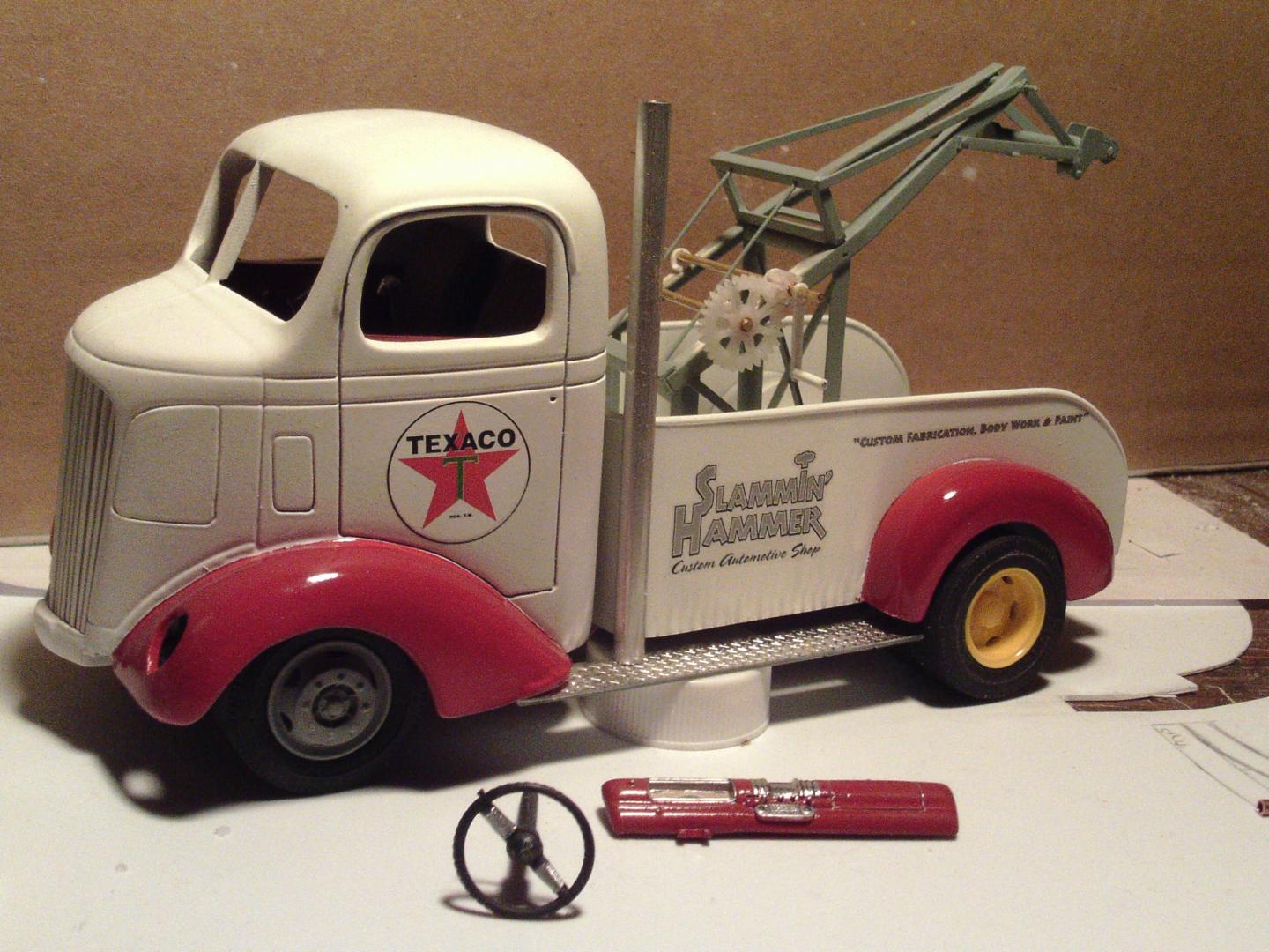

I hope someone here can help. I have this 38 GMC resin cab that has no glass for it. I made the windshields so they fit in the opening nice but I'm not sure how to glue them in without messing them up. I have some testors window glue but I've never had much luck with it in the past. Here's what I'm working on, any help would be appreciated. Thanks!

I would use some 5 minute epoxy to install your glass. I would use some masking tape to hold the glass in place and then use the epoxy around the inside of the glass to the body. any excess glue can be cleaned off you glass if not careful

Zap formula 560 canopy glue.  Get it at the R/C counter.  It is a water based white glue formulated for holding clear canopy's on R/C aircraft.  It tacks up pretty quickly an drys clear.  Because it is water based it cleans up very nicely with either a little water or alcohol on a Q-tip.  Great stuff!
