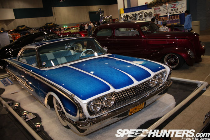

Jon Haigwood Posted June 7, 2017 Share Posted June 7, 2017 Doing a 60's style custom and want to try and paint panels with fogged edges. Never tried this before Any tips on the best way to accomplish this ? Base coat will be Createx pearl white, panels will be with Autoair transparent blue with some pearl white added. Air brush for fogging is a Paasche VL with fine tip. Thanks Quote Link to comment Share on other sites More sharing options...

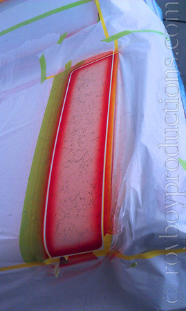

gtx6970 Posted June 7, 2017 Share Posted June 7, 2017 The way I understand it. the OP wants to fog paint over thin pinstripes ( like shown in the picture ) for that he needs to lay a very thin pinstripe tape down and paint along said tape with a very small tipped air brush And btw, I did NOT use an airbrush or tape. Fireball 500 was done last year Quote Link to comment Share on other sites More sharing options...

Jon Haigwood Posted June 8, 2017 Author Share Posted June 8, 2017 The way I understand it. the OP wants to fog paint over thin pinstripes ( like shown in the picture ) for that he needs to lay a very thin pinstripe tape down and paint along said tape with a very small tipped air brush Not actually , I don't want the pin stripes ,more like the fogged area in this pic. but without the lace Quote Link to comment Share on other sites More sharing options...
BigTallDad Posted June 8, 2017 Share Posted June 8, 2017 (edited) Then my original suggestion stands. Do the base coat, then the fogging (as described above) before you paint/decal the pinstripes. BTW, Snake45's use of the term "floating" is exactly what I was trying to explain, but he said it better than I. Edited June 9, 2017 by BigTallDad Quote Link to comment Share on other sites More sharing options...
