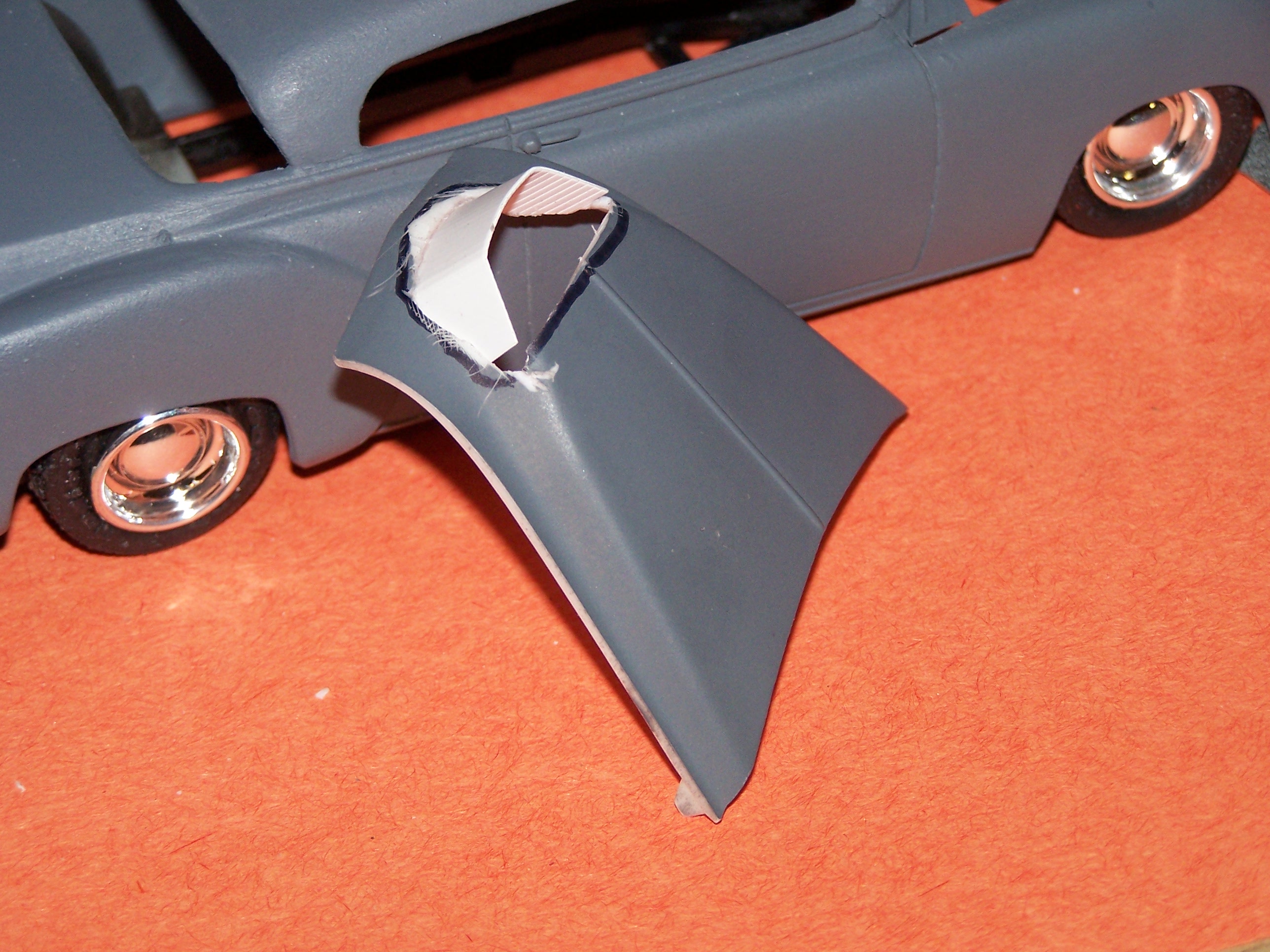

Farmboy Posted July 22, 2017 Author Posted July 22, 2017 (edited) Oh my, summertime and motorcycles...what's a guy to do? Anyway, continuing on with the boat tail, here are a couple of views of where I've glued the styrene sheet to the modified hood. I used CA (crazy glue) to anchor it, then used good old Testors tube glue to firm up the bond between the two pieces. No attempt has been made to shape it to the body but If you look close you can see the pencil marks for future roughing in of the curve. The 'hoop' piece you see at the nose section is a half-round piece of styrene rod to reinforce the joint. A smaller piece will be joining the forward nose section. None of this will be seen so structure takes priority. Note the reinforcement piece of the hood/tulip panel. Comments and observations welcome Edited July 22, 2017 by Farmboy

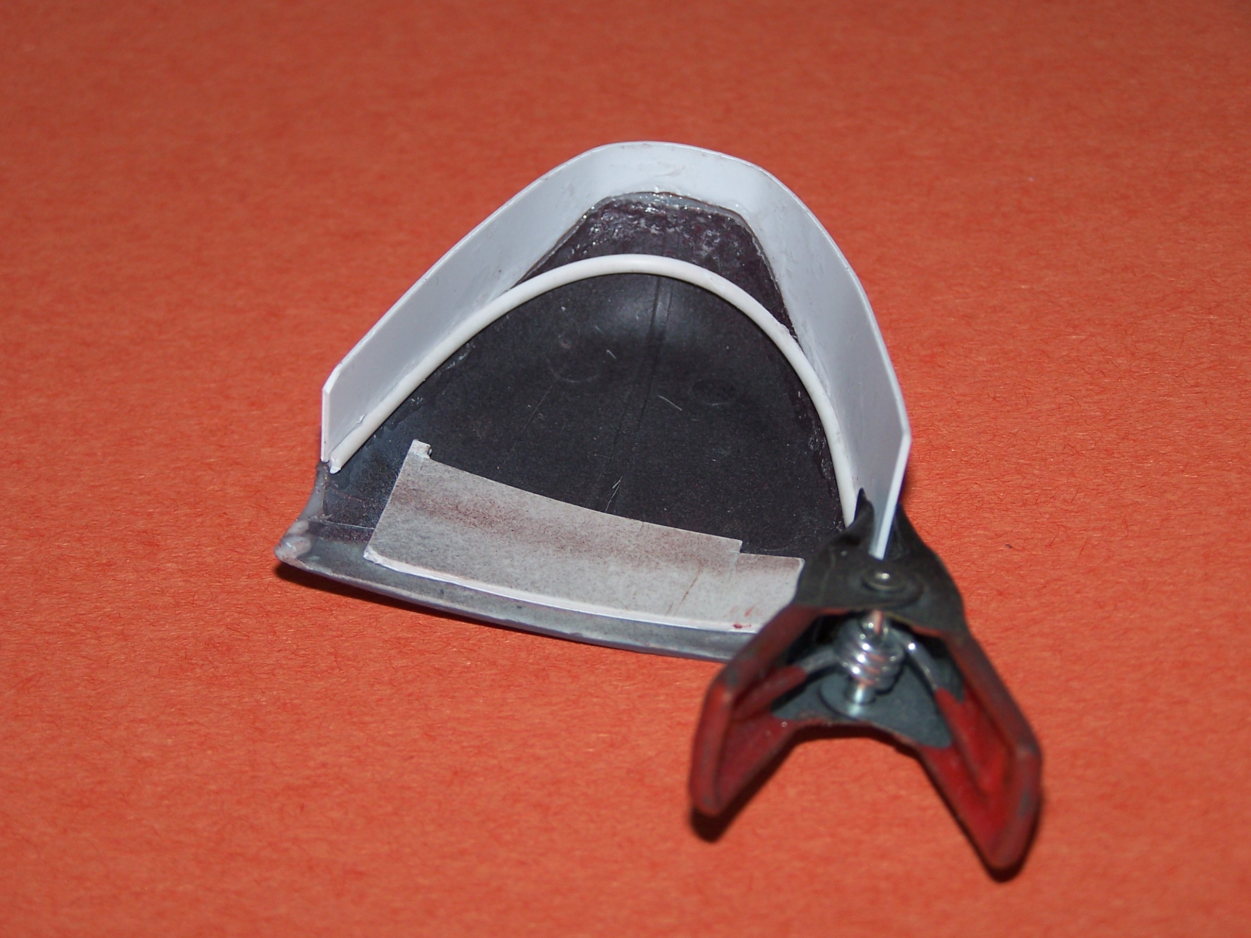

Farmboy Posted July 22, 2017 Author Posted July 22, 2017 Here it's just about ready for some finish sanding on the joint and you can see that the side piece is being taken down gradually to match the curve in the rear of the car. A paper profile will be held against this so there is a line to work up to. The difficulty will be adjusting the profile just right so the whole rear section has a correct slant to it. The side begins where the white piece stops. Comments and observations welcome.

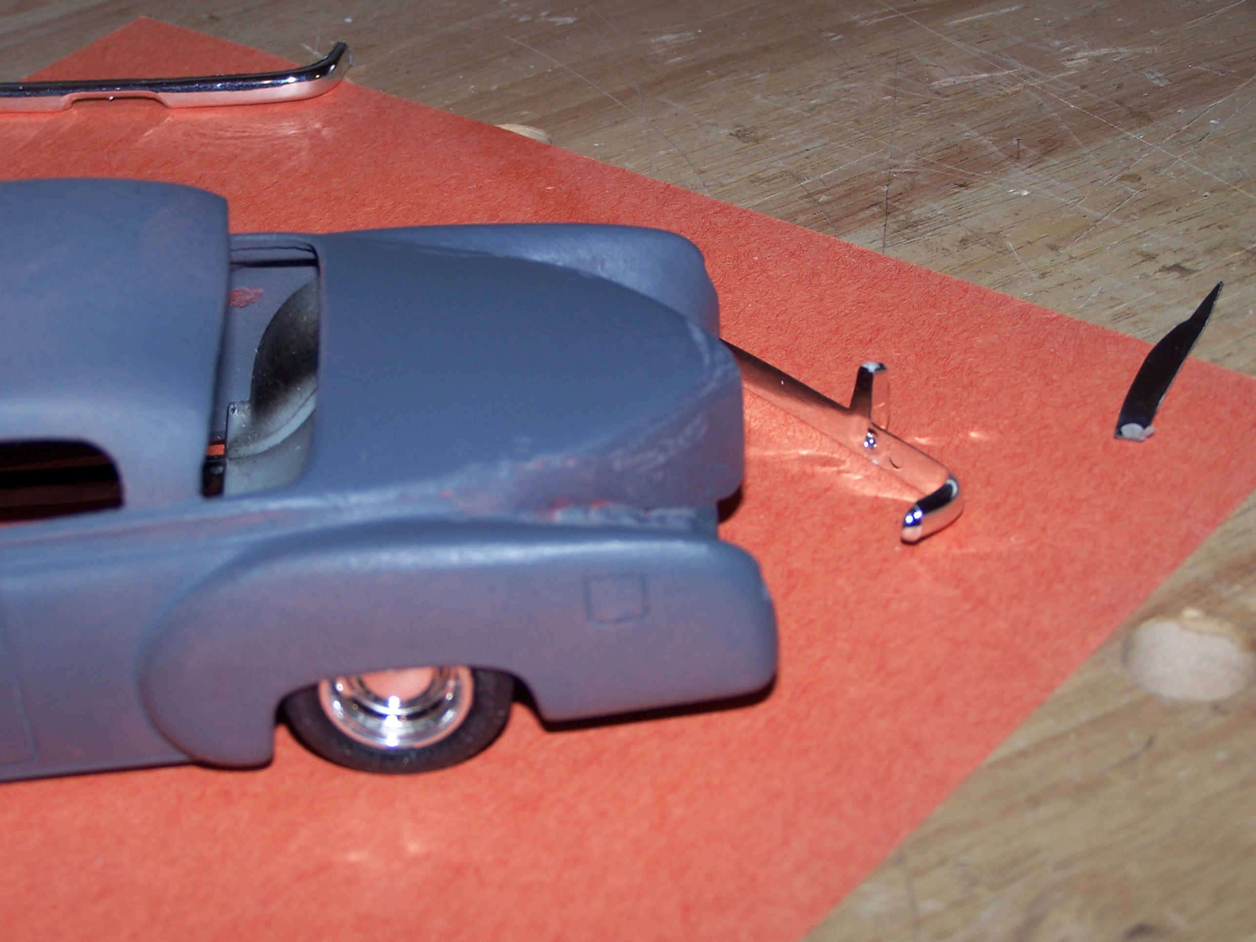

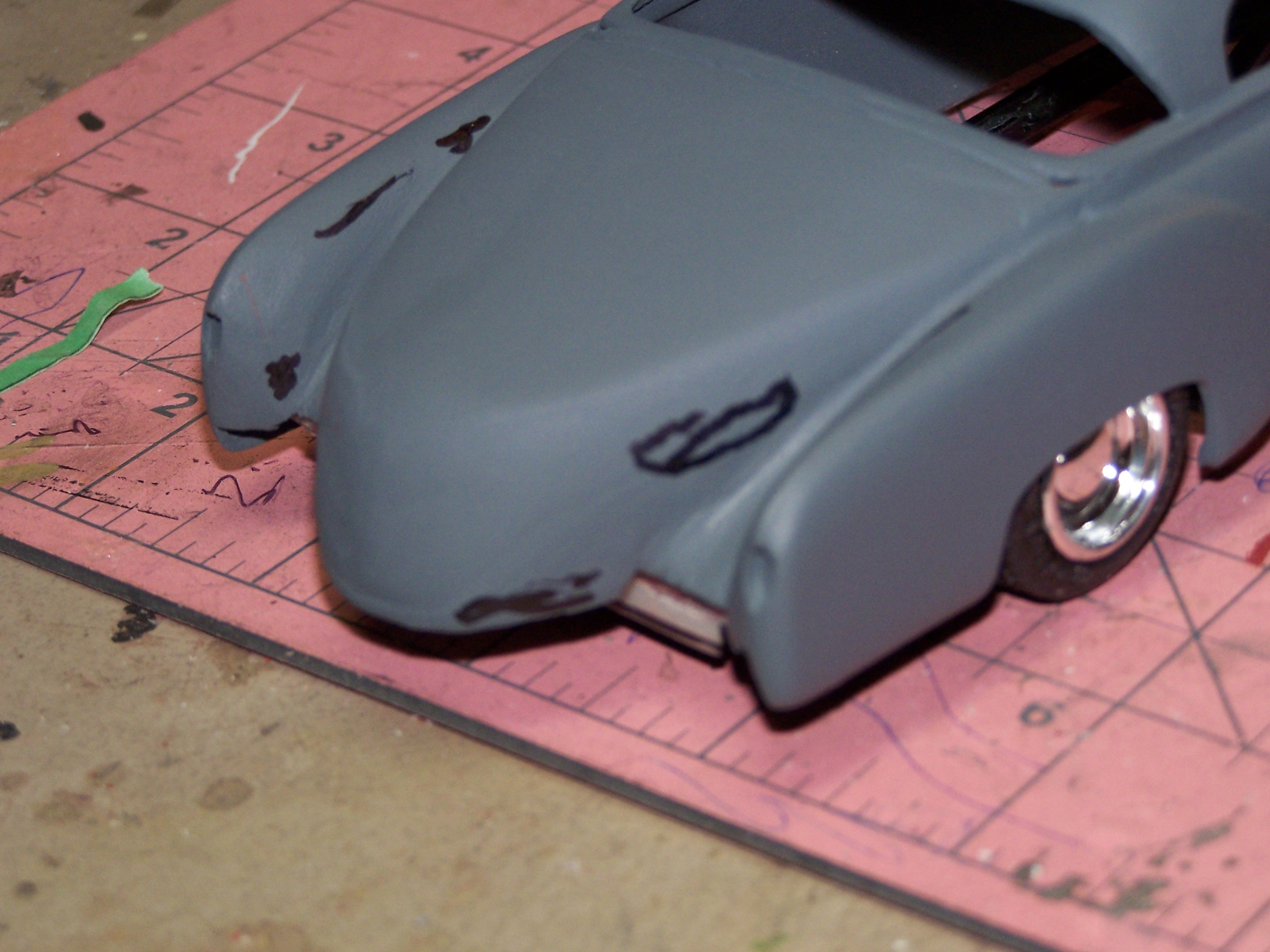

Farmboy Posted July 28, 2017 Author Posted July 28, 2017 Here's the rear end with it's first coat of primer. Lots of shaping to do yet. I've put black marker spots and squiggles where extra filing is needed to bring things in to shape. Lots to go yet but it's a start. I'll be waiting a few hours before I continue. The primer is dry to the touch but not cured and would just gum up my files to start working now. You needn't ask how I know that. Again, autofocus is not my friend. Comments and observations welcome.

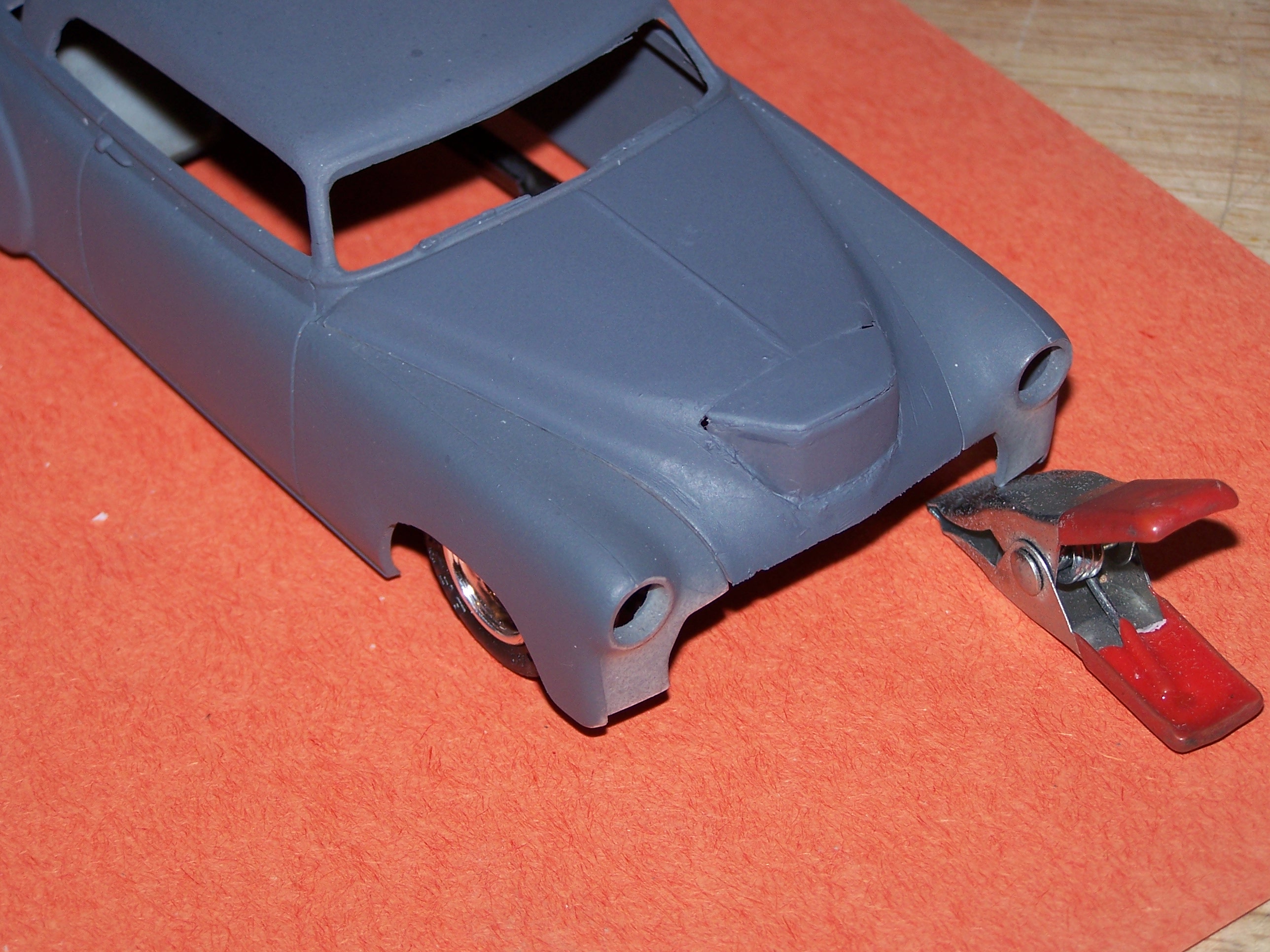

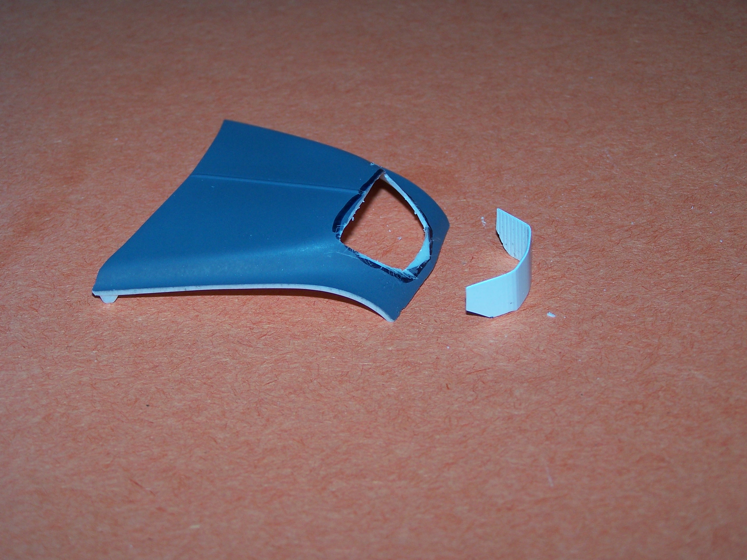

Farmboy Posted August 13, 2017 Author Posted August 13, 2017 While the back is going thru a final shaping and finishing sanding, thought it would be a good time to start nosing the beast. I've not done this before so here goes. After a bit of thought, I marked out the section I think will give max impact with minimal work. .....and after playing with construction paper, I cut a shape that will sort of fit in the opening it's important to note here that the vertical piece is not as high as the top of the hood as there is another piece that will be glued to it to form the top and then faired in. Here's the no lookin' back stage. The hole, the vertical filler. Note that the whole operation is to get the front of the nose vertical while maintaining the original body line of the hood.. more to come. Comments and observations welcome.

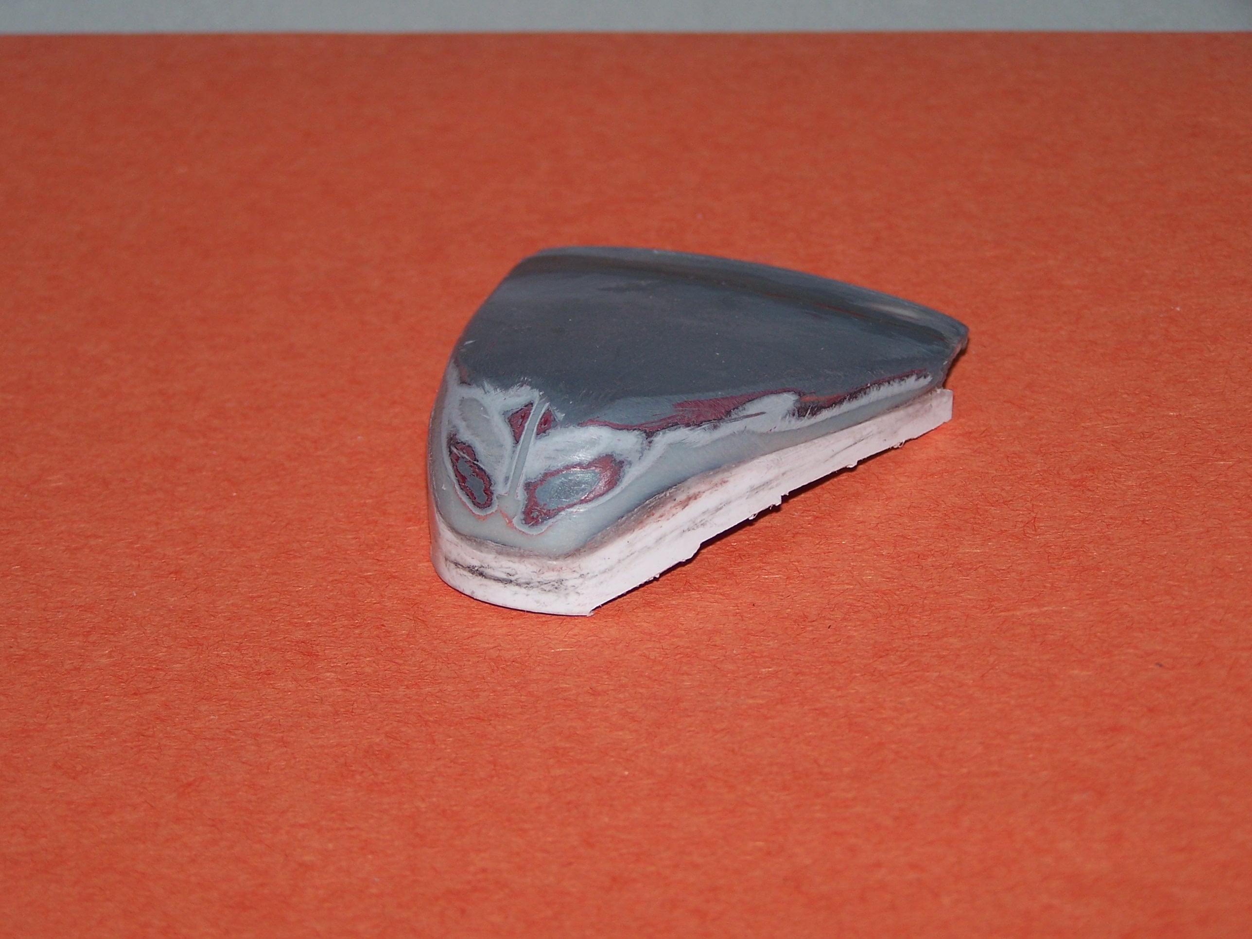

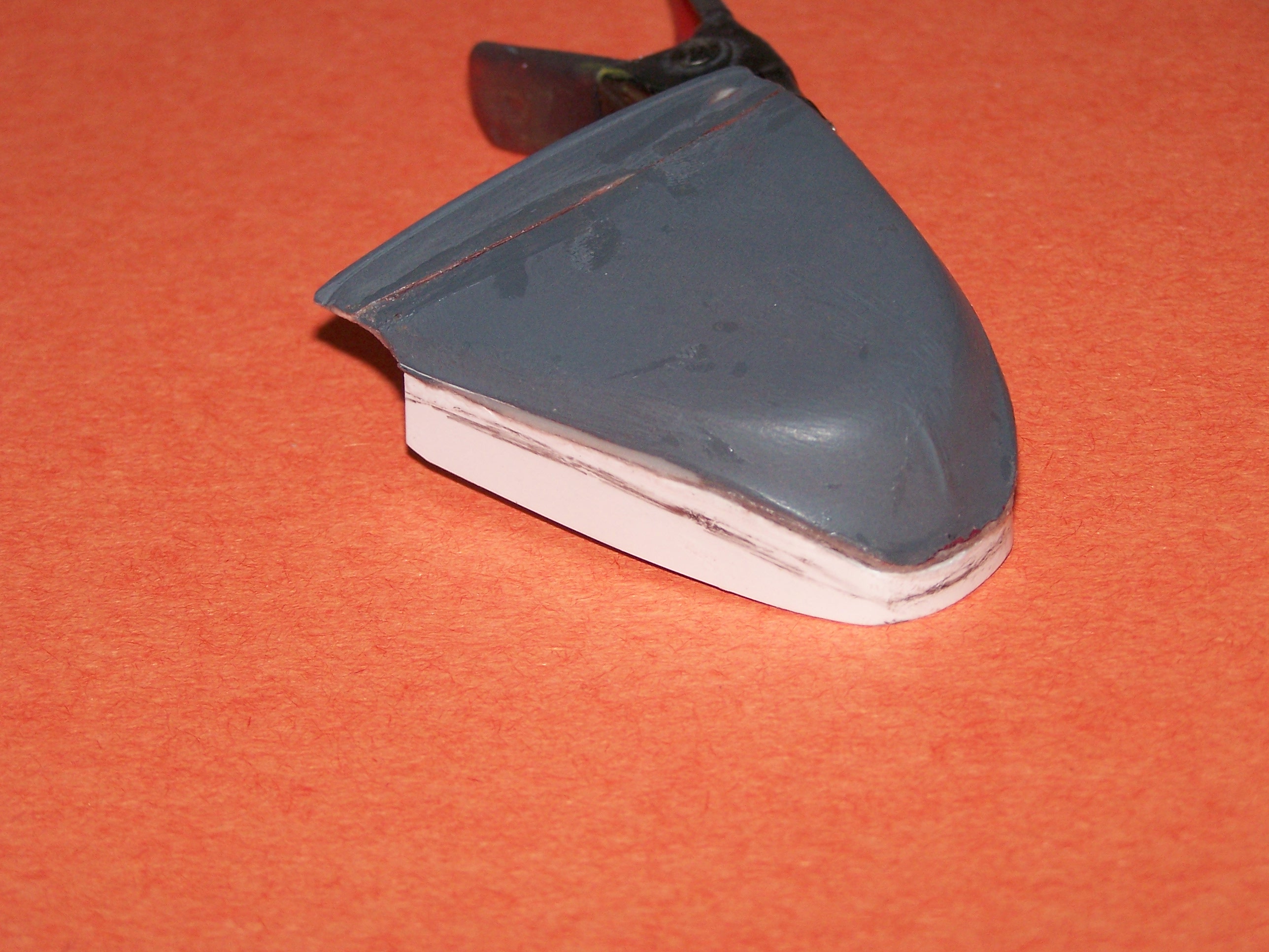

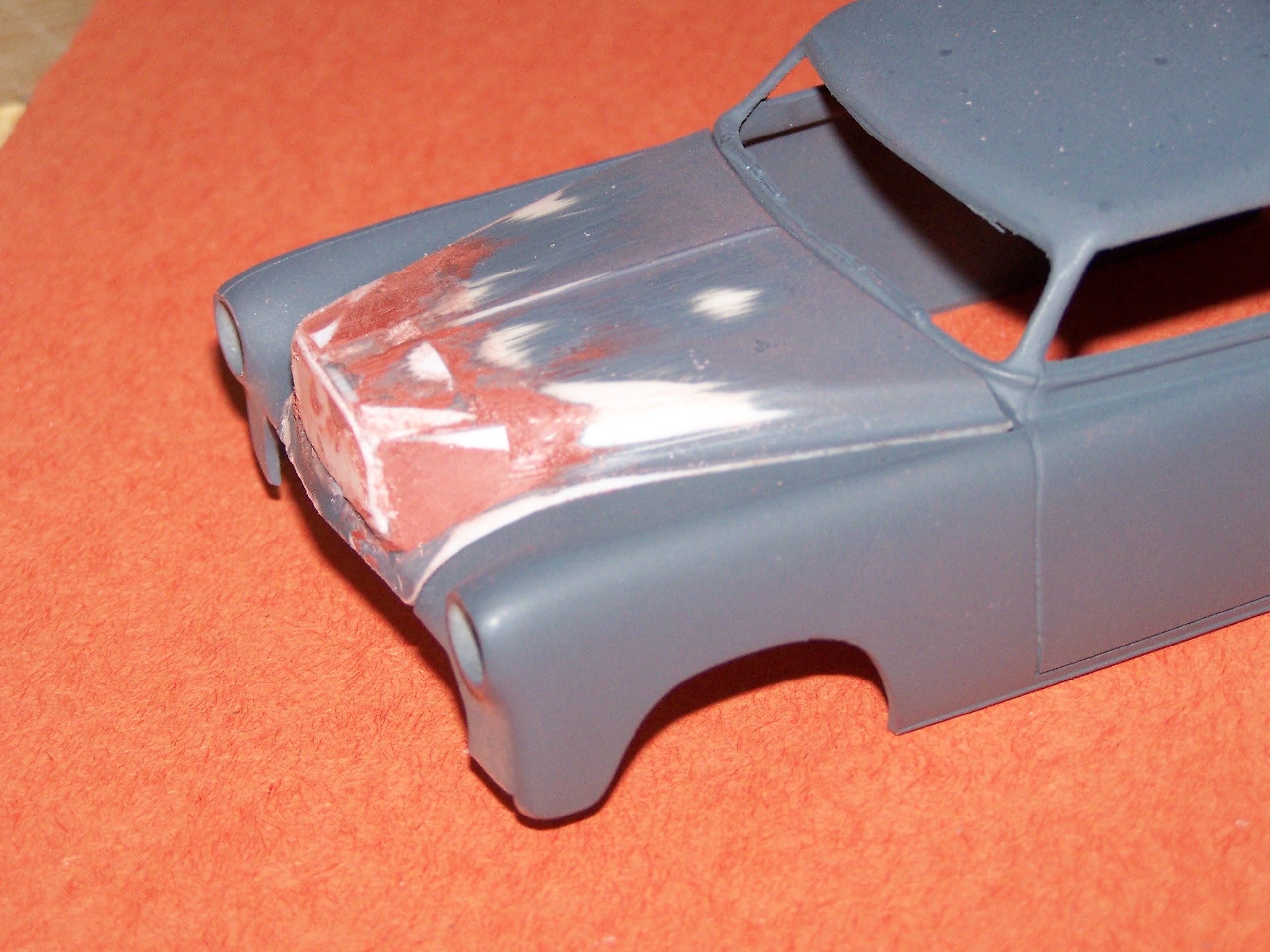

Farmboy Posted August 16, 2017 Author Posted August 16, 2017 onto the nose.... Quite a bit of changing and adjusting since the last pic of the section removed from the nose. It's been widened a bit in this shot... ...and after a quick primer coat to better see the lines, it wasn't wide enough for me ...so I widened it a bit more, readjusted the hood line and now it's more like I envisioned. lots of sanding, sweetening up the bottom piece, and more sanding and forming to do. Comments and observations welcome.
Farmboy Posted August 18, 2017 Author Posted August 18, 2017 (edited) Still in primer awaiting minor touchup and finish sanding but for all intents and purposes, finished. One nose....nosed. Comments and observations welcome Edited August 18, 2017 by Farmboy

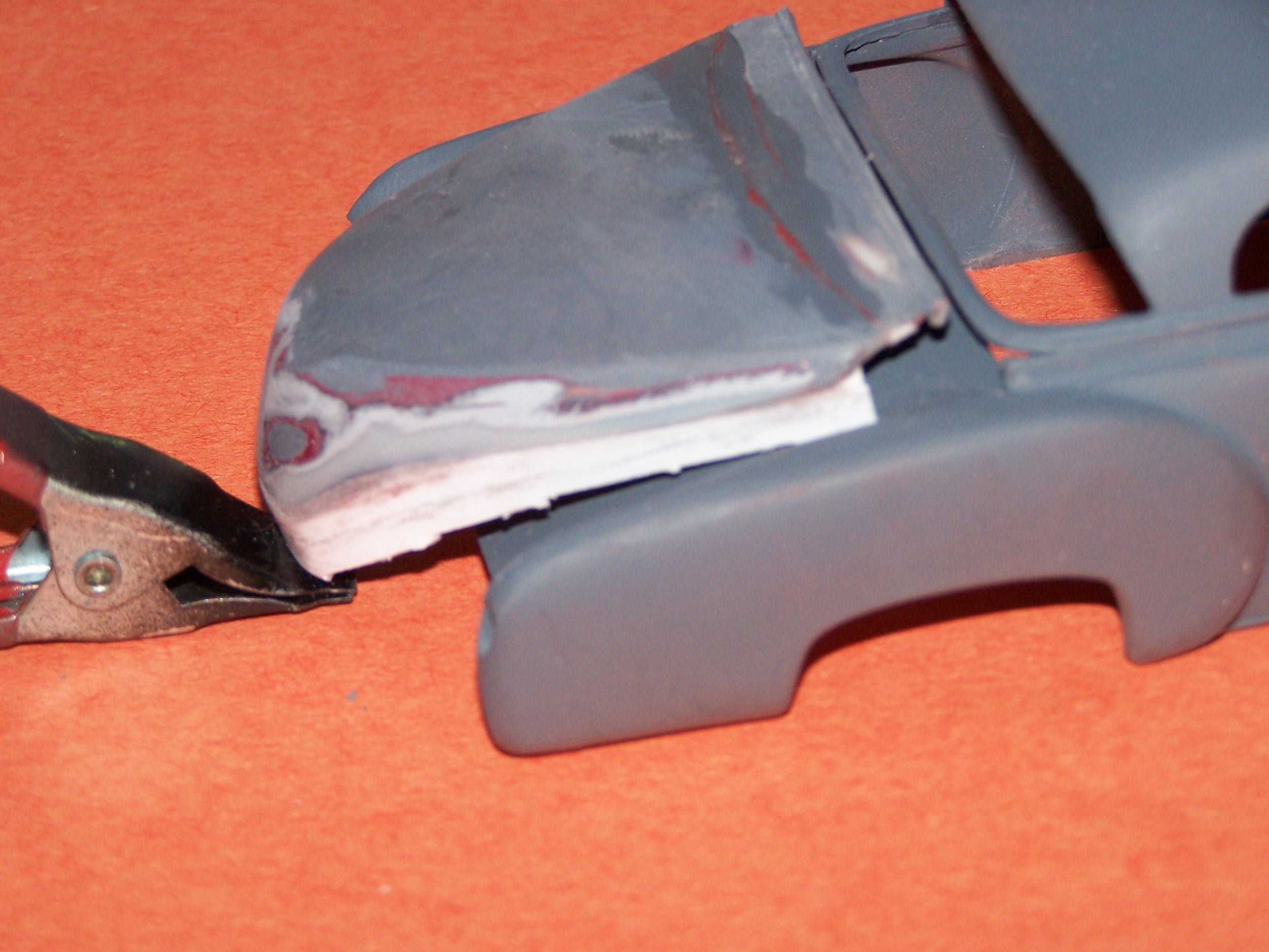

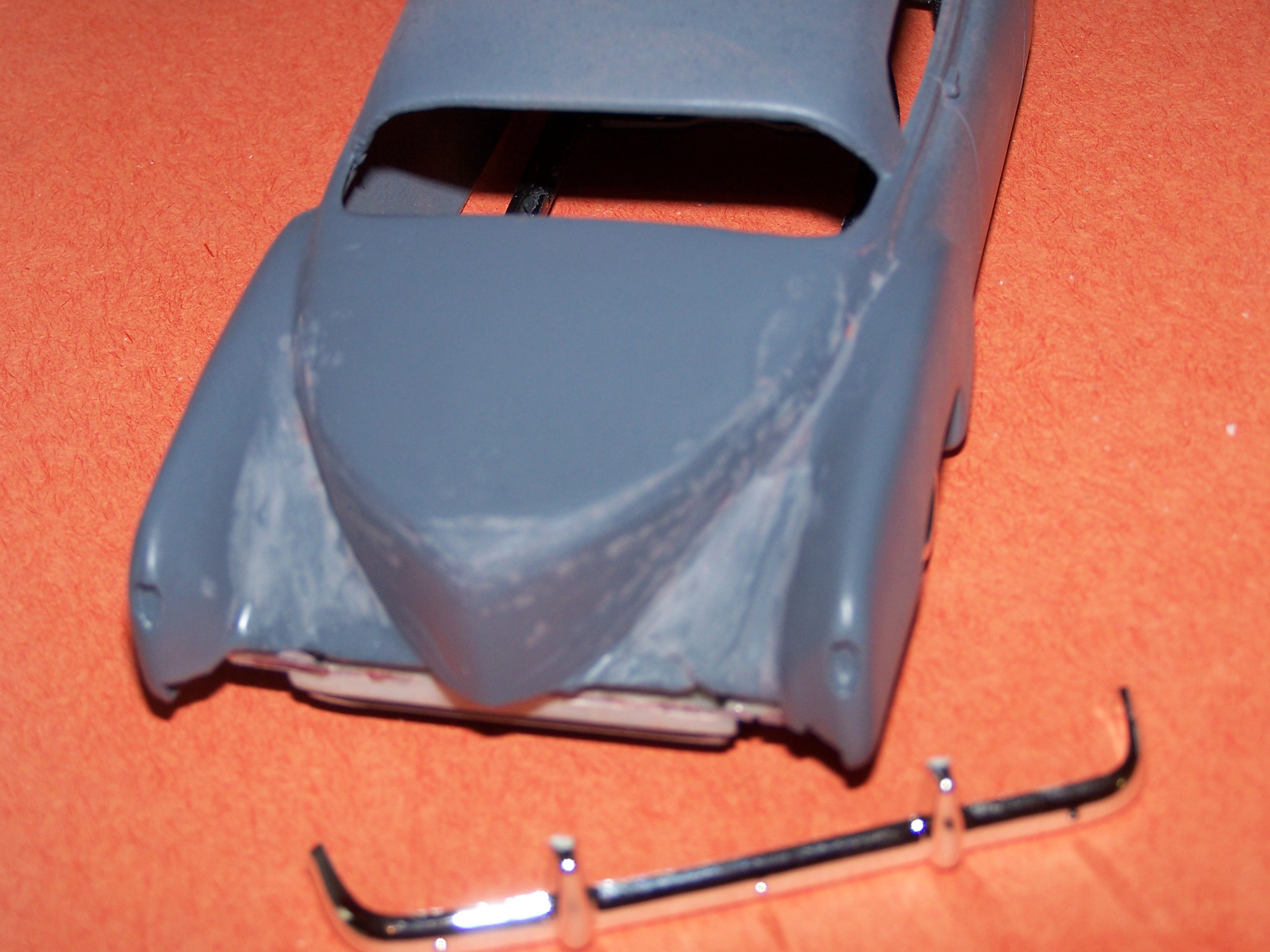

Farmboy Posted August 19, 2017 Author Posted August 19, 2017 ....and yes dammit, the back WAS too big. Out came the Dremel and razor saw and here's what I ended up with. I saw a post on here with an Auburn Speedster and that is the look I was after. For better or worse I shortened the back, changed the angle of attack and made the sides more 90 degree than I had them. Not sure if I like it or lot, but I will finish it! These are after primary sanding... \ Comments and observations welcome
