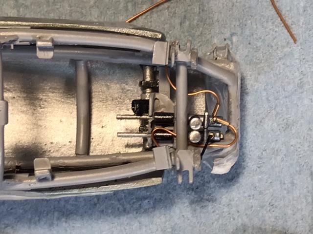

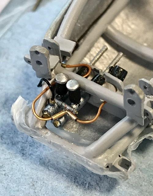

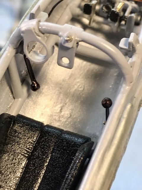

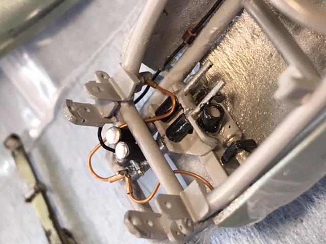

TMF sells some coated copper wire That is useful for brake lines. Very soft / bendable - which is helpful in this scale ...
The right hand cylinder has a splitter made from brass tube  the brake lines go left and right to the front brakes. The shielded brake line on the left cylinder travels back to the rear brake ...  by the way. Not sure but I may have reversed this ...

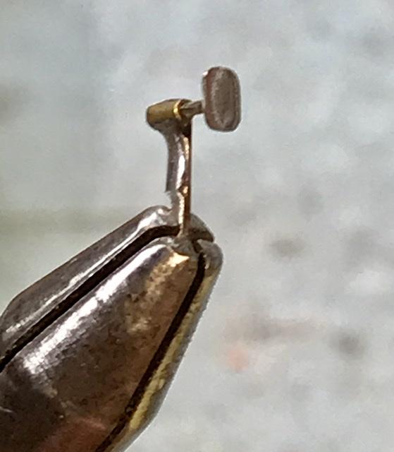

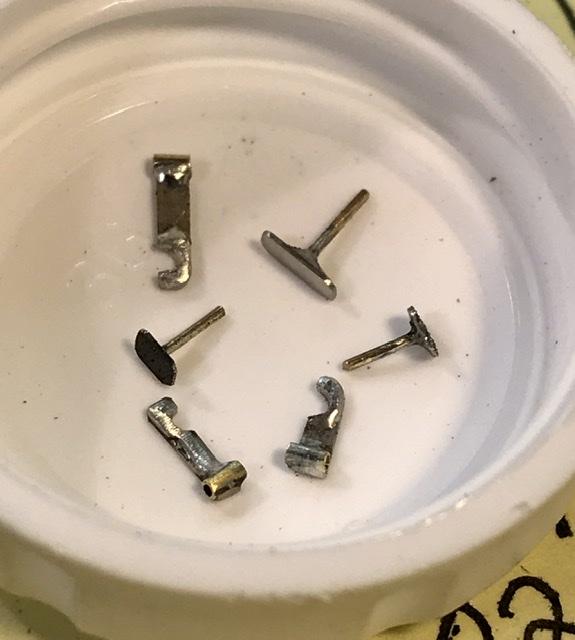

3 pedals made of nickel bar
and brass tube - brake in the center. - clutch to the left  and gas to the Right .  Have a good look. These will disappear under the gas tank in due time ...

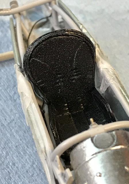

The seat has languished on the workbench for some months ...  finished the seat cushions and painted black with some textured
paint -  might flatten the finish a little -
not sure ...  ...

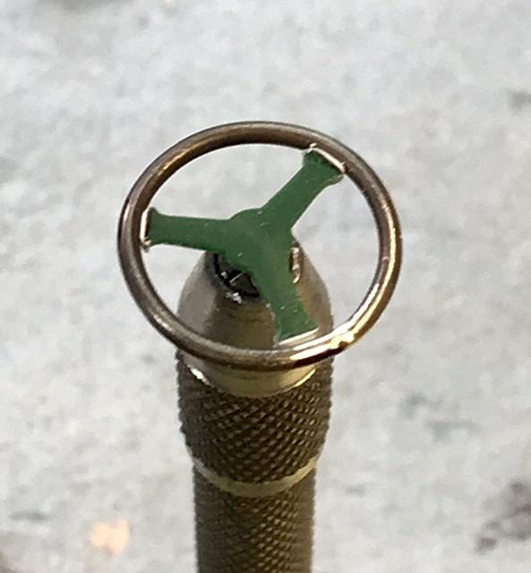

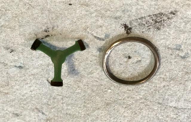

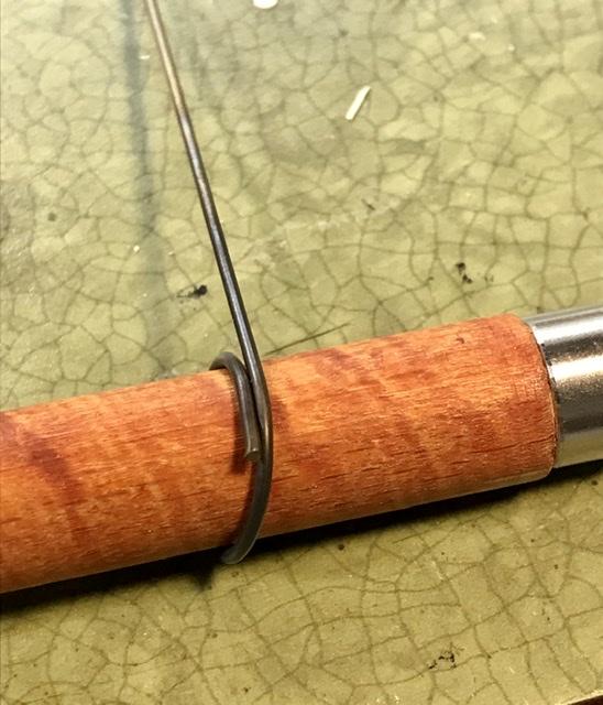

If you travel back in time to about April - 2? Page back...  you’ll see photos of the Merit kit steering wheel - which isn’t too accurate - I’ve stolen a steering wheel from Merit’s Lotus 11 kit - cleaned up and thinned the center spokes  -  and re-made the steering wheel with heated - formed - nickel silver.

Amazon. Cheap and easy - do a search for nickel silver rod assorted widths. My set has about 30 lengths of nickel silver ranging from about .020 to about .080 ??  Post me back if you don’t see it ...

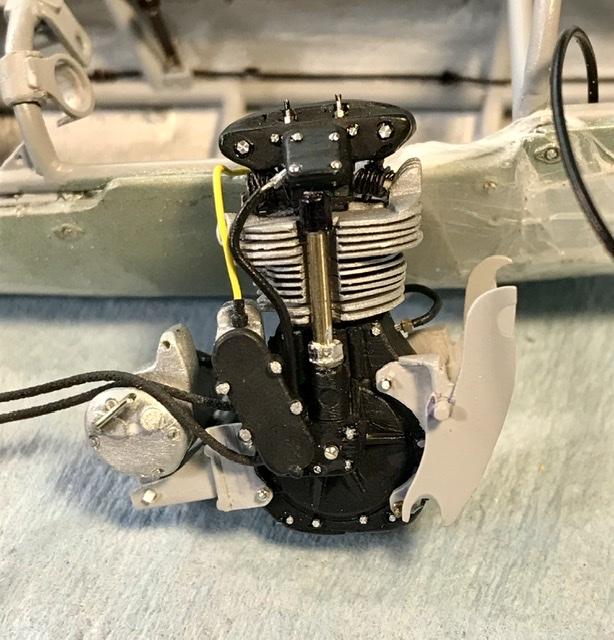

There is a fluid overflow container perched against the frame in the engine bay. I’ve glued it in here because its time (past time) to do the engine install and I won’t be able to mess with the container once this is done...

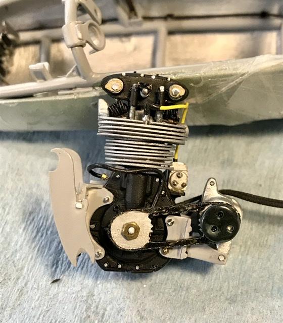

Now the engine - the gear case is attached to the engine braces and the crankcase oil lines are added before the installation - along with the crankcase/gear case chain drive

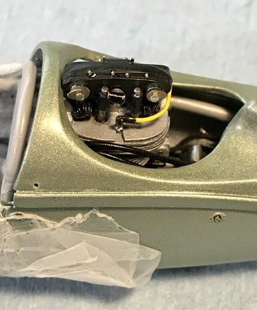

In it goes - clipped to the frame members by the notches in the braces.   Does the engine cover fit properly over the cyl head - of course not!  Why ?  Because :         A:  I think the engine should sit about a scale inch farther back in the frame - but I didn’t have enough technical info to help me sight the engine precisely.
B:  Also the engine is installed at a
 Slight tilt back and my engine does not tilt quite enough ...
but that’s okay - I’ll just shave some material on the engine cover and I’ll be able to open the cover without interference from the leading edge of the cyl head ...
By the way. I’ve not yet installed the carburetor assembly. This sticks out from the back of the cyl head. Which is why there is a large opening in the engine cover behind the cyl head.

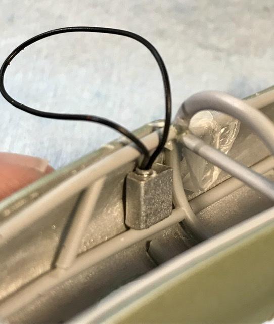

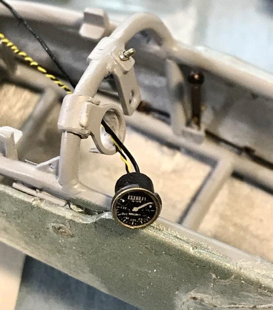

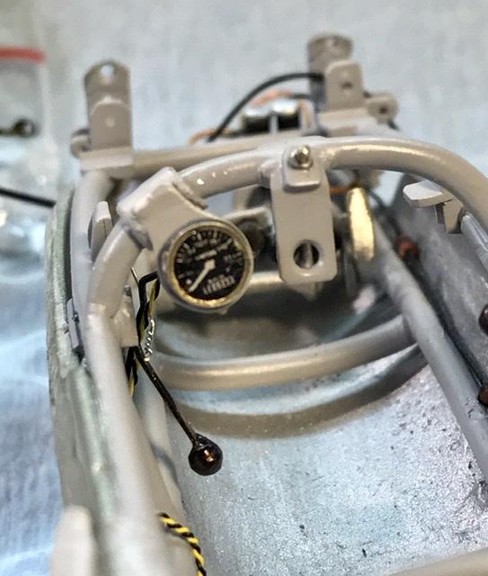

Before finishing the steering wheel I’ve installed the tach wires and glued the tach into its housing. The tach line runs back to the cyl head - the electrical wires - well I don’t really know where they go - so I’ll just bury them under the seat. -  don’t tell anyone ...
