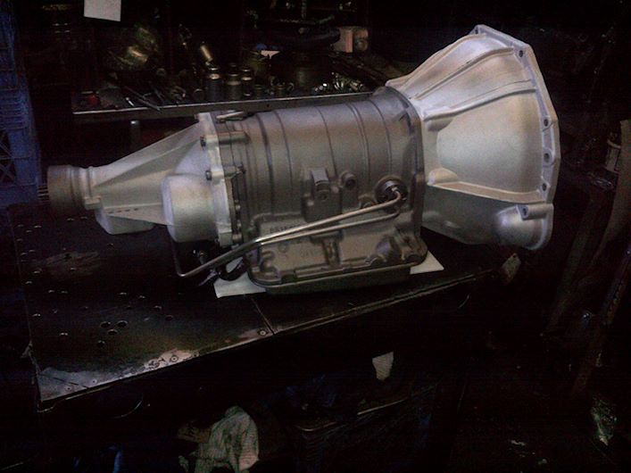

Below, a real 1962 Pontiac Hyrdamatic "Slim Jim" (I think):

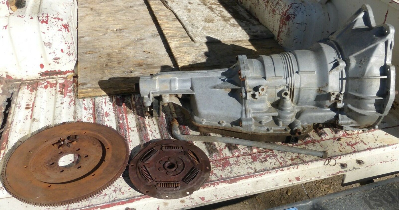

Next, the Oldsmobile Hydramatic "Slim Jim" (I think):
