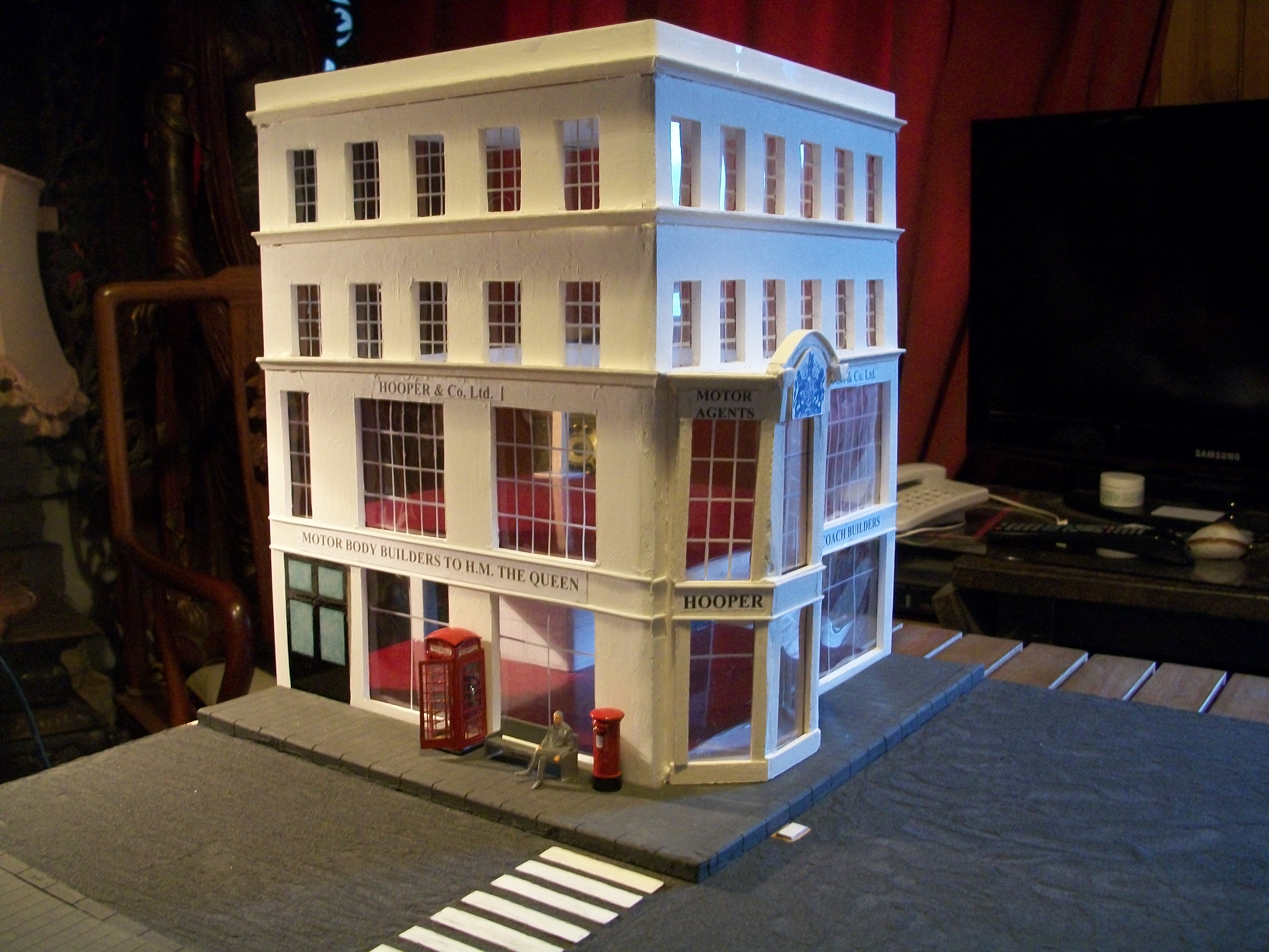

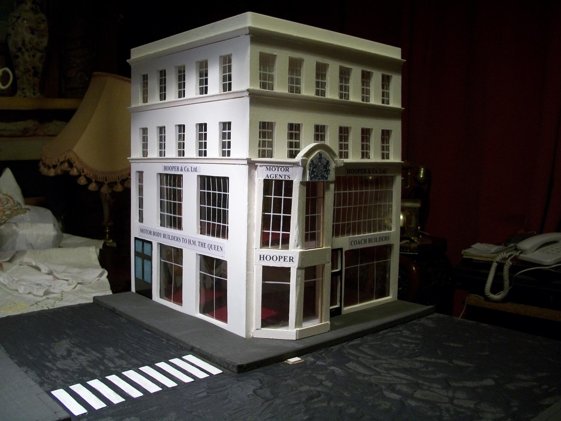

landman Posted March 22, 2019 Share Posted March 22, 2019 Classy building, sir. Quote Link to comment Share on other sites More sharing options...

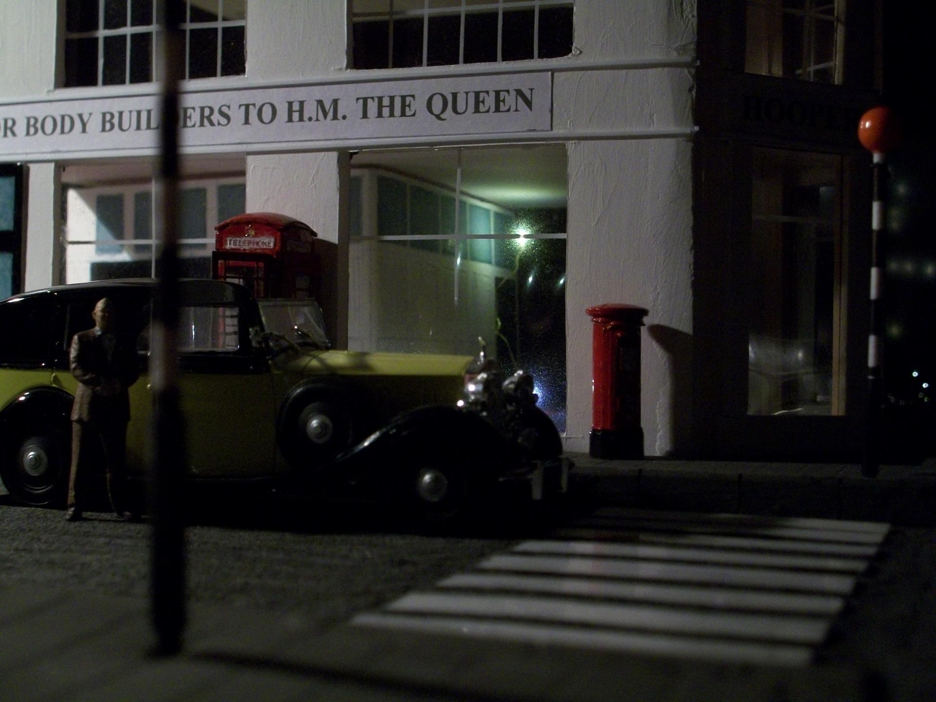

QbanFam Posted March 22, 2019 Share Posted March 22, 2019 Amazing lighting effect. It sort of looks like your windows have raindrops, or it’s snowing outside. Quote Link to comment Share on other sites More sharing options...

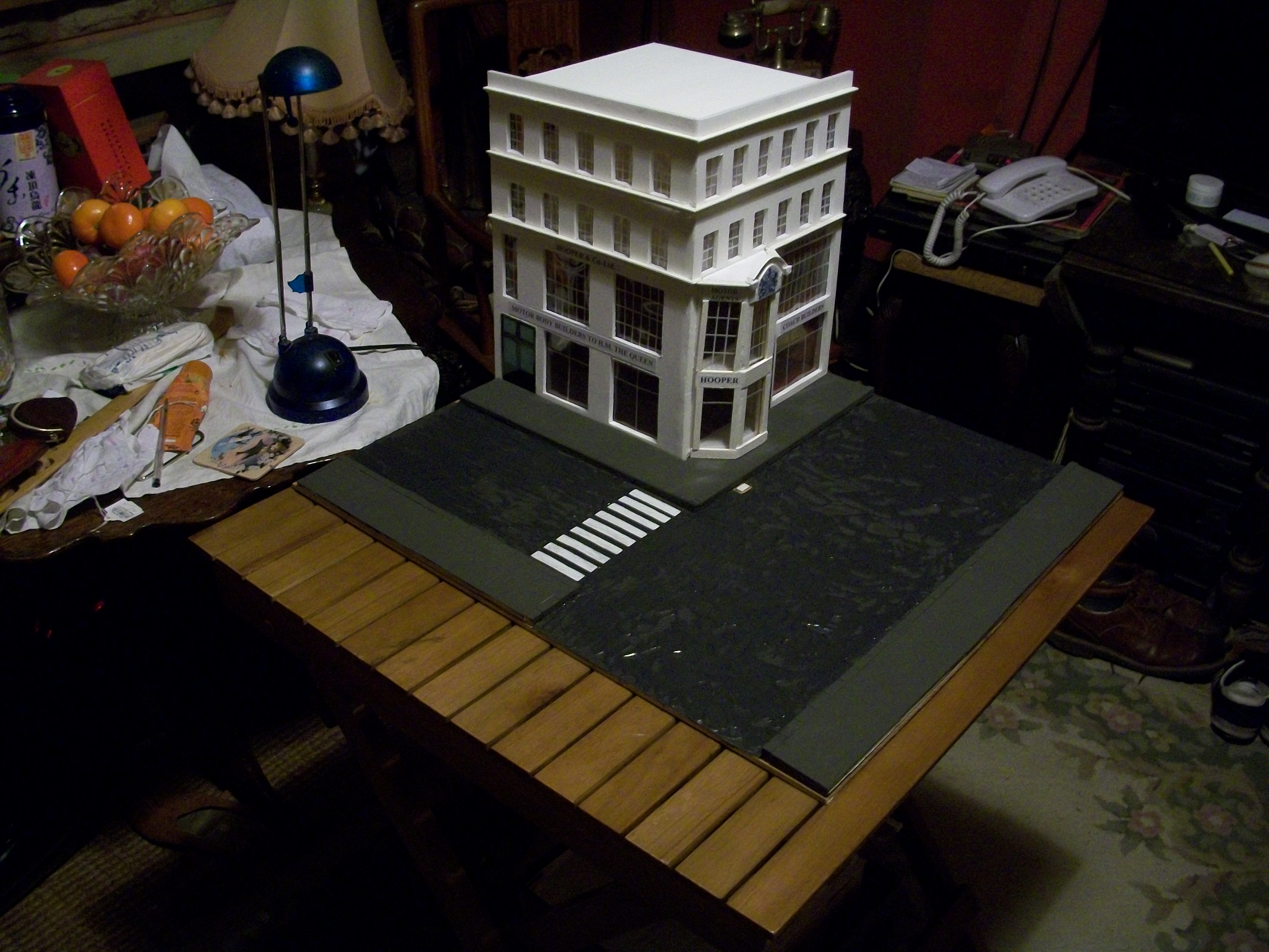

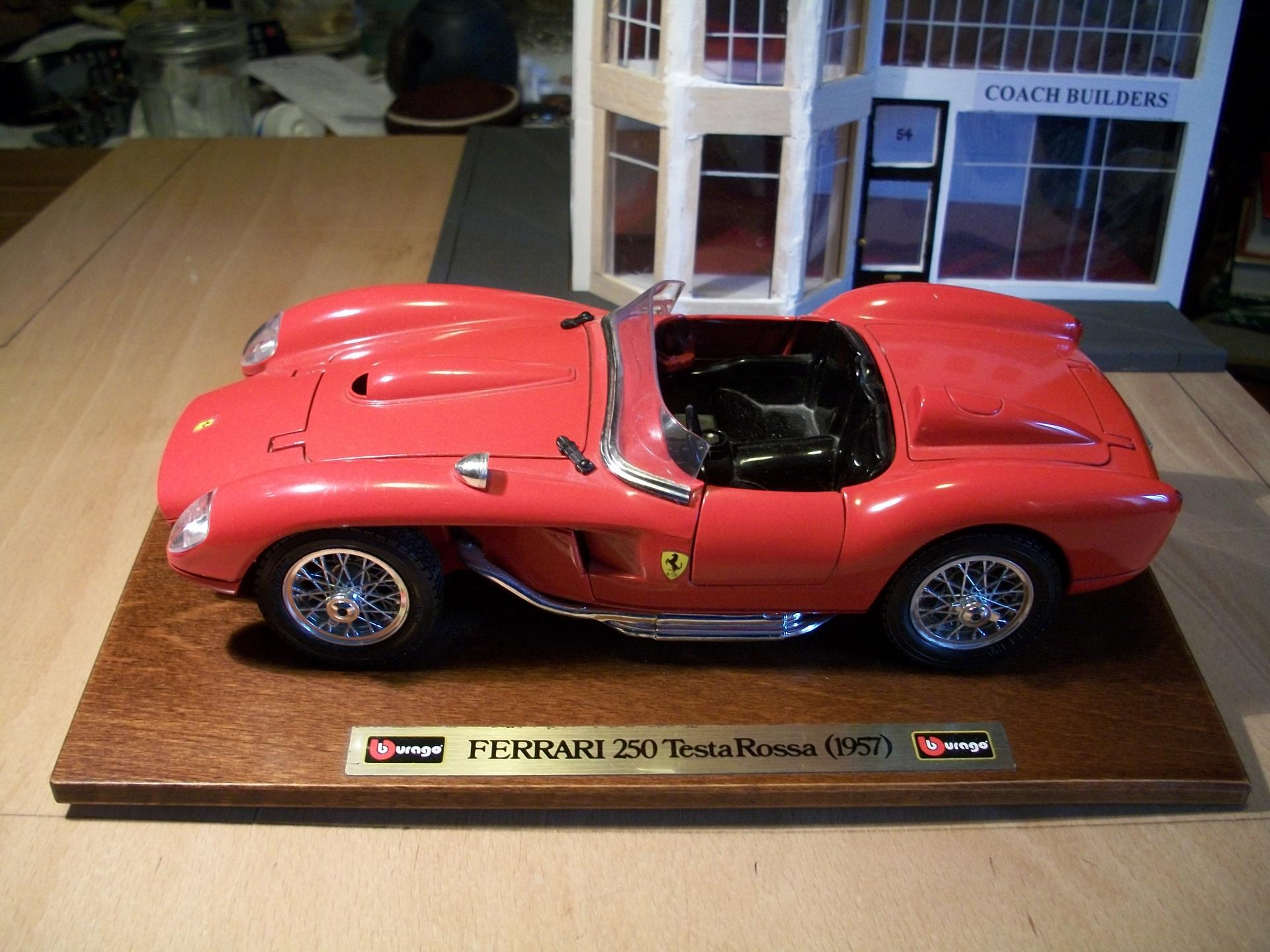

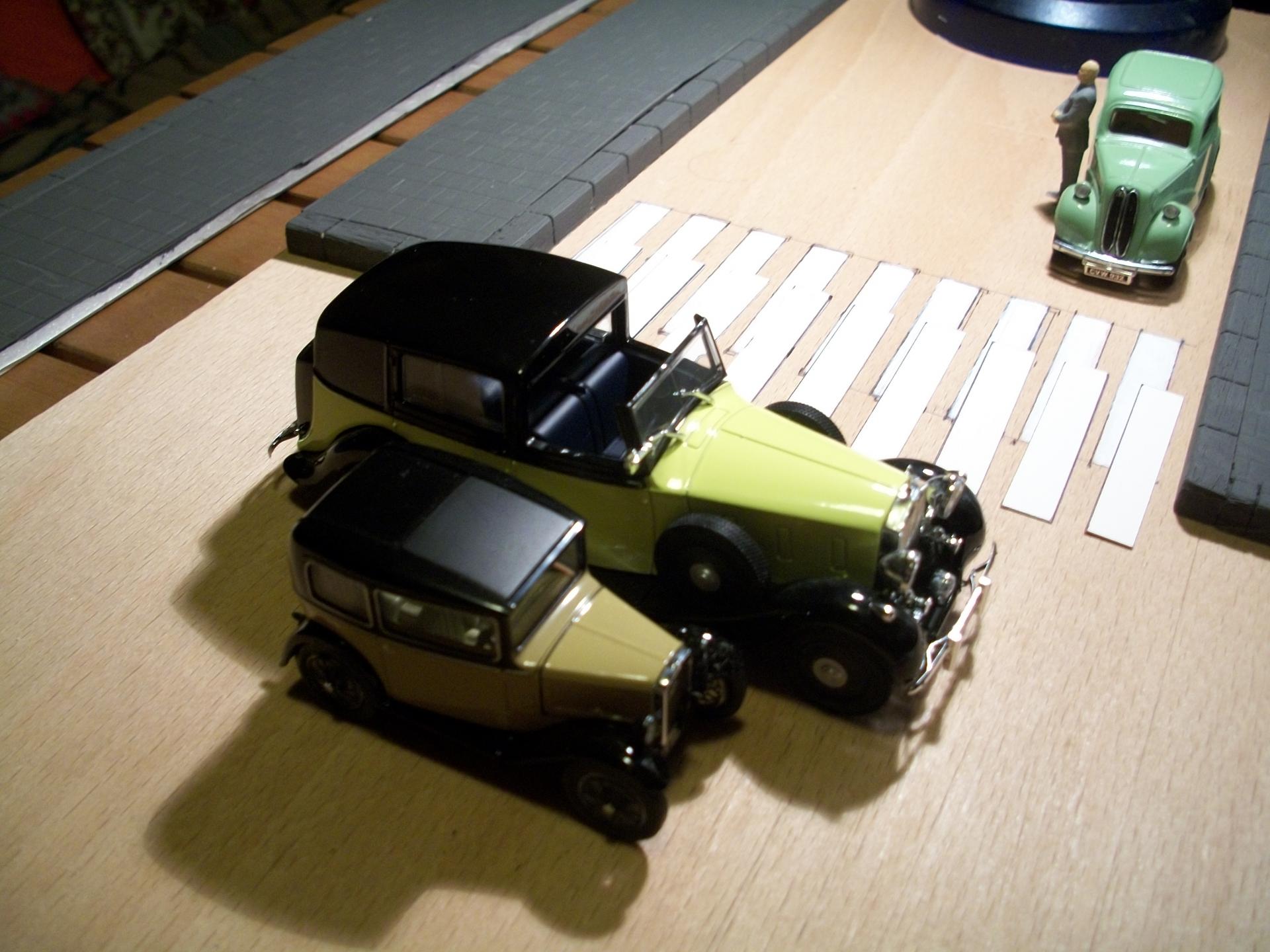

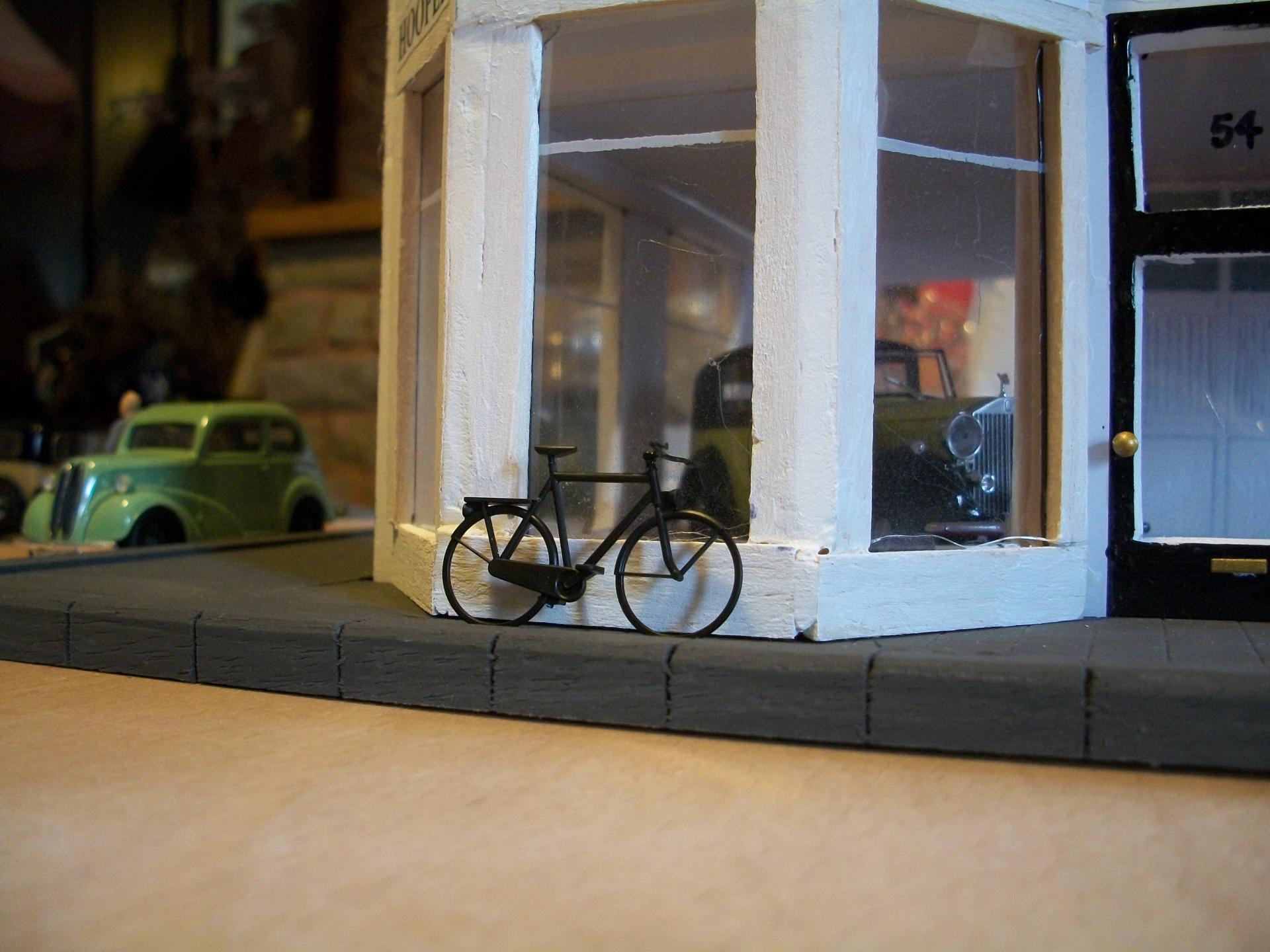

Anglia105E Posted March 23, 2019 Author Share Posted March 23, 2019 Thanks Pat and Yordan.... that was the first thought that crossed my mind when I saw the effect on the windows, which does look like raindrops. It is probably the light catching the dust! Here are a few photos of recent work on the diorama. One shows the difference in size between the Austin 7 and the Rolls-Royce Phantom III, while another photo shows the 1:43 scale bicycle which will look quite good once it is painted and chromed. Two further photos show the coving, which has gone into place quite nicely. Only today, and after 2 years constructing these two Hooper buildings, have I realised that the coving runs along the top edge of the roof level, so there is actually a low wall above the coving! The wall will finish off the proportions of the building nicely.... can't think why I never noticed this before. David Quote Link to comment Share on other sites More sharing options...

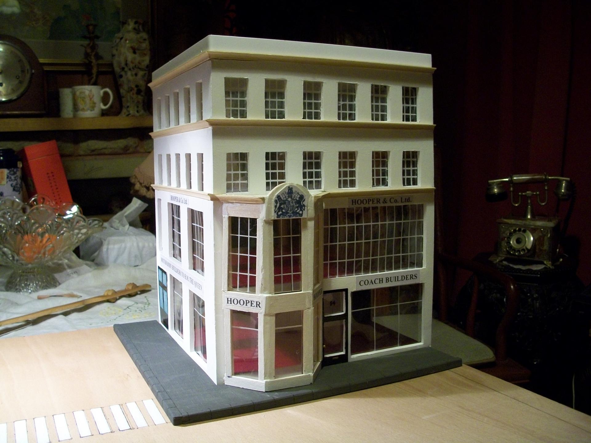

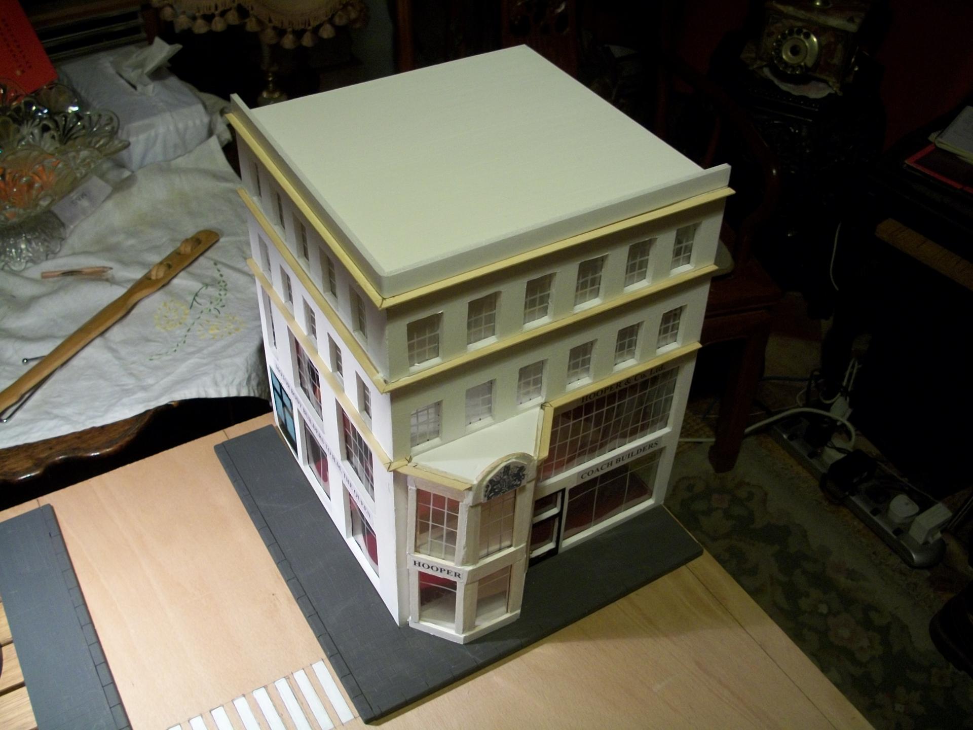

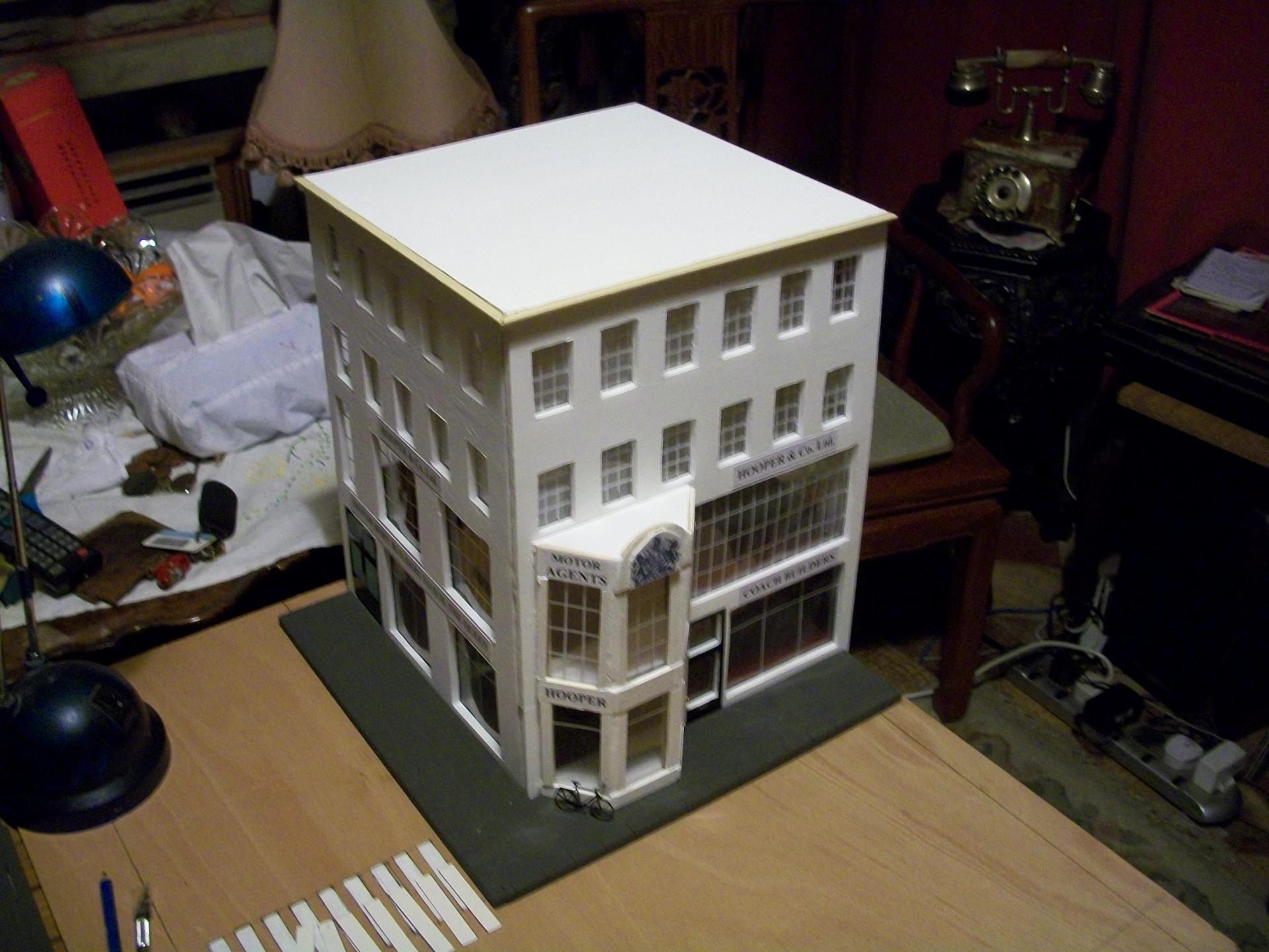

Anglia105E Posted March 25, 2019 Author Share Posted March 25, 2019 There are now three levels of coving in place, with only the curved section to make. I shall have to give this curved section some serious thought, as it will not be easy to fabricate, given the ornate profile of it. All the straight pieces are of wood, but this curved piece might have to be clay or foamboard, not sure yet. The small gap that ran from the ground level at the outer corner all the way up to the roof has now been filled and sanded. The coving will be painted with white acrylic gesso, to blend in with the surrounding areas. My feeling is that this building is becoming stronger in construction, and also taking on the appearance of the real building, which is proving to be quite rewarding at this stage of the project. Hope you like it, and thanks for looking! David Quote Link to comment Share on other sites More sharing options...
landman Posted March 25, 2019 Share Posted March 25, 2019 David, it is indeed looking very realistic. As for the curved cove, if you have a router, take a piece of MDFthe width of the gap between the angled coves at the top of the bay entrance, sound the end with a jigsaw to match the arc at the top, run it on a router with a bit of the same profile as the coves, then cut out the strip using the jigsaw. That is if you have those tools of course. I also like your telephone. Used to have one sort of like that. Quote Link to comment Share on other sites More sharing options...

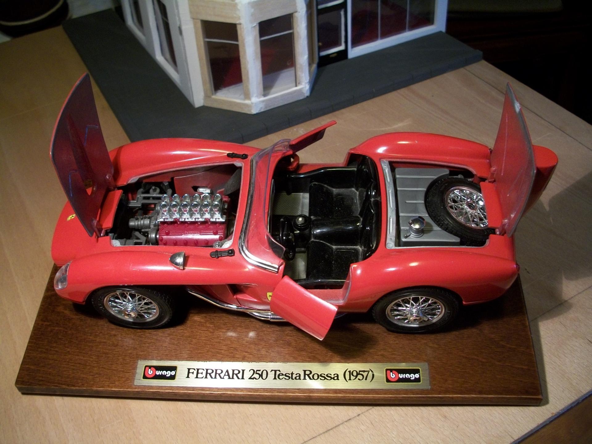

Anglia105E Posted March 25, 2019 Author Share Posted March 25, 2019 Thank you Pat..... the antique telephone is one of the many items that my wife picks up when she is visiting the local charity shops. She returns home with all sorts of surprises, one minute it could be an antique telephone, the next it could be a 1:18 scale Ferrari 250 TestaRossa on a mahogany wooden base, or even a Mamod steam engine ! Although my toolbox does not contain a router or a jigsaw, these are tools that I was considering investing in at some point. I am reading your explanation how to make the curved section of the coving from MDF, but somehow my brain doesn't work in such a way that I can follow your method..... could you put it into different words, or possibly a pencil sketch? Please excuse my lack of joinery skills ! David Quote Link to comment Share on other sites More sharing options...

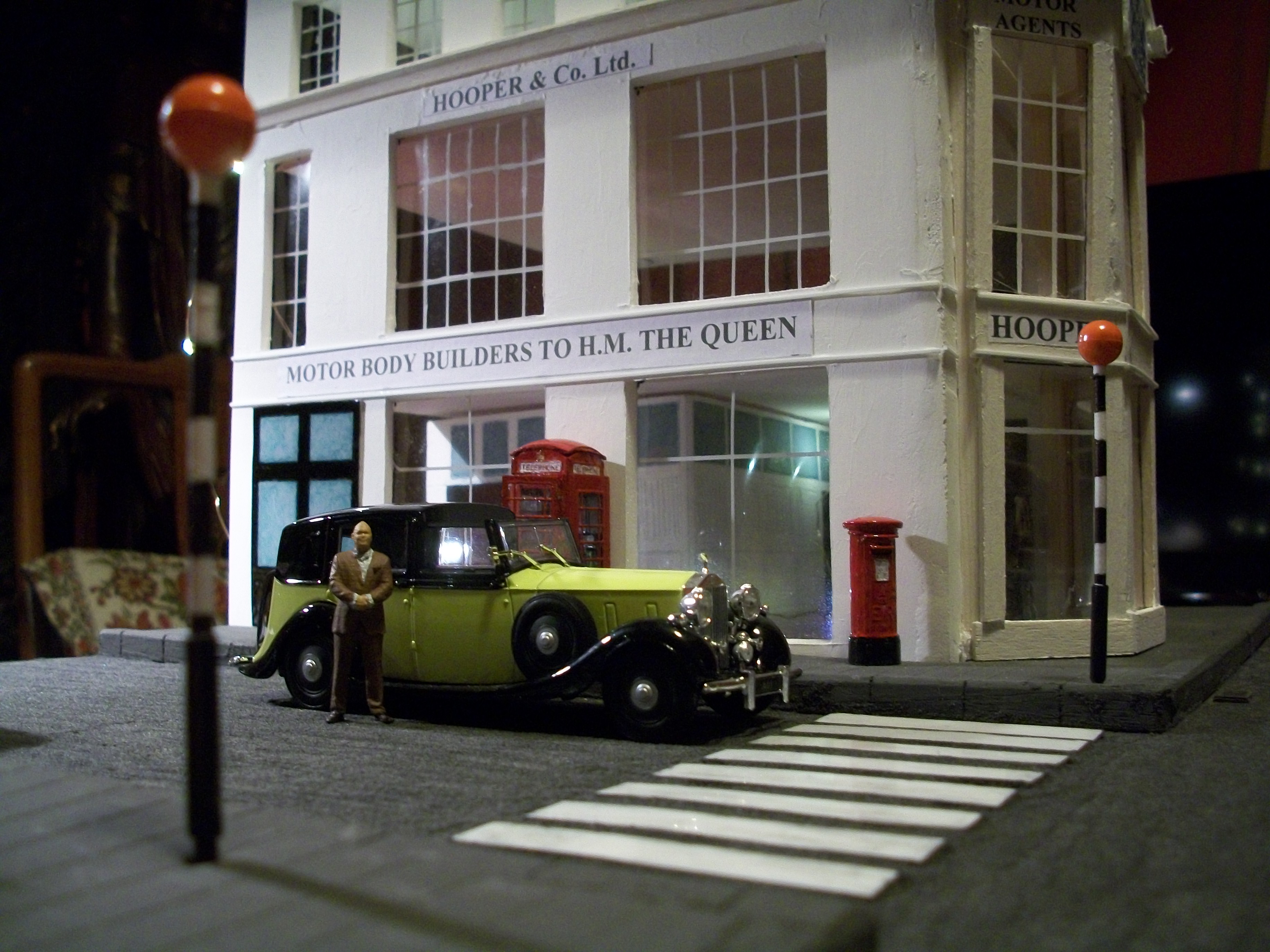

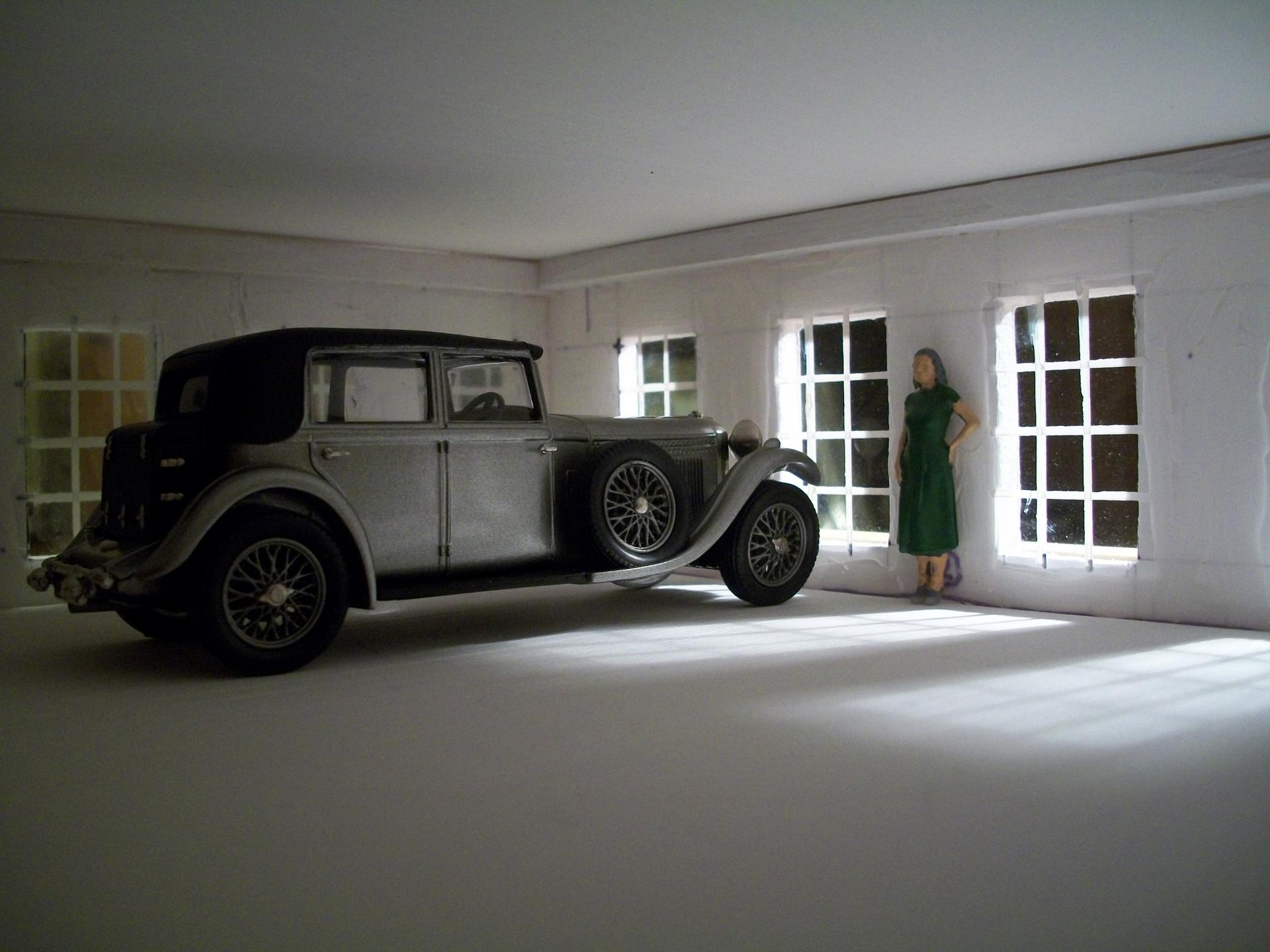

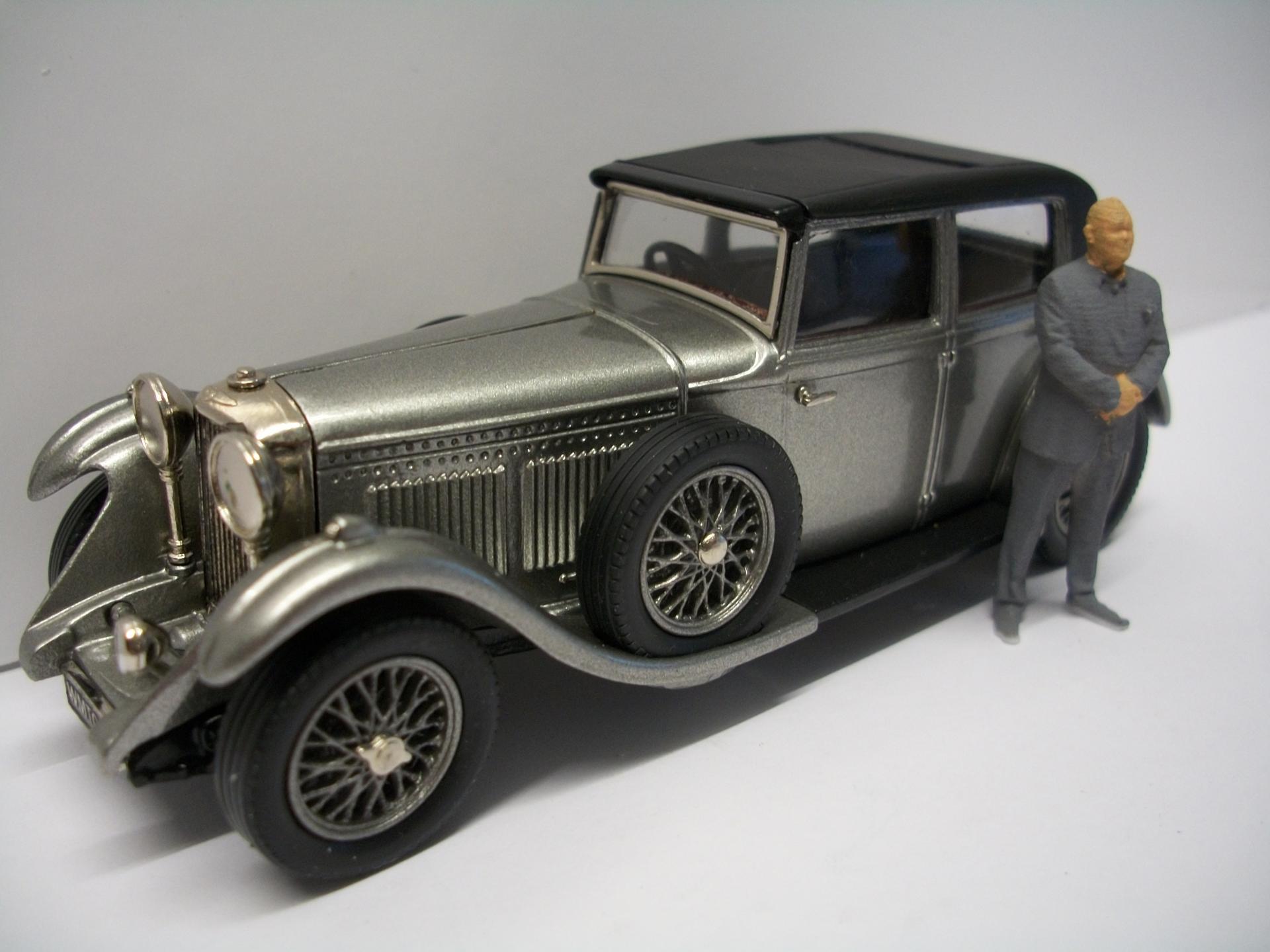

Anglia105E Posted March 27, 2019 Author Share Posted March 27, 2019 The 1:43 scale Hooper & Co showrooms have three Rolls-Royce motor cars, also two Daimler motor cars and now the single Bentley motor car has arrived today. This is a Lansdowne Models white metal 1930 Bentley 8 Litre, which is one of only 125 made and it is very heavy, even in 1:43 scale. In fact it is heavier than the 1:24 scale MG K3 Magnette that I built. This model is of superb quality and it is highly accurate in the detail. The Bentley does photograph particularly well, and it is the star of the collection by some margin. David Quote Link to comment Share on other sites More sharing options...
QbanFam Posted March 27, 2019 Share Posted March 27, 2019 Your vehicles are fantastic. Where do you get them from? I love the classy looks. I’m 39 years old but I’ve always had an old soul. Even as a child. Lol. I play classical instruments (piano and acoustic guitar). I tend to shock people because I’m a Sheriff Deputy (a police officer) in the USA, and they don’t expect theses traits. I learned to appreciate art and classic vehicles. One of my wishes is to visit England and Australia. Quote Link to comment Share on other sites More sharing options...
Anglia105E Posted March 27, 2019 Author Share Posted March 27, 2019 Interesting to hear your comments Yordan...... piano, acoustic guitar, diorama building, Sheriff Deputy, classic vehicles..... you are indeed a dark horse, as we say! The 1:43 scale vehicles in my collection are all diecast and mostly from Oxford Diecast, although the 1930 Bentley 8 Litre is from Lansdowne Models, which are manufactured by Brooklin Models, and these are white metal. The other 1:43 vehicles are from IXO, ERTL, Whitebox, Corgi, BRUMM, Eaglemoss and Del Prado. Currently there are 15 vehicles in the collection. The 1:24 scale models that I use for the larger diorama are 50% diecast and 50% built kits, mostly from Franklin Mint, Danbury Mint, Welly, Wills Finecast, Original Classics, Revell, Tamiya, EMHAR, Minicraft, Hubley, Italeri, Monogram, Heller, Airfix and SMER. Currently there are 49 vehicles in the collection. For the figures I like Shapeways, but also ICM do some really nice figures from the Model T Ford era. Sometimes I pick up Corgi diecast figures which are very good, but rare. I hope you do eventually get to visit England and Australia..... certainly England is the centre of the World ( at least on our map anyway! ) David Quote Link to comment Share on other sites More sharing options...

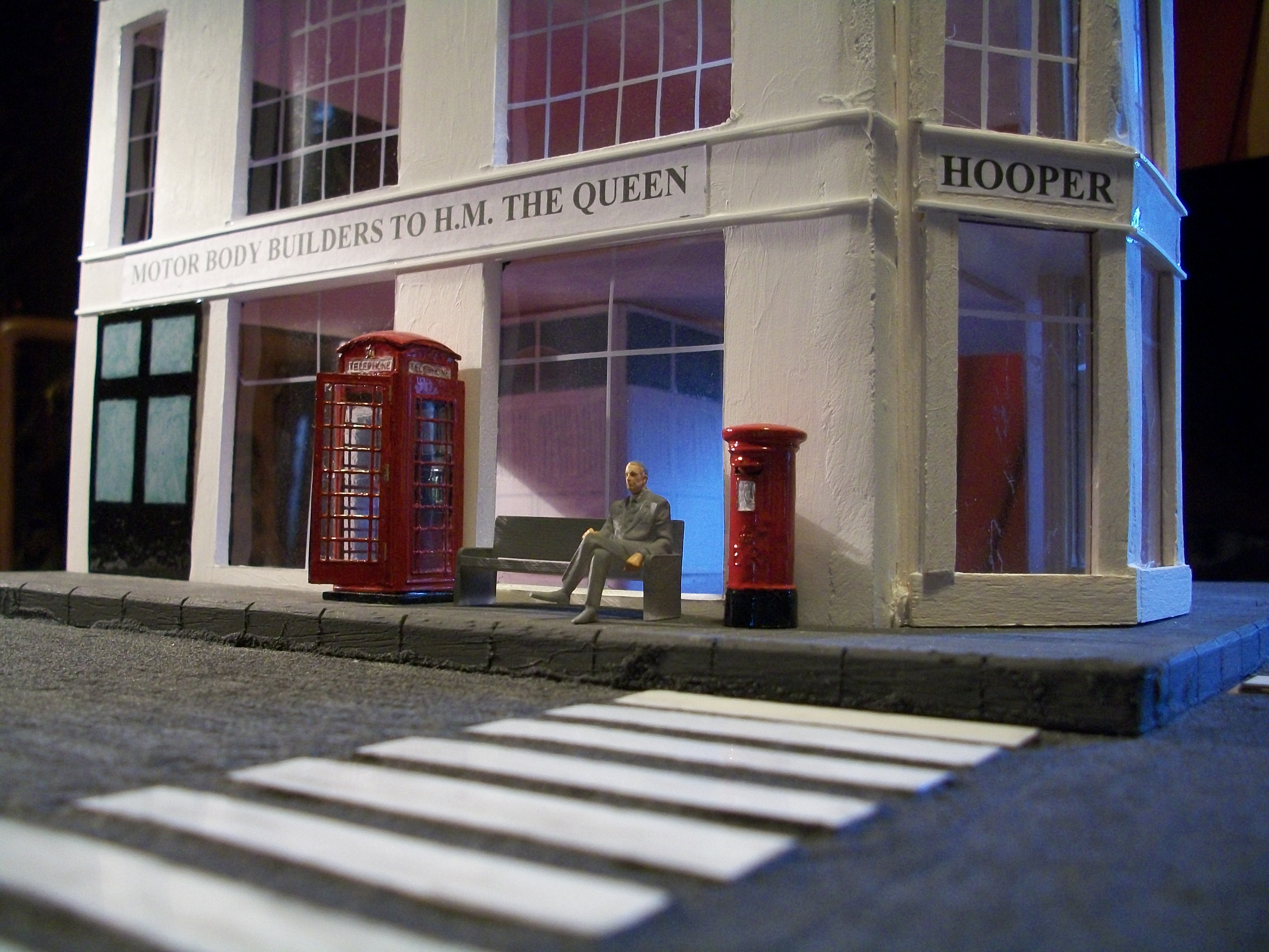

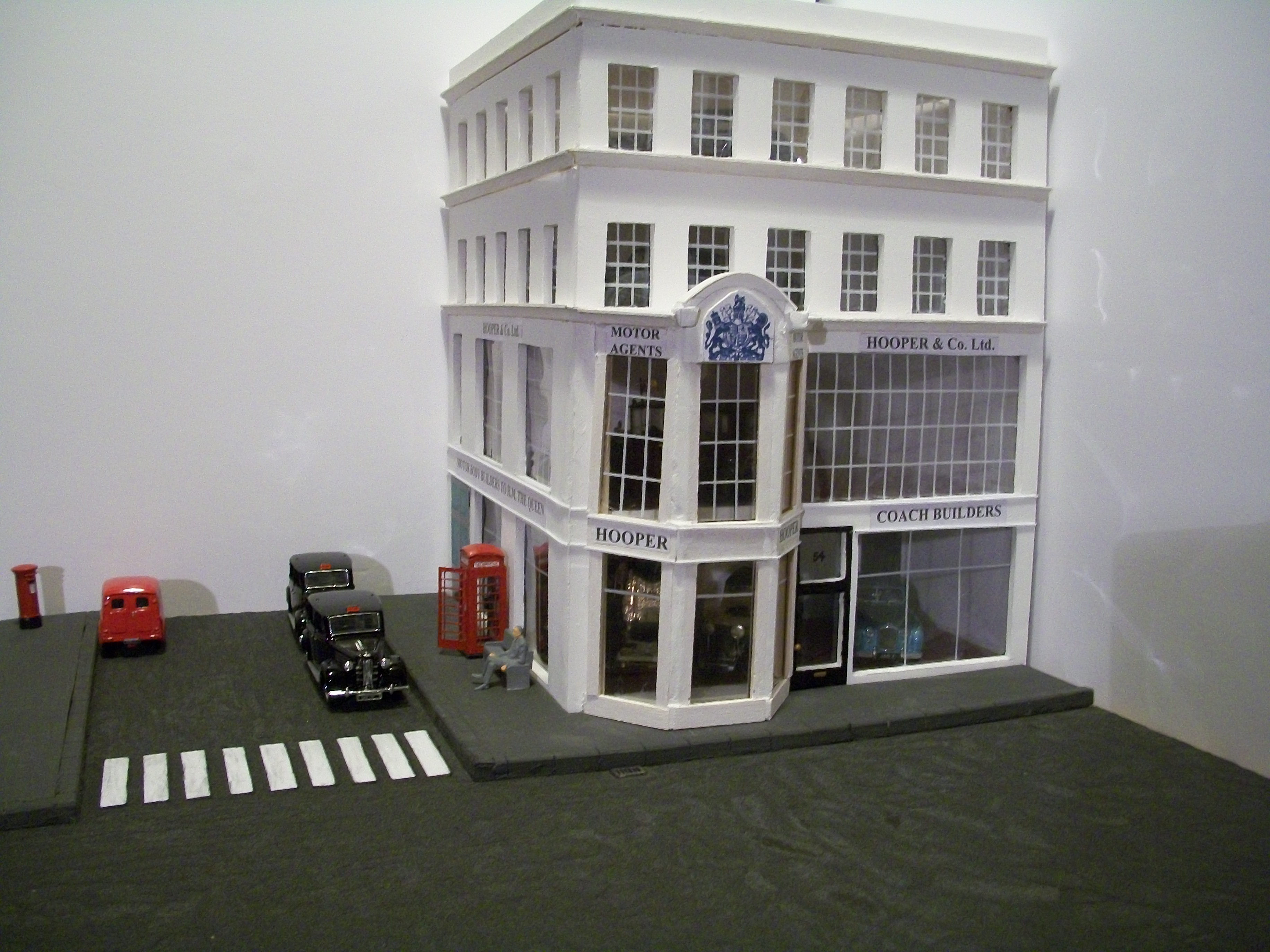

Anglia105E Posted March 29, 2019 Author Share Posted March 29, 2019 The coving for the Hooper building is now all in place and white acrylic gesso has been applied to the lengths of coving, as well as the roof top wall. The attempt to use DAS modelling clay for the curved section of the coving did not work, so I used foamboard and styrene instead. Having completed the zebra crossing, using strips of white styrene, the asphalt has been laid on Bennet Street and St James's Street, leaving a small area for the drainage grate. The asphalt will be drying overnight. Next up on the workbench are the belisha beacons for the zebra crossing, and also the first working street lamp. The three figures need detail painting and the first of eight bicycles also need painting. On top of the roof there will be a flagpole and a chimney stack, just like on the 1:24 scale version of the diorama. Along with the telephone kiosk and the post box, I shall need to scratch build a bus stop. Work is on schedule but there are still a few issues to sort out that I am not happy with. David Quote Link to comment Share on other sites More sharing options...
landman Posted March 29, 2019 Share Posted March 29, 2019 Your curved coving looks good. The whole thing looks good. Quote Link to comment Share on other sites More sharing options...

Anglia105E Posted March 30, 2019 Author Share Posted March 30, 2019 Completed the piping along the border just above the ground floor windows, which I was expecting to be difficult but did not pose any problems really. I used 1 mm square styrene rod for the piping and super glue to secure the lengths. The grate is done, using pieces of card stuck together and a black Sharpie, with grey acrylic paint applied as a wash. Simply to see how the 1:24 scale chimney stack looked on the roof of the 1:43 scale building, I placed it on the roof and realised the chimney stack actually appears to be correct to scale! Putting together a second chimney stack which will be the same size as the first one. The odd thing is, the 1:24 version does not look wrong on the larger scale building..... ? Placed two backing sheets of white foamboard behind the building to see how this diorama will look without the distraction of the room in which it is displayed. David Quote Link to comment Share on other sites More sharing options...

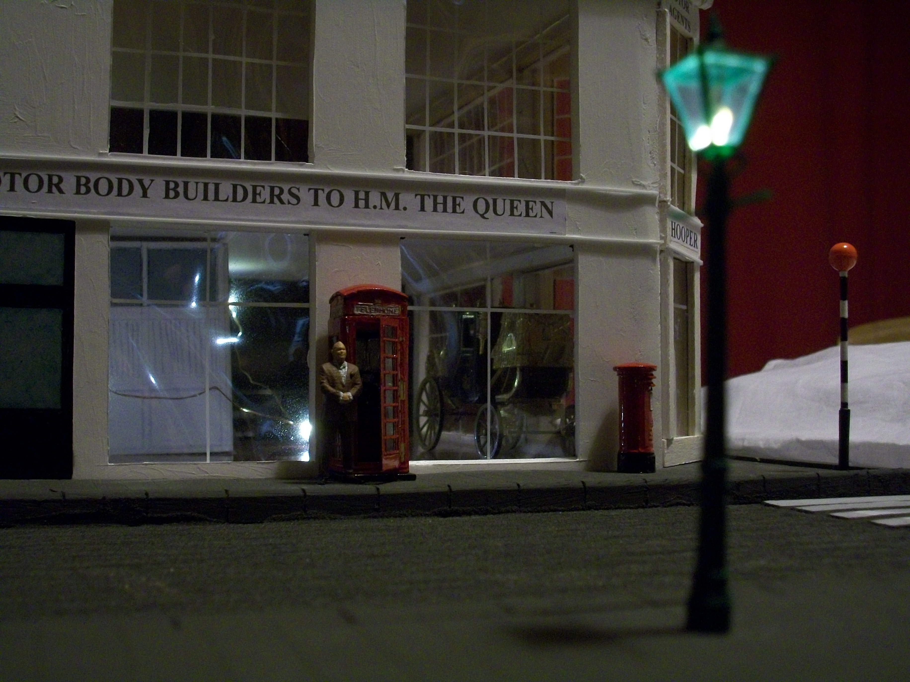

Anglia105E Posted April 1, 2019 Author Share Posted April 1, 2019 The installation of the first working street lamp is completed and the chimney stack is in place up on the roof. The two halves of the 1:43 scale lamp post were inserted tightly into a hole in the pavement, then the length of wire that has the last LED light in the chain was pushed up inside the lamp post from under the pavement and the two halves were glued together. The glazing unit was placed over the end of the wire at the top, then the four post frame was lowered over the glazing unit and the lid of the lamp was glued in place on top. The remaining wire and lights passes under the pavement and any lights that are not required have black PVC tape wrapped around them to prevent any light being emitted. . I am rather pleased with the result and I did expect this to be more difficult. All the rest of the wire and lights will run along the back edge of the diorama baseboard and into the Hooper building, where the controller box will be located inside the office. I haven't figured out yet how to wire up the second, third and fourth street lamps, because the space inside the lamp posts is not wide enough to accommodate a double thickness of wire / cable. David Quote Link to comment Share on other sites More sharing options...

Anglia105E Posted April 3, 2019 Author Share Posted April 3, 2019 The two scratch built Belisha Beacons have been completed and are now in place on the zebra crossing. Getting on quite well with the figure painting and the next scratch built model will be the London bus stop. The next 1:43 scale model car will be arriving on Thursday, which will be the 1948 Ford V8 Pilot. I tried to post a lengthy reply to Gary and Pat the other day, but the website would not allow me to post. All I got was the '404 error - Cannot load the page ' Even a pm containing the same text repeatedly came up with the same error and would not post..... ? David Quote Link to comment Share on other sites More sharing options...
