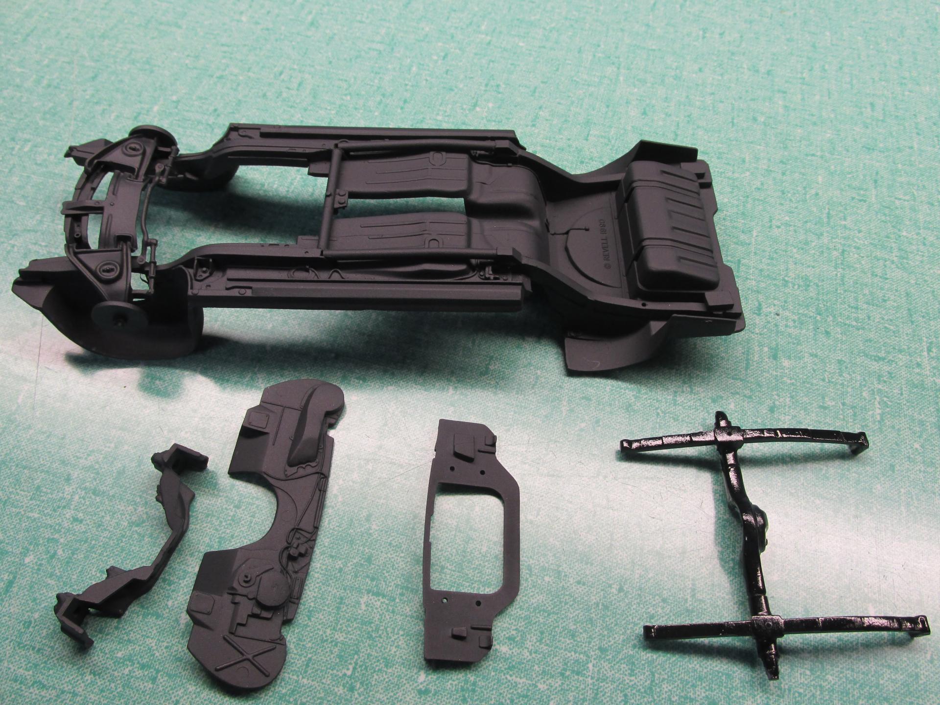

KENNEDYJR Posted October 5, 2017 Author Posted October 5, 2017 (edited) Base color on the chassis parts. Lots of detail paint left to do. I scratch built the subframe connectors and the trans mount. I also had to cut out some material in the rear wheel wells to fit the rear tires. The rear diff is from a Monogram Nascar kit and the springs are from the AMT 66 Fairlane. The chassis pan is from the Revell 69 kit btw. Edited October 5, 2017 by KENNEDYJR

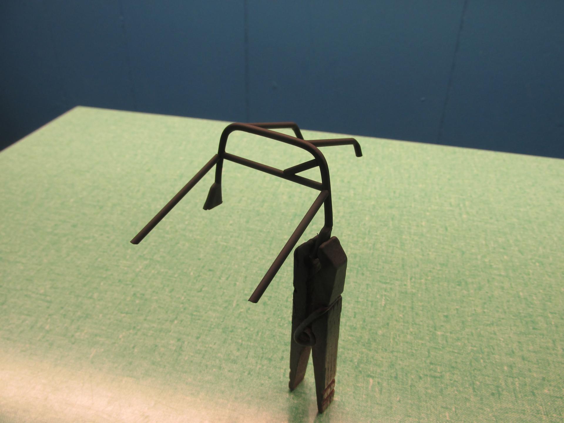

KENNEDYJR Posted October 5, 2017 Author Posted October 5, 2017 The roll cage is together. Main loop is from the Monogram 78 Camaro kit with the rest from styrene.

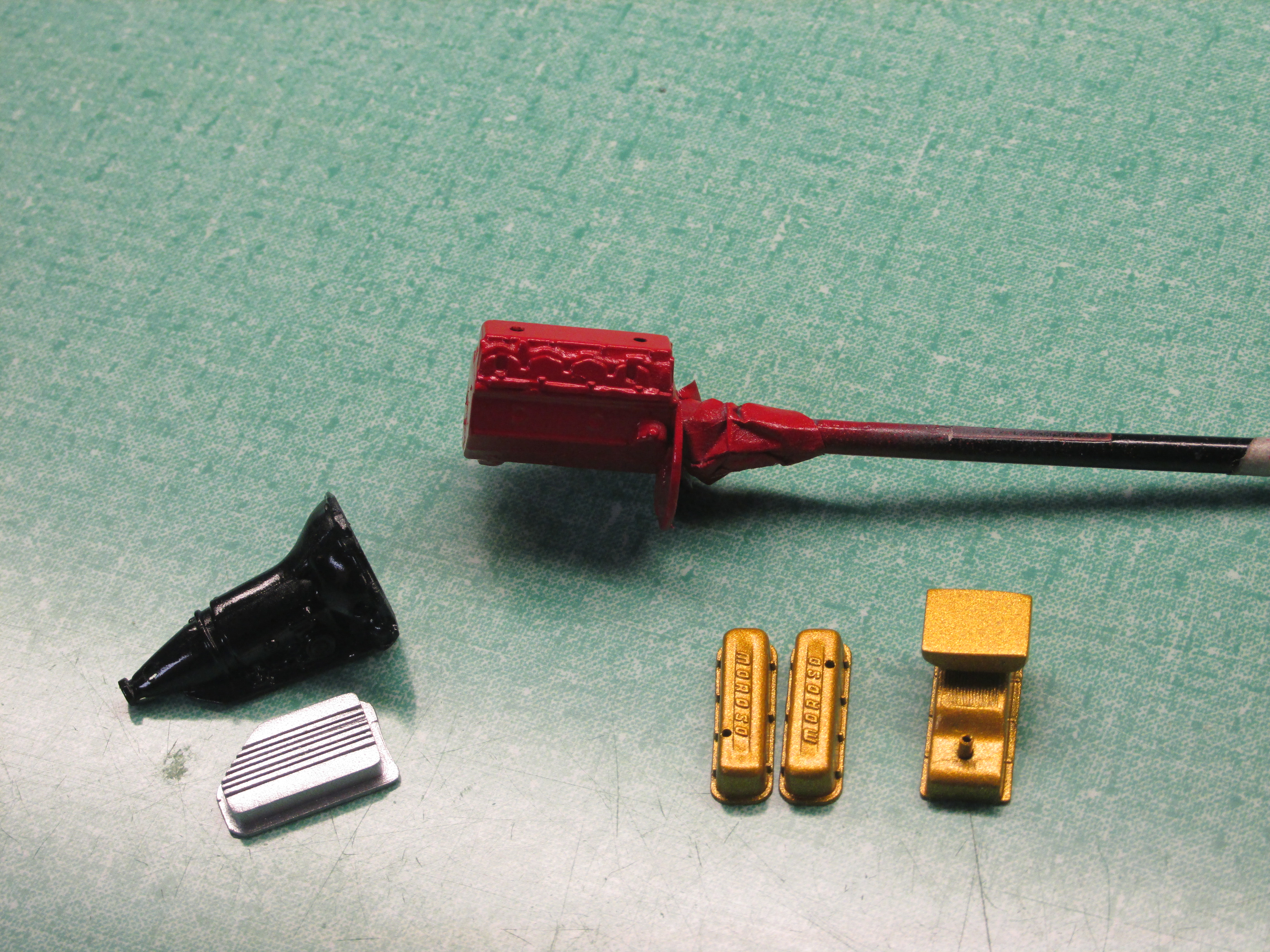

KENNEDYJR Posted October 5, 2017 Author Posted October 5, 2017 (edited) The basics of the engine are painted. Transmission is from the Monogram Monte Carlo kit with a scratch built pan. The oil pan is from the parts box(the flip nose 53 Ford truck kit I believe) with a deep sump added. Heads and valve covers are from the Firebird Prostock kit and the block is from the AMT 69 Chevelle. Parts box to the rescue! Edited October 12, 2017 by KENNEDYJR

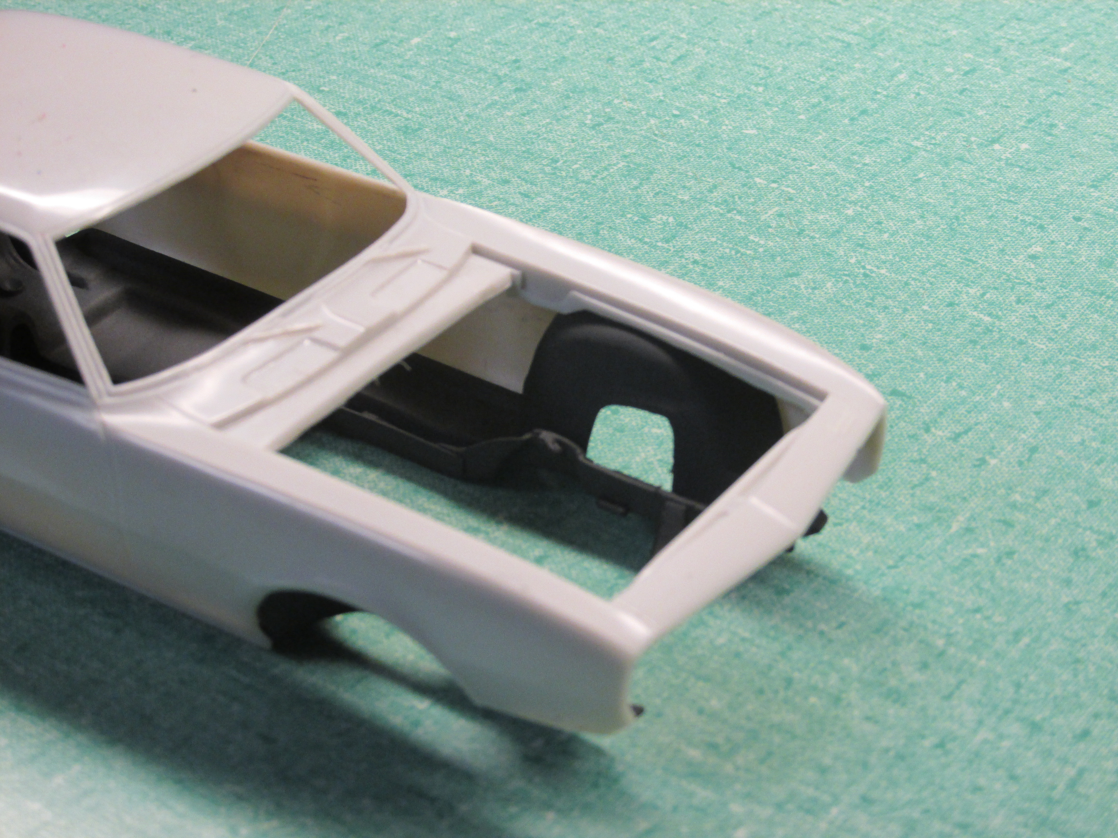

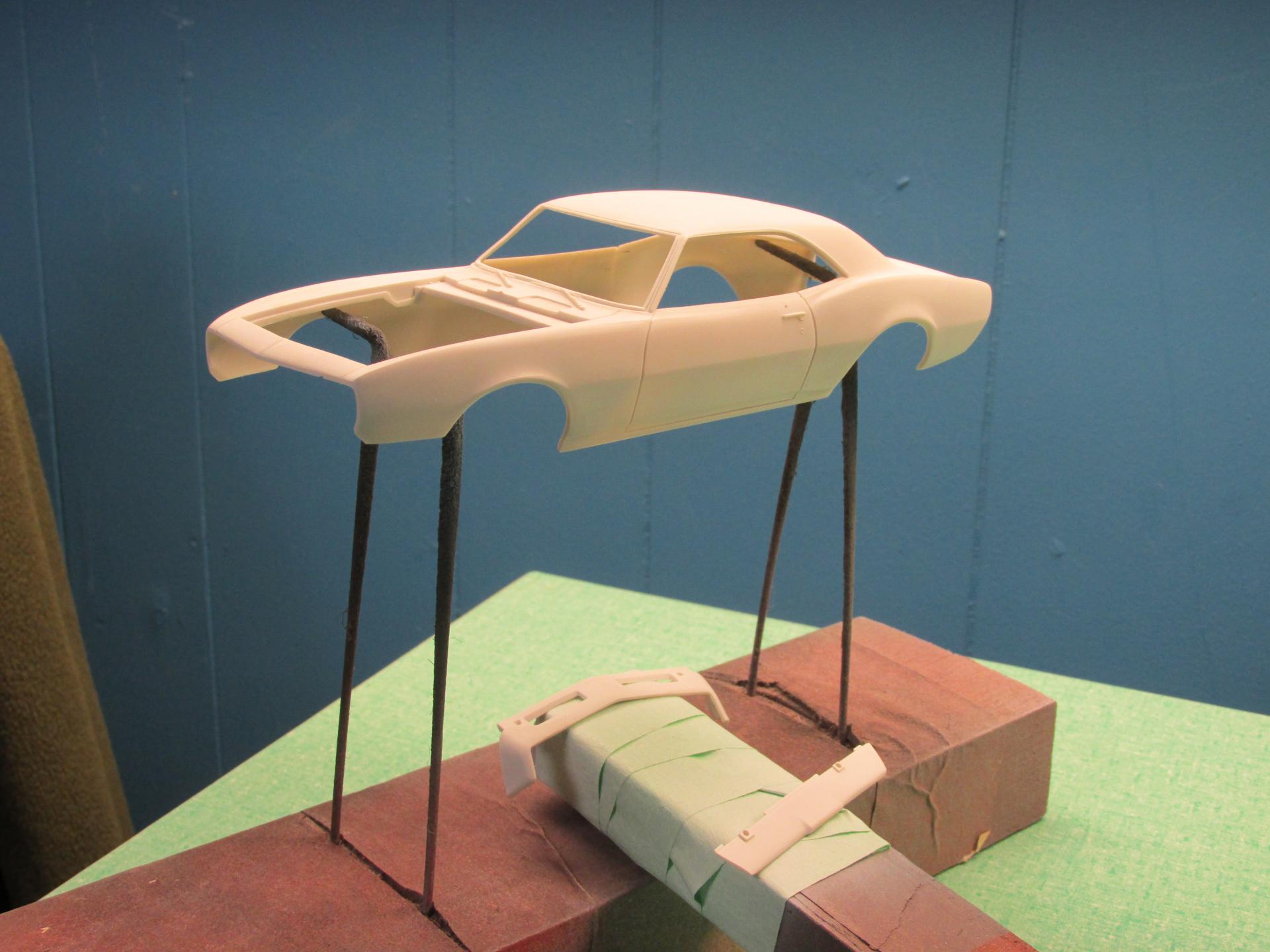

KENNEDYJR Posted October 5, 2017 Author Posted October 5, 2017 (edited) The inner fenders and firewall from the 67 kit need to be removed to allow the 69 chassis pan to fit. The firewall and radiator support fit well as is. I do have my work cut out regarding the body though. I removed the emblems and the trim around the wheels and rocker panels. In doing so I also removed some of the stamped detail below the trim which I will need to repair/replace. Edited October 5, 2017 by KENNEDYJR

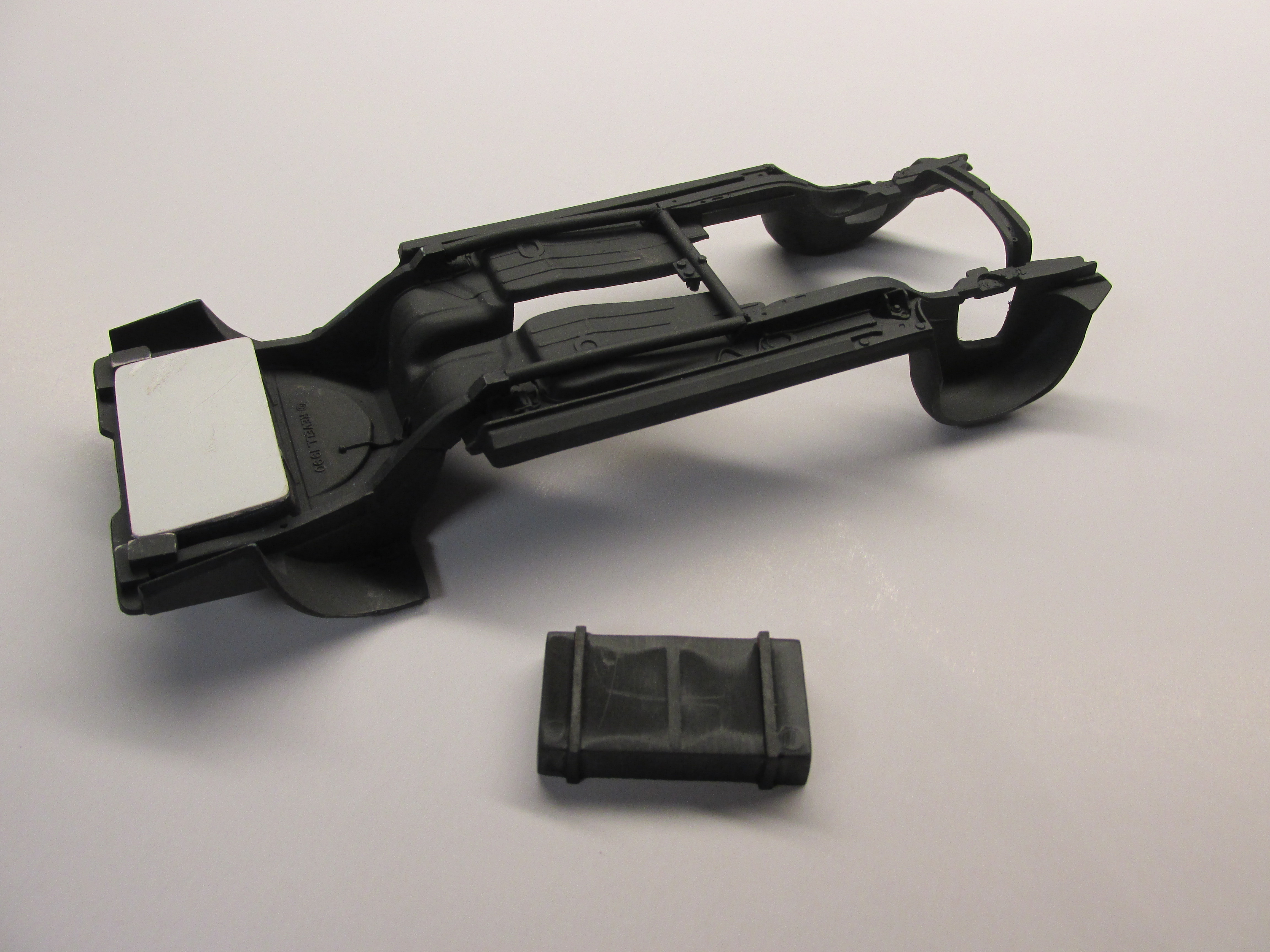

KENNEDYJR Posted October 8, 2017 Author Posted October 8, 2017 Thanks Aurf! It looks like the Camaro has an aftermarket fuel tank so the stocker will have to go. I found a good donor on a stock car that will work. I covered the hole in the chassis with styrene sheet.

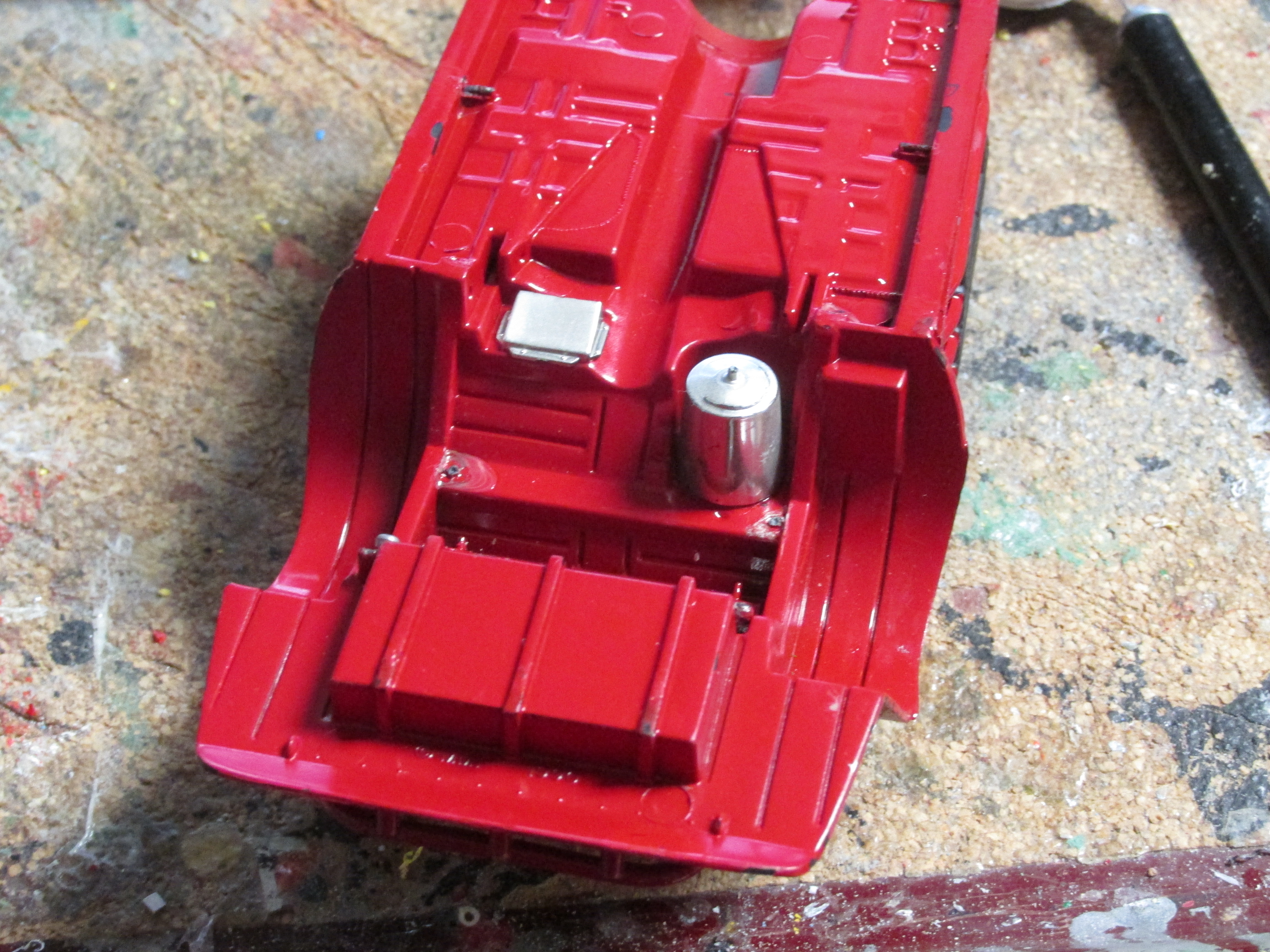

KENNEDYJR Posted October 8, 2017 Author Posted October 8, 2017 (edited) After putty,prime,and paint. I still need to paint the hold down straps. Edited October 8, 2017 by KENNEDYJR

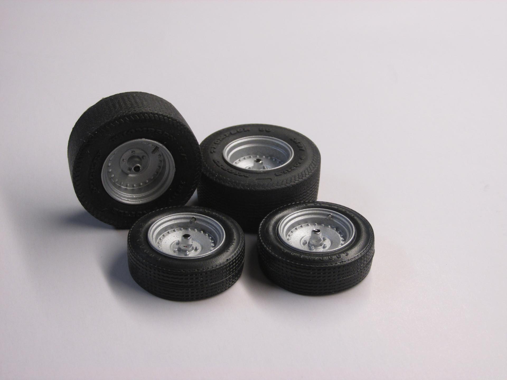

KENNEDYJR Posted October 8, 2017 Author Posted October 8, 2017 (edited) Wheels and tires are ready as well. The Centerlines are from the Monogram 70 Chevelle,and the tasty rear tires are from Fireball Models. Do not delay,buy some!! Excellent quality. I used a Molotow pen on the center caps and added valve stems while I was at it. Tires Edited October 12, 2017 by KENNEDYJR

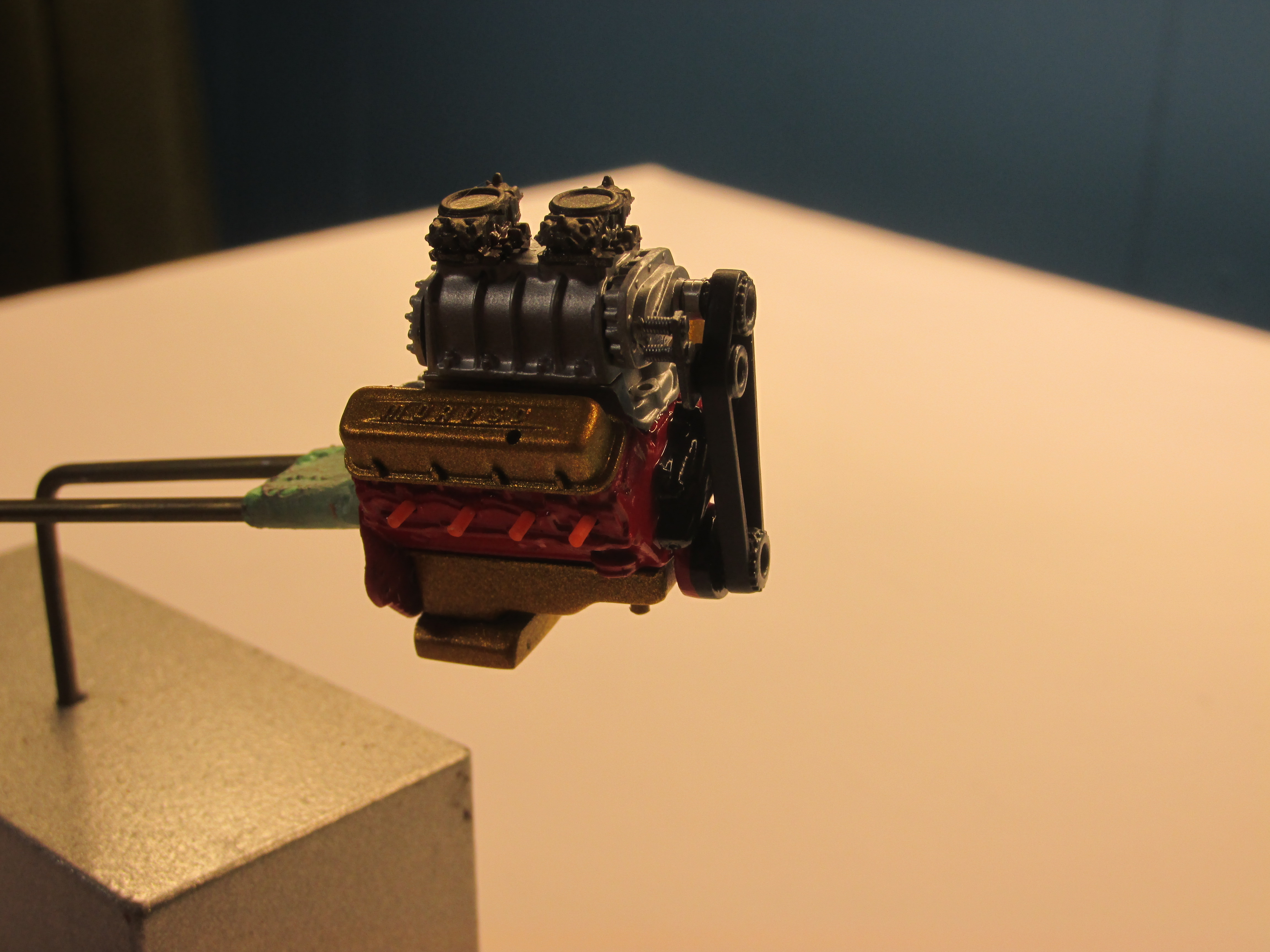

KENNEDYJR Posted October 8, 2017 Author Posted October 8, 2017 (edited) Engine detailing started. Added the idler pulley assembly and spark plug boots (from Crazy Scale auto parts for dirt cheap-get some). I need to tackle all of the fuel lines before I install the distributor and plug wires. Plug boots Edited October 9, 2017 by KENNEDYJR

aurfalien Posted October 9, 2017 Posted October 9, 2017 Wheels and tires are ready as well. The Centerlines are from the Monogram 70 Chevelle,and the tasty rear tires are from Fireball Models. Do not delay,buy some!! Excellent quality. I used a Molowot pen on the center caps and added valve stems while I was at it. Tires Hi, I totally love the profile etc of this! Not too big like drag slicks would have been, just perfect.
