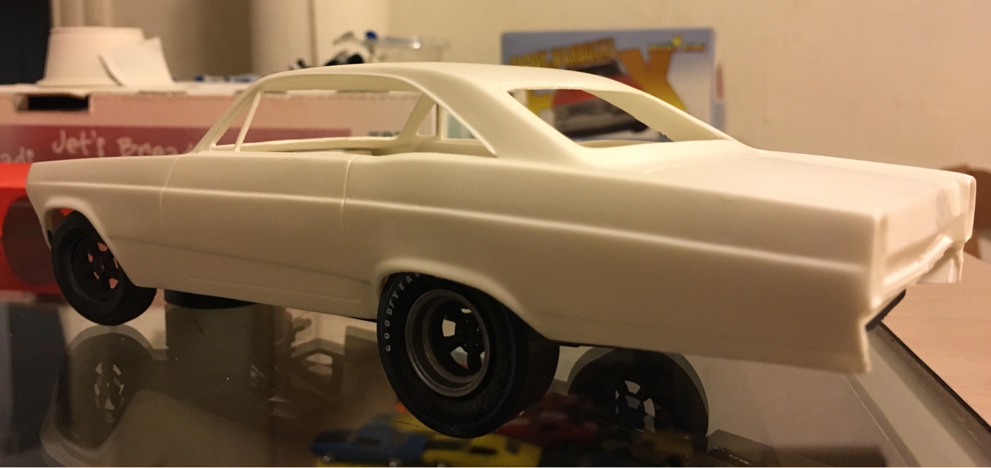

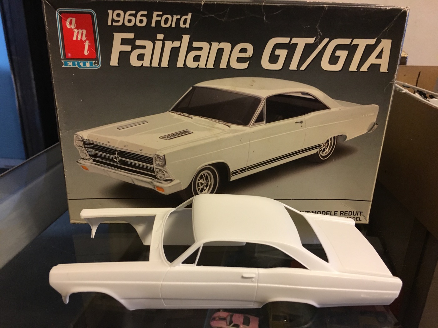

fairlane1320 Posted October 27, 2017 Posted October 27, 2017 I've pushed everything else aside for my latest obsession, building this unique 1966 Fairlane AWB. It will be loosely based on the rather obscure Prestone Silencer car. A Hilborn injected Cammer will provide the power. An AMT Fairlane GT and a Kings Comet will donate to the cause.

bogger44 Posted October 28, 2017 Posted October 28, 2017 Very interesting project. Great work on moving the wheelwells. I'll be watching for more updates.

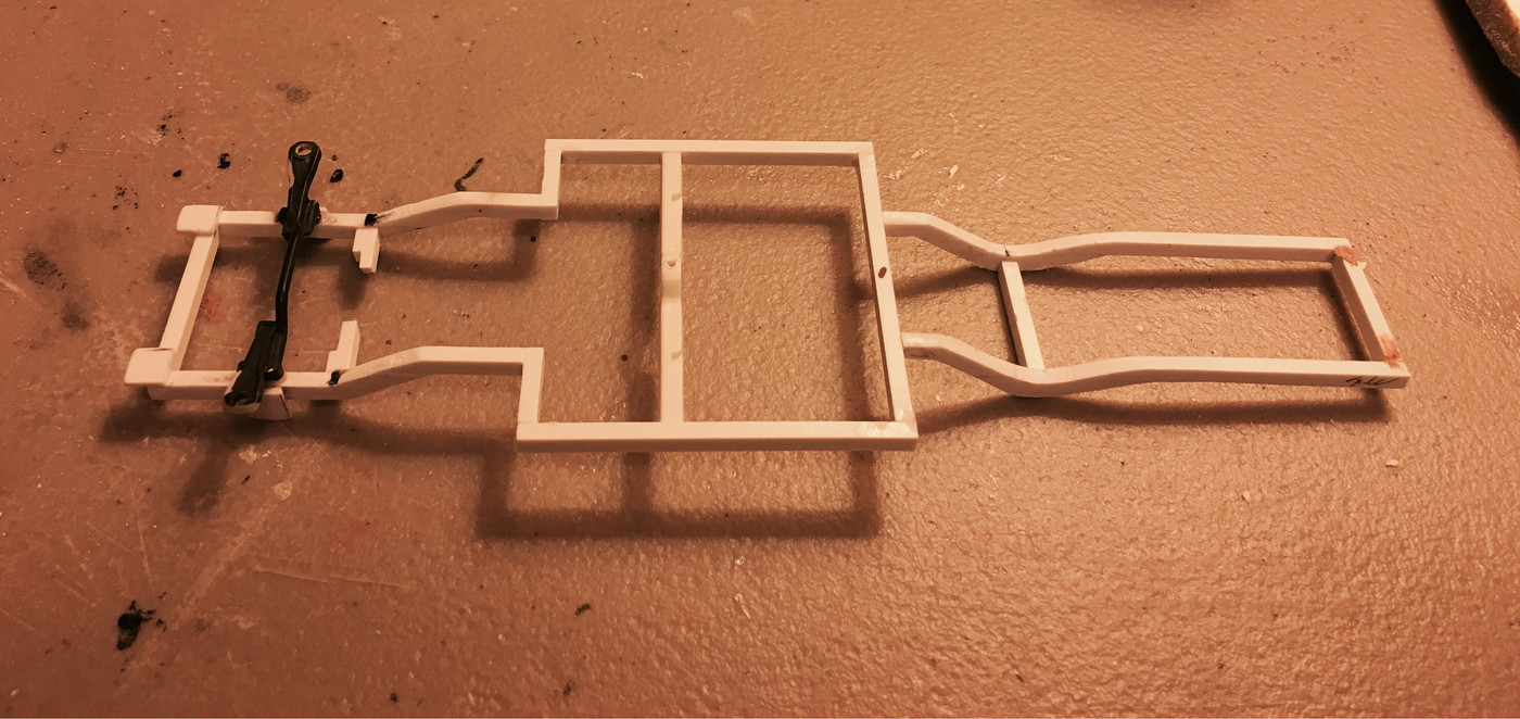

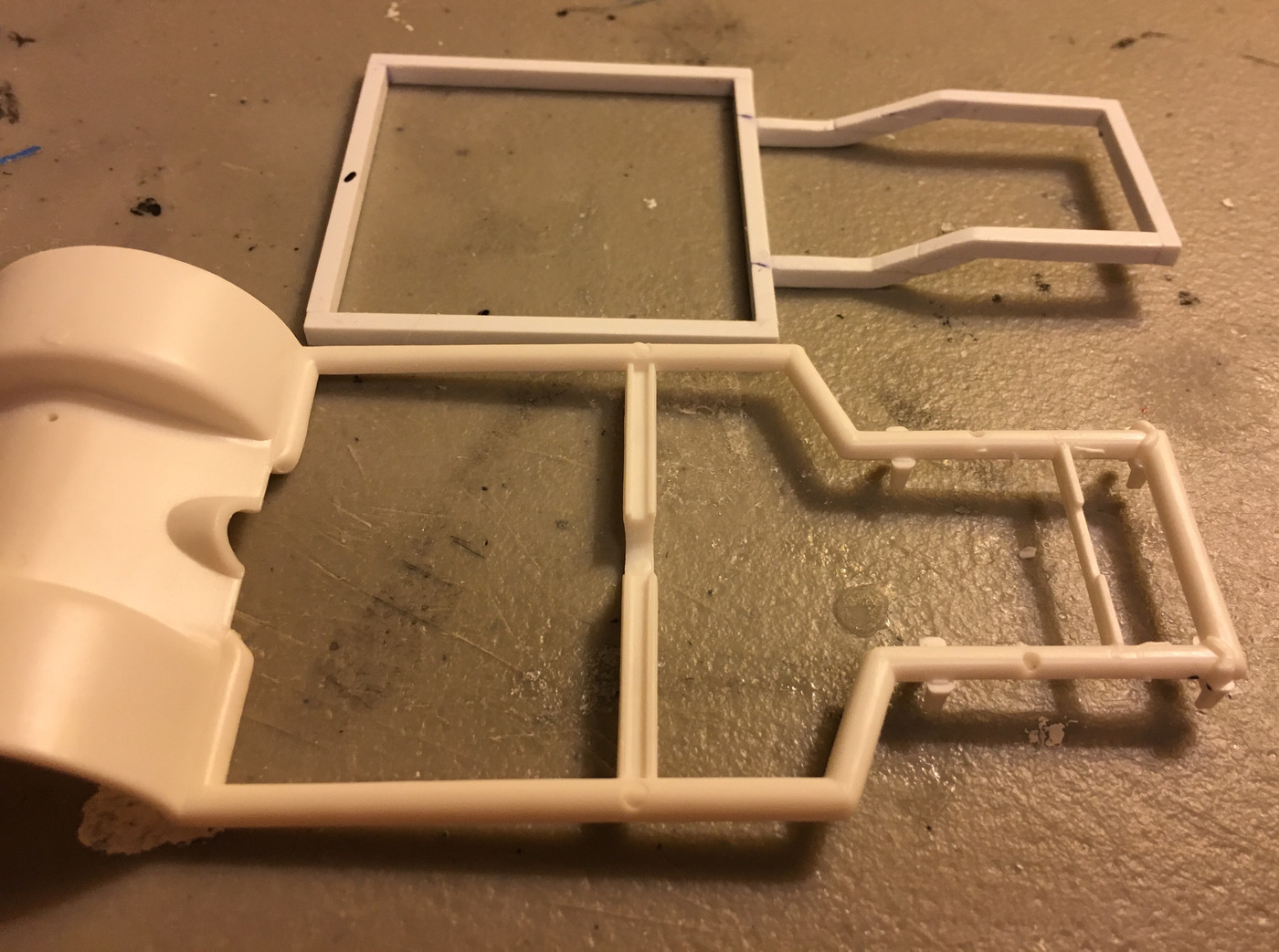

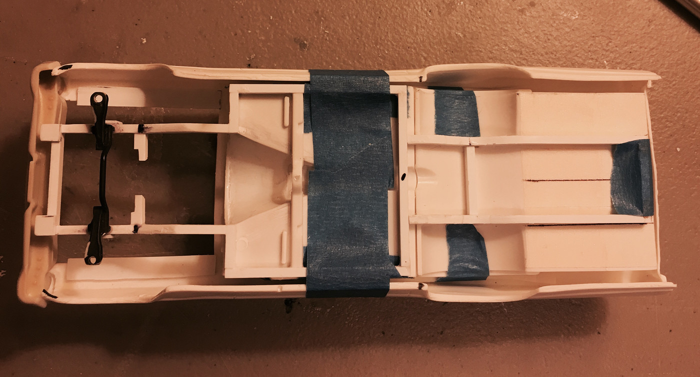

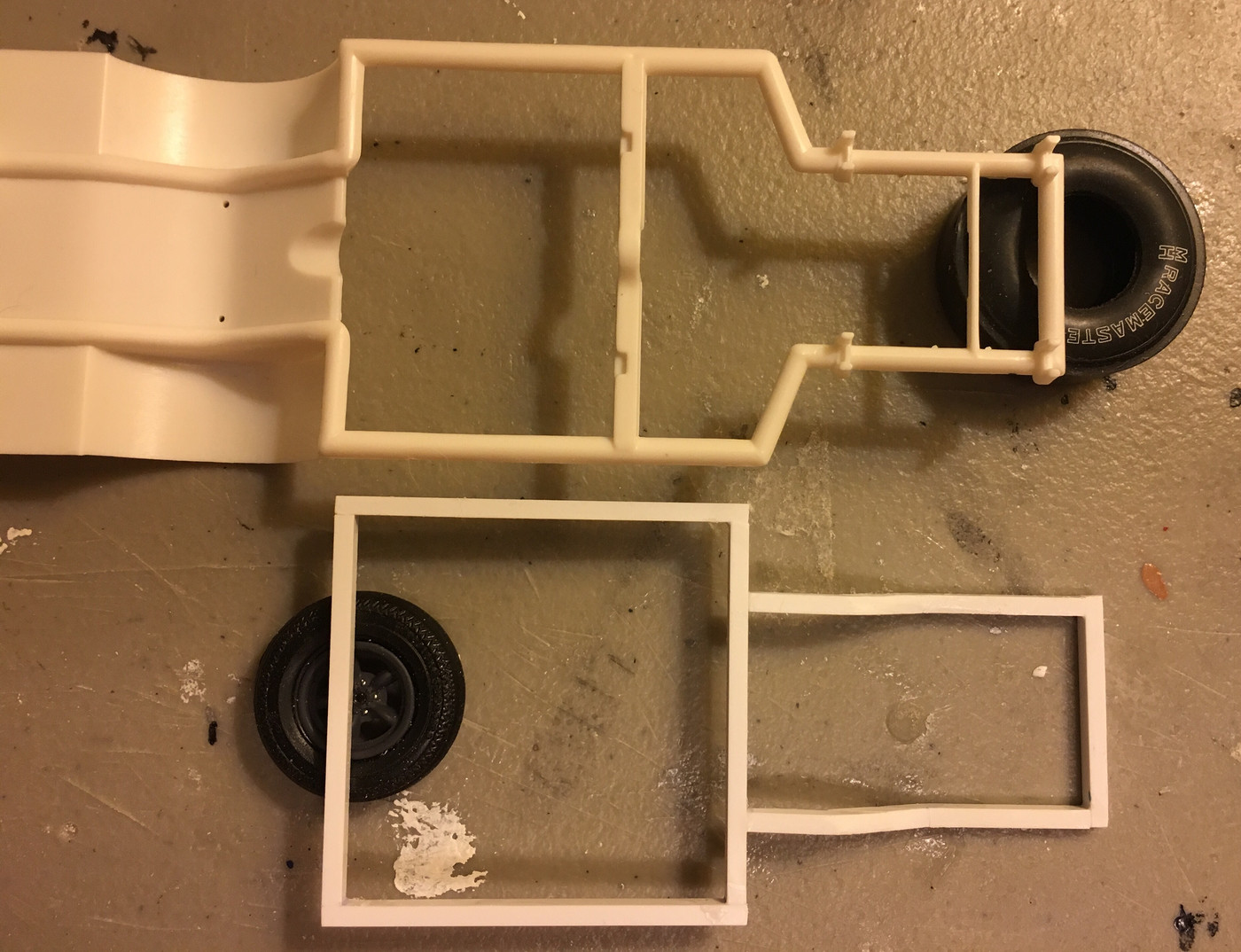

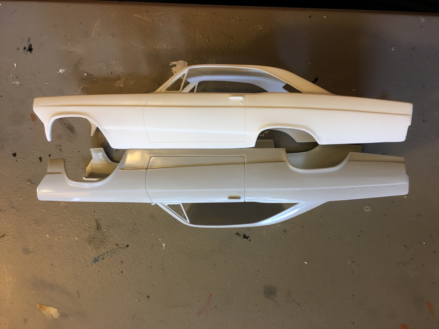

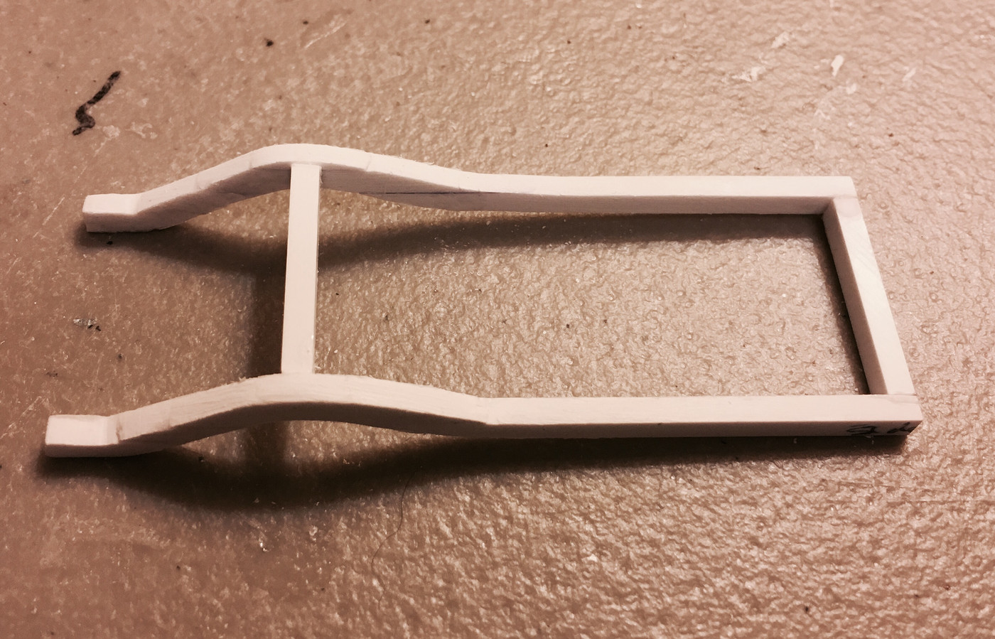

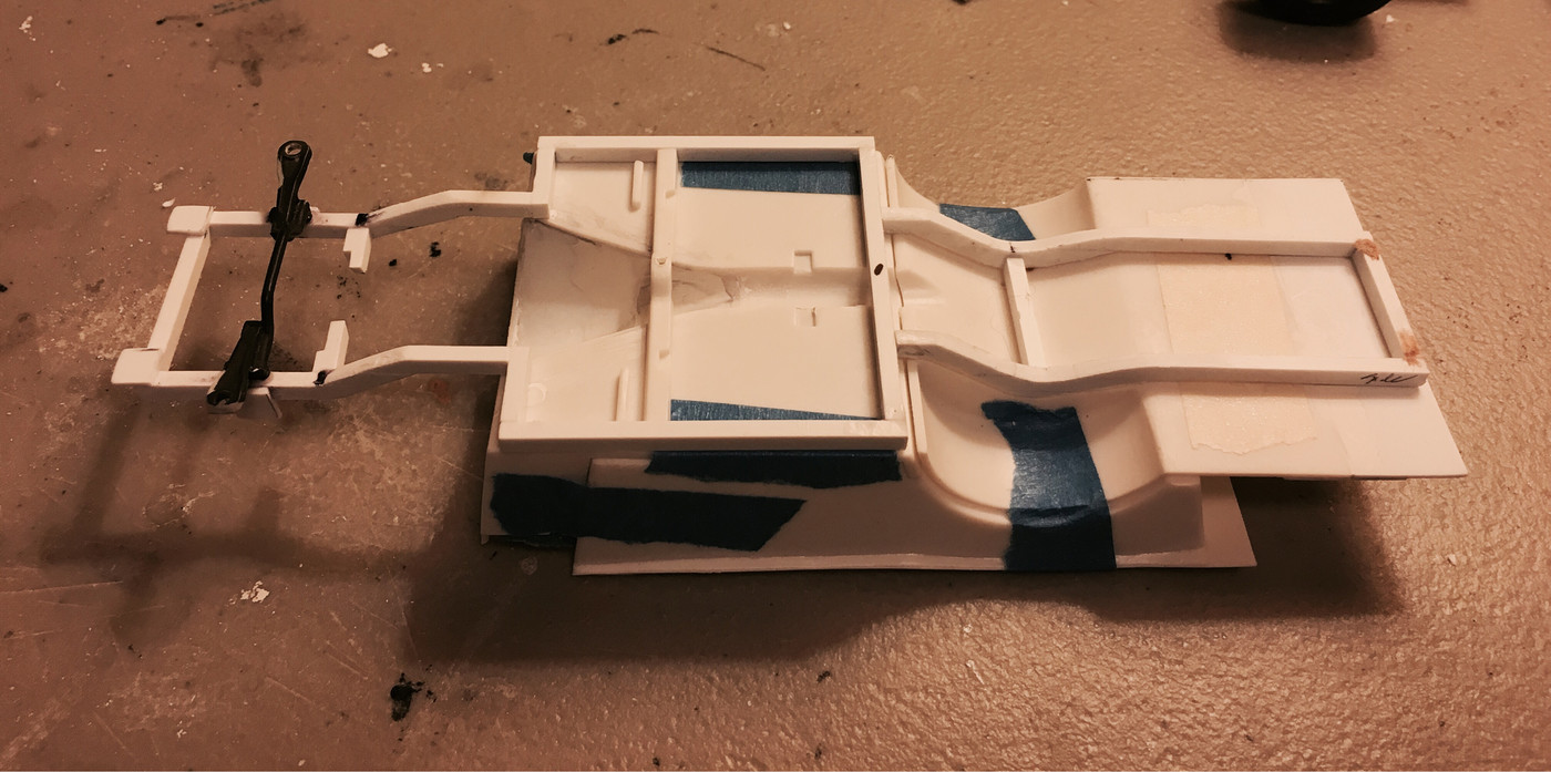

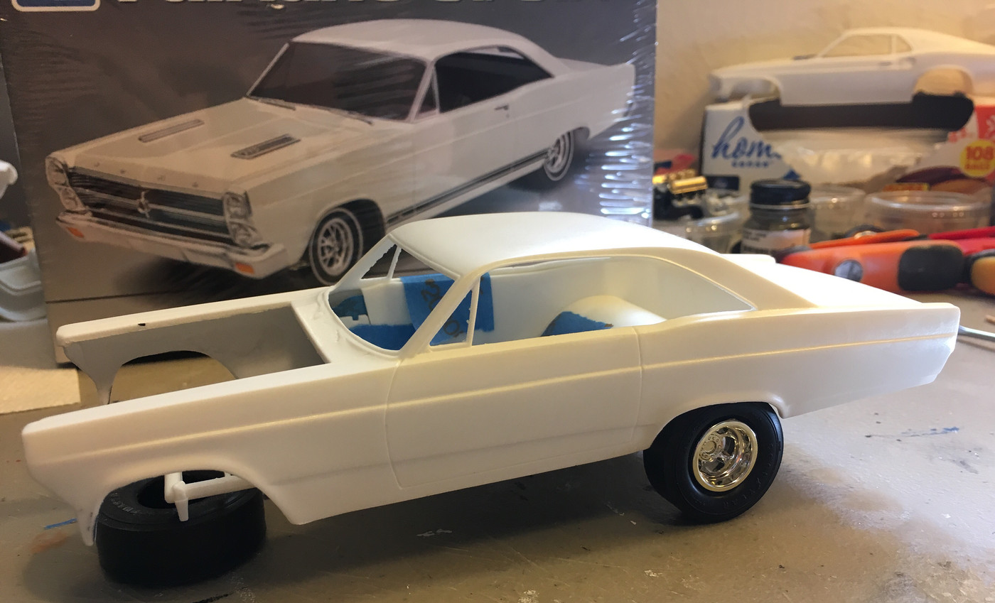

fairlane1320 Posted October 30, 2017 Author Posted October 30, 2017 Well I wish I could take credit for the wheel openings, but this is a resin. This kit donated it's interior, chassis and a few odd n ends. Other than being too short in the front, the Comet chassis fit perfectly. I decided to cobble up a square chassis to replace the incorrect round tube one.

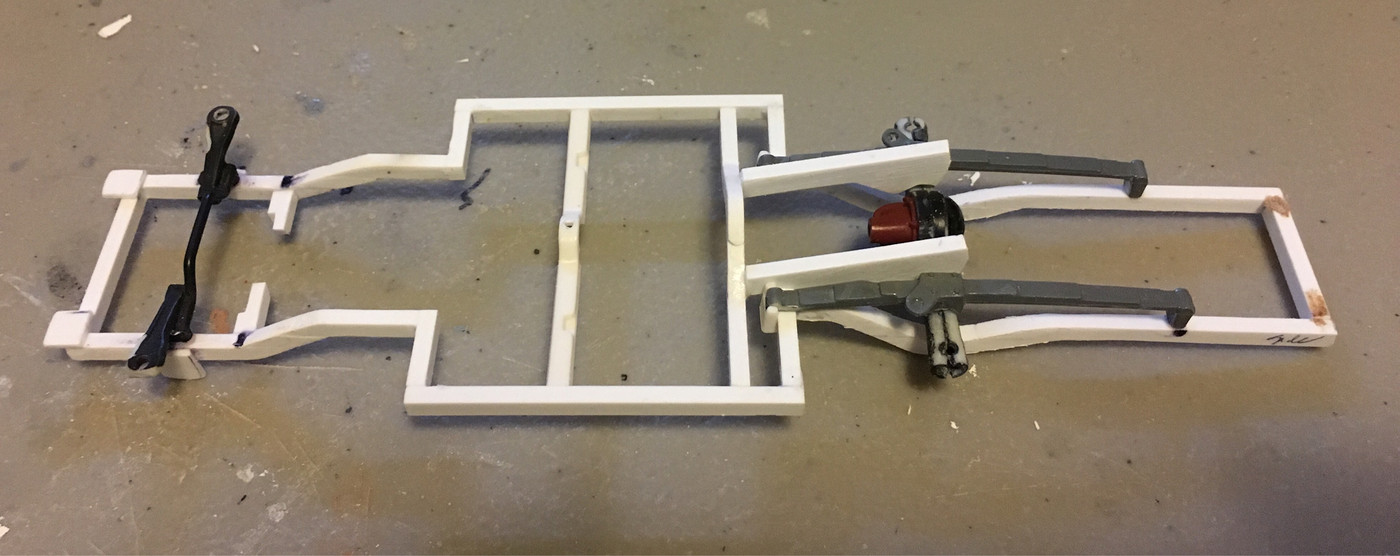

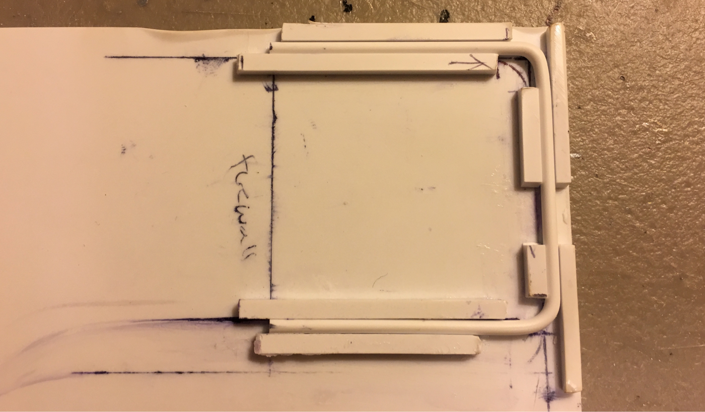

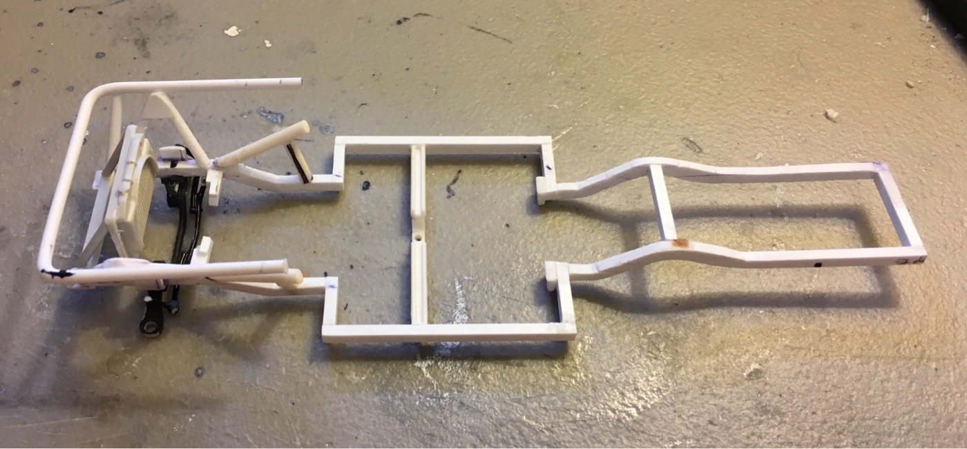

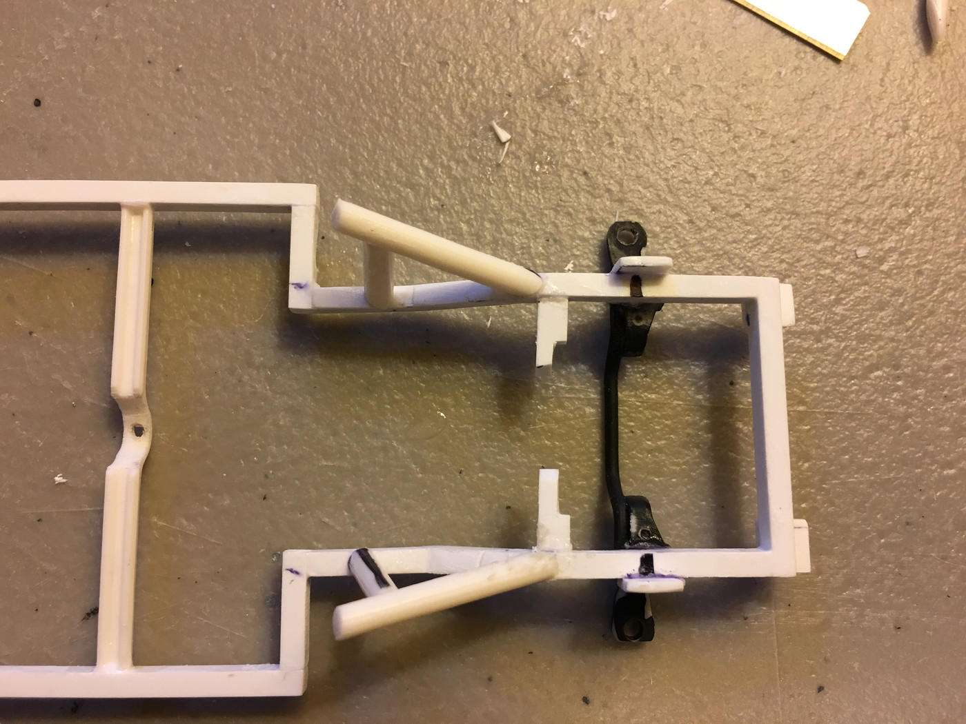

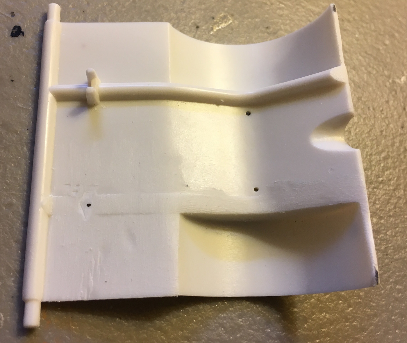

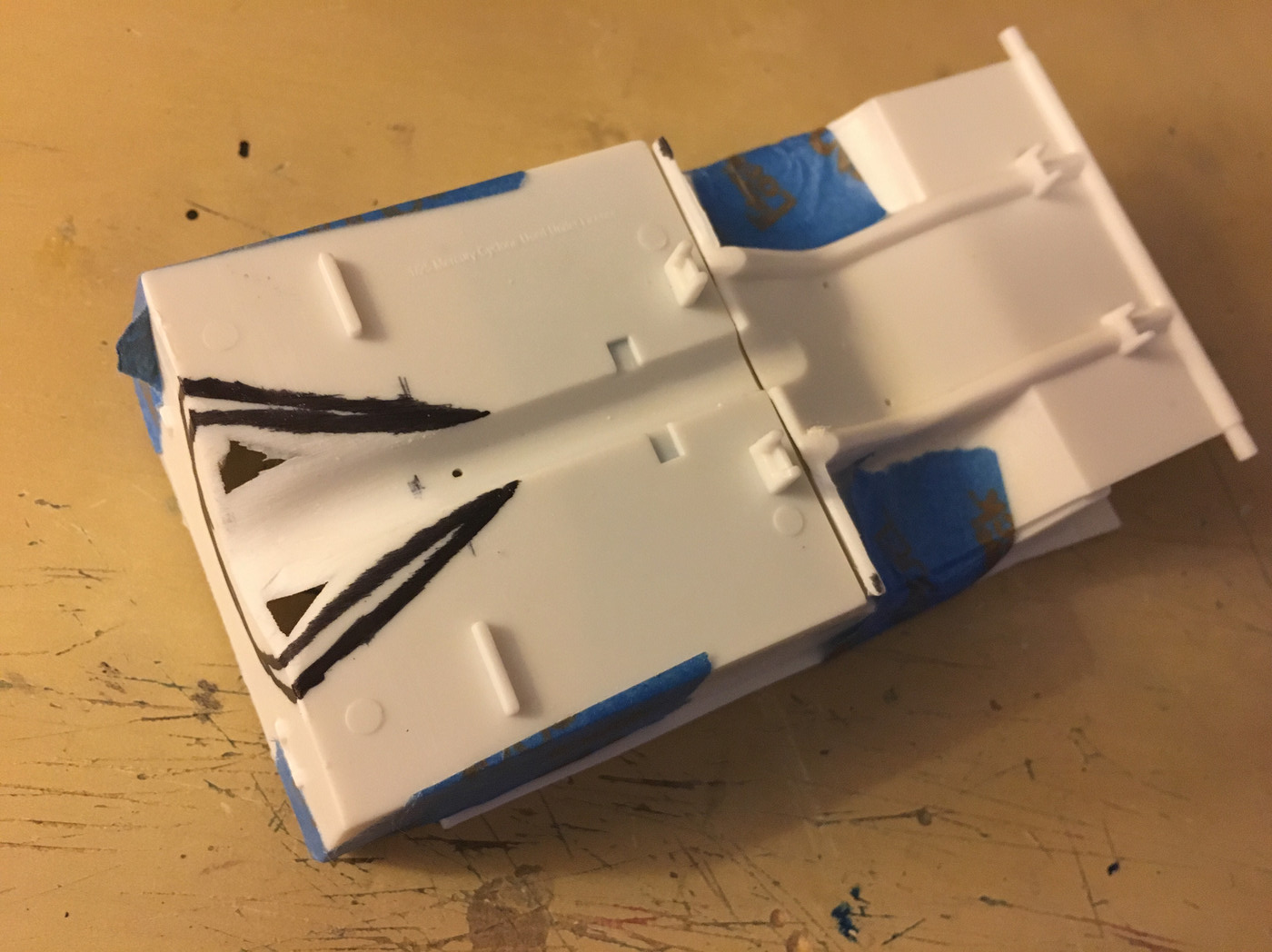

fairlane1320 Posted November 5, 2017 Author Posted November 5, 2017 The rear frame rails were also tubular, and these were molded into the floor plan. So I ground then out and went about making a square tube rear frame to match the rest. I also lengthened the rear floor pan. The rear rails were a bit of a challenge!

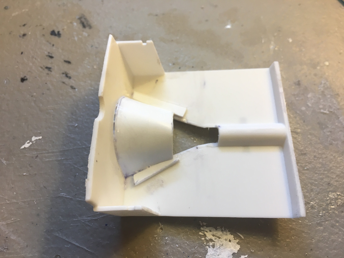

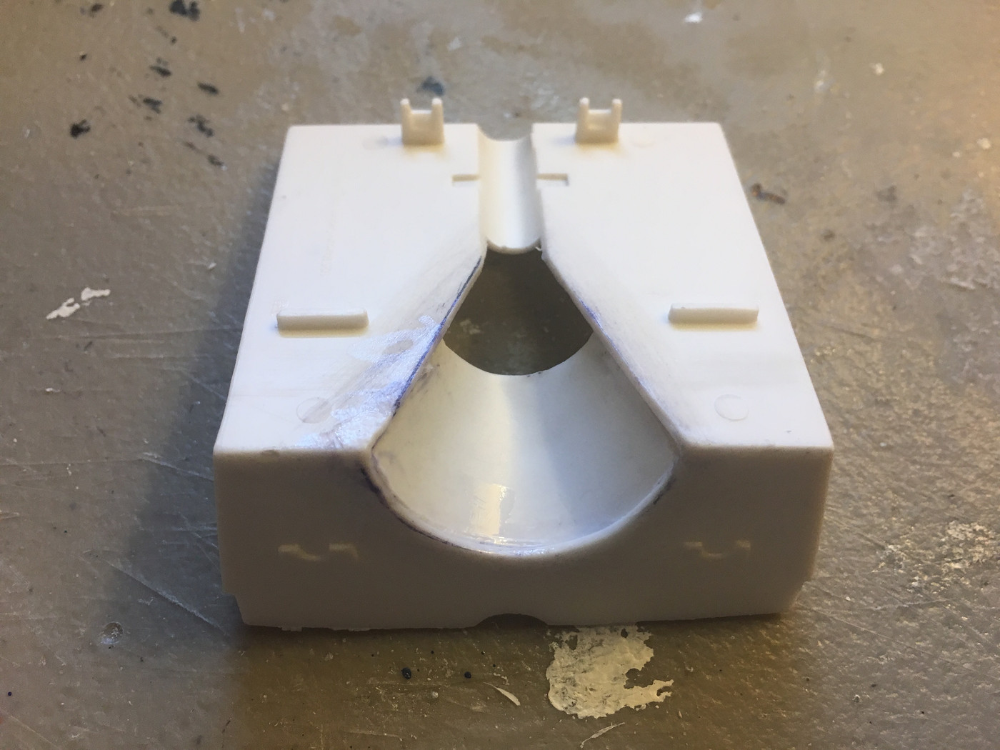

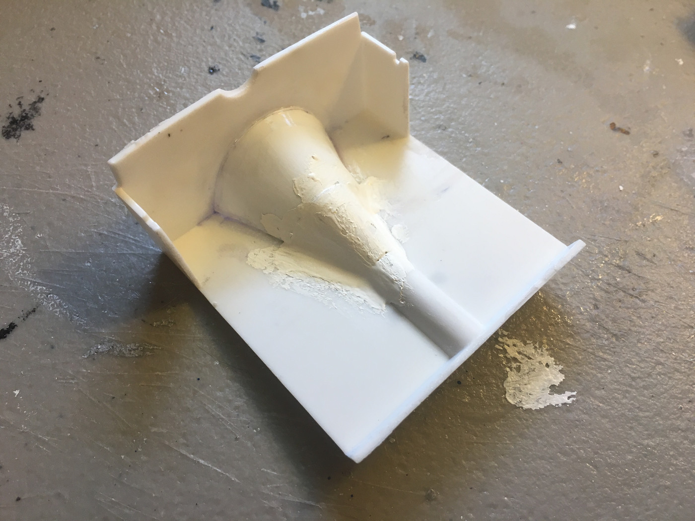

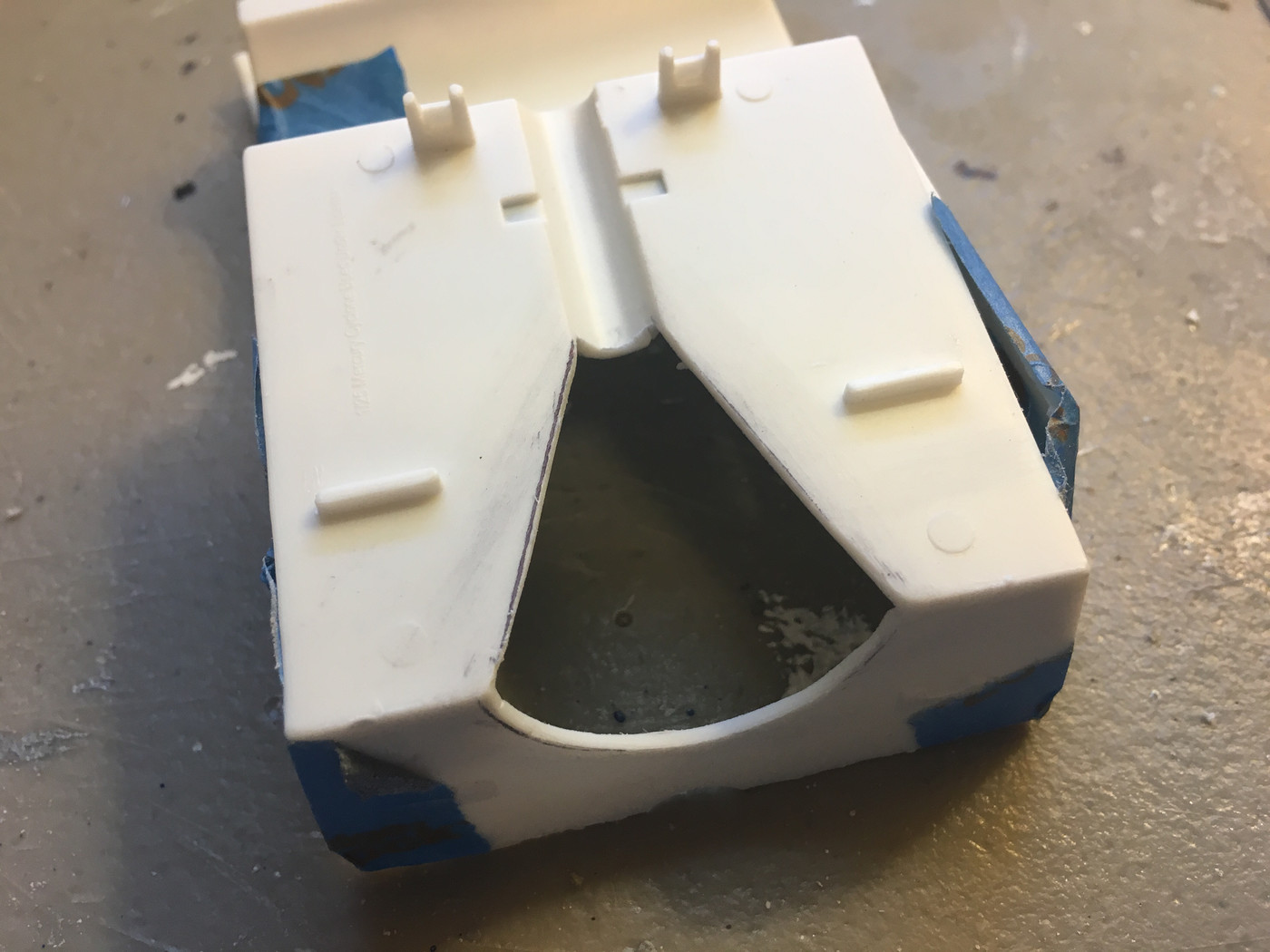

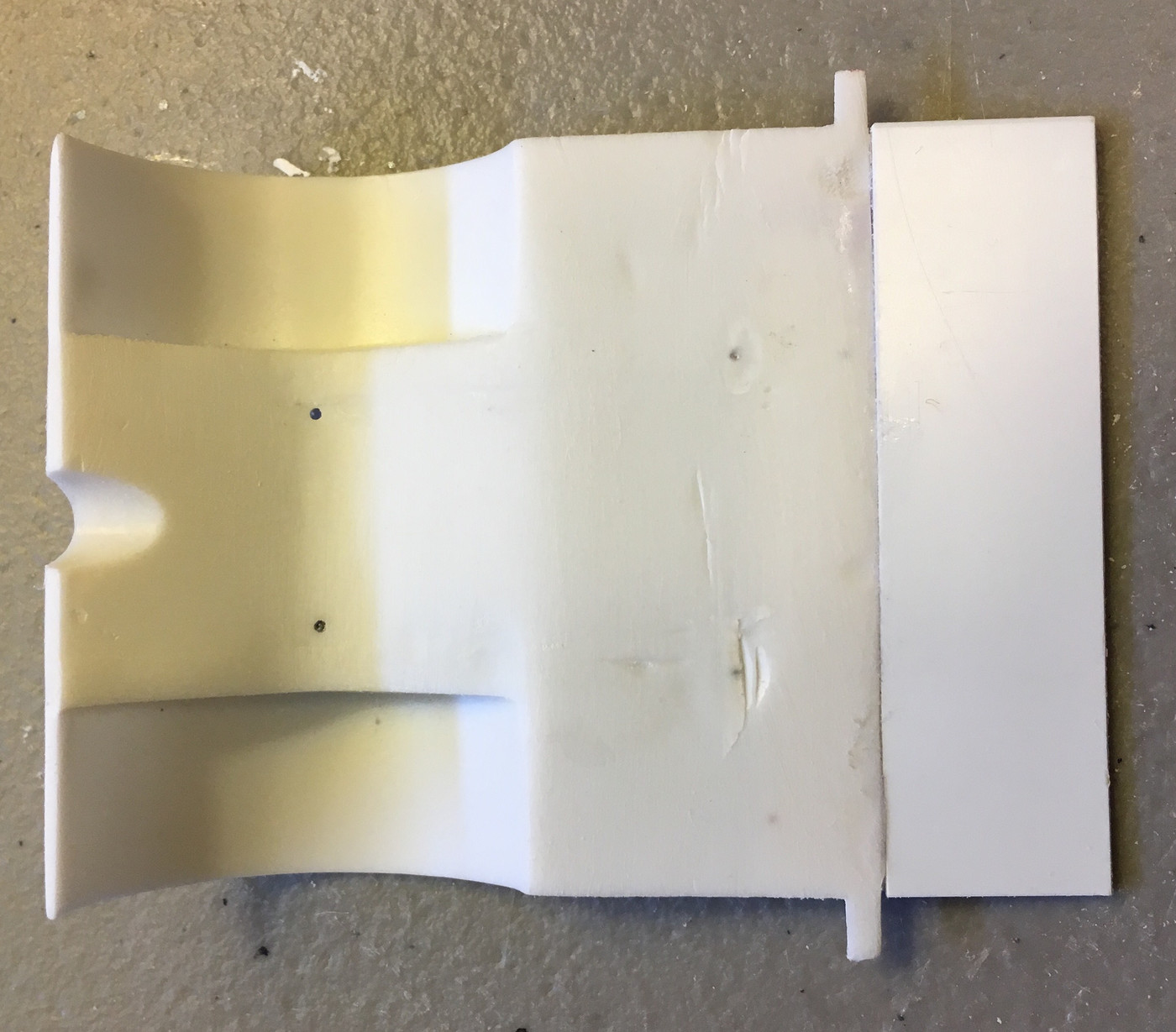

fairlane1320 Posted November 5, 2017 Author Posted November 5, 2017 The tiny trans tunnel needed to be opened up to accommodate the C-6 Trans. Another challenge!

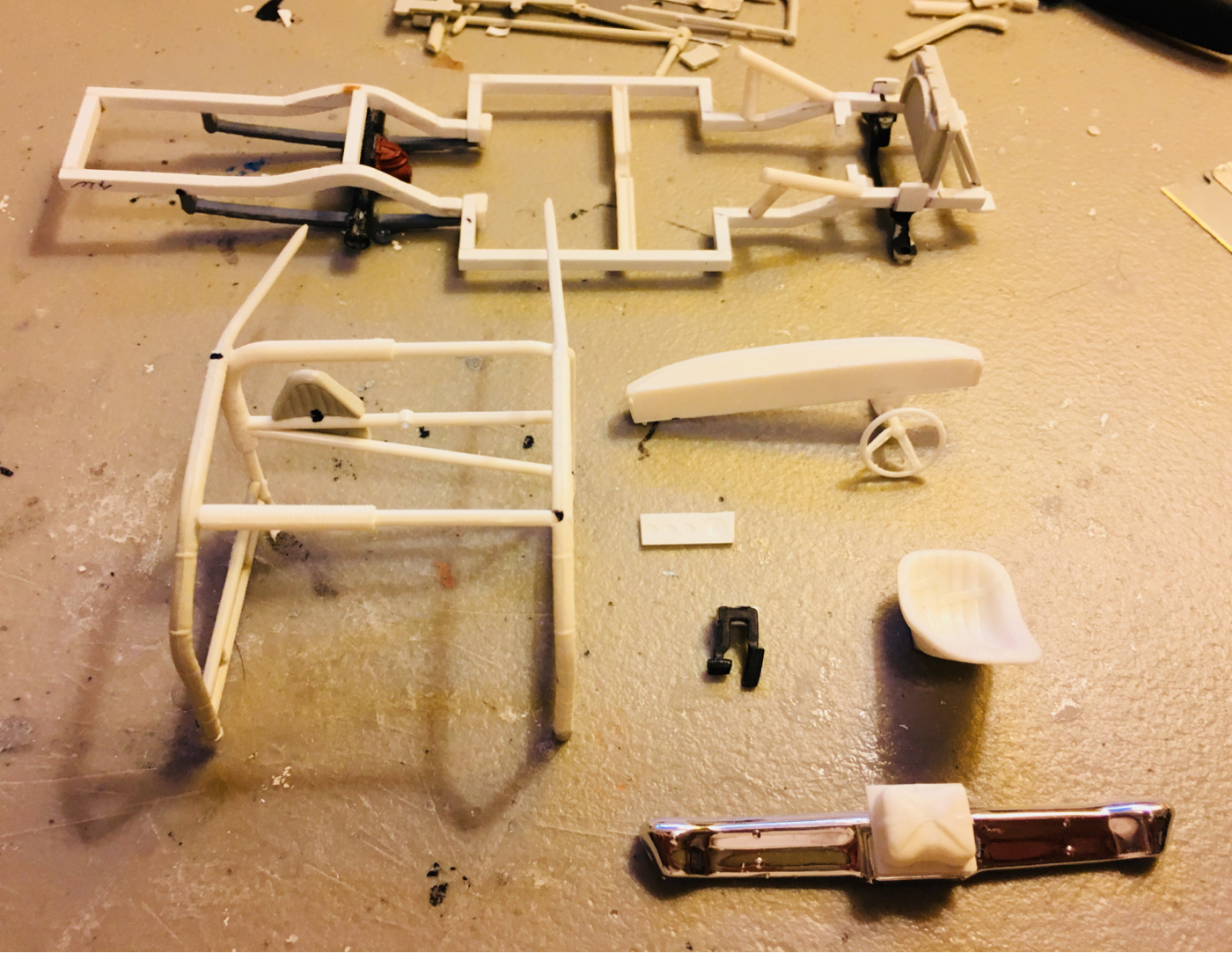

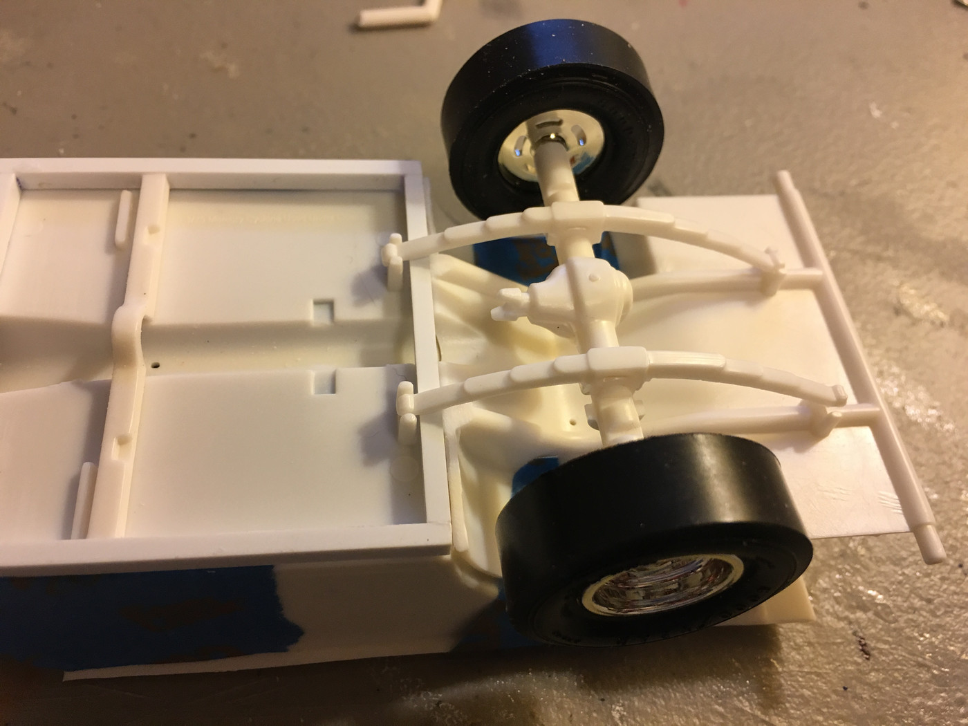

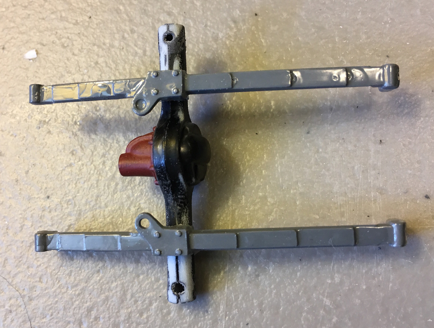

fairlane1320 Posted November 5, 2017 Author Posted November 5, 2017 Since this is not a "gasser" that's all jacked up, the ride height will have to be adjusted. The Comet rear axle and springs had way too much arch, and the axle housing didn't really look like a 9-inch. So, I used the axle and springs from the doner Fairlane kit.

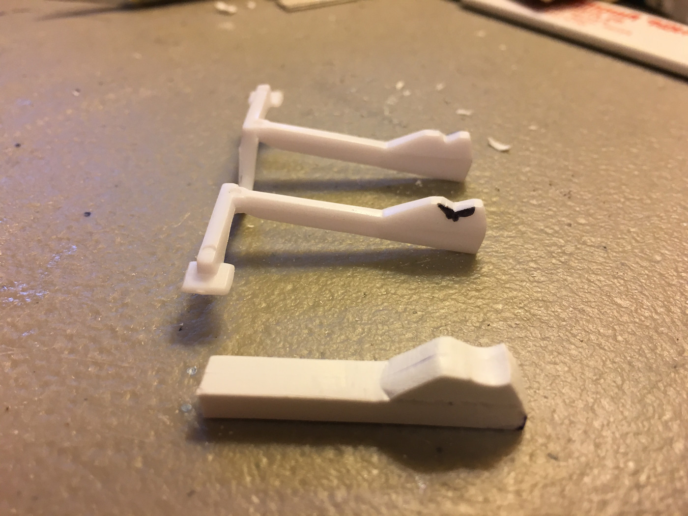

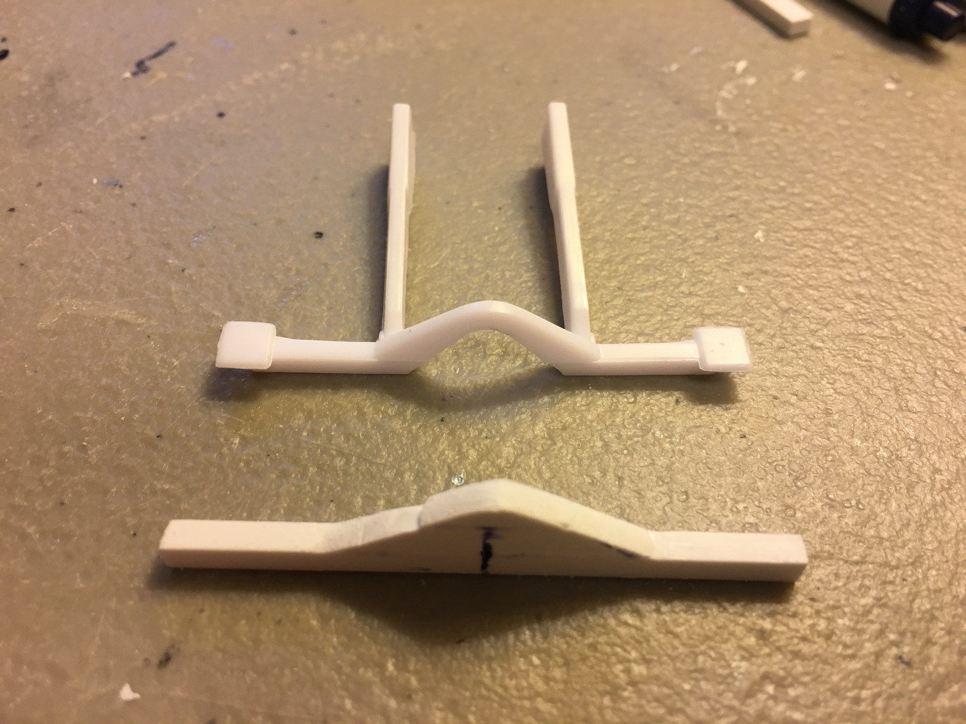

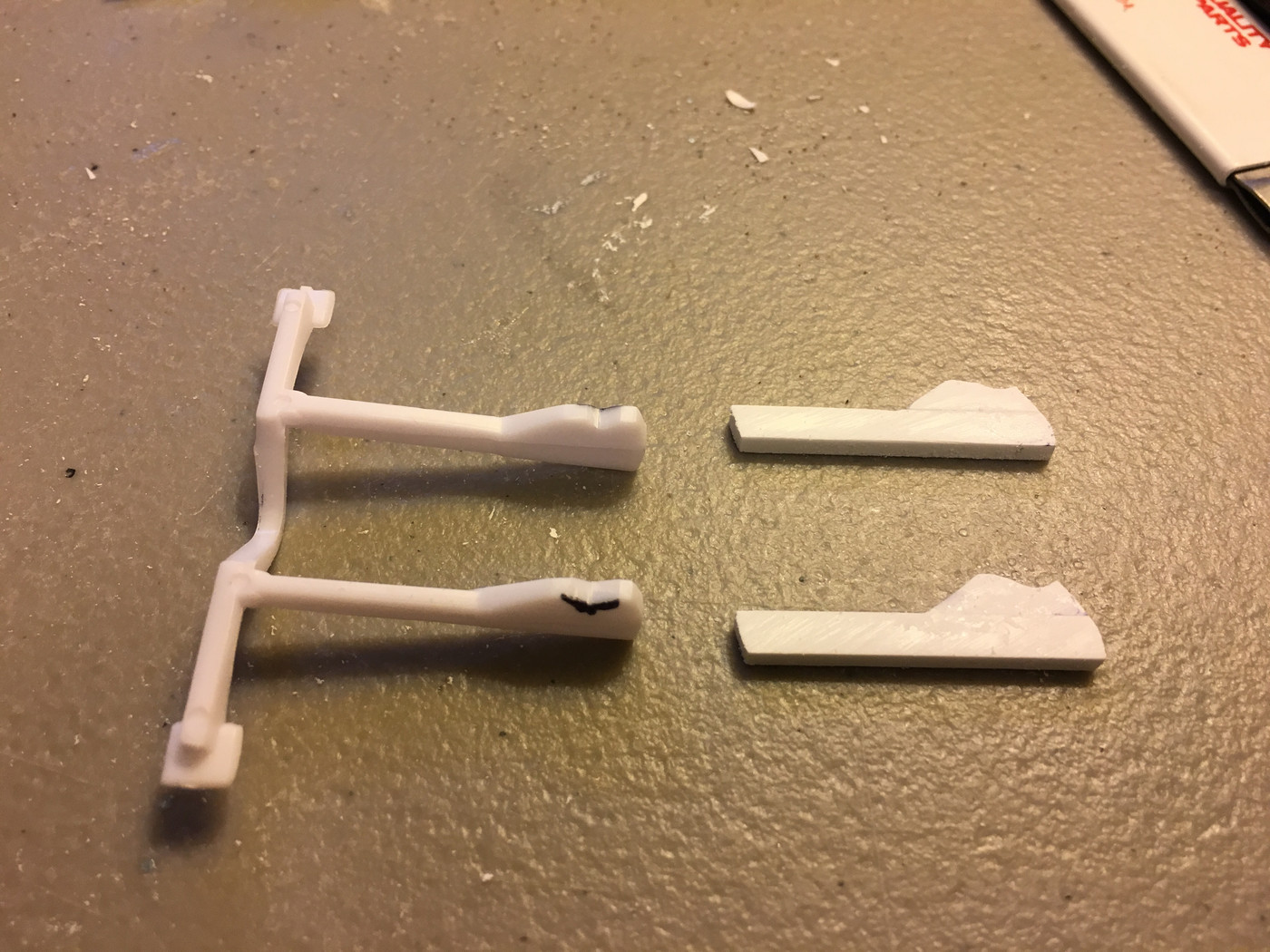

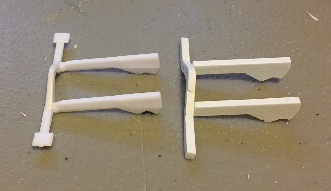

fairlane1320 Posted November 5, 2017 Author Posted November 5, 2017 I decided to use Thunderbolt traction bars, but they didn't fit. So I made a similar set.

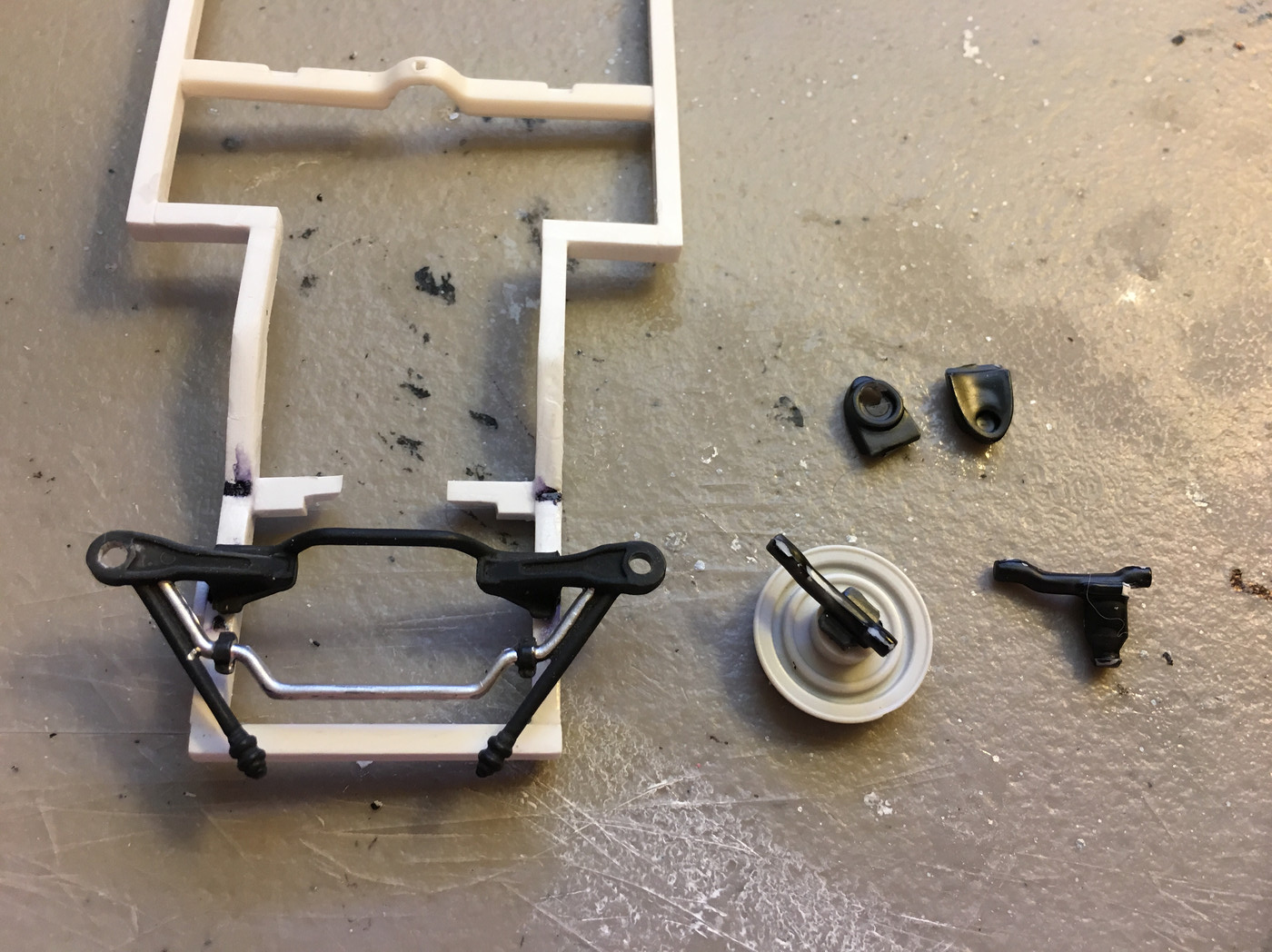

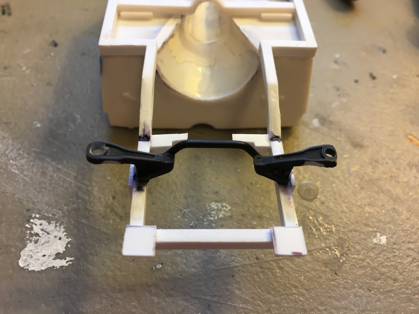

fairlane1320 Posted November 5, 2017 Author Posted November 5, 2017 The front suspension is from the AMT '66 Fairlane, slightly modified.

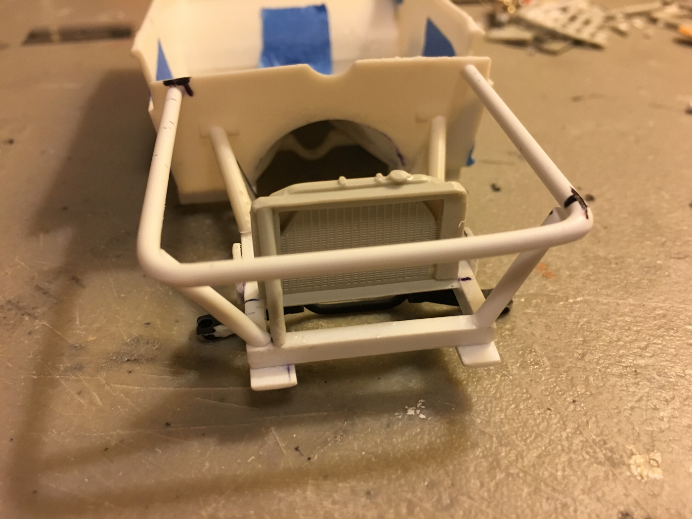

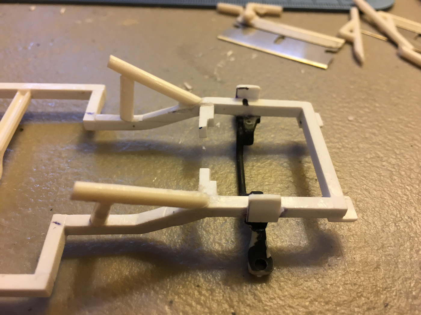

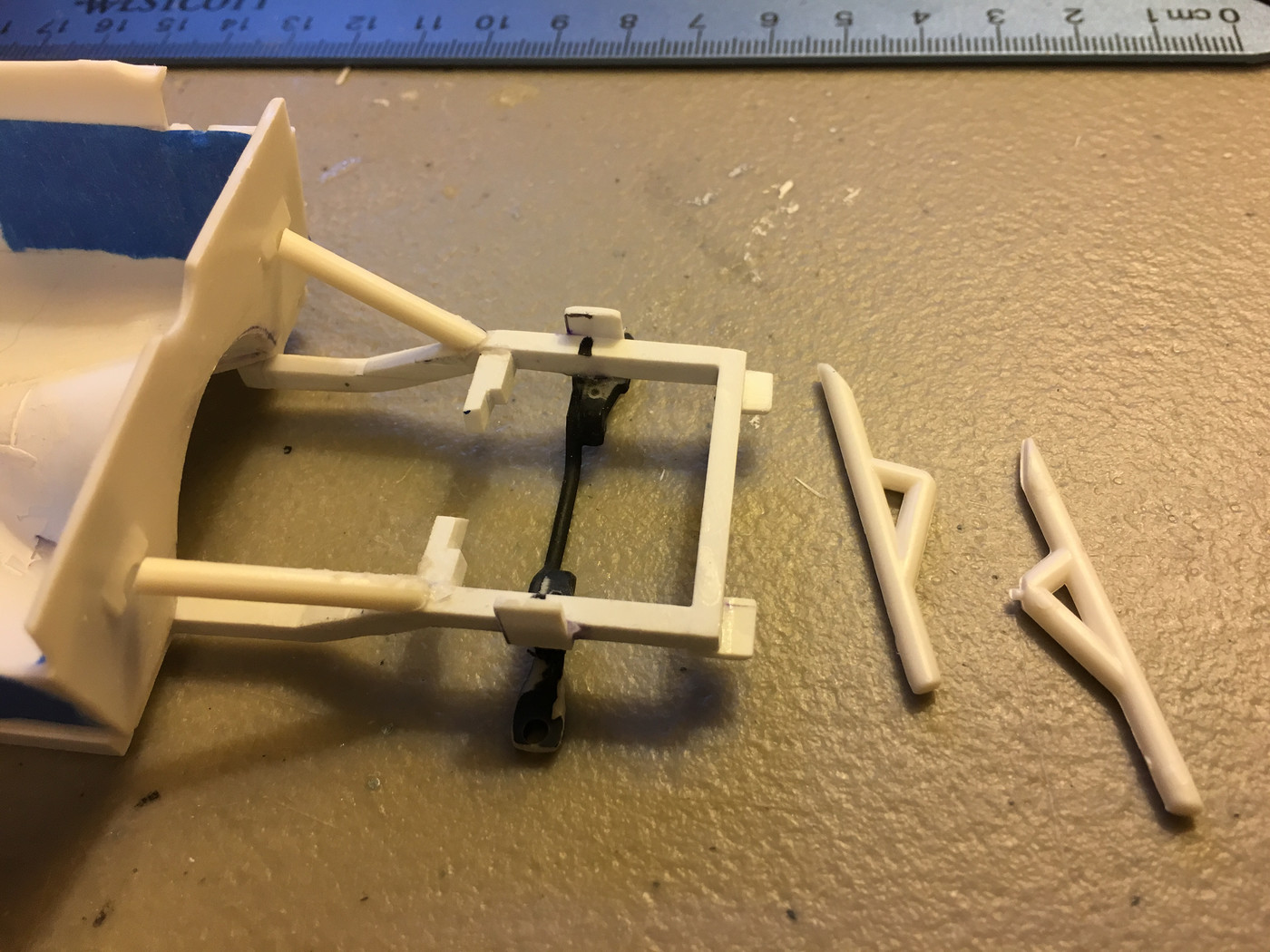

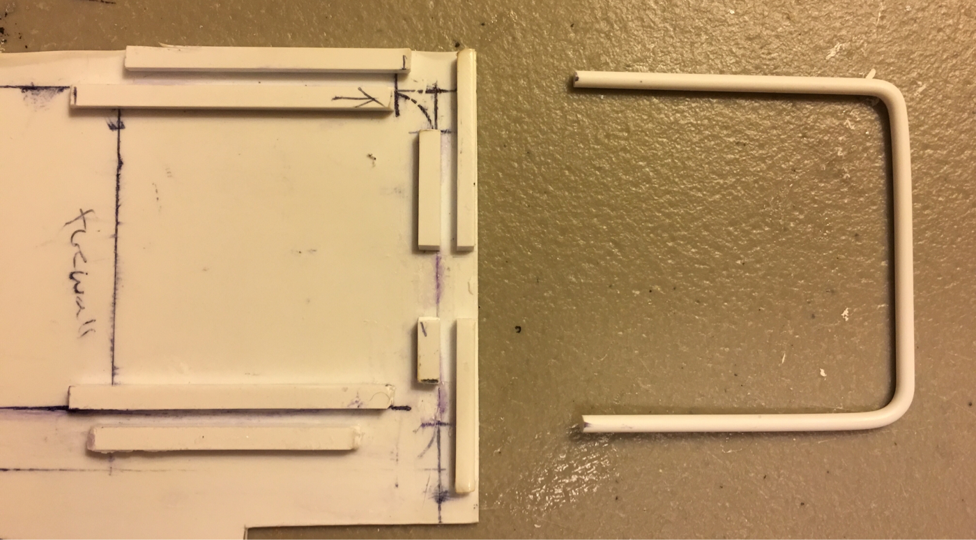

fairlane1320 Posted November 5, 2017 Author Posted November 5, 2017 The front support bars are next. The Comet kits bars didn't fit, so I had to make these up too.

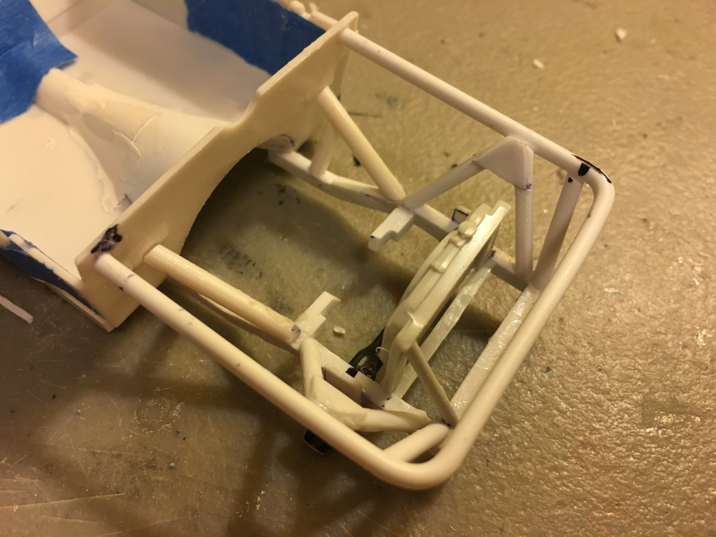

fairlane1320 Posted November 5, 2017 Author Posted November 5, 2017 I made a jig to make the front upper support bar, it's similar to the 60s stock car. It also serves to support the body under the front fenders.

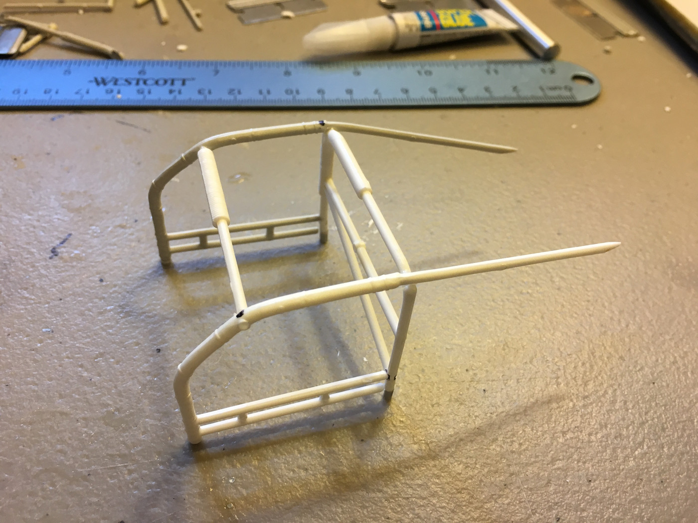

fairlane1320 Posted November 5, 2017 Author Posted November 5, 2017 The modified roll cage came from an AMT '69 Torino Cobra kit. Yes, it's right hand drive!
fairlane1320 Posted November 7, 2017 Author Posted November 7, 2017 Nice work. Are you making it right hand drive? Thx! Yes it will be RHD like the real car it's based one......

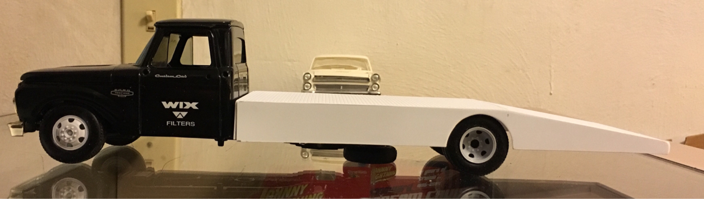

fairlane1320 Posted November 7, 2017 Author Posted November 7, 2017 It's coming along, building a matching ramp truck too....

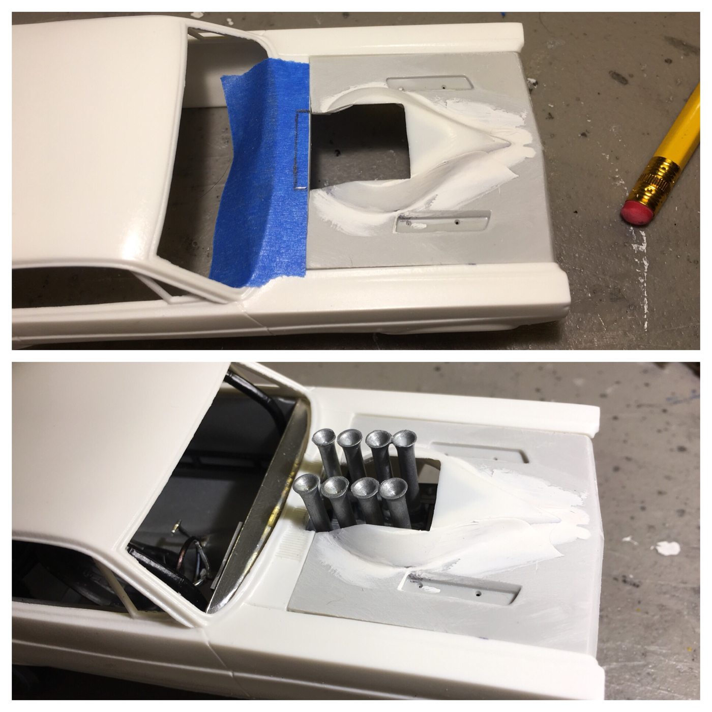

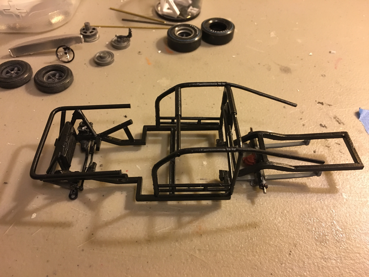

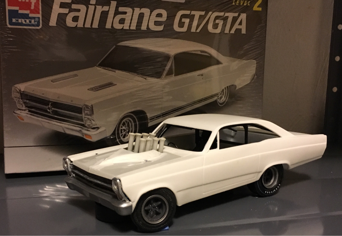

fairlane1320 Posted November 13, 2017 Author Posted November 13, 2017 Chassis is painted and assembly is ongoing. Injector stacks will require some notching the cowl panel.
fairlane1320 Posted November 30, 2017 Author Posted November 30, 2017 Back on the bench after the long holiday break, making the injector tubes fit...
afx Posted November 30, 2017 Posted November 30, 2017 (edited) Coming along nicely Ron. You probably already know this ( I see you are planning on installing a C-6) but I asked about the correlation with tall injectors and auto trans and here are the responses I received. Edited November 30, 2017 by afx
