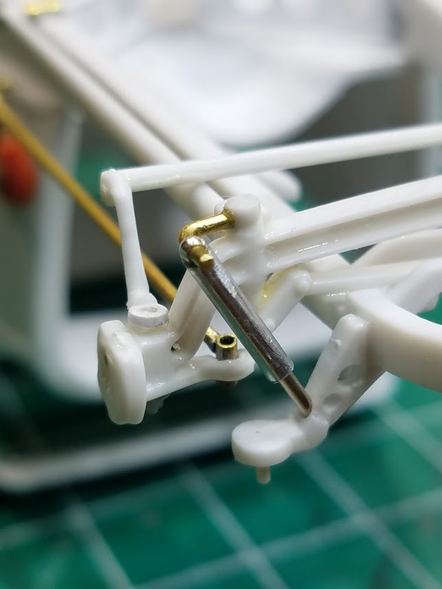

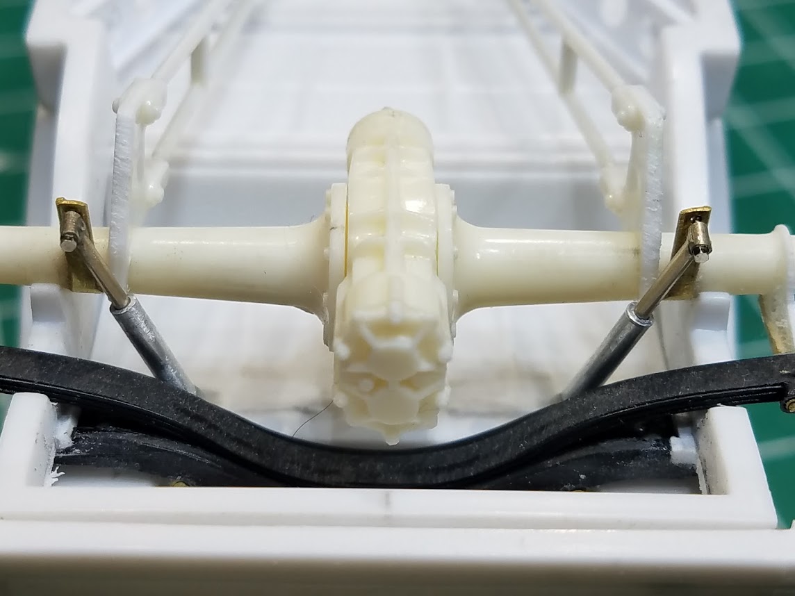

Taxdude Posted December 2, 2017 Author Posted December 2, 2017 Got some time to sort out the front suspension. Front and rear shocks are done all the way around. New lower shock mounts on the front axle The kit front shock and headlight mounts have been thinned down as they are too thick. Also added an extra lightening hole. Cowl side steering arm and drag arm. Rear end axle shock mounts had been completed and installed. Next step is to make some motors mounts and maybe a motor too.

Spex84 Posted December 4, 2017 Posted December 4, 2017 Well there's an endorsement if I ever heard one If I wasn't on board before (and I was!), then those lower front shock mounts would have convinced me. Darn nice work! I once bent up some F1 truck-style front shock mounts for a hot rod project, then considered how fiddly they'd be to securely mount, and decided against it. After seeing this, I'm wondering if I should try again. Very inspiring stuff!

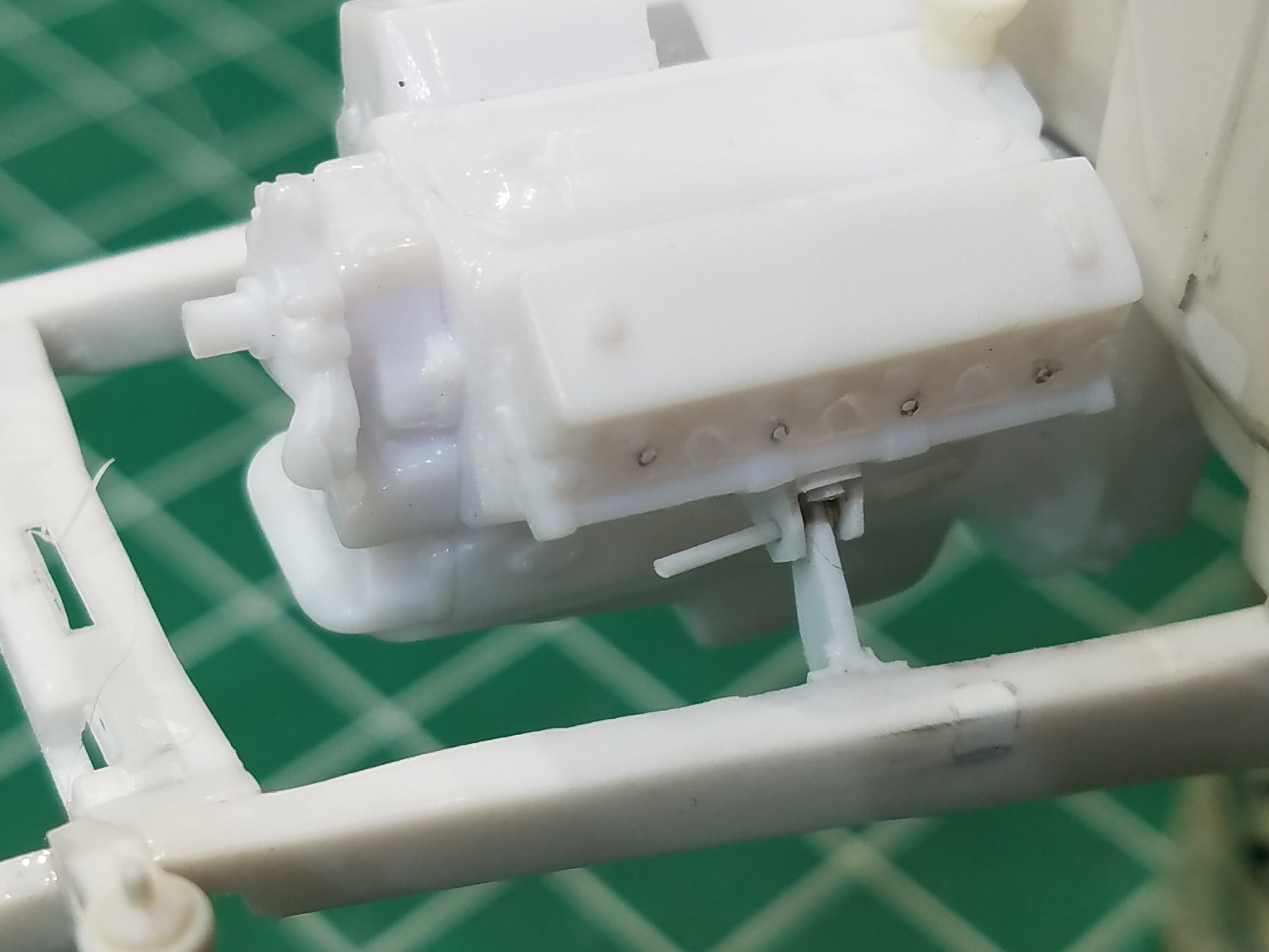

Taxdude Posted December 19, 2017 Author Posted December 19, 2017 (edited) Time, the final frontier or lack thereof. Had some time again to work on the coupe. Build the motor mounts., rebuilt the motor mounts a bit smaller, launched a new better motor mount into the modeling unknowns, built one more. Looks like I'm going to have to order shorter bolts I also built a one-off intake. To convert the 2 barrel intake to one that could take two Stromberg 97's And a motor mount picture out of order. Edited December 19, 2017 by Taxdude
