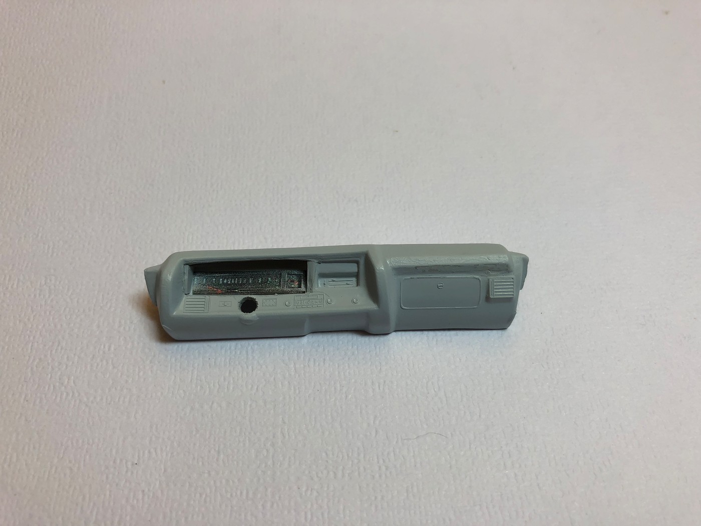

Modified the dash from the SS version to match Jim's.

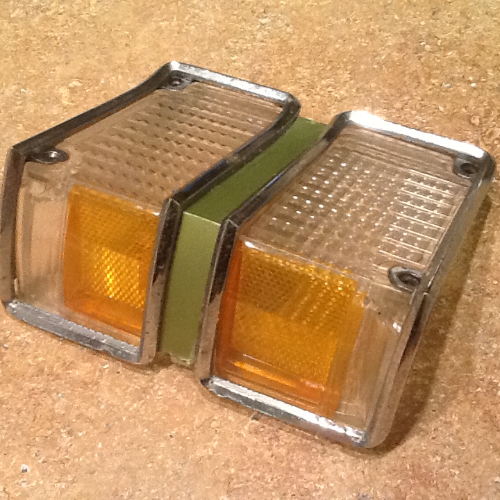

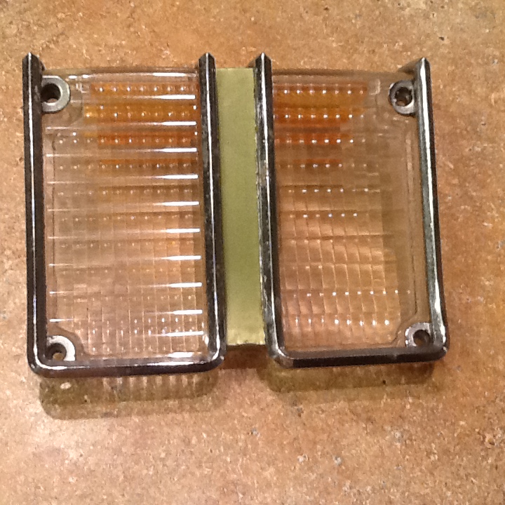

I have had success replicating the 71 front end by adding a small slice of pinstripe tape painted the body color to replicate the horizontal division between the turn signals (although it looks like the subject's turn signal bezels may have been re-chromed omitting the yellow in the divider). In the photos below you can see the body colored stripe which is 5/8" tall and the chrome trim is .25". Also note that the amber reflector is side facing only. From head on the lens is clear with an amber bulb being used.
The grill needs a horizontal center bar added from fine strip syrene covered in BMF and a black wash to the rest which makes it a suitable likeness.
Don't forget that there will also be body color between the headlight trim and the grill as shown in the original photos.

Thanks, Tim. I did notice there was a bit of work to do in that area, so I'm working that out in my mind still. I appreciate your input!
