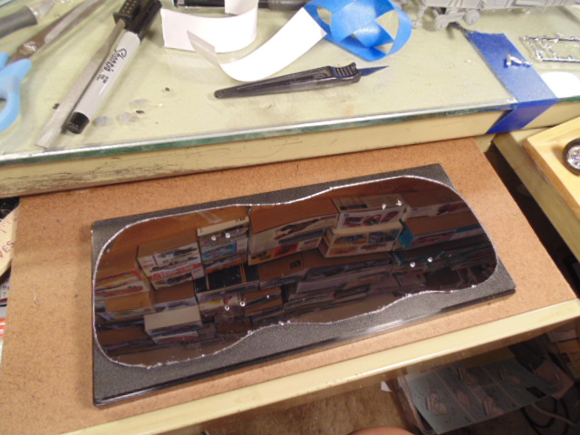

Bucky Posted December 10, 2017 Posted December 10, 2017 I have several of these showcases. They are handy for keeping my builds safe, and dust free. Here is my method of madness when mounting a model on the base of the showcase: This is the showcase I used for this one. It has a black base, clear cover, and four coated wires. I located "Lo-Velle" on the base. I turned the base over, and selected the holes I needed to drill out. This shows the holes, after drilling. I didn't want to use a plain black base, so I grabbed the above item from the local auto parts emporium. I made a template to use for a pattern. I cut the pattern, and added double-sided tape. The mirror is stuck to the base, with the holes drilled through, and the protective film peeled off. Here are two of the wires in place, on the rear axle. The front wheels will have similar wires. "Lo-Velle" is attached securely to the base. The mirror shows the undercarriage detail. The cover keeps the model relatively dust and damage free. AND......they are stackable!!!!
Snake45 Posted December 10, 2017 Posted December 10, 2017 Tell us more about that cut-to-fit mirror stuff. Seems like it might have all kinds of model applications.
Bucky Posted December 10, 2017 Author Posted December 10, 2017 This material is for replacing broken automotive mirrors. It can be trimmed to the shape of the mirror, and put in place with the double-sided tape. It looks to be a mylar coated plastic sheet. I cut it with metal shears. It's a fairly tough plastic. One sheet can do two of these showcases. I have used This product on several cases.
espo Posted December 10, 2017 Posted December 10, 2017 11 hours ago, Bucky said: This material is for replacing broken automotive mirrors. It can be trimmed to the shape of the mirror, and put in place with the double-sided tape. It looks to be a mylar coated plastic sheet. I cut it with metal shears. It's a fairly tough plastic. One sheet can do two of these showcases. I have used This product on several cases. Thank you for the heads up on this product. I had never seen this product before. As Snake45 pointed out there are many ways that this could be used.
Snake45 Posted December 10, 2017 Posted December 10, 2017 43 minutes ago, espo said: Thank you for the heads up on this product. I had never seen this product before. As Snake45 pointed out there are many ways that this could be used. Yes, thanks. I'm gonna look for this next time I'm in an auto parts place.
