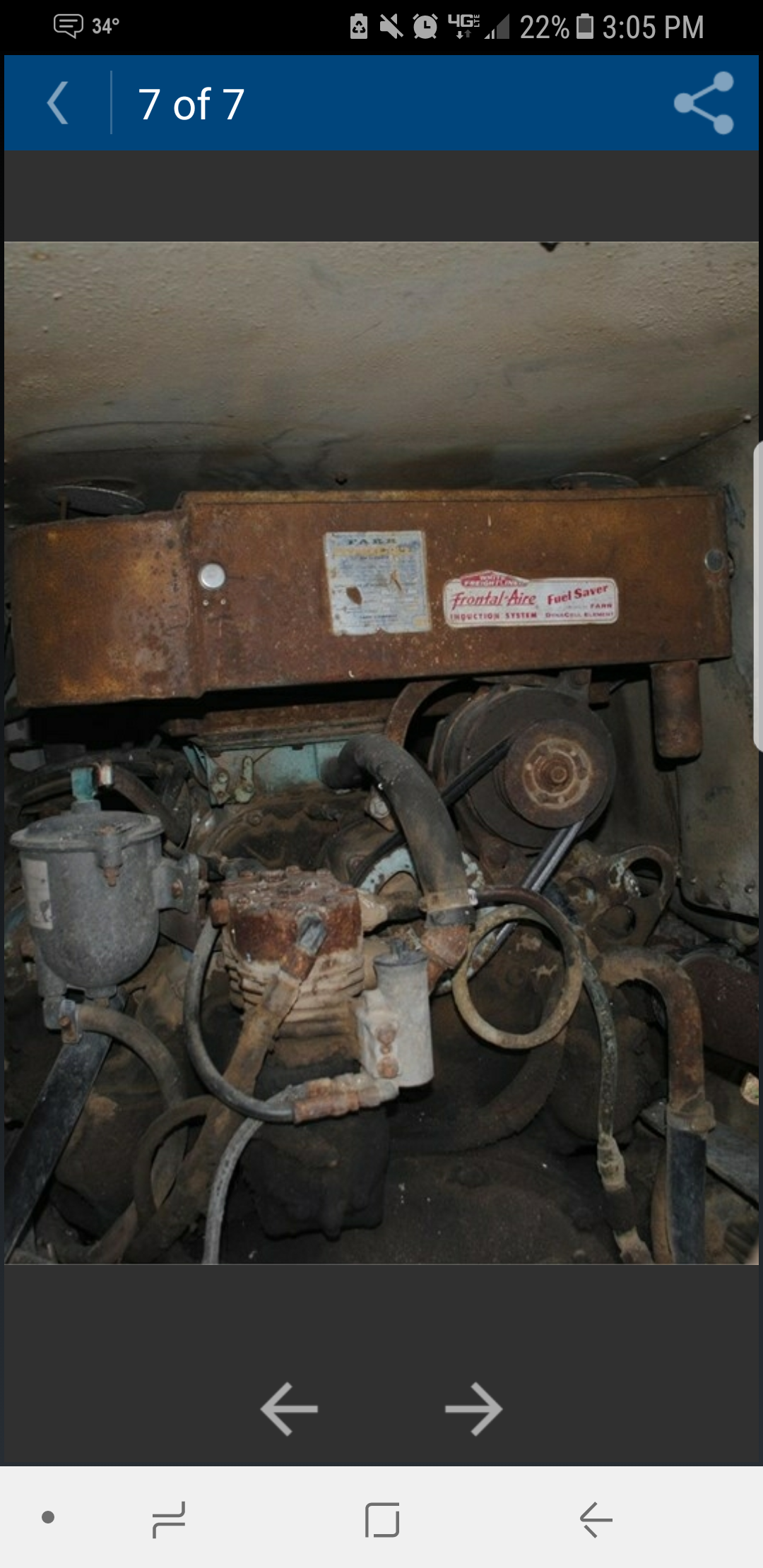

TheSDTrucker Posted January 15, 2018 Author Posted January 15, 2018 On 1/12/2018 at 9:11 PM, Muncie said: Farr Dynacell air cleaners with frontal air intake thru the nose skin like the AMT kit and the brochure were (probably?) not available with the 8V-71 engine. The Farr air cleaner mounted easily on the inline Cummins engines but the main problem is that they didn't flow enough air to meet Detroit Diesel Engineering requirements. I know for certain that it wasn't enough for the 8V-92's but at best they would have been marginal for the 8V-71 - maybe OK for the naturally aspirated 8V-71, but not for the 8V-71T - not sure about it on a 1971 to '73, but I'm sticking to it. Some of the high horsepower 8V-92's that came later even required dual 16" diameter air cleaners - yeah, try to locate that where the trailer doesn't hit it. I think your reference truck has stationary air intake with the air cleaner mounted on the exhaust cross braces - that would be correct for the 8V-71T. The alternative with single exhaust is to frame rail mount the air cleaner under the cab ahead of the fuel tank. I've only ever seen one 8v71 with the Farr air cleaner on it. It's for sale right now actually.
Muncie Posted January 15, 2018 Posted January 15, 2018 1 hour ago, TheSDTrucker said: TI've only ever seen one 8v71 with the Farr air cleaner on it. It's for sale right now actually. that's pretty cool! - neat to know - you found something that I wasn't aware of. do you have a link for the truck for sale? by the time my Freightliner time started there weren't too many 8V's around - almost zero 8V-71's and only a handful of 8V-92's.
TheSDTrucker Posted January 16, 2018 Author Posted January 16, 2018 (edited) I know it's in TN, I'll look for the link Edited January 16, 2018 by TheSDTrucker

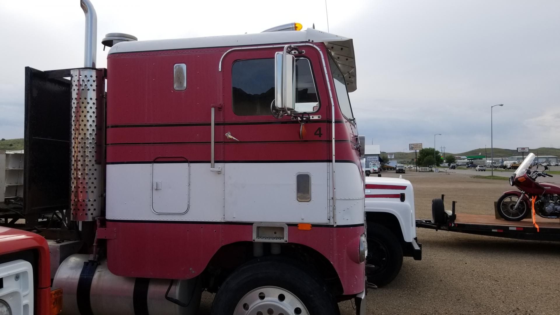

TheSDTrucker Posted January 16, 2018 Author Posted January 16, 2018 1 hour ago, Muncie said: that's pretty cool! - neat to know - you found something that I wasn't aware of. do you have a link for the truck for sale? by the time my Freightliner time started there weren't too many 8V's around - almost zero 8V-71's and only a handful of 8V-92's. I just found the link, it's in Covington TN. It's in rough shape, but with some time and skilled work, it could be put back on the road. https://www.truckpaper.com/listings/trucks/for-sale/17805745/1971-freightliner-fla96
37 caddy Posted January 16, 2018 Posted January 16, 2018 That old truck looks like its been ridden hard and put away wet?,there are some good shots for details you normally dont see,it has stack towers very similar to the kit ones,wouldnt be hard to replicate that.It has the small emblem on the grille top,it is a pointed type,not the rectangle one in the kit.The cab in the kit is an oddball cab,they had a very limited run of the cab steps,was a one year only?.I have never seen one in person that is the same cab with those type of steps.There were some pictures on here of the real one that had those steps. Harvey
TheSDTrucker Posted January 16, 2018 Author Posted January 16, 2018 39 minutes ago, 37 caddy said: That old truck looks like its been ridden hard and put away wet?,there are some good shots for details you normally dont see,it has stack towers very similar to the kit ones,wouldnt be hard to replicate that.It has the small emblem on the grille top,it is a pointed type,not the rectangle one in the kit.The cab in the kit is an oddball cab,they had a very limited run of the cab steps,was a one year only?.I have never seen one in person that is the same cab with those type of steps.There were some pictures on here of the real one that had those steps. Harvey It seems like all Freightliners were oddballs back then. I confirmed the one I'm basing my build off of is a 1972. It's in MUCH better shape than the white truck the link sends you to.

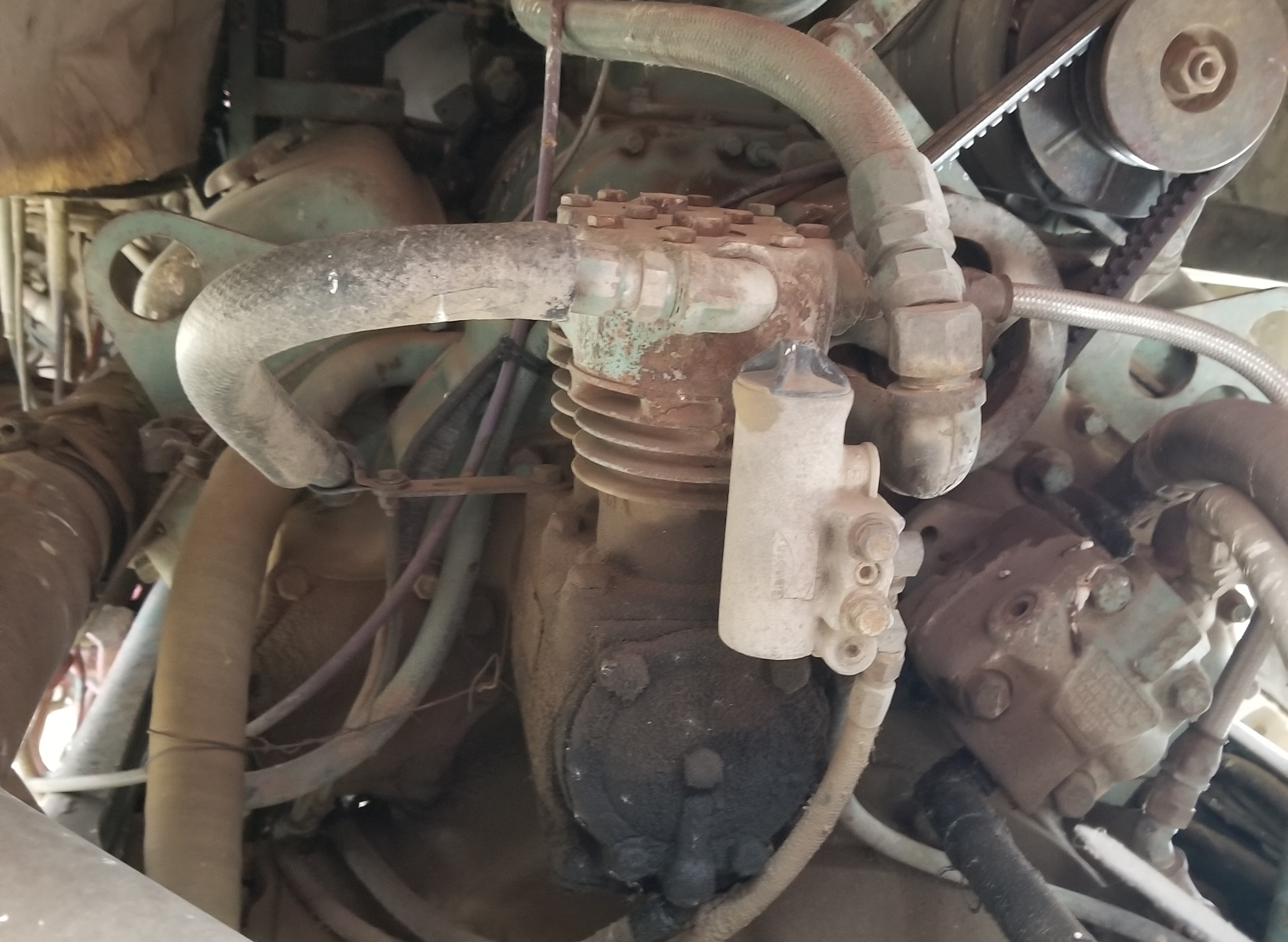

TheSDTrucker Posted January 17, 2018 Author Posted January 17, 2018 Is this the air pump on a Detroit? If so, where do all these hoses lead to?
