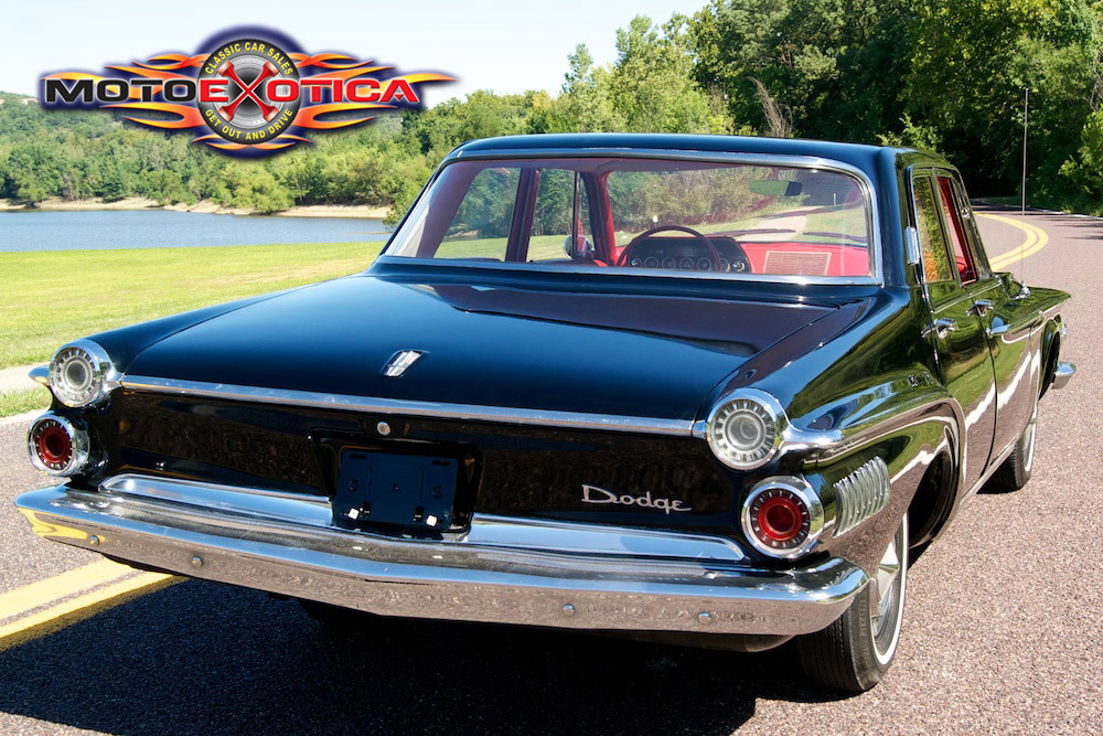

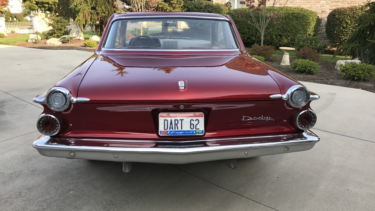

RichCostello Posted January 9, 2018 Posted January 9, 2018 I just got an old Jo-Han 62 Dart and the dash in the kit looks different than the ones in pics on Google. Is it the wrong one ? Also, some of the pics show the tail lights with the red lights on the top spot, and others show them on the lower one. Which way is right? I'm thinking about bashing it with a Lindberg 64 330 for chassis, and engine, etc. has anybody tried this, and how much of a pain is it? Thanks for any help.
Casey Posted January 9, 2018 Posted January 9, 2018 22 minutes ago, RichCostello said: I just got an old Jo-Han 62 Dart and the dash in the kit looks different than the ones in pics on Google. Is it the wrong one ? Yes. 22 minutes ago, RichCostello said: Also, some of the pics show the tail lights with the red lights on the top spot, and others show them on the lower one. Which way is right?

RichCostello Posted January 9, 2018 Author Posted January 9, 2018 So, above the tail light, is that just a chrome trim piece? I thought it might be a back up light.
StevenGuthmiller Posted January 9, 2018 Posted January 9, 2018 45 minutes ago, RichCostello said: So, above the tail light, is that just a chrome trim piece? I thought it might be a back up light. Depends on the trim level. Some were equipped with backup lights, others were not. Steve

Art Anderson Posted January 9, 2018 Posted January 9, 2018 8 hours ago, StevenGuthmiller said: Depends on the trim level. Some were equipped with backup lights, others were not. Steve By 1962, backup lights were standard on most makes of cars, in their highest trim level--but they were also an available option on lesser versions.
