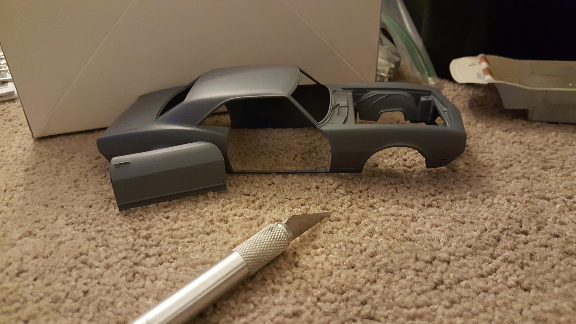

Plastic_Passion Posted January 29, 2018 Posted January 29, 2018 First time I've done this. I'm thinking pro mod build.... it's originally a 68 z28 but I'll be making it a 67.
dino246gt Posted January 29, 2018 Posted January 29, 2018 '67 have vent windows, '68 did not, why make it a '67? That's a lot more work for an open door project. I'd keep it '68 myself. You must have a reason?
Slotto Posted January 29, 2018 Posted January 29, 2018 You've concurred the first step. Nice clean opening. Now the fun begins
Plastic_Passion Posted January 29, 2018 Author Posted January 29, 2018 (edited) 4 hours ago, dino246gt said: '67 have vent windows, '68 did not, why make it a '67? That's a lot more work for an open door project. I'd keep it '68 myself. You must have a reason? Lol I am aware of the vent window. The 68 also didn' have a marker light in the front and had rectangle parking lights in the grill... I have a 68.... correction.... two 68's and a 69... but I have parts for a 67. So since I have a 68 on my shelf, and a 69 on it's way there.... why not go idea bin digging and start kit bashing and testing things out on a car that realistically doesn't matter to me if it gets messed up... if it doesnt work out with the vent window I'll just throw the other 68 grill in it and leave the marker light on the front fender and keep it a 68. I also have a 70 1/2 camaro that I'll be building when I pick up the pe kit for it. Amongst other goodies. Edited January 29, 2018 by Plastic_Passion

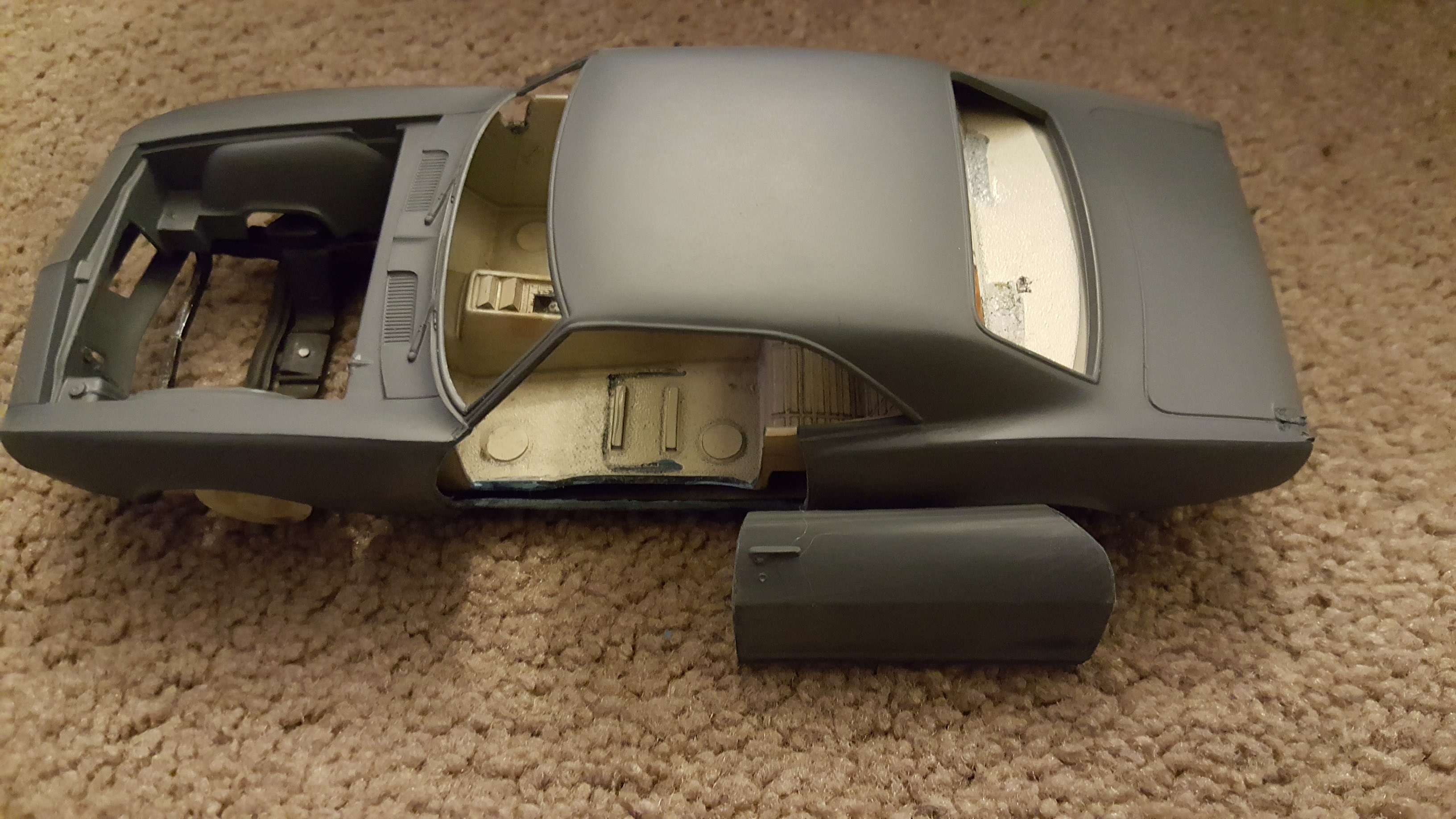

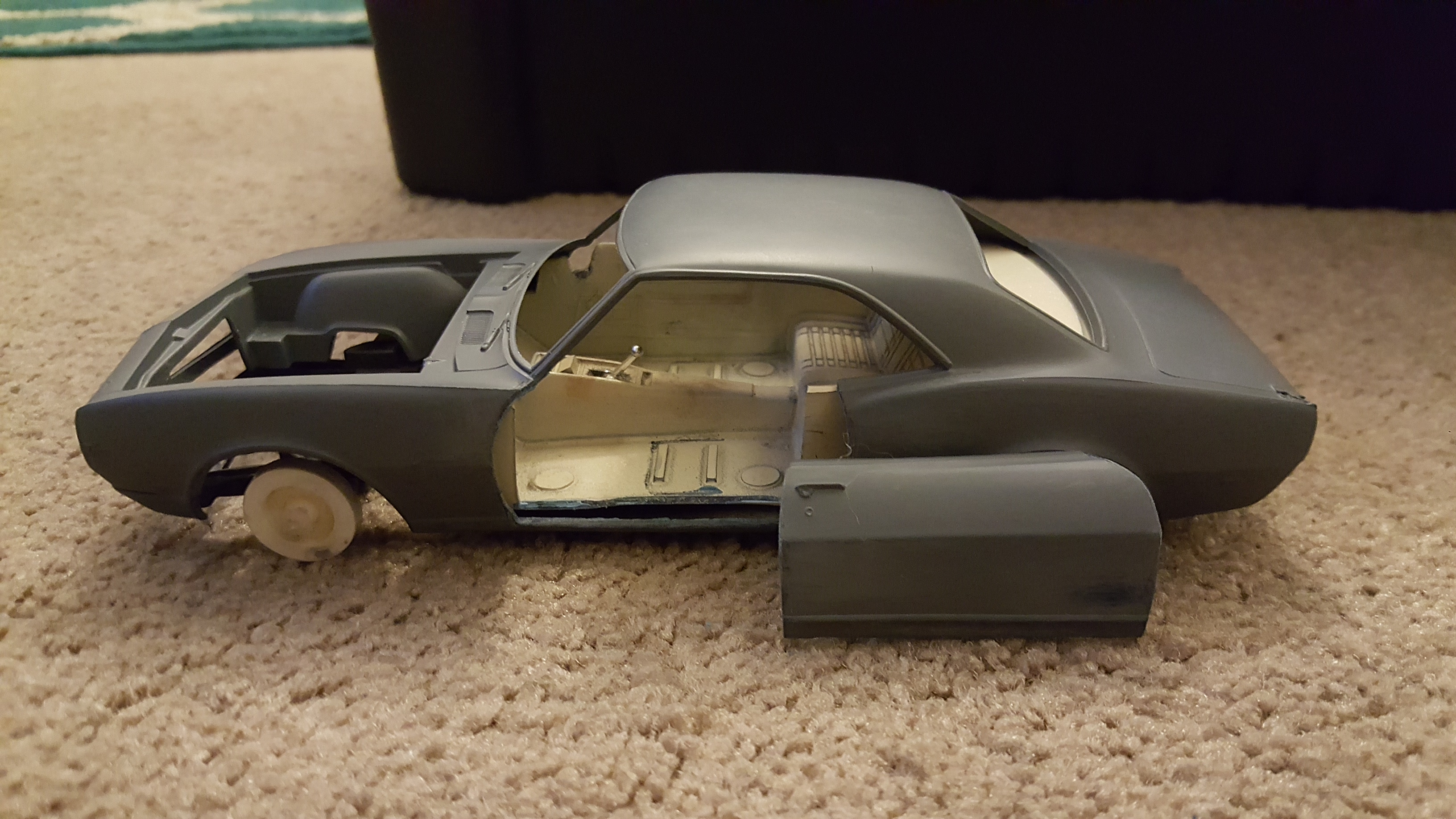

Plastic_Passion Posted January 30, 2018 Author Posted January 30, 2018 Well.... it appears the window vent might not be the worst nightmare. However.... this interior tub might be.... pretty sure this tub is about 6 scale inches too short in the door panels.
Greg Rogers Posted January 30, 2018 Posted January 30, 2018 Wow, bummer about the interior. Would you be able to move the whole interior back in the body, or maybe just the rear seat? I am a novice, I know I couldn't do it! It seems funny that the manufacturer would make such a disparity. Though maybe after the model was built as instructed maybe you wouldn't see it. But it seems like you would looking thru the side windows. Good luck.
Psychographic Posted January 30, 2018 Posted January 30, 2018 (edited) The tub is not too narrow, you need to build the door sills and jambs to reach it. You will also need to build the door edges also. Look at a real car and you will see what I mean. Edited January 30, 2018 by Psychographic
Slotto Posted January 30, 2018 Posted January 30, 2018 18 hours ago, Plastic_Passion said: Thanks Steve! I'm excited to try it out. I really want to cut the trunk open too but it's pretty thick in that rear panel. You can do it. The first time that I open the doors it was on a 56 Chevy. I also opened the trunk. It's a learning experience and the more you do it, the easier it gets the next time. I'm on my 4th build where I've opened doors. This time it's suicide doors. If you run into trouble, there's plenty of people here that can help. One trick is to pay attention how you attach the hinge. This will determine if the door opens in or out of the jamb. Good luck, I'll be following along.
Psychographic Posted January 30, 2018 Posted January 30, 2018 If I might add a little tip I've learned, don't cut your door, hood , trunk, or whatever all the way through before making you hinge. What I do is cut about 90% of the panel leaving a few little sections connected. I then make and mount my hinge, this way the panel is already aligned. Then just cut the little but that is still connected. The hinge cannot have any binding, or when you cut the panel the rest of the way through it will not align properly.

GerN Posted January 30, 2018 Posted January 30, 2018 If the tub really is too short, front to back, I'd divide the tub at the front of the back seat. This would minimize the necessary work. Also, I think it may be less than 6 scale inches short.

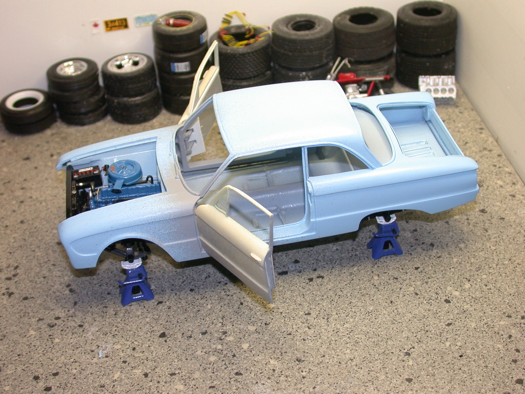

dino246gt Posted January 31, 2018 Posted January 31, 2018 I don't think the interior tub is too short, well maybe a bit, but not much, the real car doors open to reveal a bit of the rear inside trim like what you see in your picture. Google it and see, but what you've done so far looks great! Here's a resin Falcon body I'm doing, although it's not quite as noticeable on cheap early cars, you can see the outer door skin goes further back than the interior rear side panel.

Plastic_Passion Posted February 2, 2018 Author Posted February 2, 2018 On 1/30/2018 at 8:32 AM, Psychographic said: The tub is not too narrow, you need to build the door sills and jambs to reach it. You will also need to build the door edges also. Look at a real car and you will see what I mean. I looked @ a bunch of pics of 1:1 cars as I usually do. Lots and lots of pics saved and filed for each specific model. The tub is just a touch too short . It's spot on in the front of the door jamb but the back is just a tad too short. If I slide the tub back it'l work but then the rear deck behind the seats is a little off. Not really enough to notice. However... it'll be noticeble up front. I think I need to cut the floor and extend it just a bit.
Plastic_Passion Posted February 2, 2018 Author Posted February 2, 2018 On 1/30/2018 at 12:35 PM, Psychographic said: If I might add a little tip I've learned, don't cut your door, hood , trunk, or whatever all the way through before making you hinge. What I do is cut about 90% of the panel leaving a few little sections connected. I then make and mount my hinge, this way the panel is already aligned. Then just cut the little but that is still connected. The hinge cannot have any binding, or when you cut the panel the rest of the way through it will not align properly. This is definitely a priceless tip. Great trick of the trade to have up your sleeve. Thank you for sharing this!!!

Plastic_Passion Posted February 2, 2018 Author Posted February 2, 2018 On 1/31/2018 at 11:01 AM, dino246gt said: I don't think the interior tub is too short, well maybe a bit, but not much, the real car doors open to reveal a bit of the rear inside trim like what you see in your picture. Google it and see, but what you've done so far looks great! Here's a resin Falcon body I'm doing, although it's not quite as noticeable on cheap early cars, you can see the outer door skin goes further back than the interior rear side panel. I know your right about the trim. This is just a touch too far forward. I'll post a comparo pic. By the way that looks great!!!! I love the way you'e displayed this.
Plastic_Passion Posted February 2, 2018 Author Posted February 2, 2018 On 1/30/2018 at 2:25 PM, GerN said: If the tub really is too short, front to back, I'd divide the tub at the front of the back seat. This would minimize the necessary work. Also, I think it may be less than 6 scale inches short. This is what I was ultimately thinking as well. And you might be right it may not be 6 scale inches but it's gotta be close. Look at the door handle(Which also might not be scale correct) comparative to the extra plastic.
