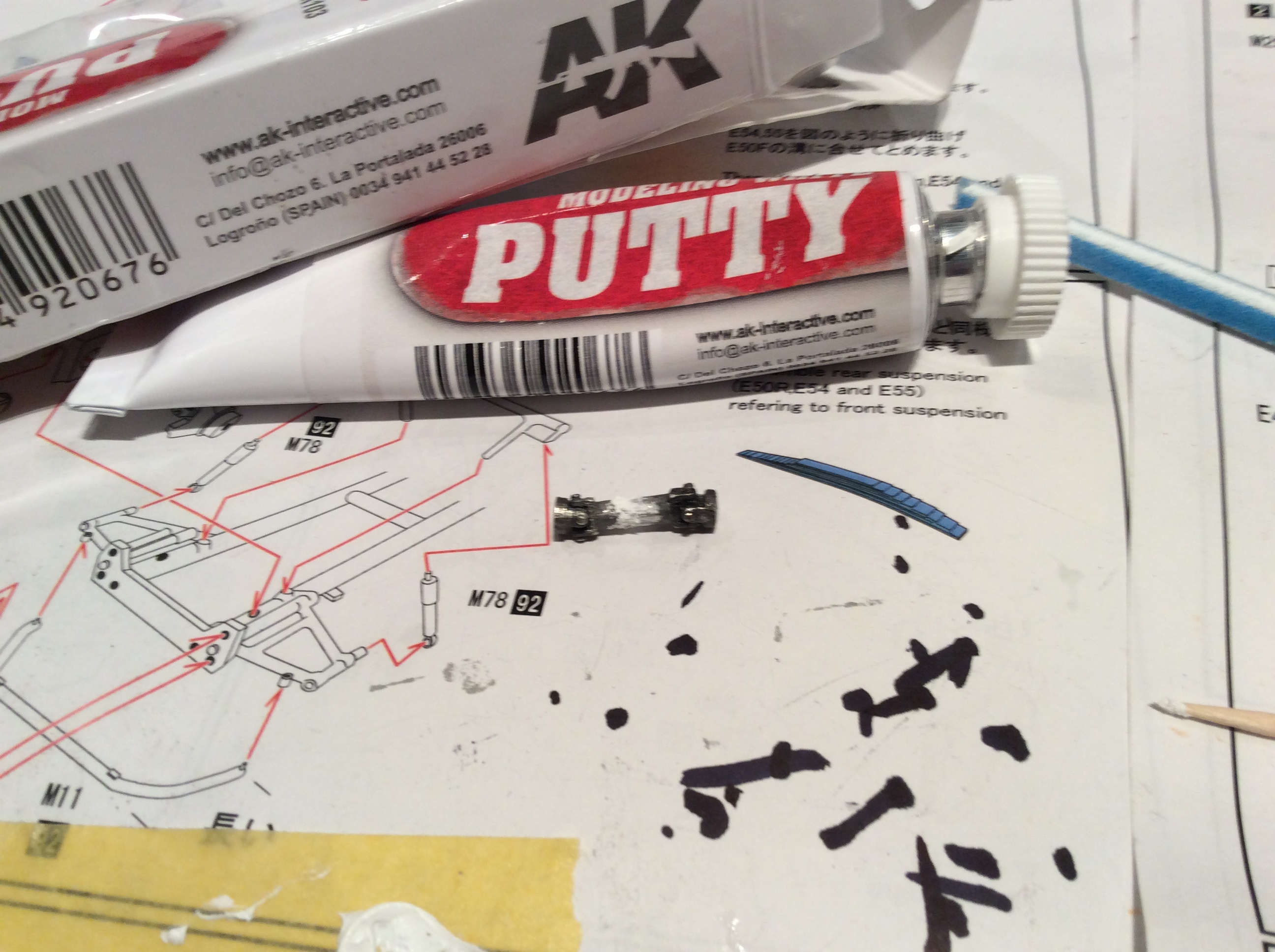

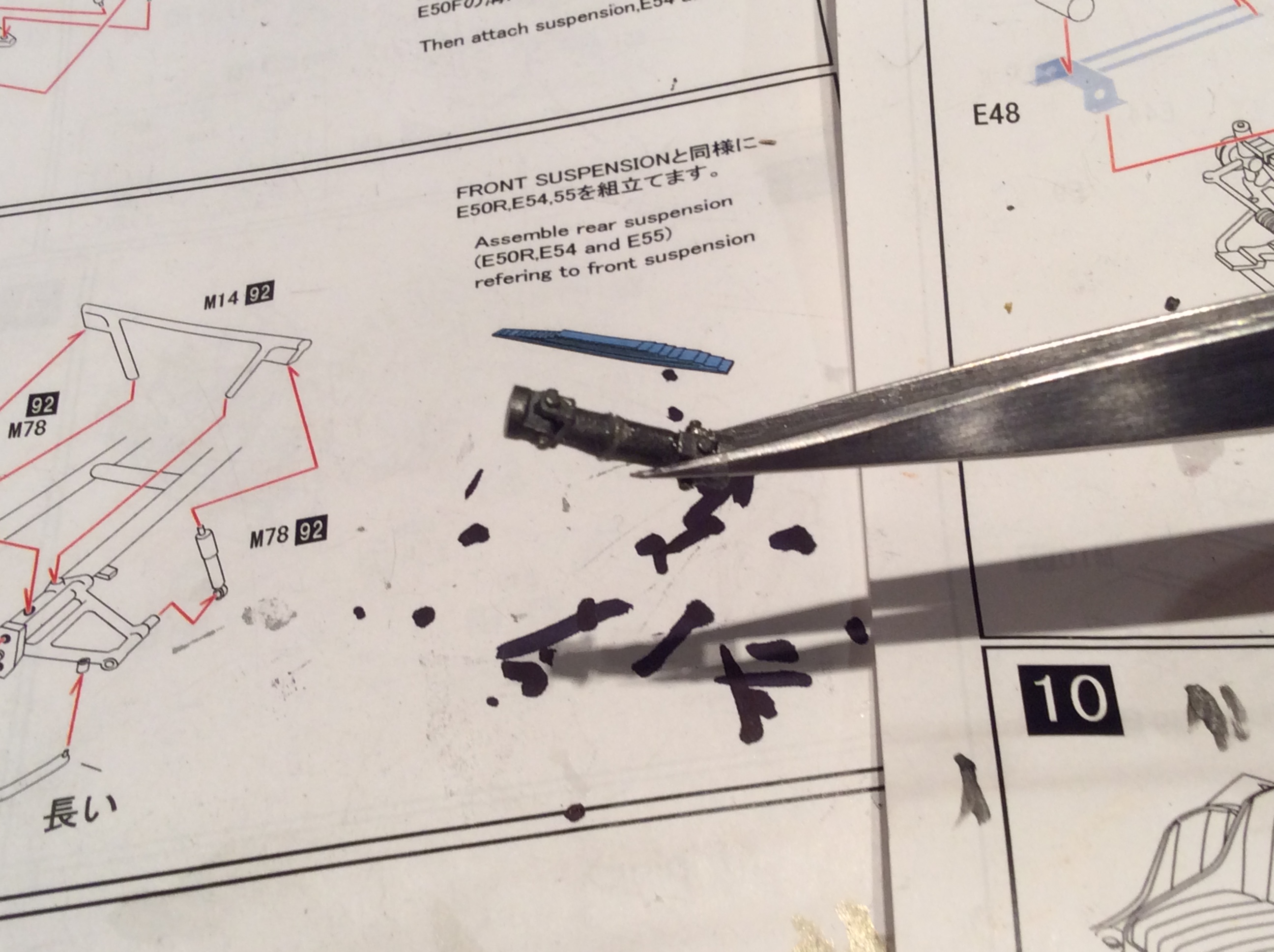

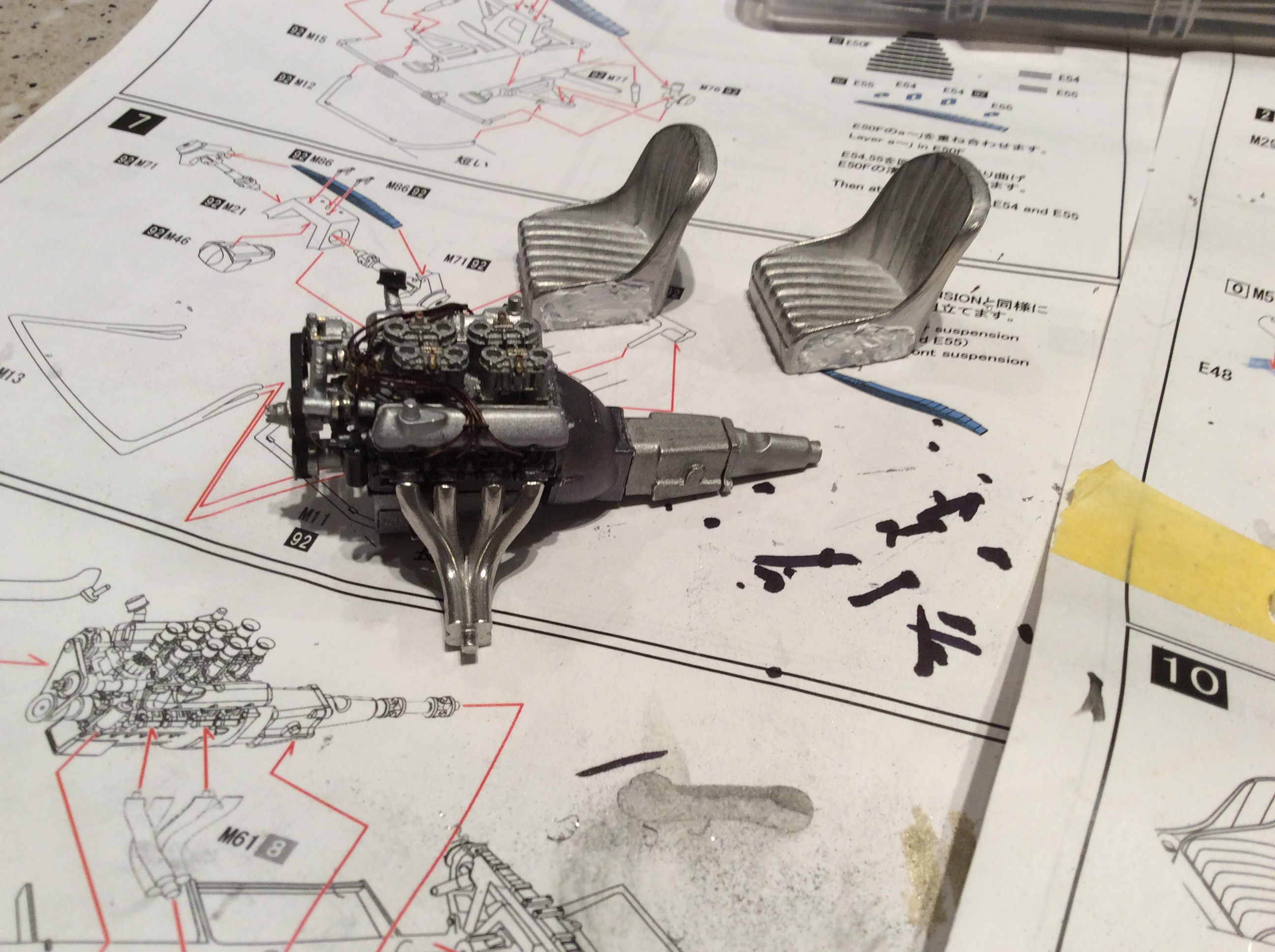

Gt fan Posted November 7, 2018 Author Posted November 7, 2018 Here are the pictures from earlier and a few new ones. The drive shaft didn’t fit at all. I had to cut it in half and glue it back together. After drying I put some putty on it to smooth out the seam. The heads were drilled out and the headers fitted with the side pipes. The finish on them is the way they came out of the magnetic tumbler. Gonna kill me to paint them black. I started on the seats as well. They had a few sink holes in them and a nasty side seam. Tomorrow I hope to be able to fit the motor in and get into the interior more.

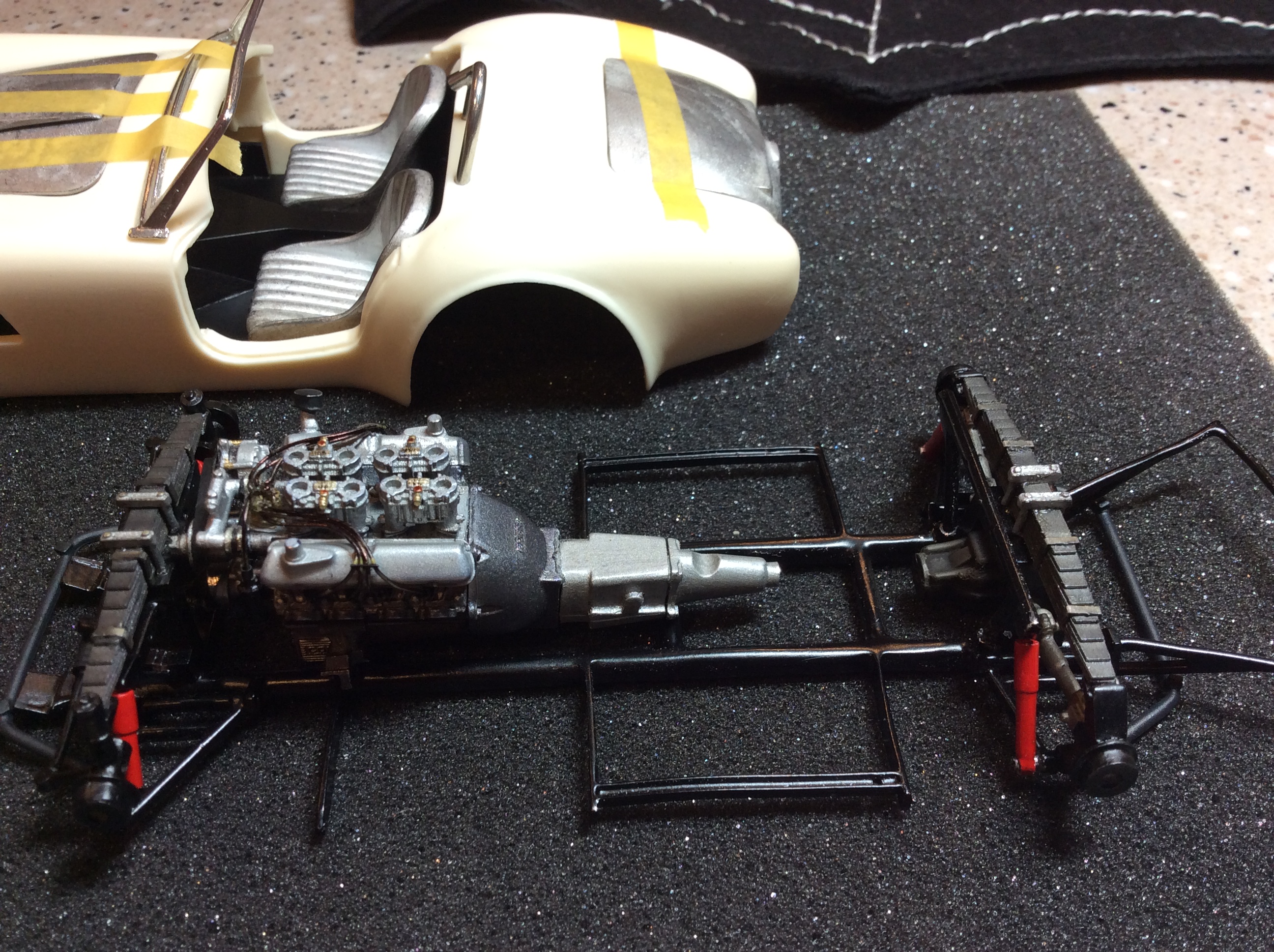

Gt fan Posted November 13, 2018 Author Posted November 13, 2018 Thanks for all the kinds words everyone...it’s been a labor of love.. thought it was gonna be a lawn dart a few times. Here is a update photo , lm working on the interior bucket and getting it to fit in the frame rails even. The seats are metal as well. I scribed the lines a bit deeper. The only resin part in the chassis so far is the interior bucket . It has some weight too it

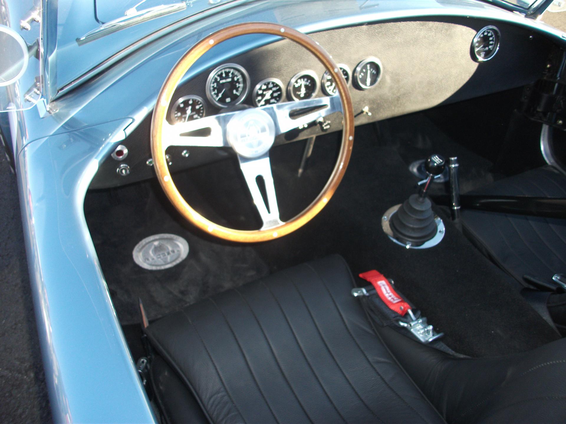

Gt fan Posted November 13, 2018 Author Posted November 13, 2018 Thanks for the heads up on the local.on the shifter. I may pull it out and fill the hole and repaint it. I just need to see if I have a kit that has a good one in it. I'm looking for a good picture of where the seat beats good on the seat and where they pass though.
Mark IV Posted November 13, 2018 Posted November 13, 2018 The belts do not pass through the seat, they come from the side and are mounted behind the outer edges of the seats.
