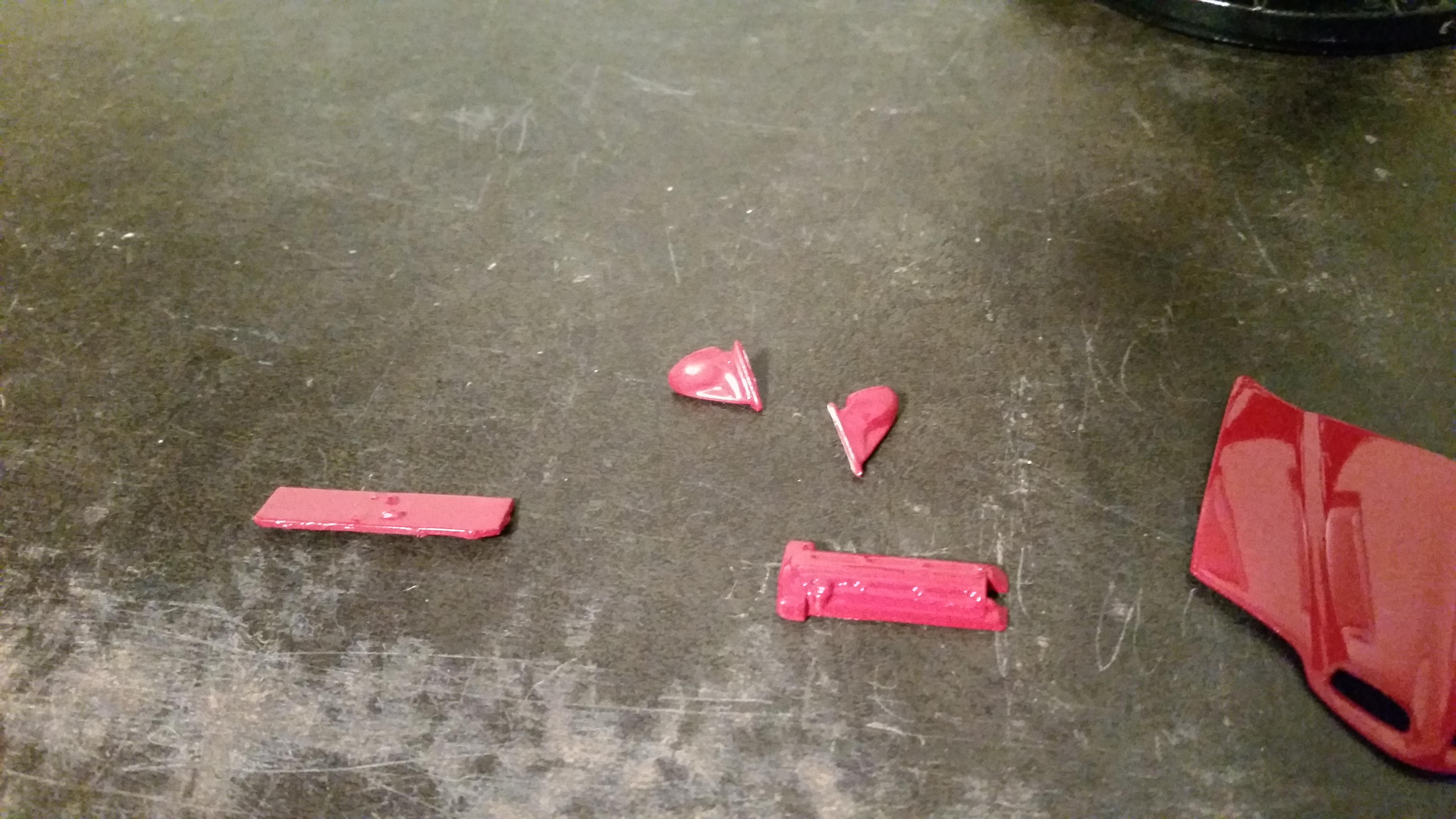

I apologize for lack of updates, had to strip the paint job due to humidity causing bubbles underneath that somehow got under a near perfect finish. While waiting for it's purple bath to finish, I was also trying to finish up a Quad 4 swapped Opel GT that was started way before I joined in on the 2018 CB. With the Opel nearly finished (just need to get a moment to assemble it all) I also tried to squeeze in whatever time I had after work to find a less humid day to respray the 2JZ bird's body. his paint job came out much better... aside from a teensy big landing on the chicken emblem on the front bumper, which isn't a biggie as I plan to ether lightly sand it down then apply an leftover unused chicken decal from my 2002 CE build that would likely fit over it. Worst case scenario would be to apply a licence plate over it, making it more street legal since while kinda ugly looking, I've seen 1:1s that have them so option B wouldn't be unusual if so.

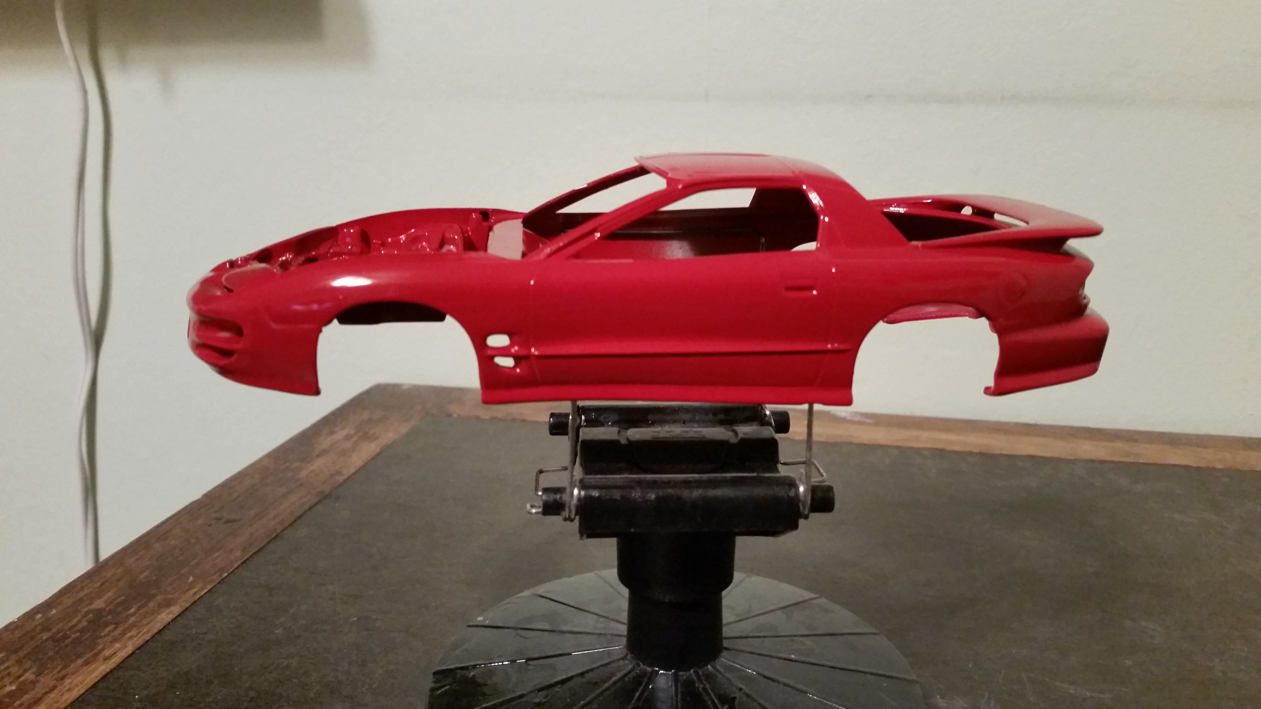

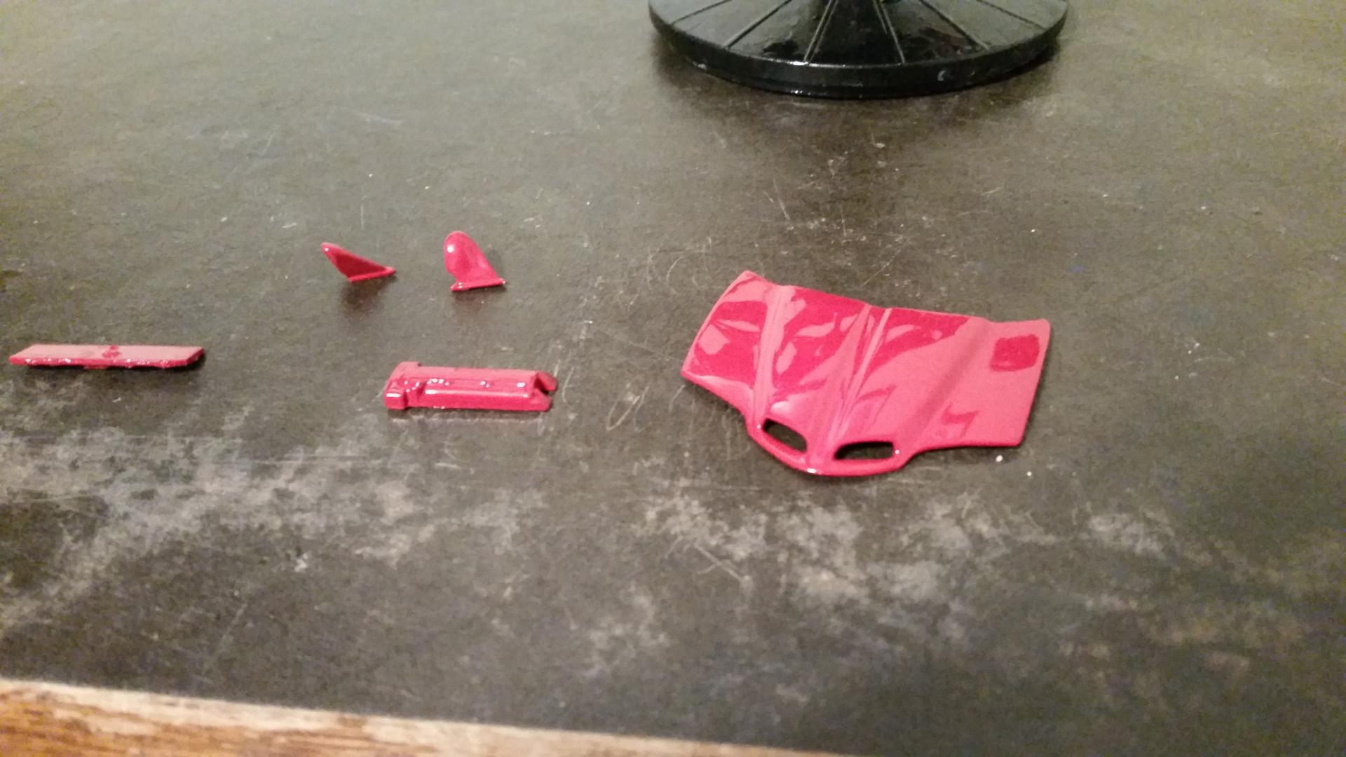

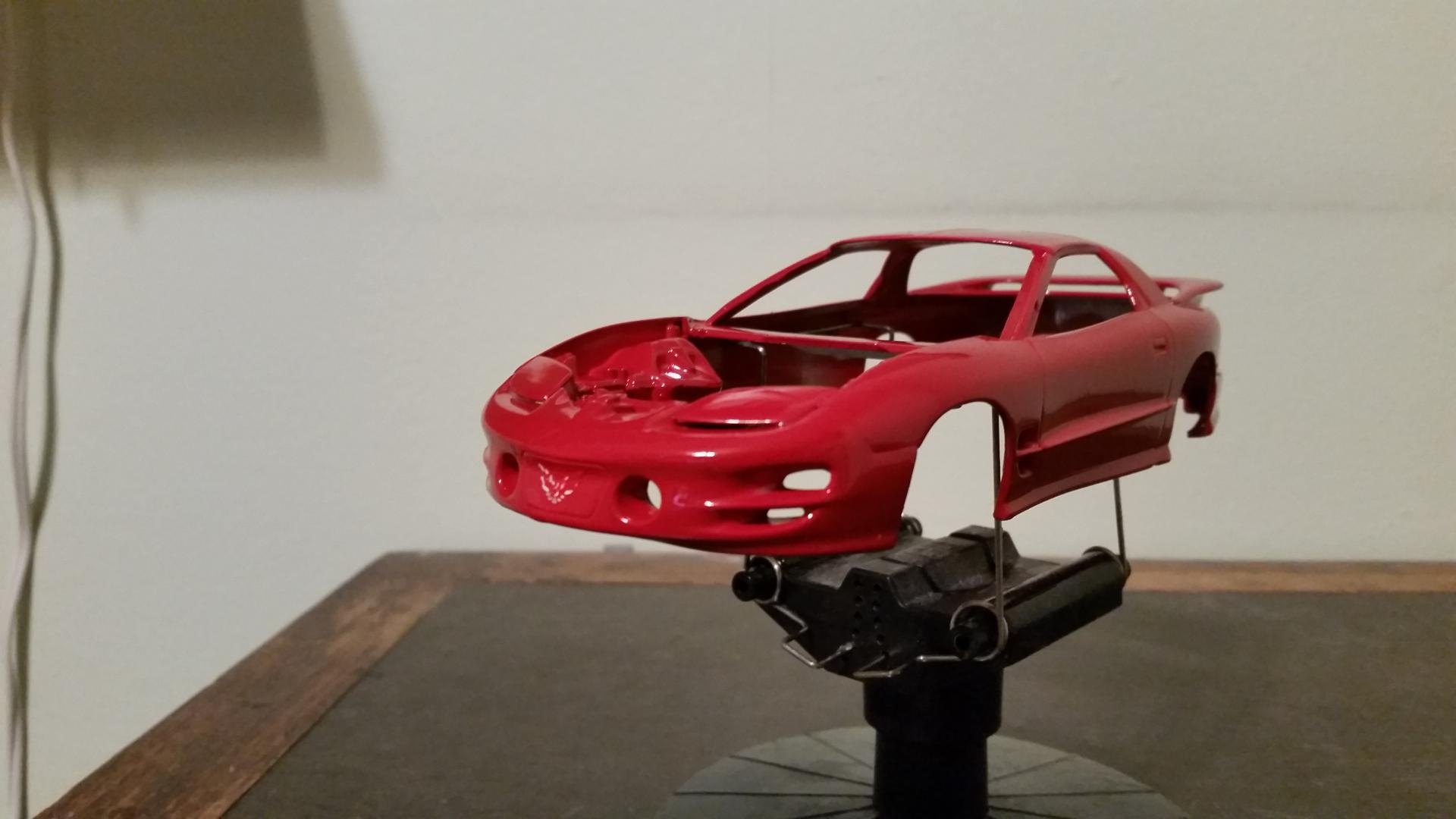

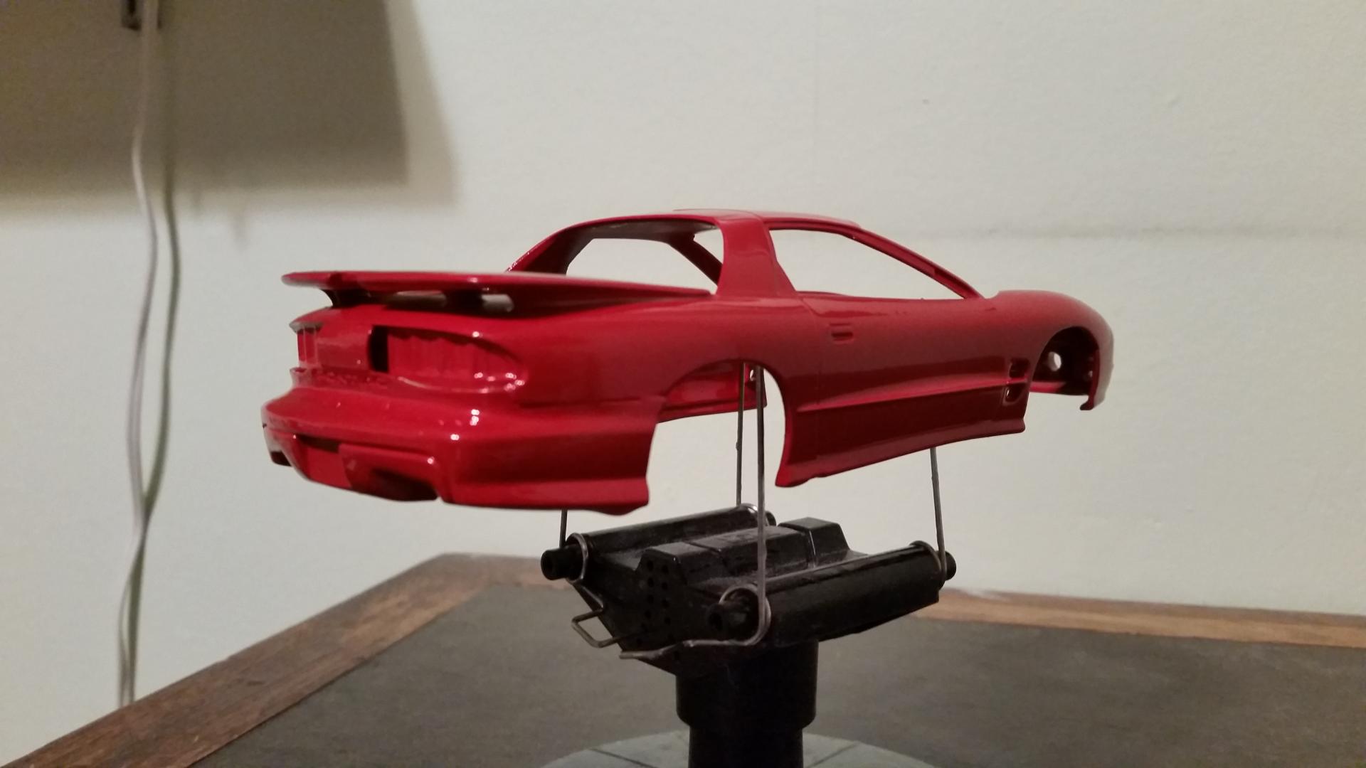

Update 8/3:
Now that I finished my Quad 4 Opel GT (coming up in a bit), I got the 98's body parts, 2JZ valve cover, and custom engine bay plate painted Colorplace Fire Red after the 2nd painting attempt (same color I used on the 93 I built in 2009). Though there were some minor imperfections, they were lightly sanded down i a few spots and the front bumper on the chicken emblem thanks to Mr. Teensy fly. Then I applied Pledge/Future and here's how it all looks before I do some toothpaste polish.
In some shots, it looks different and kinda pink but that's due to lighting and such in my room. It's a much darker red than what you see in the pics. Drip came down because I had just applied it and still wet.
I plan to paint the chicken flat black or apply the leftover CE bird decal to further break up the reds, but that's all once I get to detail painting.
