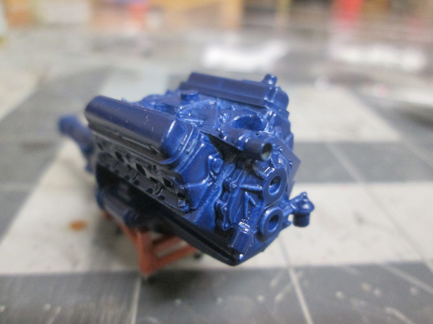

landman Posted August 2, 2018 Share Posted August 2, 2018 What is the engine in this kit? 302 or 351M? Thanks, Pat Quote Link to comment Share on other sites More sharing options...
Classicgas Posted August 2, 2018 Share Posted August 2, 2018 I believe it is a 302. Quote Link to comment Share on other sites More sharing options...
landman Posted August 3, 2018 Author Share Posted August 3, 2018 14 minutes ago, Classicgas said: I believe it is a 302. Thank you Lee. Quote Link to comment Share on other sites More sharing options...
Classicgas Posted August 3, 2018 Share Posted August 3, 2018 Your welcome. Quote Link to comment Share on other sites More sharing options...
Force Posted August 4, 2018 Share Posted August 4, 2018 It's easy to see if you know what you should look for. On the Windsor family engines (221-260-289-302 and 351 Windsor) the upper radiator hose goes into the front part of the intake manifold and the water goes through it to the heads, on the 335 family engines (351 Cleveland, 351M and 400) the upper radiator hose goes into the engine block. Quote Link to comment Share on other sites More sharing options...
landman Posted August 4, 2018 Author Share Posted August 4, 2018 (edited) 8 hours ago, Force said: It's easy to see if you know what you should look for. On the Windsor family engines (221-260-289-302 and 351 Windsor) the upper radiator hose goes into the front part of the intake manifold and the water goes through it to the heads, on the 335 family engines (351 Cleveland, 351M and 400) the upper radiator hose goes into the engine block. Thank you Håkan, now I know what it is. Edited August 4, 2018 by landman Quote Link to comment Share on other sites More sharing options...
