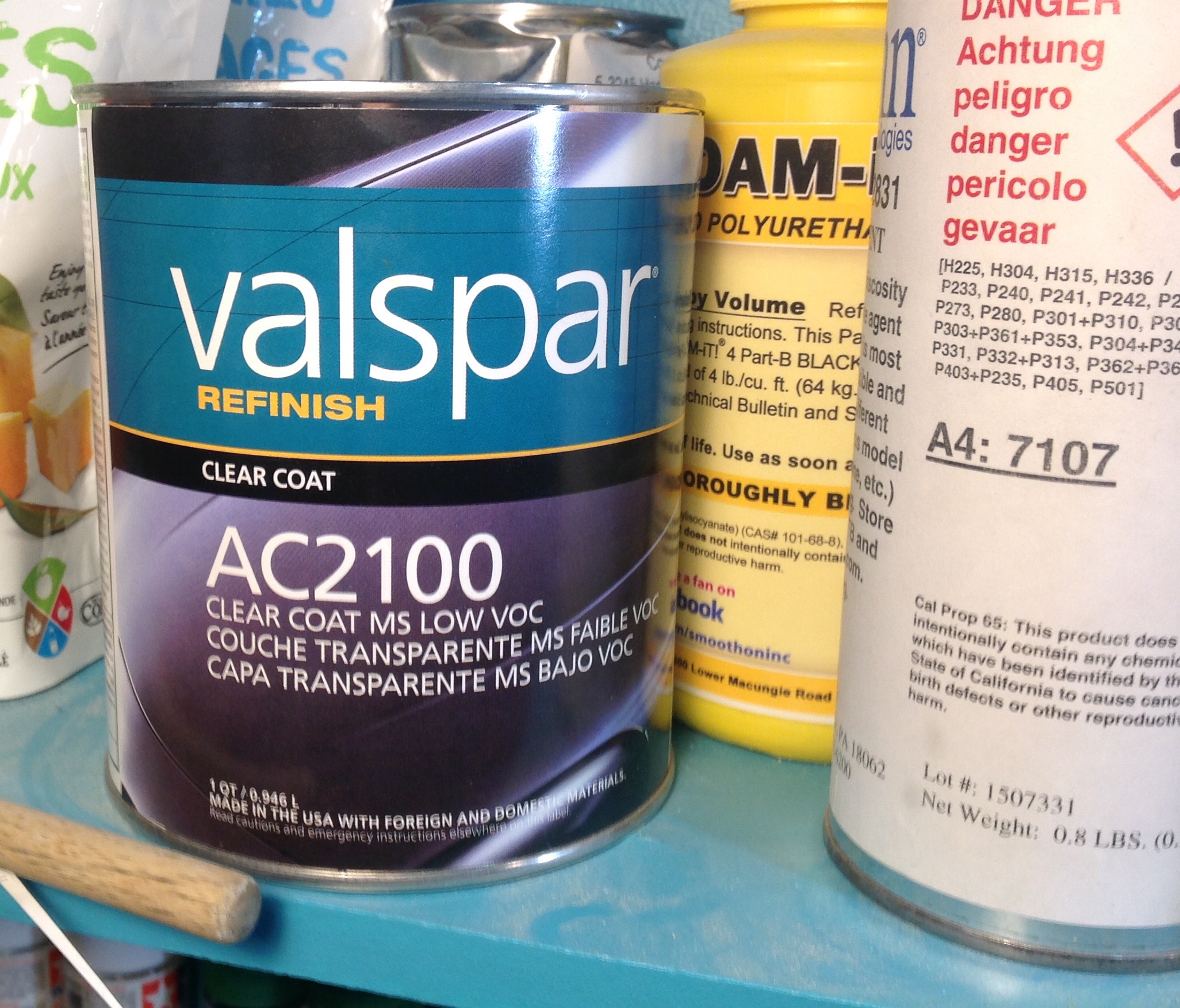

Rider Posted September 5, 2018 Posted September 5, 2018 (edited) 49 minutes ago, jchrisf said: What about craft acrylics? That stuff sprays so nice out of an airbrush... if I could just get a nice clear on it. Best clear I have used is this 2 part Poly, it's actually 3 parts if you include the reducer and catalyst. This stuff is great for intercoating (also know as a barrier) as well. I use this stuff between many many different paint products and finishes with out any issues. As a top clear coat it is glass smooth without any wet sanding or polishing. Edited September 5, 2018 by Rider
jchrisf Posted September 5, 2018 Author Posted September 5, 2018 29 minutes ago, Rider said: Best clear I have used is this 2 part Poly, it's actually 3 parts if you include the reducer and catalyst. This stuff is great for intercoating (also know as a barrier) as well. I use this stuff between many many different paint products and finishes with out any issues. As a top clear coat it is glass smooth without any wet sanding or polishing. Where do you get it Rider? Will it go over acrylics?
Rider Posted September 5, 2018 Posted September 5, 2018 39 minutes ago, jchrisf said: Where do you get it Rider? Will it go over acrylics? Goes over pretty much anything, I have yet to have any kind of reaction. I buy from autobody supply shops. As I said it works great for intercoating when mixing different types of paint and different brands. If anyone tells you different they haven't used it. I dig it because I use a ton of different products for coverage and colour choices. If you do a search on here (not sure exactly what subject topic to search) for messed up paint and reactions many are caused from using one manufactures paint over another's. Even if they are both acrylic. I have had reactions between Tamiya and testors, Tamiya and Valijo, Duplicolor and testors, etc. I am no chemist but results don't lie and I am not one to talk BS just to talk. For me Poly-U is a safety net. Ever since I started using it a few years ago for intercoating I have yet to chuck a shell in stripper as a direct result of a bad reaction. It's not cheap by any means but it is a piece of mind for me when messing around with so many different types of colours and paint combos. This thing has over 40 colours on it and a number of paint manufactures paints, enamel, lacquer, acrylic, dollar store nail polish which is some type of lacquer, nail polish from China (who knows what's in that stuff) craft die, my own concoction of Pledge mixed with some colour, the list goes on and on. No reaction at all.
