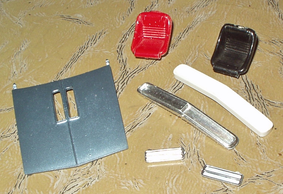

Snake45 Posted October 3, 2018 Author Posted October 3, 2018 Thanks Bill and Gramps. Reason I'm asking is, I'm building a custom Camaro and want to use this hood, which has already been opened up by someone long ago. Thought it might be cool to have Webers showing underneath it, but I'm not sure a big block would fit under that flattish hood with Webers (the whole reason for the bump on all First Gen SS Camaros was that the room was needed for the air cleaner on the 396). Looks like I'll have to try. It might work (using the setup from the reissue AMT Vettes). Or I might be able to piece together the 4-carb Man-a-Fre setup from the AMT '67 Camaro annual kit. I have at least two of those, neither one complete, but I might have one full set. It would be appropriate for this particular build, using so many original AMT '67 pieces.

Snake45 Posted October 3, 2018 Author Posted October 3, 2018 Just now, Exotics_Builder said: I seem to recollect either an AMT or MPC late 70's or early 80's Camaros had a Weber manifold option on small block Chevy. Can't attest to accuracy. My stuff is still boxed up, so I can't check to see if I have anything further. I'm drawing a blank on further detail. Anyone else recollect this? Hmmmm. I don't have any of those kits so it wouldn't help me anyway, but thanks. I'm now looking at the VERY short injection stacks from the old AMT '69 Chevelle SS. They're probably not accurate, but would fit, should more or less "bolt on" to the BBC in the Revell kit I'm using, and give me the look I'm looking for.
