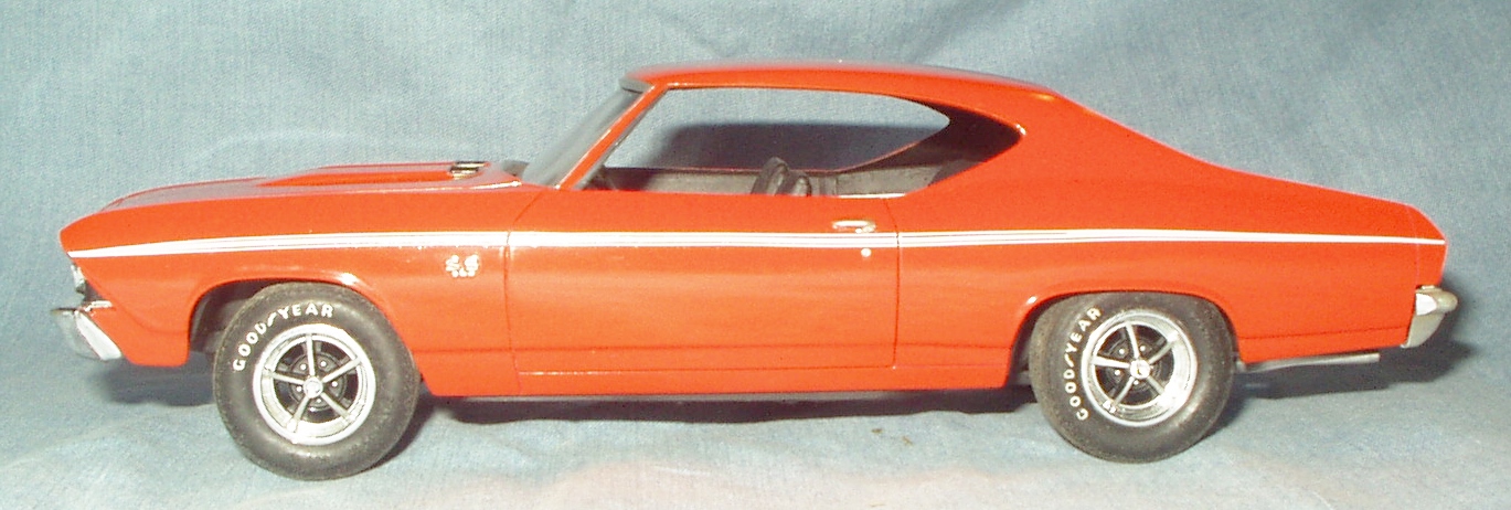

Snake45 Posted November 20, 2018 Posted November 20, 2018 I wouldn't do it with sandpaper either. I've done two of them with files, and another one by cutting it, either with a razor saw or Xacto, I don't remember each. In either case, I cut the top line at a slight downward angle, and the bottom edge of the thing upward, until the two cuts met and the molding fell off. Here's how it looks when done.
