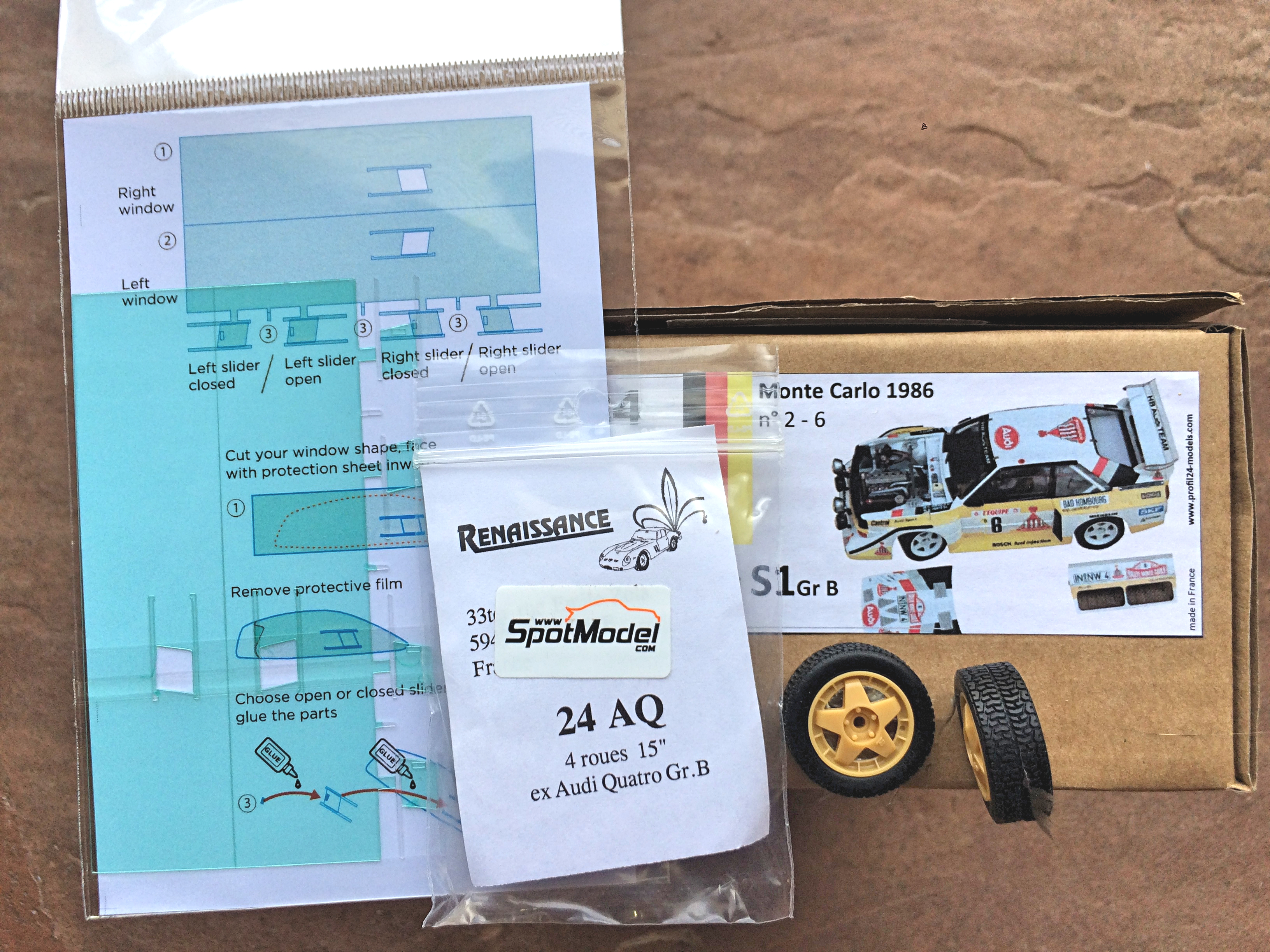

Gt fan Posted December 5, 2018 Author Posted December 5, 2018 I started working on the snow/ gravel wheel . It seems that this car has run with a few different combinations. These are the ones that I’m using. They just have to be printed.

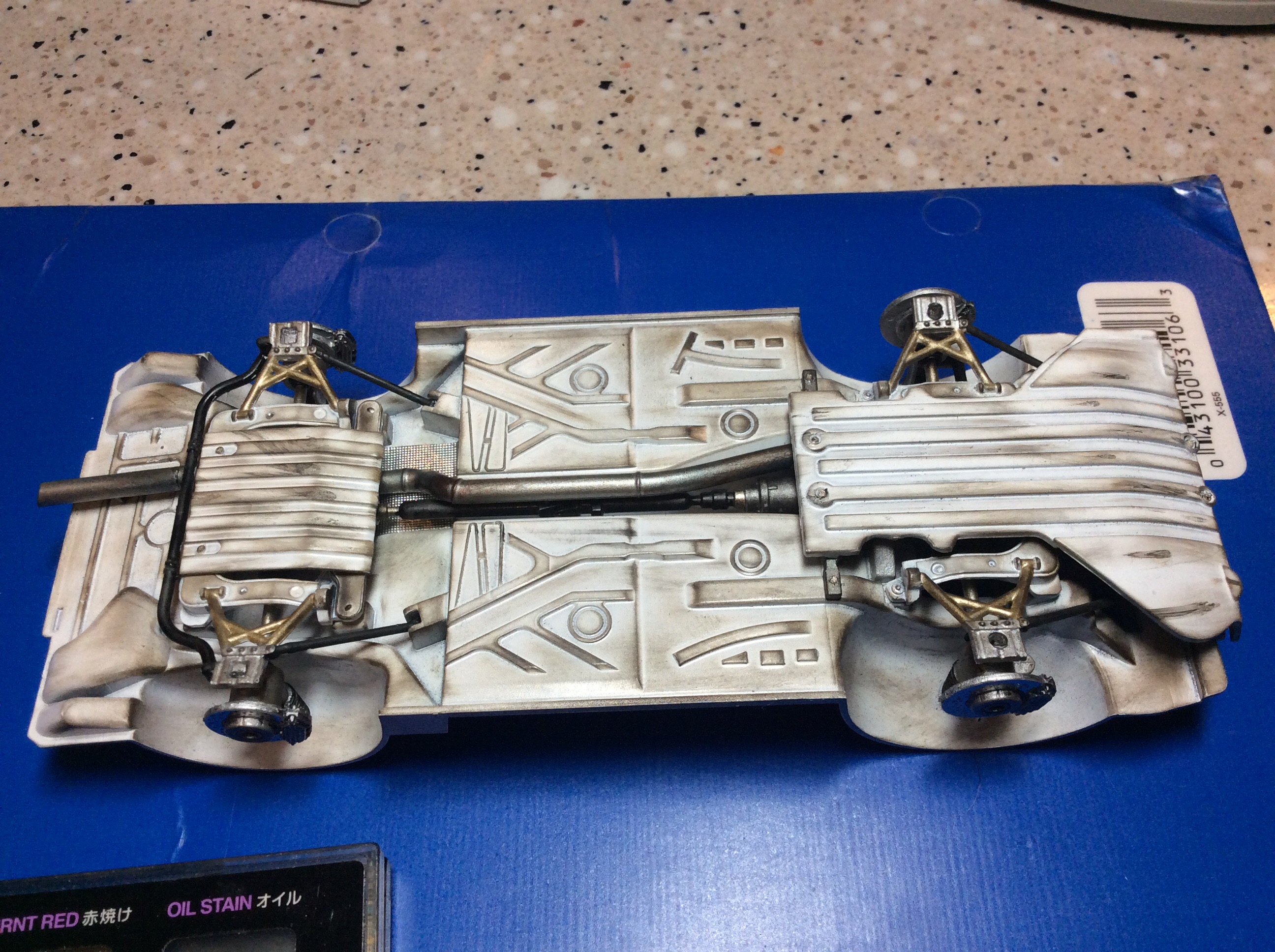

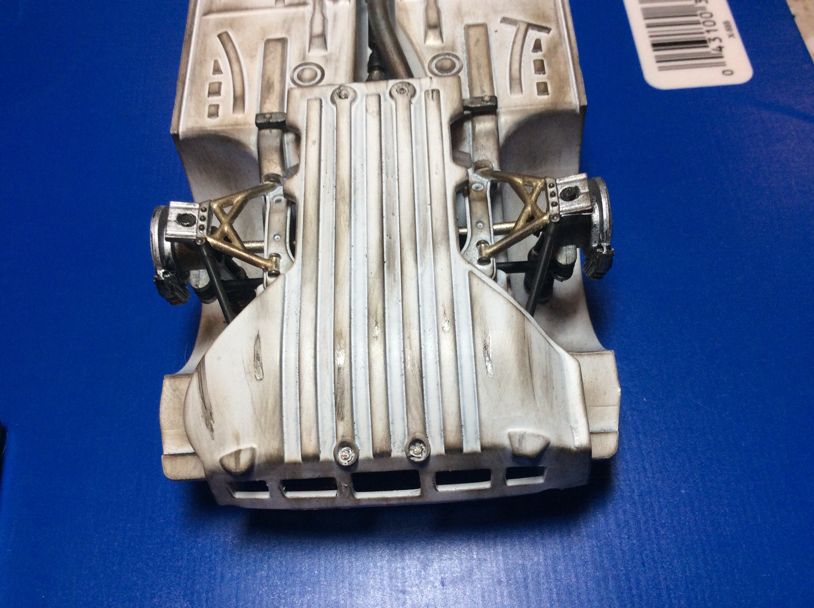

Gt fan Posted December 6, 2018 Author Posted December 6, 2018 3 hours ago, carmad1957 said: Man o man...that's looking super! Mind sharing how you get that heat stain look? That's really nice. Thanks I use the Tamiya weathering kits. I start with burnt blue and then some burnt red. I some times use a dry brush of clear red. After that step I use the soot mixed with the rust in the weathering kit. The rust with the black gives it a “ worn tone “ that’s not as harsh as just black. In the new photos the skid plates have been added. On the front plate I’ve added some silver tone scrapes. These would be from rocks or from running the corner short. These were done with a tiny blob of almost dry silver. Then I used a sharpened tooth pick to pull the paint. Then mixed a bit of soot into it. By the way I use Titanium silver for my exhaust base color. It’s a little softer looking than a bright aluminum.

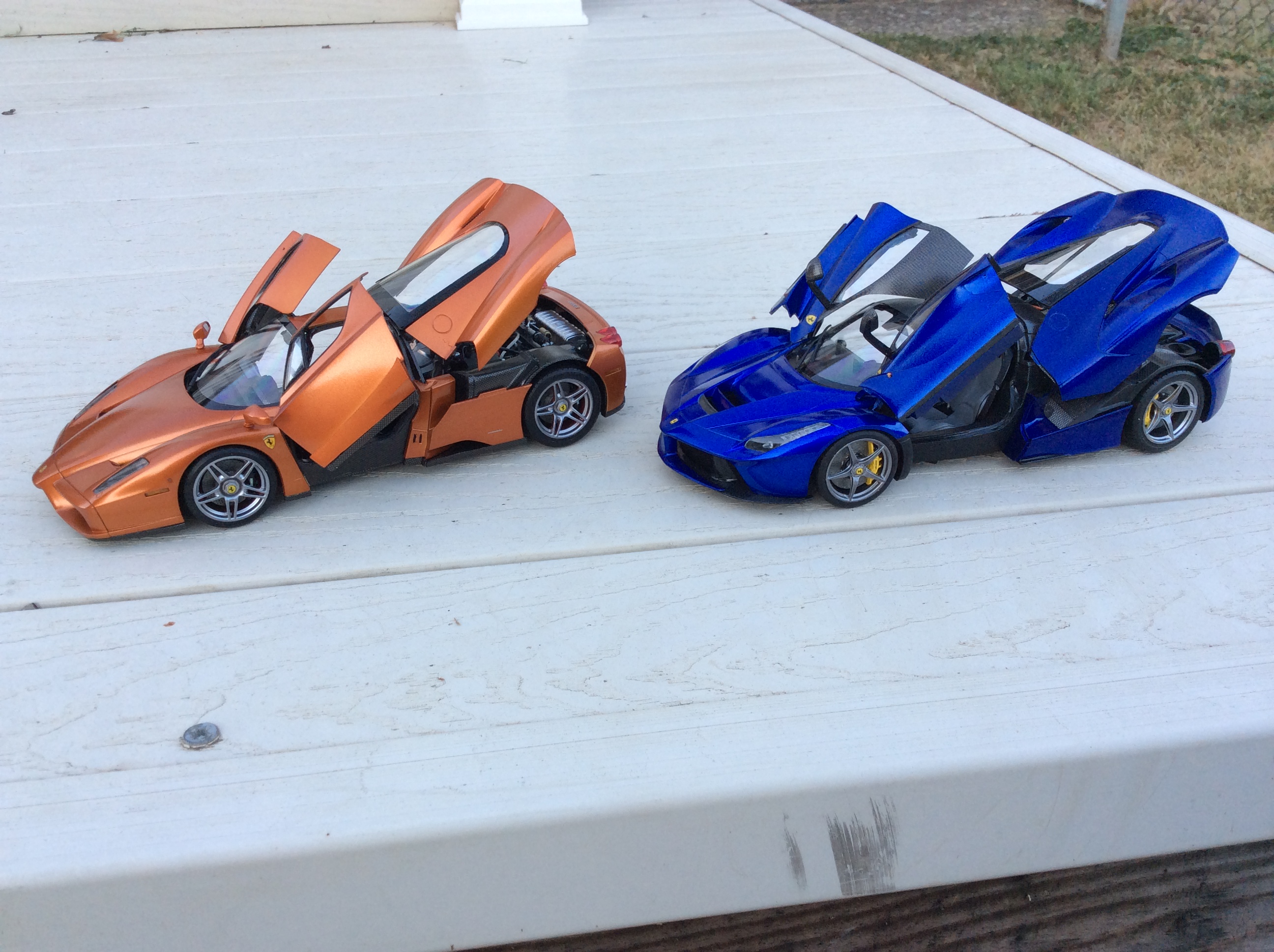

Gt fan Posted December 6, 2018 Author Posted December 6, 2018 35 minutes ago, carmad1957 said: I really appreciate you sharing that. I think it's the weathering powders and transparents that I need to get more comfortable using, because from what I see in your work there....that's exactly what I'm trying to accomplish. I have a Ferrari Enzo build I'm getting underway and if ya happen to stumble onto it in the WIP I would very much appreciate your input! Now, time to get practicin'!!! Thanks again for sharing Get the Tamiya sets and try it out. You can always wipe the stuff off. I’ll look at your Enzo. Love that car. I built one I’ll see if I can find the pictures.

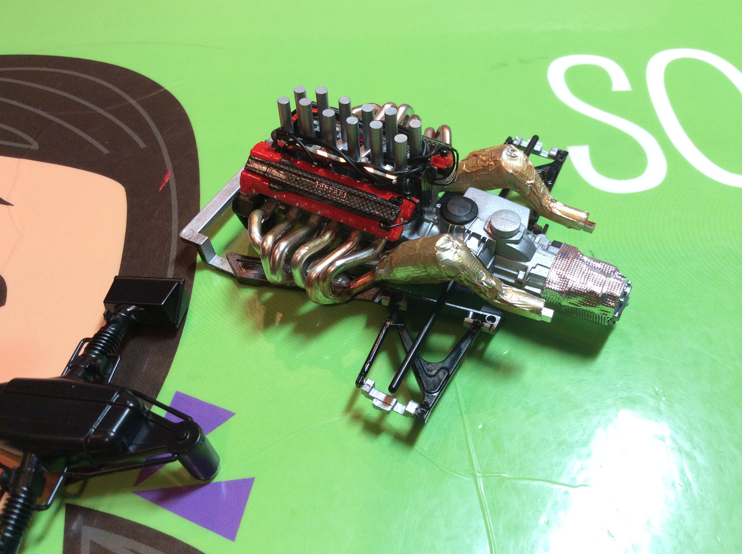

Gt fan Posted December 6, 2018 Author Posted December 6, 2018 1 minute ago, Gt fan said: Get the Tamiya sets and try it out. You can always wipe the stuff off. I’ll look at your Enzo. Love that car. I built one I’ll see if I can find the pictures. Here is one
carmad1957 Posted December 6, 2018 Posted December 6, 2018 (edited) Well, well- looks like I'd better get busy. Guess I could have mentioned that I haven't begun the WIP thread yet, probably today. Those pics are quite an inspiration! What did you use on the exhaust there to replicate a heat wrap or whatever? I was considering tin foil dull side out. Edited December 6, 2018 by carmad1957 forgot to mention the WIP thread- thanks
Gt fan Posted December 6, 2018 Author Posted December 6, 2018 48 minutes ago, carmad1957 said: Well, well- looks like I'd better get busy. Guess I could have mentioned that I haven't begun the WIP thread yet, probably today. Those pics are quite an inspiration! What did you use on the exhaust there to replicate a heat wrap or whatever? I was considering tin foil dull side out. I used the MFH heat shielding. I have used tin foil. If you look in this WIp. Someone said Micheals Has a product that wil work as well. Then I stained it with the Tamiya weathering kit.
carmad1957 Posted December 6, 2018 Posted December 6, 2018 MFH? Not sure what that is but I gotta get some- looks darn realistic- Enlighten me sir!
Italianhorses Posted December 6, 2018 Posted December 6, 2018 10 minutes ago, carmad1957 said: MFH? Not sure what that is but I gotta get some- looks darn realistic- Enlighten me sir! MFH is Model Factory Hiro, Japanese kit/accessories maker. http://www.modelfactoryhiro.com/new/en/
Gt fan Posted December 6, 2018 Author Posted December 6, 2018 As Italiian Horses has listed there web site. There stuff is aval. at the better online stores and direct from them. To date the best in the foil that I have used. I get mine from Hobbyeasy.com

Funkychiken Posted December 8, 2018 Posted December 8, 2018 Great build here, glad someone's started it! Question - did you have to ask in the weathering with a flat clear?
Gt fan Posted December 8, 2018 Author Posted December 8, 2018 8 hours ago, Funkychiken said: Great build here, glad someone's started it! Question - did you have to ask in the weathering with a flat clear? The weathering kits are like a make-up base. Kinda like a pastel. Tamiya doesn’t use. A clear or flat over them like the AK stuff. It will rub off if rubbed hard.

Gt fan Posted December 9, 2018 Author Posted December 9, 2018 Thanks for all the support everyone. I’ve been watching videos of these cars . They are crazy fast. The wheels are printed and on the way to me. I can’t wait to get them.
