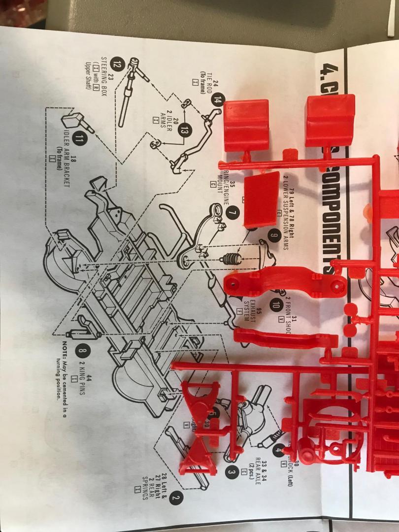

The AMT Rescue van is correct, the 64-66 Chevy C10 would also be a good donor.
For the Rescue van, the upper arms will have to be cut off the frame, but the rest is not bad. I am converting one of my vans to a 4X4 so I will be cutting it off. Let me know if you need it. Be aware, it is 1/25 scale.
Edited by Oldmopars

One thing to be aware of if you decide to go that route, Jordan-- the van upper control arms are different lengths/widths, as the van frame is offset to the right side.
Again, all are 1/25 scale, and I have my doubts they would look right on a 1/24 scale frame. Usually 1/24 can be sapped over to 1/25 and not look too out of place, but the other way around doesn't usually work too well. Plus, the AMT Chevy van UCAs are blocky and thick-- not great options IMHO.
I will have to look at doing this, have an unbuilt kit as well as an older build that I could scavenge parts from.
Question for you: are either one of the upper control arms usable for both sides or will one have to create new UCAs?
