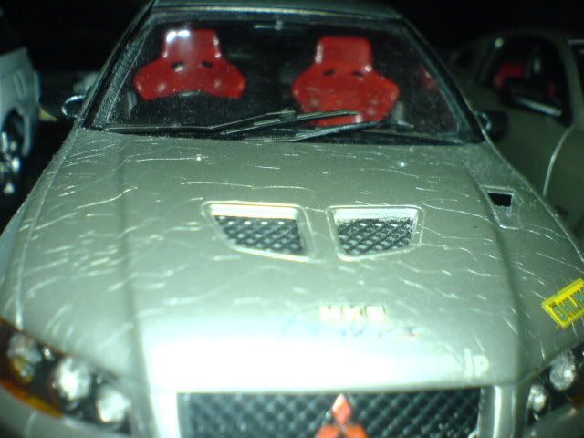

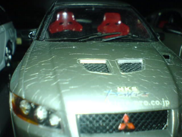

ericmaxman Posted August 21, 2008 Posted August 21, 2008 Guys, I seem to have an emergency here. A few of my kits have hairline cracks on them. Especially those silver ones. Here is a shot.
MrObsessive Posted August 21, 2008 Posted August 21, 2008 Ouch!! What kind of paint/clear did you use? The clearcoat dries faster than the color coats--------because the previous coats are still shrinking this can lead to the cracks in the topcoat/clearcoat. I ran into this problem years ago with Tamiya Acrylics, using their clearcoat over their water based acrylic colors ALWAYS led to cracking about a month or so down the road!
ericmaxman Posted August 21, 2008 Author Posted August 21, 2008 I'm using some sort of automotive clear. I thought it would of higher quality, and so it seems I may be wrong. So the key is to give is more time to cure?
MrObsessive Posted August 21, 2008 Posted August 21, 2008 I'm using some sort of automotive clear. I thought it would of higher quality, and so it seems I may be wrong. So the key is to give is more time to cure? Okay-------Most likely that is a hot acrylic enamel/lacquer clear. Lacquers don't like to be sprayed over anything else but other lacquers. But you can spray acrylic enamels clears over lacquer because they aren't so hot. Likewise hobby enamel clears can be sprayed over just about anything. But it seems that reaction should have been immediate------how long ago did you paint the car? Might be the only solution would be to take the car apart, strip it, then repaint.
ericmaxman Posted August 21, 2008 Author Posted August 21, 2008 Okay-------Most likely that is a hot acrylic enamel/lacquer clear. Lacquers don't like to be sprayed over anything else but other lacquers. But you can spray acrylic enamels clears over lacquer because they aren't so hot. Likewise hobby enamel clears can be sprayed over just about anything. But it seems that reaction should have been immediate------how long ago did you paint the car? Might be the only solution would be to take the car apart, strip it, then repaint. Car was completed some time in May. It is not too visible under direct sunlight, but when up close, it hurts to see it crack like that. Even my Magnum and Mustang has those crack lines.
george 53 Posted August 21, 2008 Posted August 21, 2008 WoW E-Man, I have NEVER seen a clearcoat crack THAT BAD!!! Make sure your paints are compatable with each other.Like Bill jus said NEVER spray laquers over ANYTHING but laquers. I hate to echo Bill, but he's right, the only fix for that I'm afraid, is the ol Purple pond. What a shame! the car looks pretty nice.
ericmaxman Posted August 21, 2008 Author Posted August 21, 2008 WoW E-Man, I have NEVER seen a clearcoat crack THAT BAD!!! Make sure your paints are compatable with each other.Like Bill jus said NEVER spray laquers over ANYTHING but laquers. I hate to echo Bill, but he's right, the only fix for that I'm afraid, is the ol Purple pond. What a shame! the car looks pretty nice. The worst part is that it seems to be spreading like an epidermic. And I did go through quite a hassle trying to get the car to look right. Removing the paint is indeed a painful procedure.

george 53 Posted August 21, 2008 Posted August 21, 2008 Well E-Man, the first stuff(the clear, I think) says it's an acrylic, so I don't really see anything there that mighta caused the cracking, BUT, the Color paint says its some kind of modified resin. Maybe it needed more time to gass out? You'd think that with both paints beein by the same manufacturer they would be compatable. Who knows Bro, at least you now know NOT to try it again. I still think the pond is the only solition. Maybe one of the guys might be able to answer the compatability question.

CAL Posted August 21, 2008 Posted August 21, 2008 The worst part is that it seems to be spreading like an epidermic. And I did go through quite a hassle trying to get the car to look right. Removing the paint is indeed a painful procedure. :rolleyes: Yeah, it's done.... I am afraid. Your base and clear are drying and shrinking at different rates. It doesn't look like a gas-out problem. Paint systems today are getting very specific and you don't want to mix and match base/clear, plus there are all kinds of variants depending temp, moisture, flash-time, when it comes to pick out the right clear. who knows what is in that junk.
