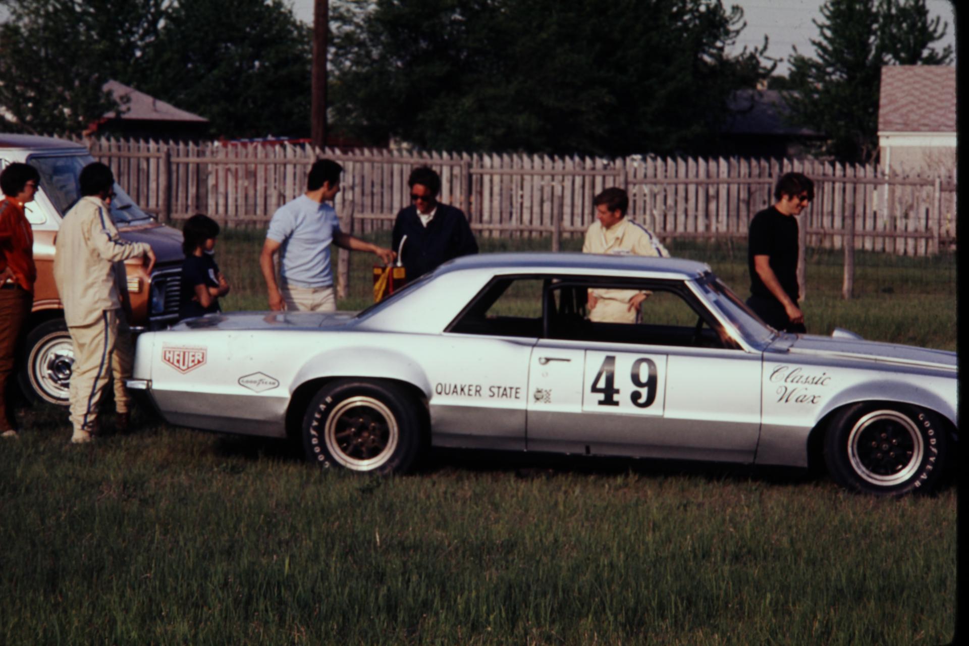

Mike K,  I am attaching a couple of pictures, among several my dad took at Waterford Hills during the session where A.B. Shuman drove the car. If you know the end of the article,  you now the story behind these. I will leave it to you to tell the rest of the readers about that.  I am the one in the dark short sleeve shirt and Ray Ban sunglasses in the picture with the car.  PLEASE NOTE THE IMAGES ARE THE PROPERTY AND COPYRIGHT OF H QUACKENBOSS AND ARE PROVIDED WITH THE RESTRICTION THAT THEY NOT BE POSTED OR USED IN ANY OTHER PUBLIC FORUM OR VENUE, INCLUDING FACEBOOK, INSTAGRAM OR TWITTER, OR ANY OTHER WEBSITE.
Thanks Harry - these are an unexpected thrill to see...
I appears he's being afforded his thin fuel ration for what would turn out to be an abbreviated session.  At least nothing was damaged!  A. B. Shuman both wrote and photographed the well known story that appeared in the September, 1971 issue of Motor Trend titled Ask Herb's Wife If We Can Take Her Car Racing.  For a brief run Shuman was allowed to make a quick and measured assessment of the vehicles potential on-track, having been reminded quietly though firmly by Herb Adams that the powerplant constituted the team's "...one good engine".  Suitable chastened and yet agreeably curious as to what potential lay within, the journalist ventured out and gathered some impressions.  All well and and good - until silence and no power.  Had he unintentionally inflicted damage upon the car?  Thankfully no - for instead it was revealed that he'd simply and literally run out of gas...
The article remains the best period record of the genesis of the effort, including who was involved, technical specifications of the Gray Ghost, etc.  Know that I really appreciate the privilege to witness the photographs, while quite a surprise then to warm up the computer and have these waiting.
Mike K./Swede70

Seen then are a pair of images useful for guidance concerning the reproduction of the hood-mounted Diamond Racing Engines/Mount Clemens decal employed late season as a pair.  One is used to establish the color, the other, the art itself.  Tedious, but also rewarding if I can act upon such.
5c5861c181cc4_1971GrayGhostSt.Jovitepaddockone.jpg.238b4b523d264be6b6d7df3fa0101c59.jpg
...the subject in the paddock at '71 St. Jovite then.
