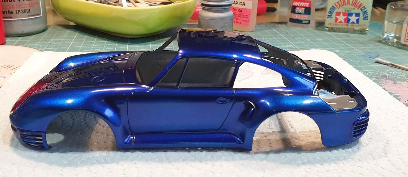

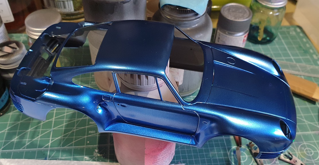

Funkychiken Posted July 6, 2019 Author Posted July 6, 2019 On 6/29/2019 at 10:20 AM, Cpt Tuttle said: Great job on the legendary 959, will be interesting to watch how it will look with a blue topcoat then. Well you kind of get to fin out! I'm posting 2 pics, the first is 1 dust coat, then 1 medium coat of Cobalt Blue. The Alclad II instructions recommend 1 do 1 light coat wait 10 mins 7 than 2 medium coats. It's a lacquer, but unlike any i've used before. The problem with this paint, it that it has been designed to be translucent - so the silver base shines through. Well that's great, but it makes it really difficult to patch up issues. I had dust land in one spot, lightly sanded it out, then when touching up, I ended up with a light spot (where the sanding was) then dark areas outside of it. I also ended up with 2 splodges - same issue trying to sand out and patch up. I'll probably give it one more coat. Â This paint also attracts dust. Once washed and air dried, it's like a magnet for dust. never seen anything like that before!
Funkychiken Posted July 6, 2019 Author Posted July 6, 2019 This 2nd pic is of the 2nd coat after a repair for dust. It's a little darker
DiscoRover007 Posted July 6, 2019 Posted July 6, 2019 The aclad might have a property to it that attracts dust. One thing Ive done recently is to use Tamiya's static brush to use just before painting. It wipes off dust and eliminates the static charge so you are less likely to get imperfections. It's meant to dust off displays models but it works well for painting too.
Dann Tier Posted July 7, 2019 Posted July 7, 2019 KILLER kolor!!!!!....i always use canned air to blast possible debris off my parts....between EVERY coat.

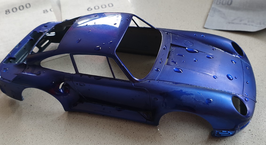

Funkychiken Posted July 15, 2019 Author Posted July 15, 2019 On 7/7/2019 at 12:57 AM, 89AKurt said: Beautiful blue!  On 7/7/2019 at 11:36 AM, Dann Tier said: KILLER kolor!!!!!....i always use canned air to blast possible debris off my parts....between EVERY coat. Thanks Kurt & Dann!  I've made some progress! It got even more dust during the recoat. So i've sanded the dust out & decided to use micromesh here's a pic before Â

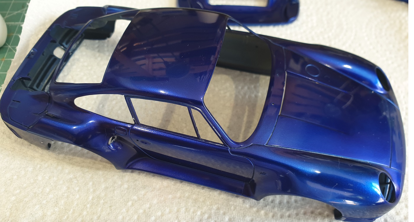

Funkychiken Posted July 15, 2019 Author Posted July 15, 2019 And here's 3 for after. Unfortunately it's really delicate, so it's burned through in a few spots & it keeps chipping off. I'm going to have to find a way of cleaning out the polish residue from the panel lines, then clearcoat with 2K Zero... wish me luck

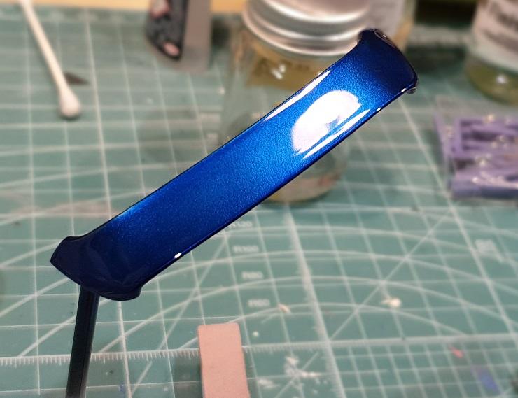

Funkychiken Posted September 12, 2019 Author Posted September 12, 2019 It has been clear coated with Zero 2K the bootlid & spoiler came out perfectly! however, the body was riddled with pitting & dust. it also suffered from ripples. so, it's going to get polished! that will be happening ths weekend....

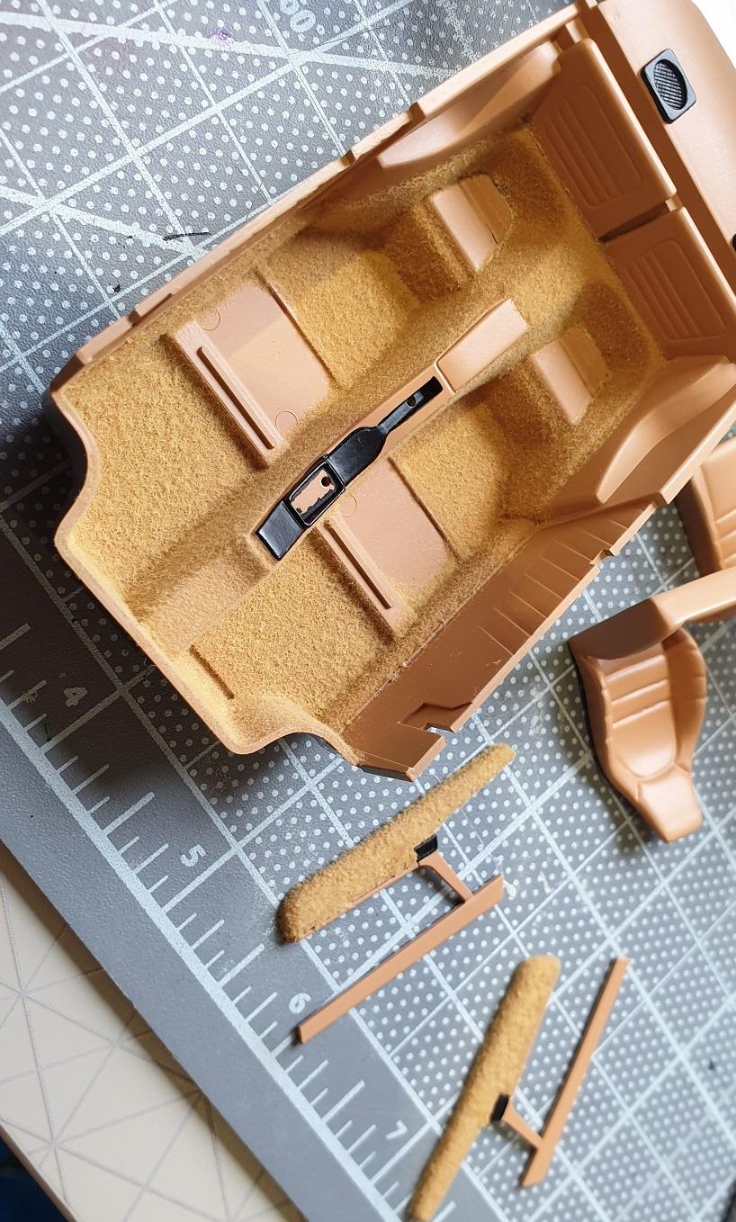

Funkychiken Posted September 12, 2019 Author Posted September 12, 2019 Engine, Chassis & interior are on their way... Other than spraying the body-shell, the worst part of this hobby is flocking. It never goes to plan... this is 2 coats of Hiroboy cream using Humbrol clear enamel as an adhesive. This is an old Tamiya kit, so it's not the best in terms of detail, however, it goes together really well, no real flash & ony minor sink hole defects to worry about....
OldNYJim Posted September 13, 2019 Posted September 13, 2019 I think the flocking looks great! Â What problems did you have with it? Â The end result is certainly impressive enough!
Dann Tier Posted September 13, 2019 Posted September 13, 2019 9 hours ago, CabDriver said: I think the flocking looks great! Â What problems did you have with it? Â The end result is certainly impressive enough! I TOTALLY agree!!....that flocking looks spot-on, realistic to me....especially considering that there are different kinds of carpet used in the automotive industry.
beeRS Posted September 14, 2019 Posted September 14, 2019 That paint job looks absolutely fantastic. Can't see any problems with the finish of the flocking.
kelson Posted September 14, 2019 Posted September 14, 2019 I'm with everyone else,the flocking looks great!.
Funkychiken Posted September 20, 2019 Author Posted September 20, 2019 Thanks for the comments Jim, Dann, Sonny & Curtis! It does look OK in the pics, but I guess in real life its a bit patchy, doesn't show in the pictures... Interior tub is done, this is OOB, no details at all, not even belts...! Just wated to get a kit completed!!!!

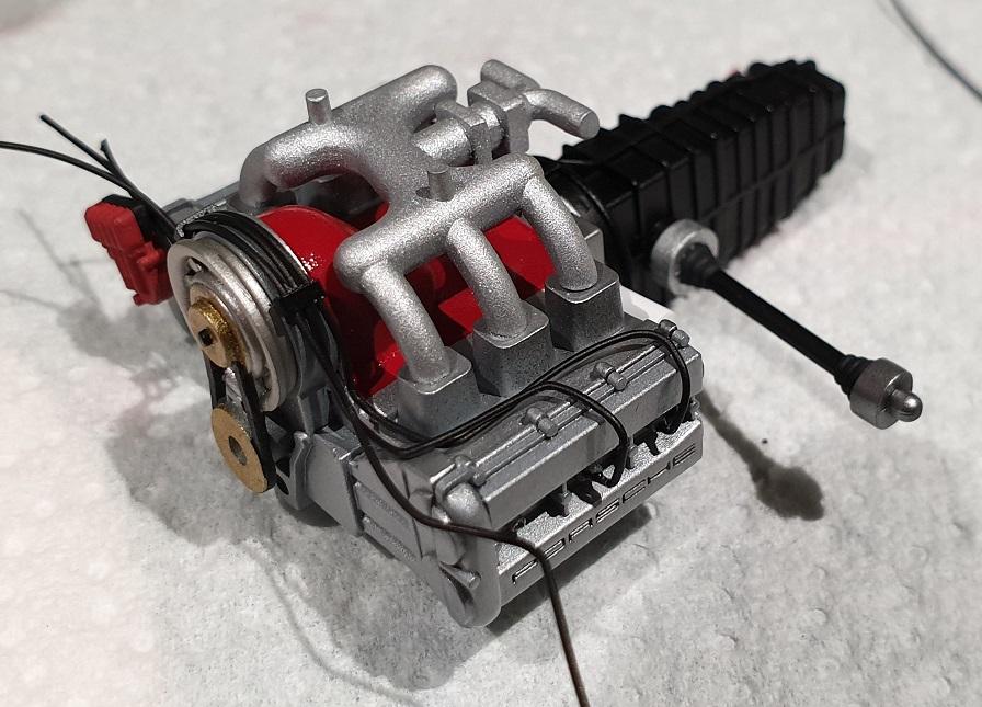

Funkychiken Posted September 29, 2019 Author Posted September 29, 2019 polished the Zero 2K, and started to wire the engine, it's a bit fiddly! just final assembly now...
beeRS Posted October 4, 2019 Posted October 4, 2019 That paint job is stunning. This is going to make a really nice model. Is the Zero 2k a clear coat?
