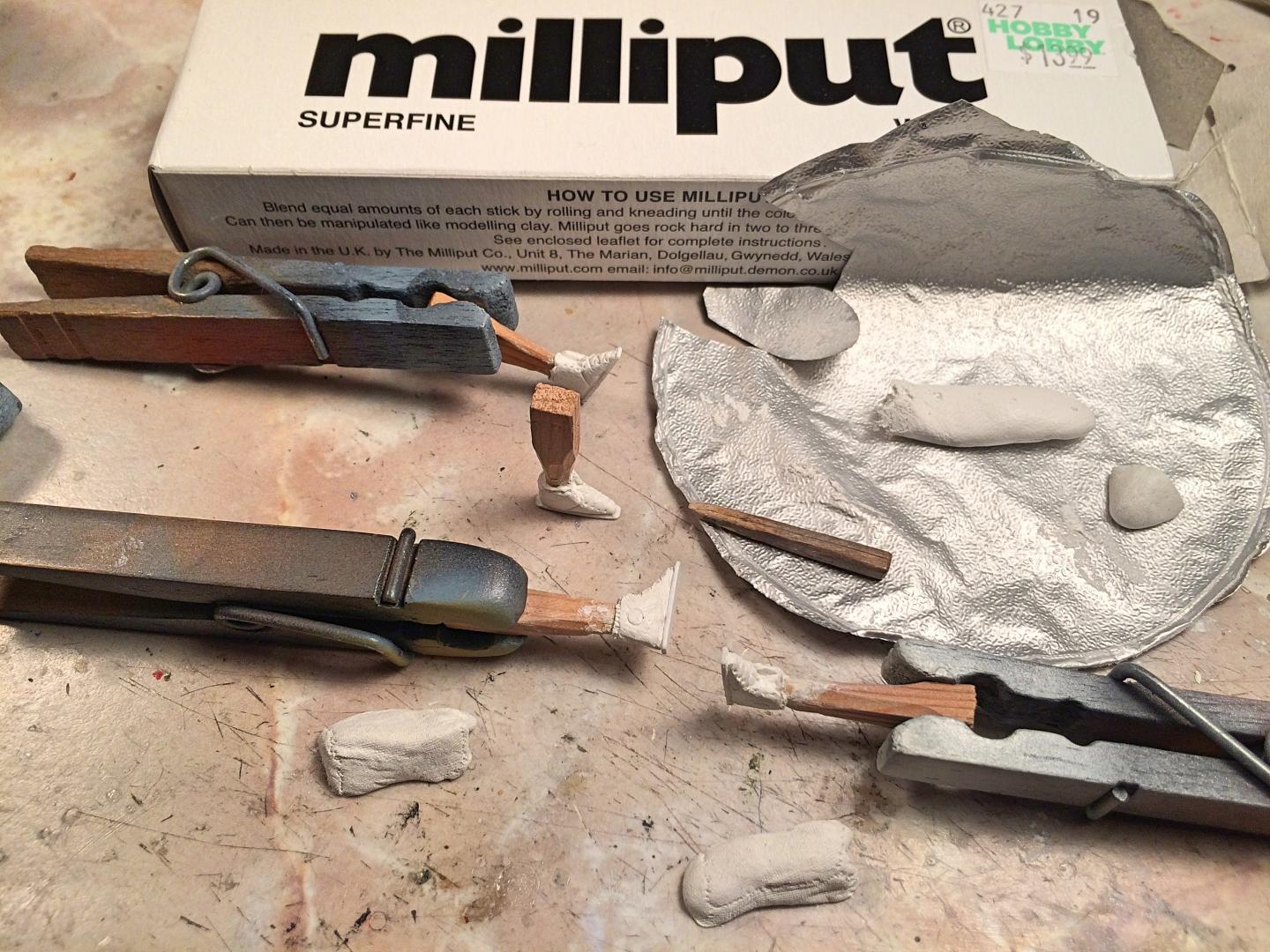

89AKurt Posted February 24, 2019 Posted February 24, 2019 On 2/22/2019 at 8:18 PM, fiatboy said: I've worked with Milliput [...] Which one? I tried his one for the first time, the result for the boots was good enough. But for doing body modifications, I'm not using it. The result is much like Sculpty clay that you bake, a bit soft. So let's see some Tamiya reviews.
