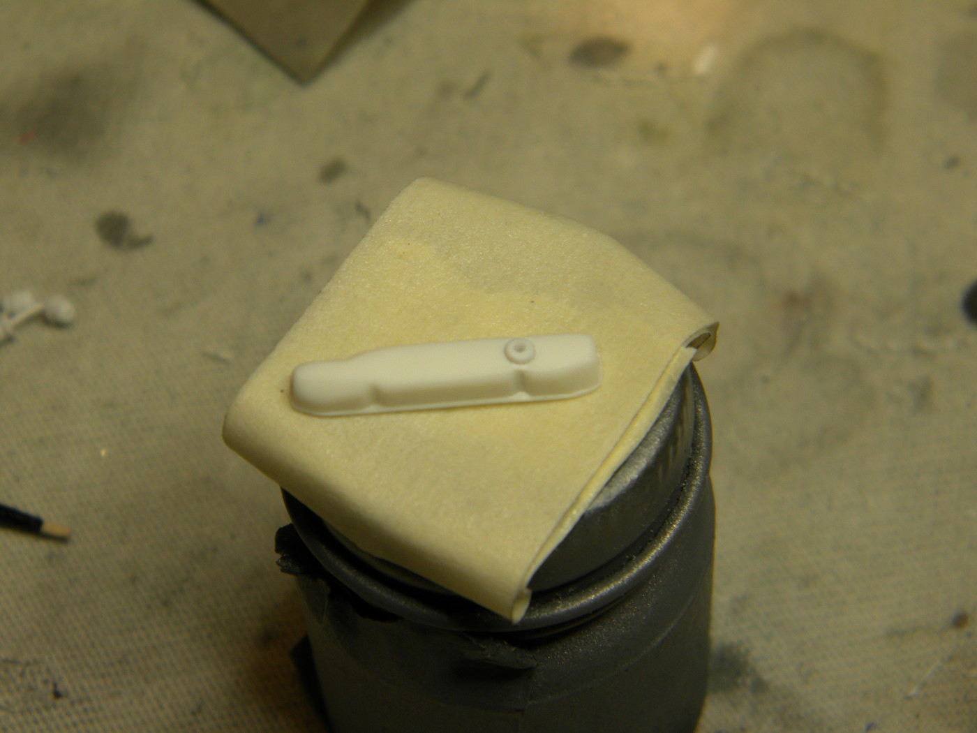

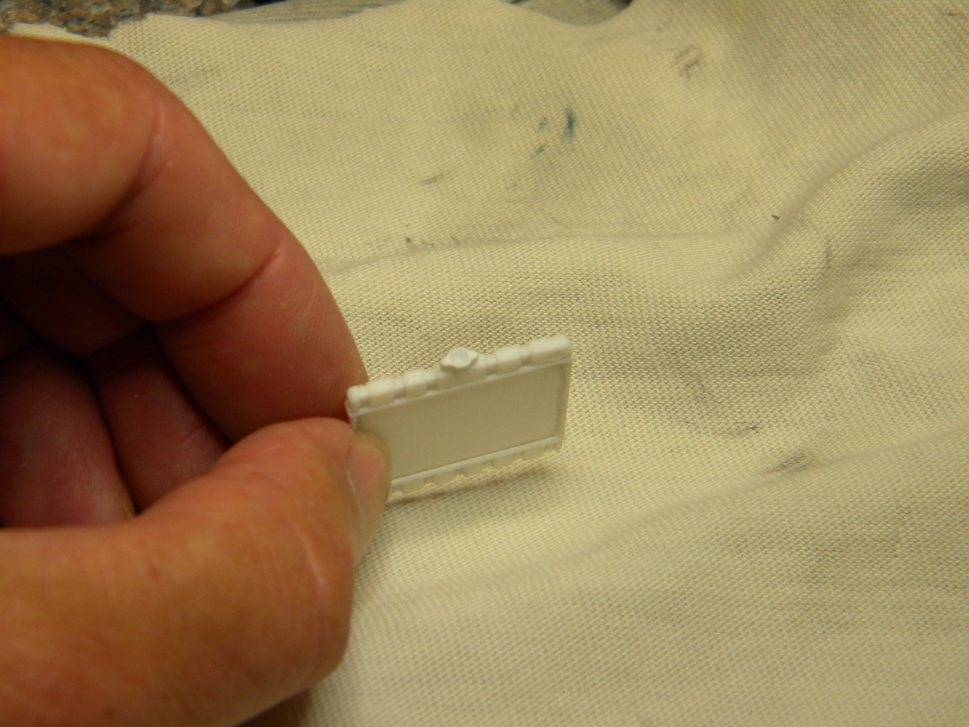

Started scratching up a few details for the engine.

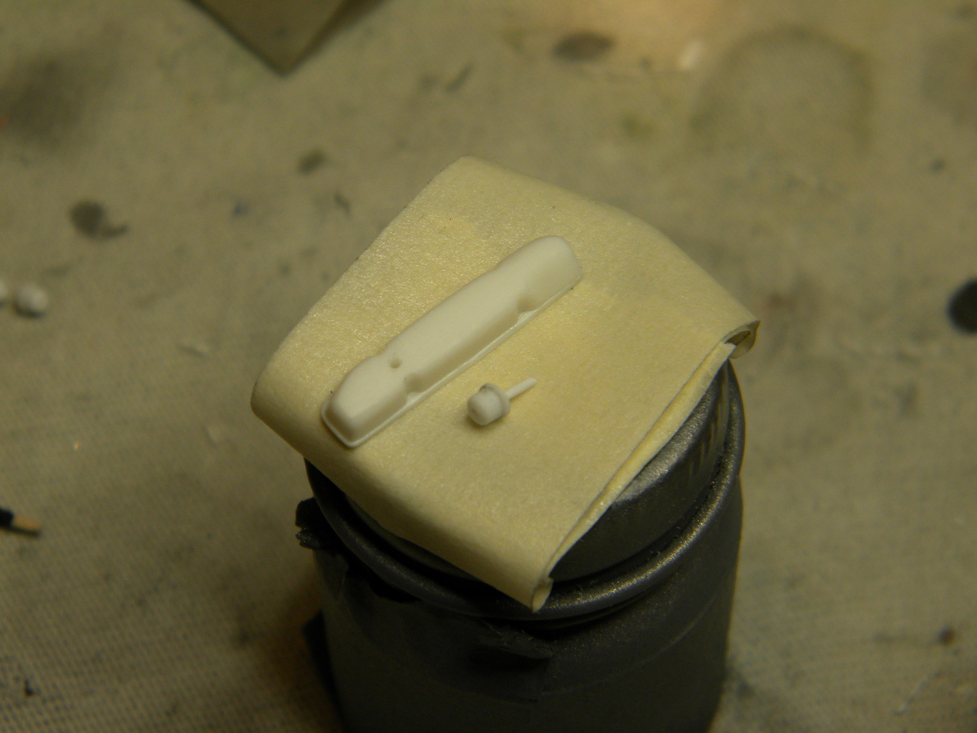

First I wasn't enamored with the molded in oil filler cap on the valve cover, so I removed it and whipped one up quick, as well as adding the O-ring on the other valve cover for the vacuum line.
Then I cranked out a pair of fuel filters.
Steve

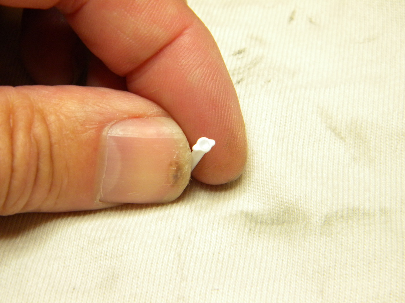

Steve, can you elaborate on how you made the breather grommet in the valve cover? Drilled a hole in the end of round styrene rod and rounded the outside radius before cutting it off? Everything looks fantastic
Edited by garagepunk66
Something like that Dan, only easier! :)
It was a simple operation of drilling a small hole in the end of a short length of plastic rod and then drilling a hole in the valve cover large enough to accept that piece of rod and slipping it into the valve cover until the desired portion was exposed on the surface and then gluing it from underneath.
After the glue is dry, you can trim any excess rod protruding on the underside of the valve cover and lightly sand the exposed portion on the top to round it down slightly.
Steve

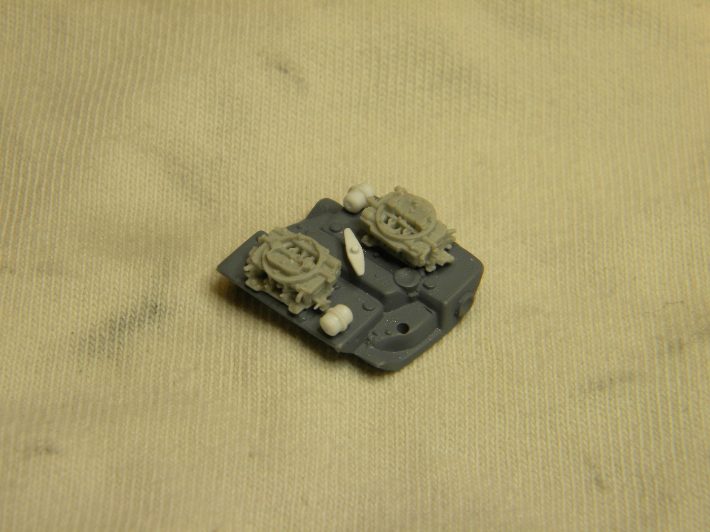

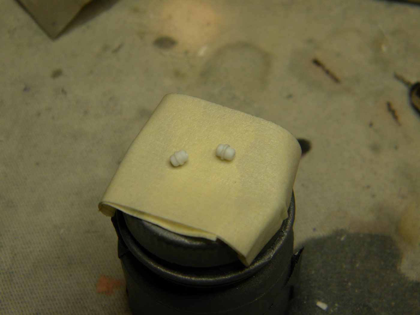

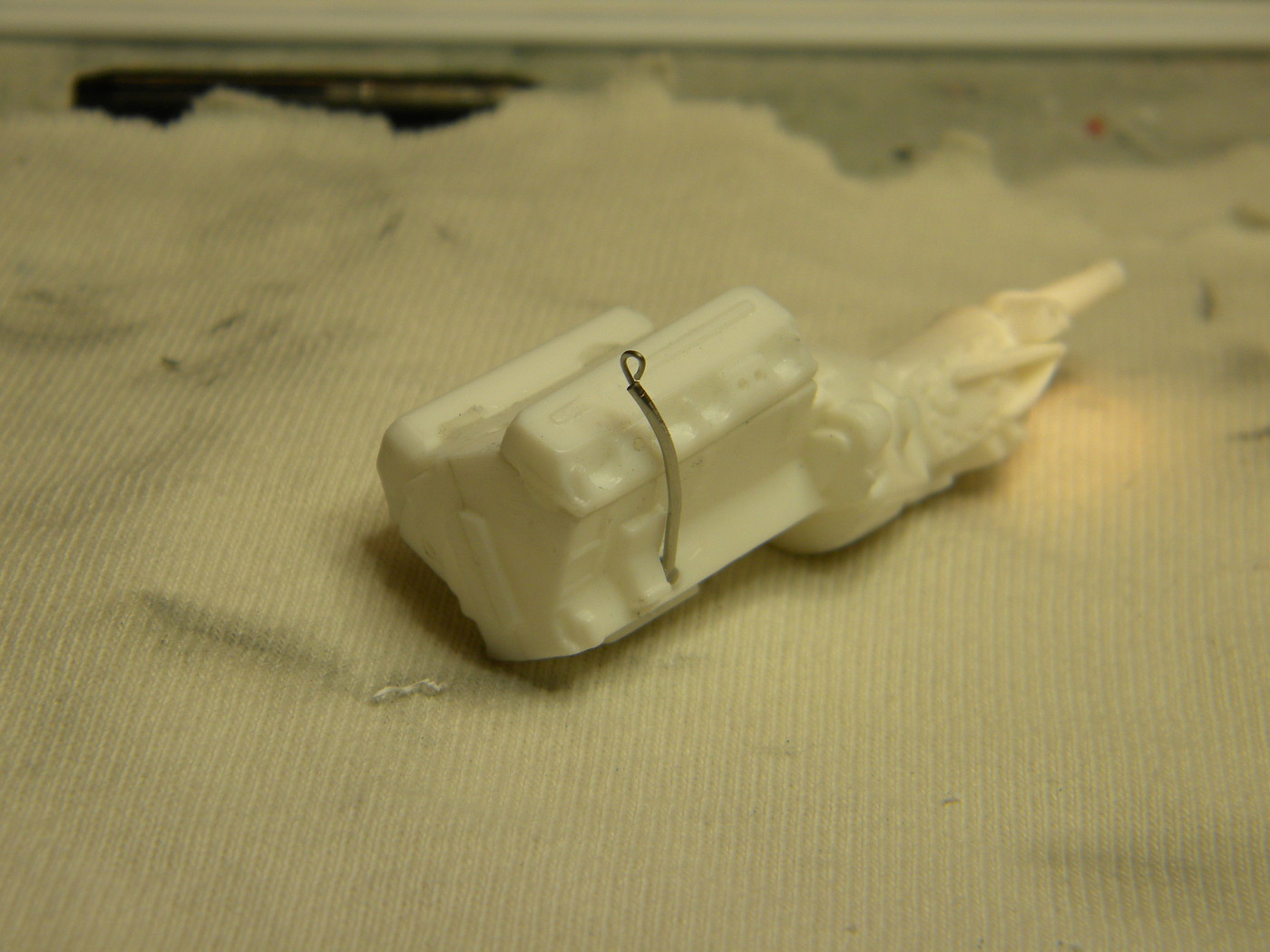

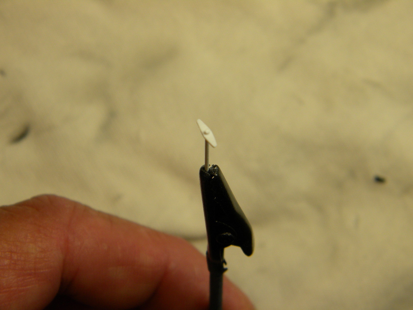

A couple more little details.
I wanted to be able to display the engine with the air cleaners on or off to show off the beautiful Fireball carbs, so I added a couple of air cleaner bolts to the carbs.

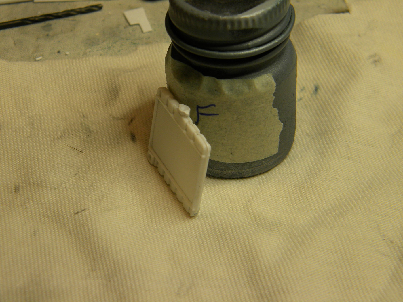

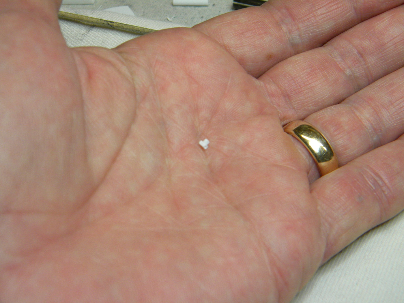

Then I decided that the radiator cap that was molded to the radiator wasn't going to cut it, so a new one was scratched.
Steve
Next I added the radiator overflow tube.

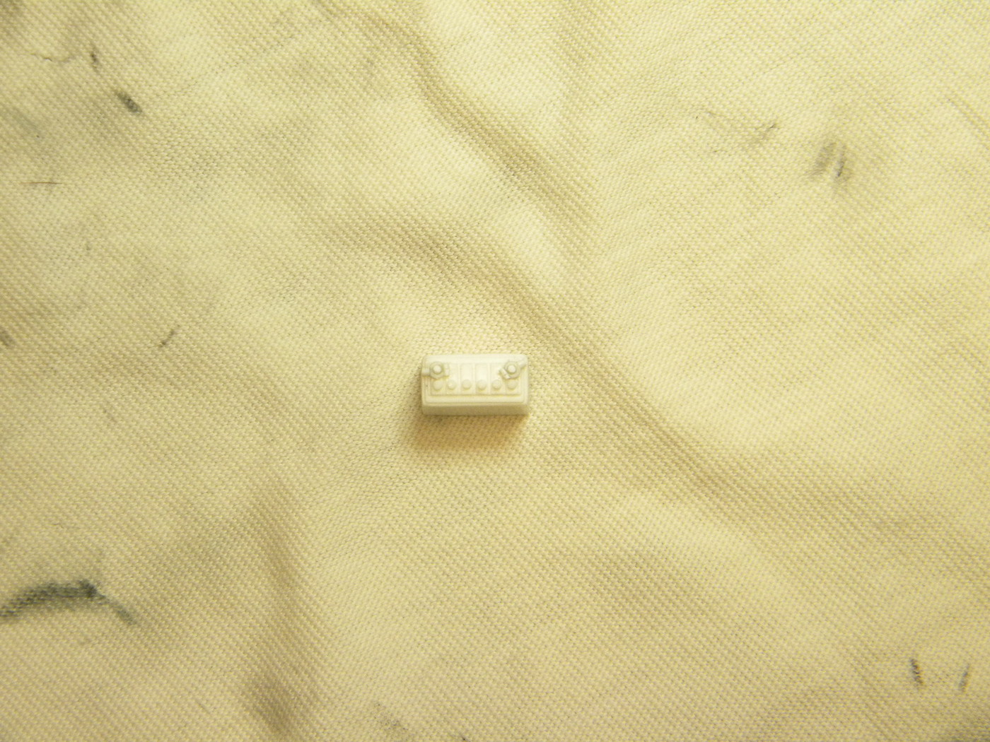

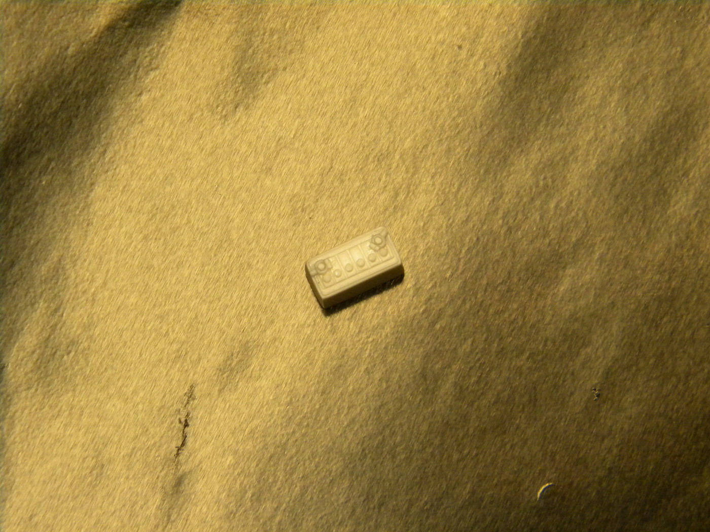

This battery had no clamp detail, only the posts.
Let me tell you, it was a real test of my eyes and dexterity to make something halfway presentable! ?
I believe now I'm ready to start painting some of these parts!
Steve
"Bet that's a job and a half..."
There's a real good set of clamps on the AMT '62 Catalina's battery; after having whittled away most of said battery (and part of my sanity) to get at the darn things, I may cast them next time.

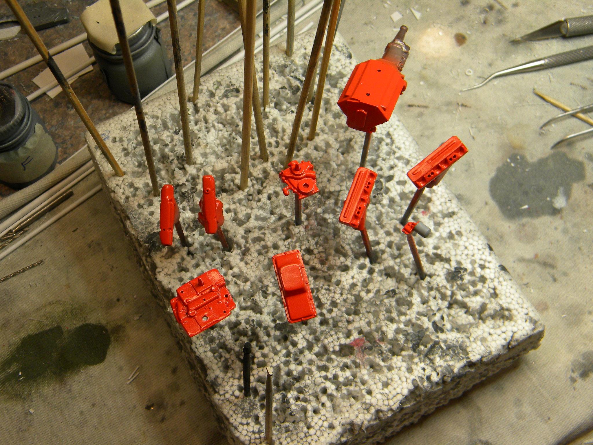

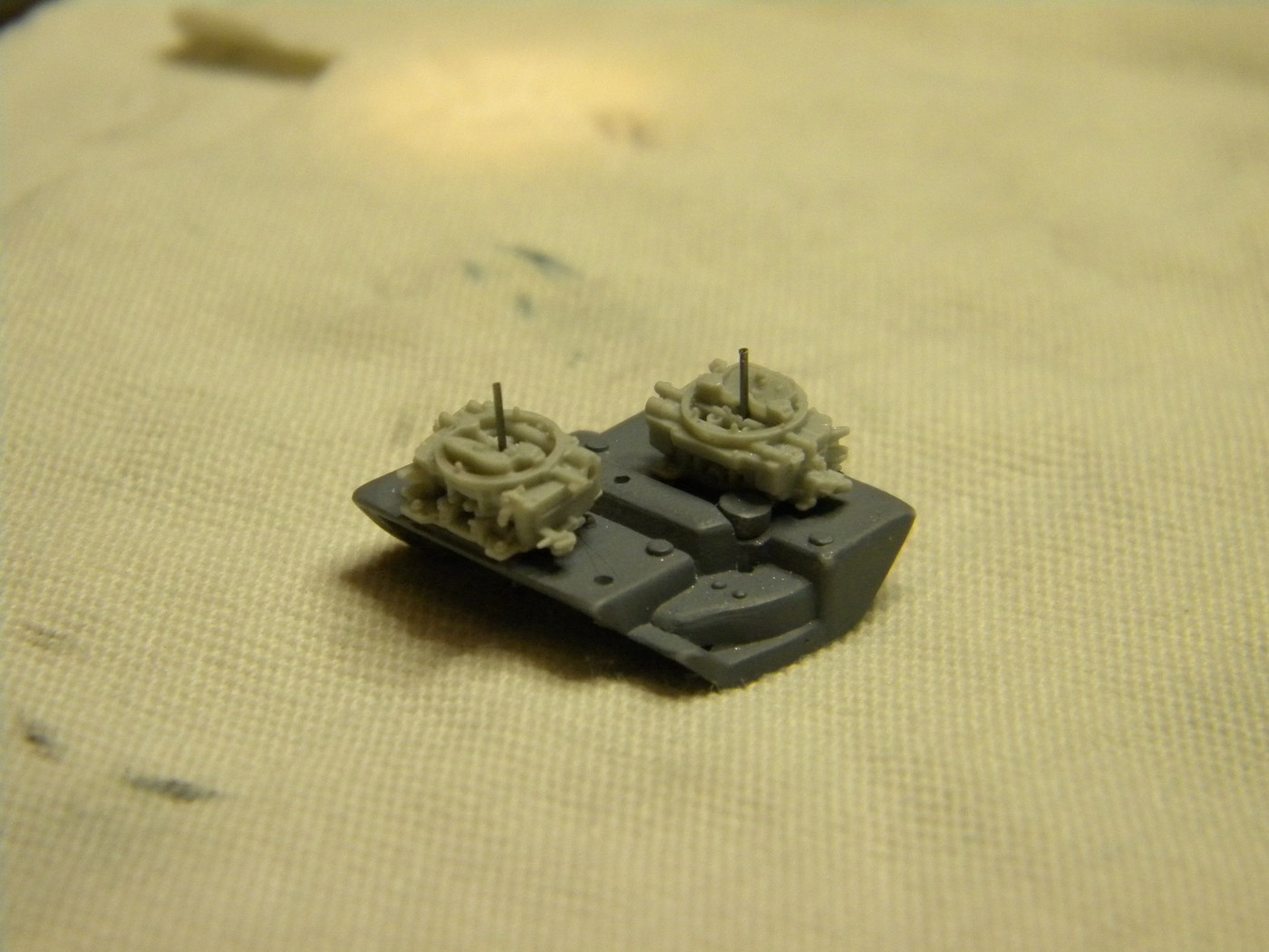

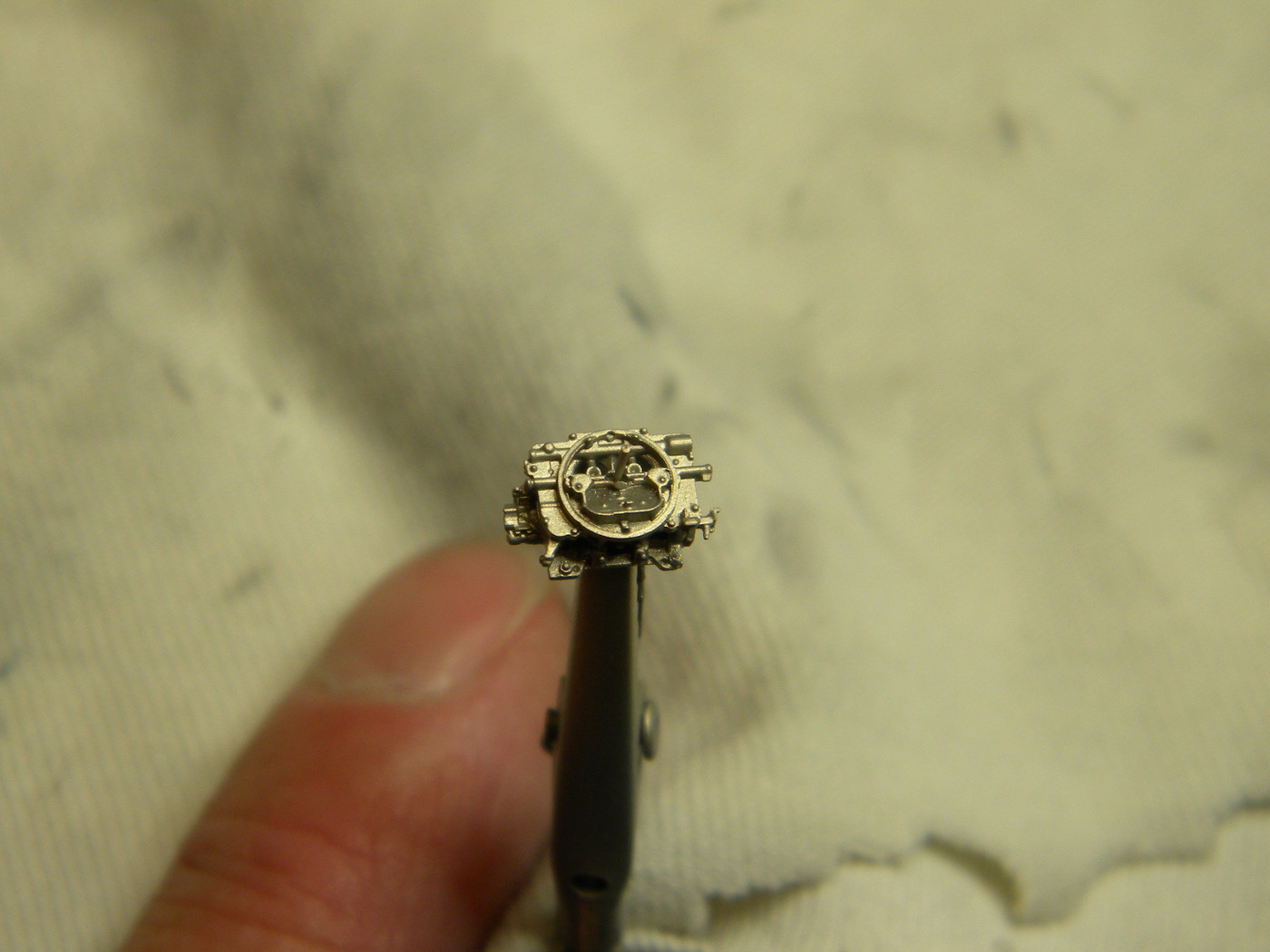

I didn't think that these Fireball carbs could look any better........and then I painted them!!! ?
I shudder to think how they will look after some detail painting and a wash!
Steve
I probably could have saved myself a ton of work and looked for a different battery........but where's the fun in that? ?
Steve
