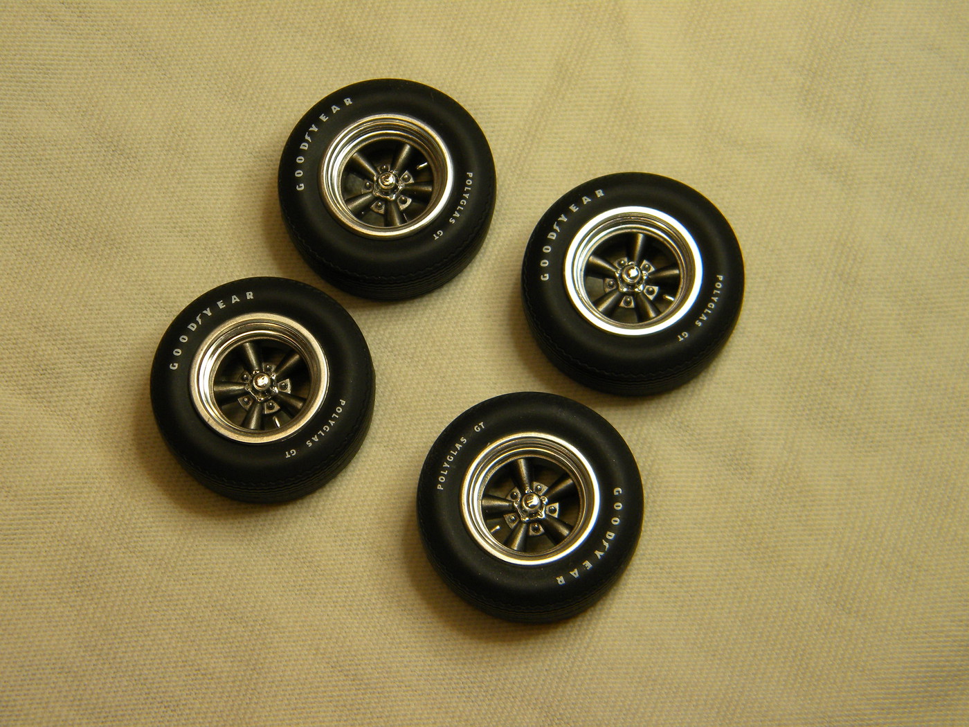

StevenGuthmiller Posted May 21, 2019 Author Posted May 21, 2019 I think that I'm finally done refining the wheels! Now I found a set of chrome center caps shaved from another wheel so I don't have to use the home cast Alclad painted ones! I'll just need to add some Molotow to the lug nuts and possibly some valve stems. Steve

StevenGuthmiller Posted May 25, 2019 Author Posted May 25, 2019 This is the first part of this project that you can call finished! Steve
Brutalform Posted May 26, 2019 Posted May 26, 2019 Wheels look fantastic. It’s amazing what a little detail can do to make them look so realistic.

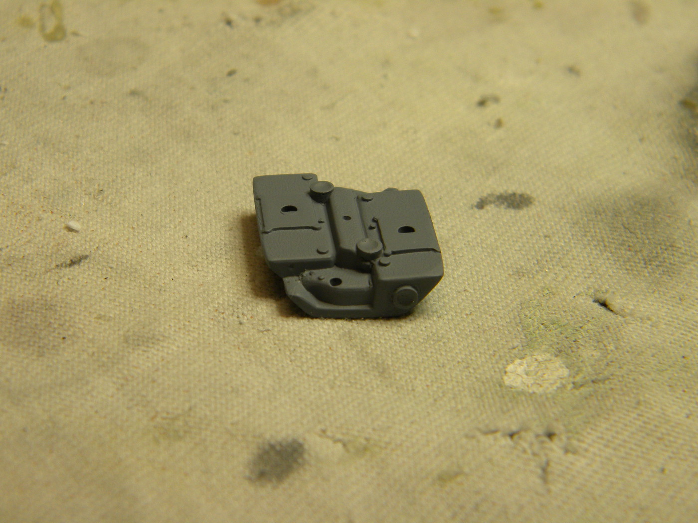

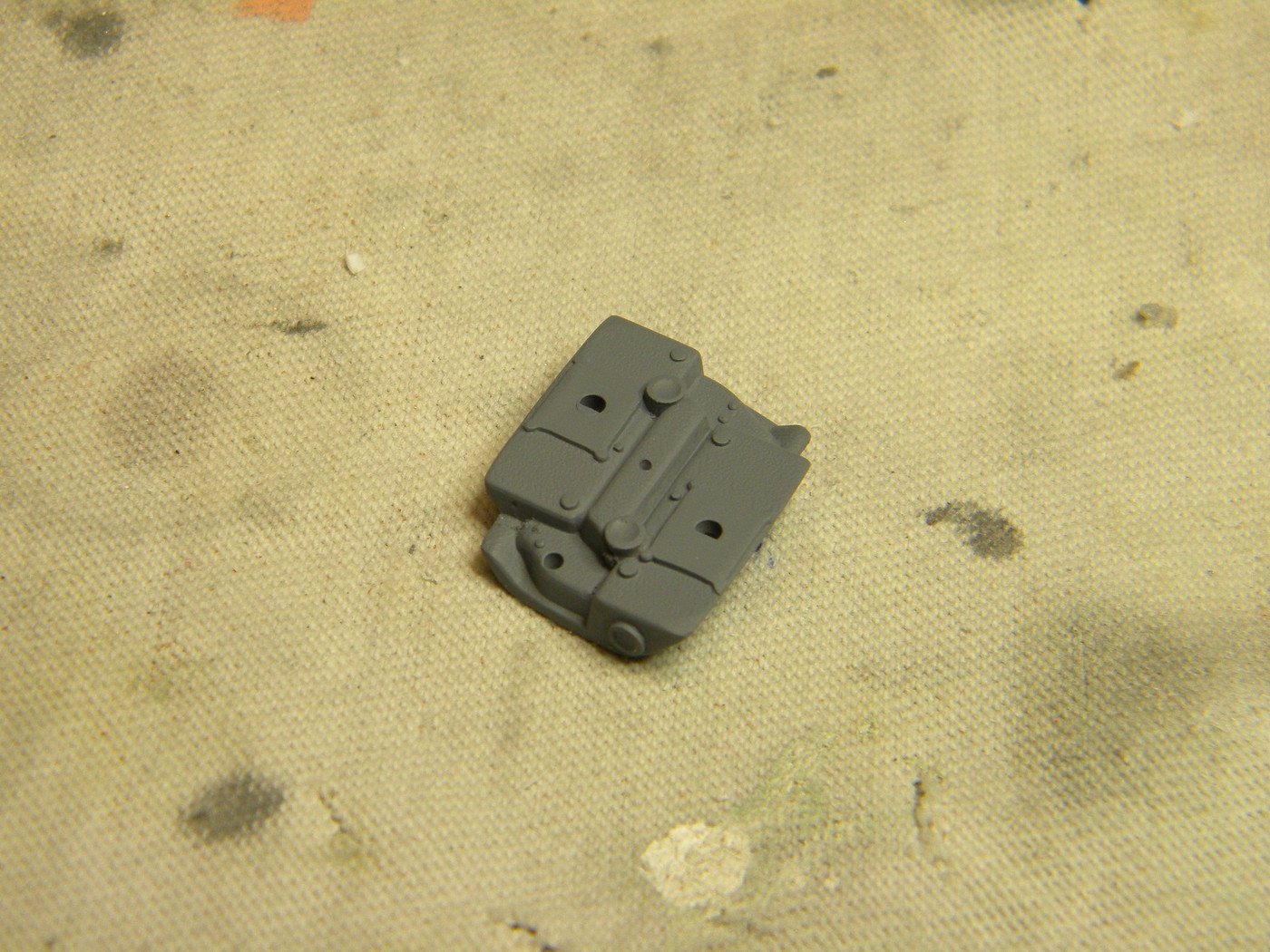

StevenGuthmiller Posted May 27, 2019 Author Posted May 27, 2019 Although I still greatly appreciate the fact that Dan Carlson, (garagepunk66) was so gracious as to send me a bunch of engine parts for this project, it turns out that the intake, heads, etc, will not work with the Lindberg block. Apparently, the Lindberg engine is too long making it difficult to decide between sticking with mostly Lindberg parts, or scrapping the whole thing and beginning a search for an entirely different engine. At this point I have decided that, at least for this project, I'm going to stick with the Lindberg engine to be certain that there will be no need for further modifications to the chassis or other parts that are, for all intensive purposes, finished. So, I guess I will go back to plan A. Oh well, I guess the Lindberg intake that I modified previously doesn't look half bad in primer. Thanks again Dan! I have no doubt that I will be able to use the parts that you provided on a future project. Steve

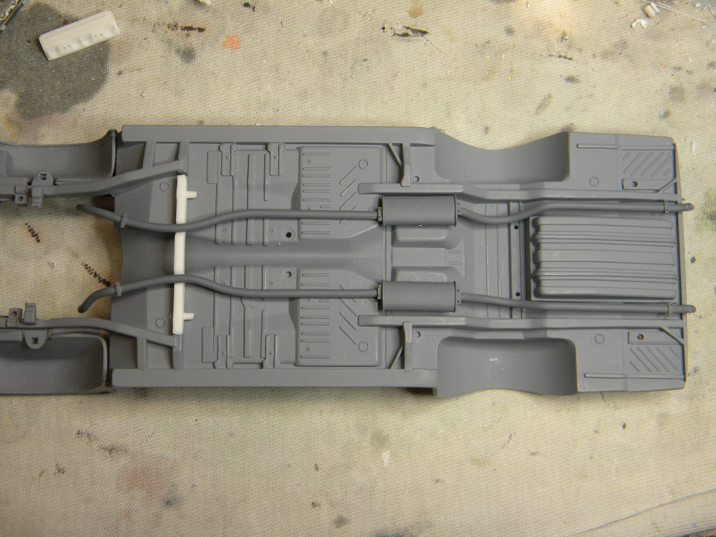

StevenGuthmiller Posted May 27, 2019 Author Posted May 27, 2019 The scratch built exhaust system turned out quite well. Primed and ready for paint. Steve

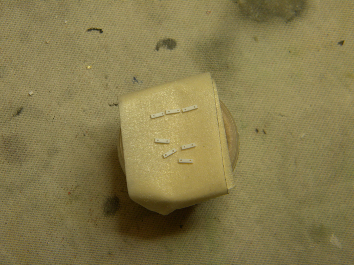

StevenGuthmiller Posted May 28, 2019 Author Posted May 28, 2019 1 hour ago, Brutalform said: Looking great Steve. Isn’t it nice when things come together so nice? I don’t have an airbrush yet, but, there are some Model Master lacquers that spray so nice right from the can, making it a delight. Those muffler clamps you scratch made look great on the exhaust. I noticed you drilled them and I am guessing there are “u” bolts as well? If I try to drill holes that small in such a small piece of styrene, I always break through one of the sides, even with the smallest pin vise bit. I have really gravitated towards premixed air brush lacquers over the past few years mainly because of the huge color pallet available. I hate nothing more than being limited to what's available in a spray can. With these paints, the sky is the limit for colors and there is much better control in spraying with an air brush once you play with it for a while. The brackets were drilled and "bolt detail" added to the top, but no u-bolts. I contemplated doing that with wire, but decided that it was a detail that was very unlikely to be seen and not really worth the effort. I drill narrow parts like this with the smallest bit that I have first, and then cut the part to length after drilling. It makes handling much easier. Steve
