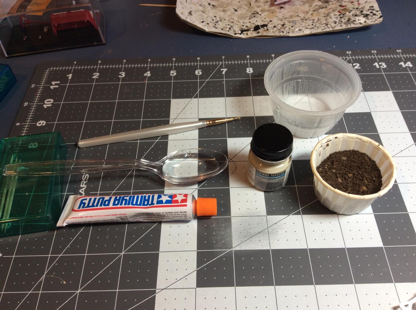

You will need: Dirt, Tamiya body putty, flat tan paint (optional), water, a small container (to mix the mud concoction in), and a paintbrush (use one that’s ok to get body putty in the bristles).

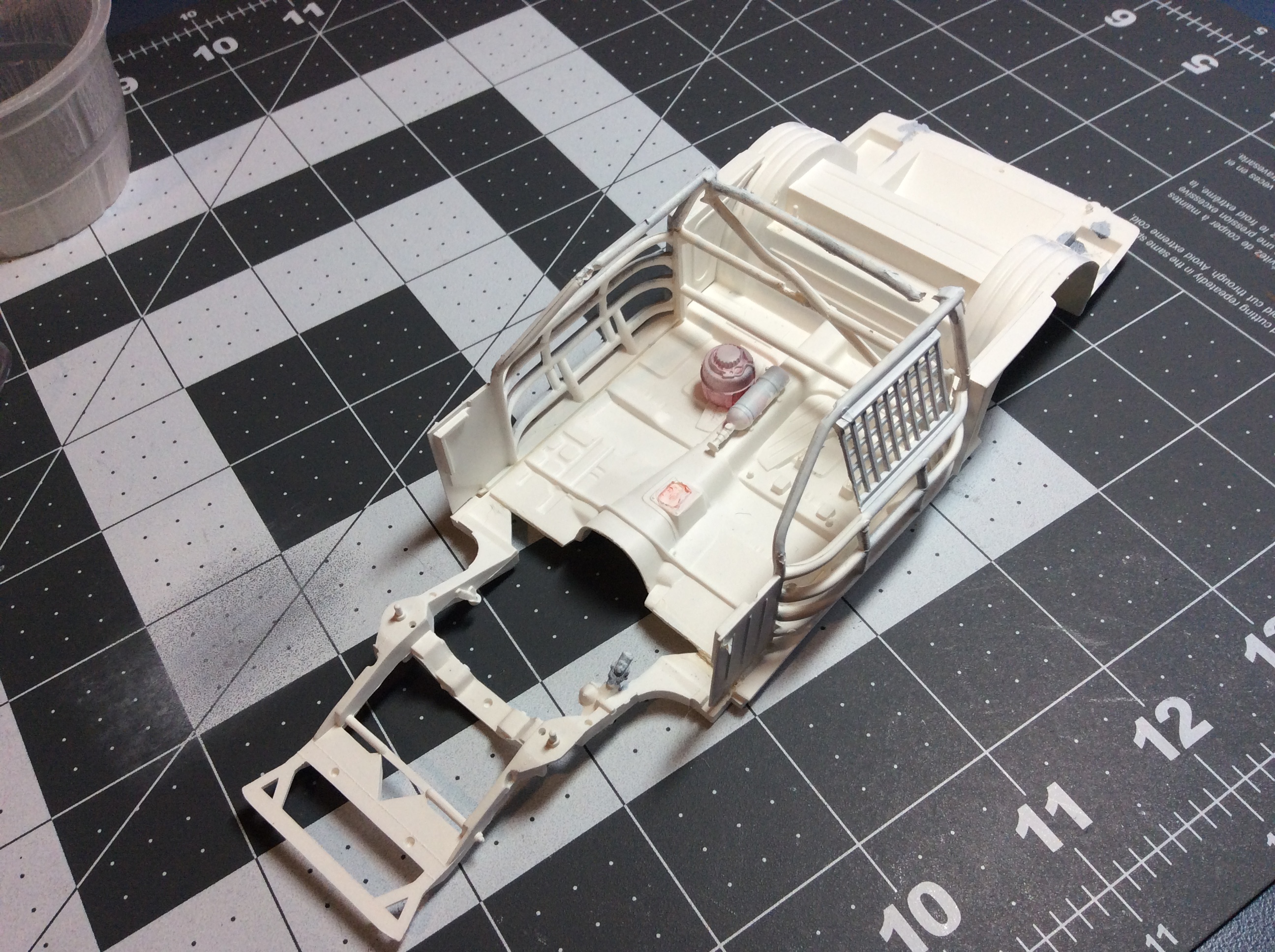

I first sprayed a decent layer of primer on the part(s) that are getting muddy. I used white primer to show the difference between the two effects, but I recommend using tan or brown primer.

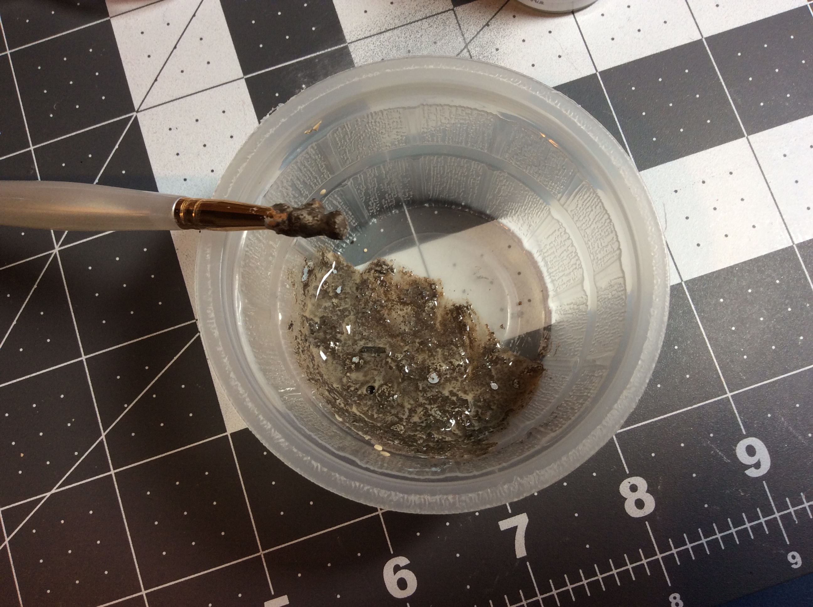

Then: mix the body putty, water, dirt, and paint (if desired) together. It should look something like this.

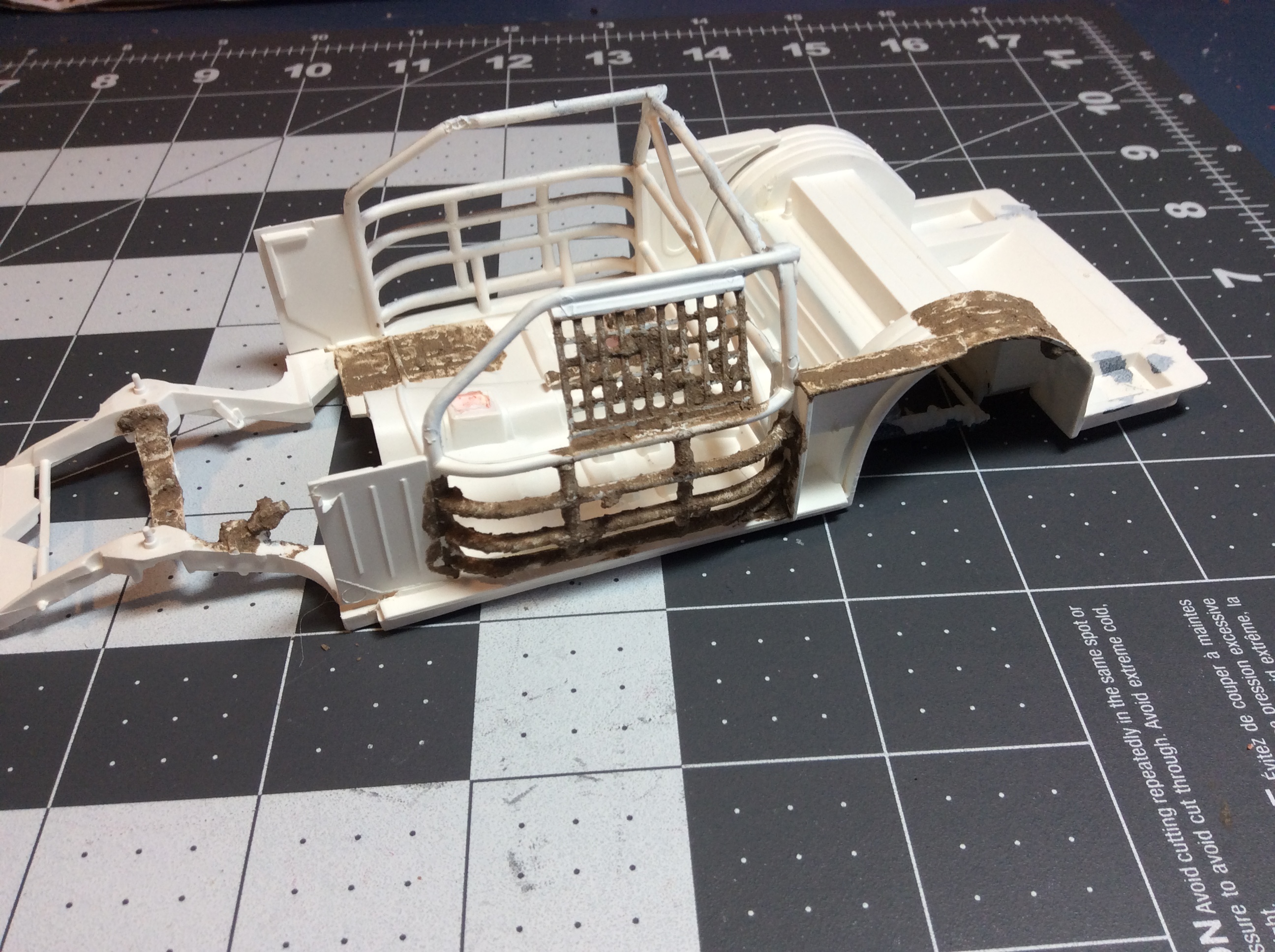

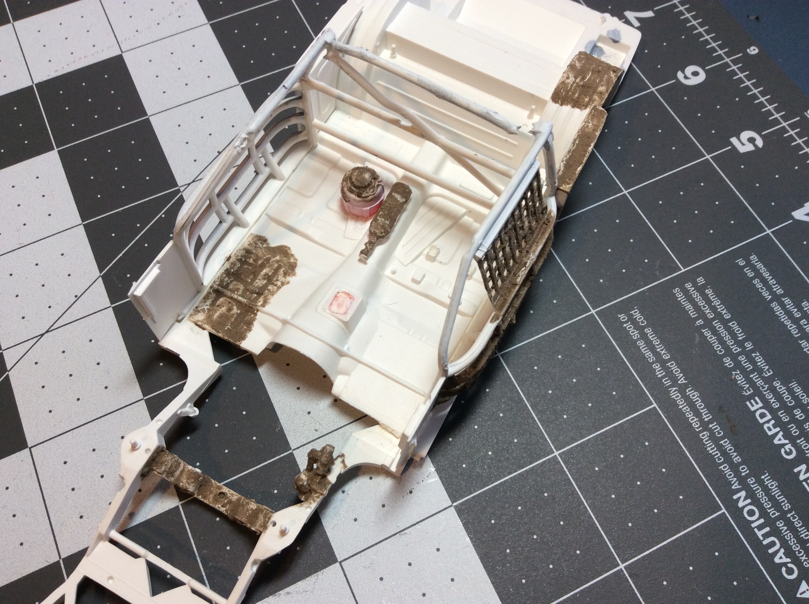

Here is about how it’ll look when applied.
5C243FA5-1706-47AD-B4FA-8F28AF3B978A.thumb.jpeg.f447349af02c020ffdac41cf51acb55e.jpeg2456D944-1589-47A6-8DAF-5973444B6E8A.thumb.jpeg.2ef18ad2d9104097b1953cb44bcd8e07.jpeg

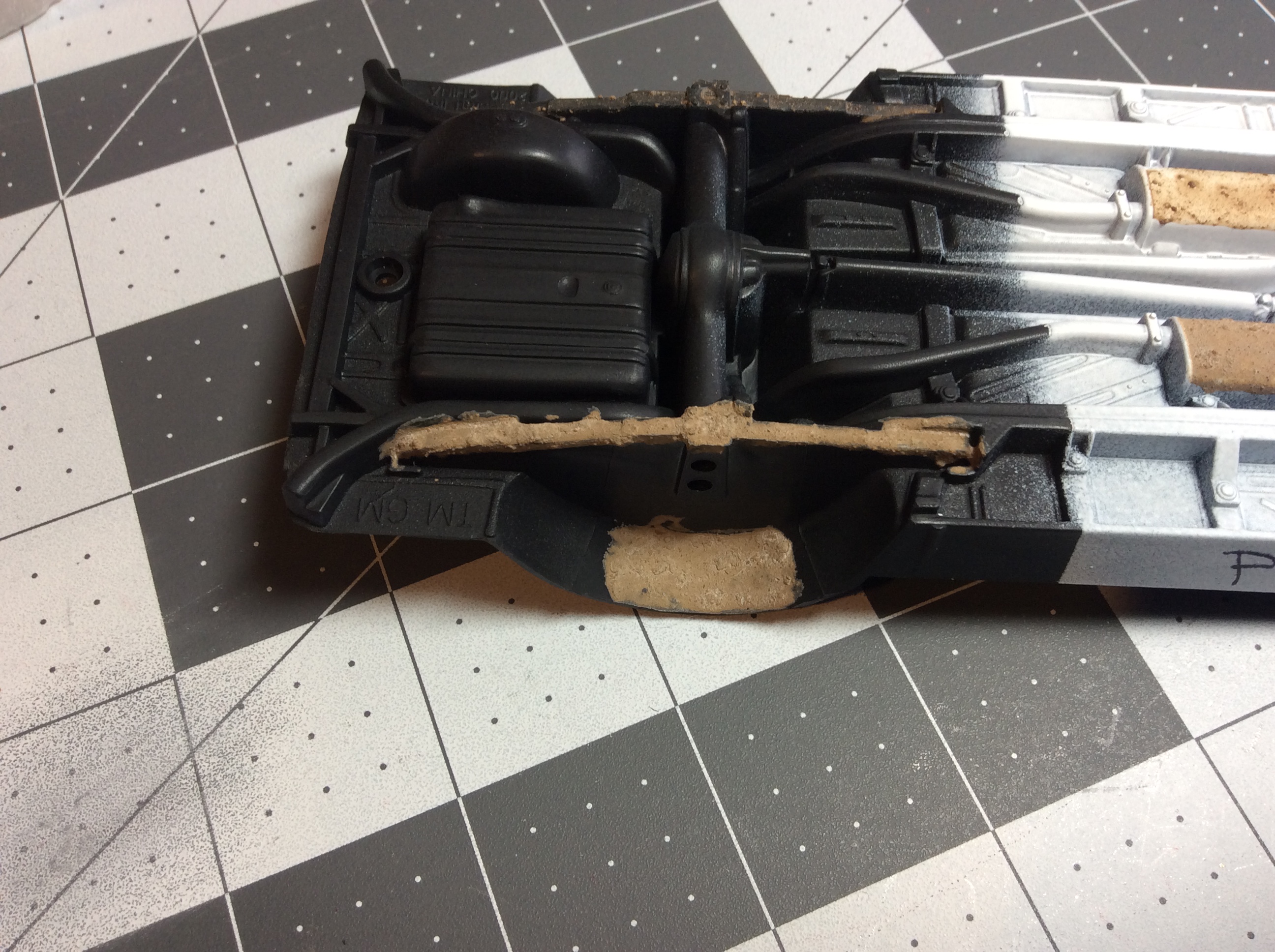

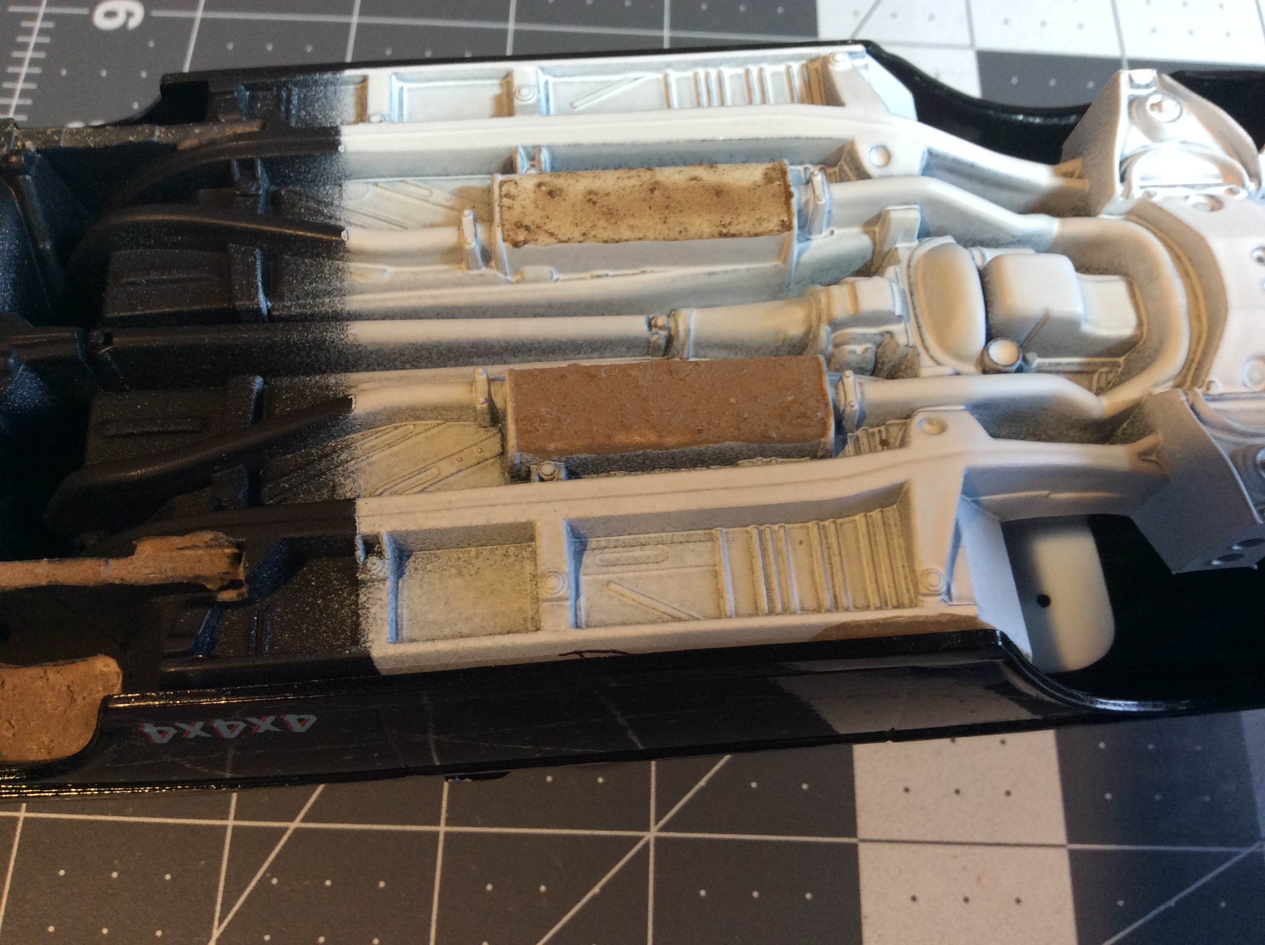

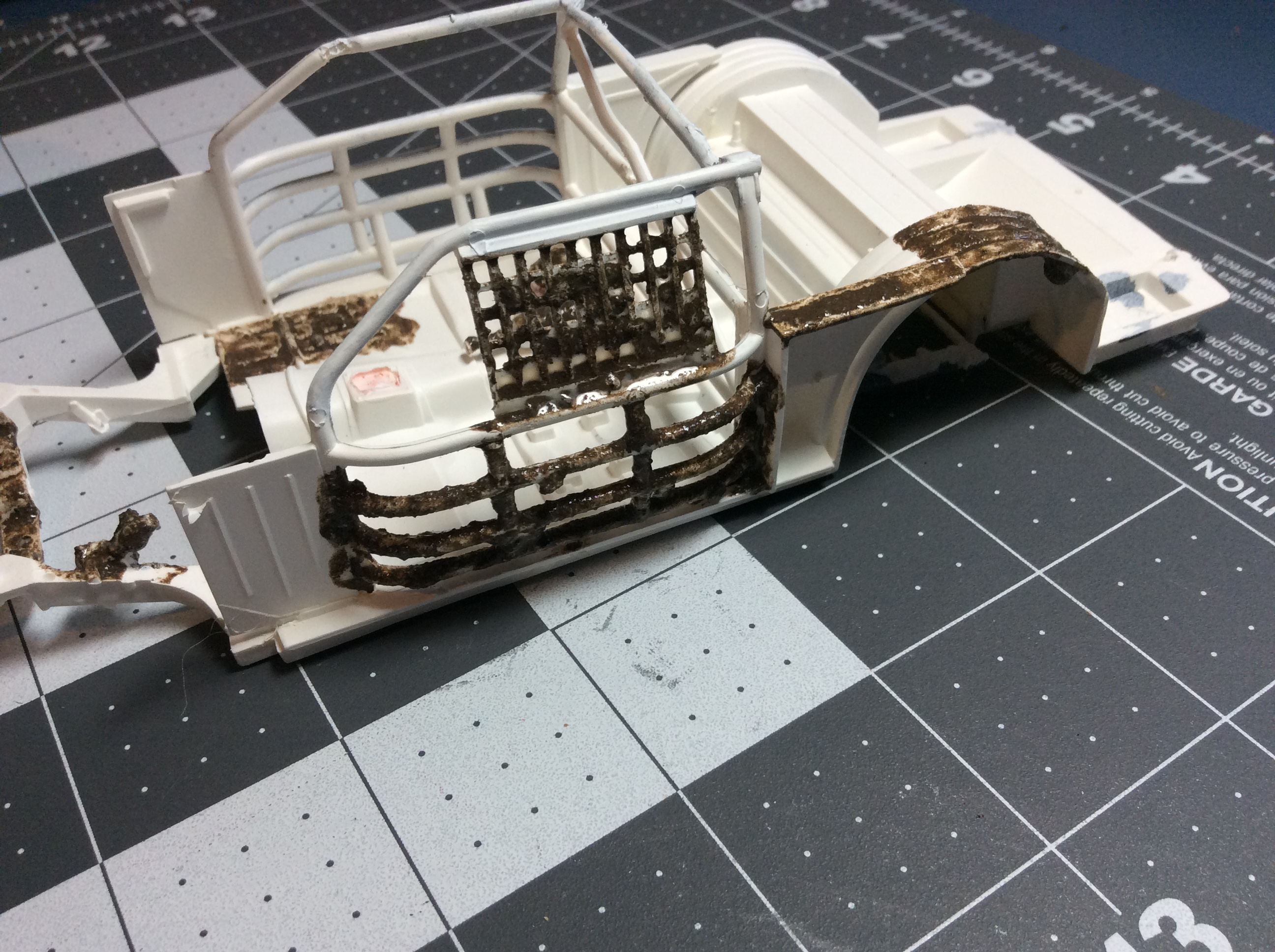

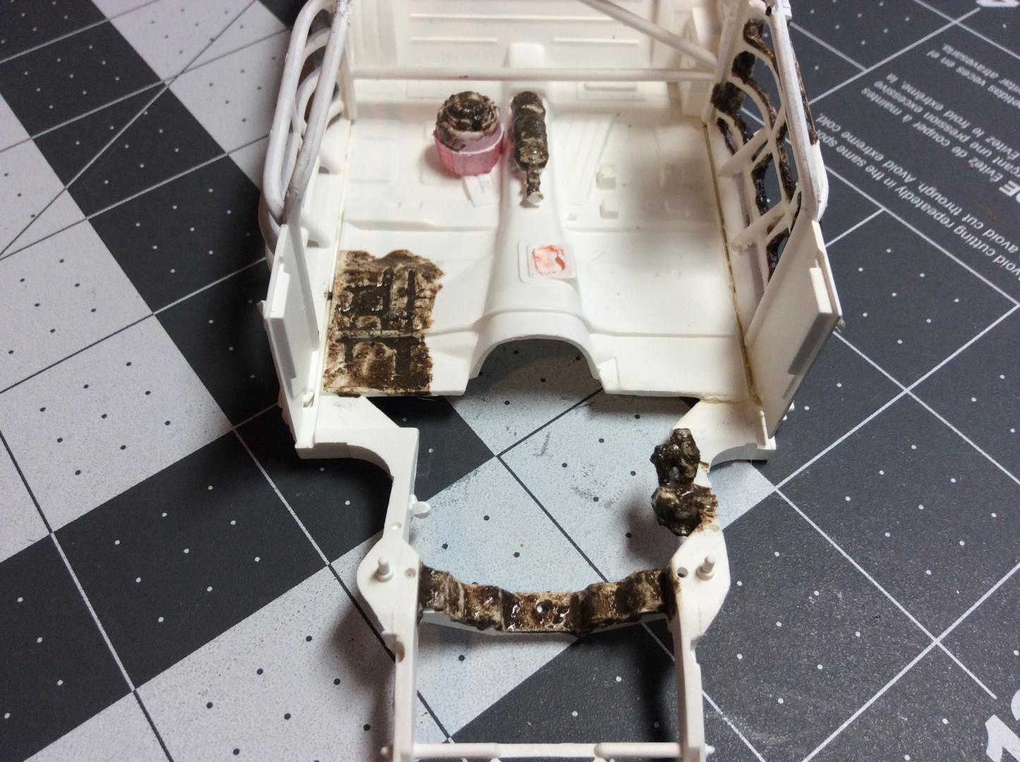

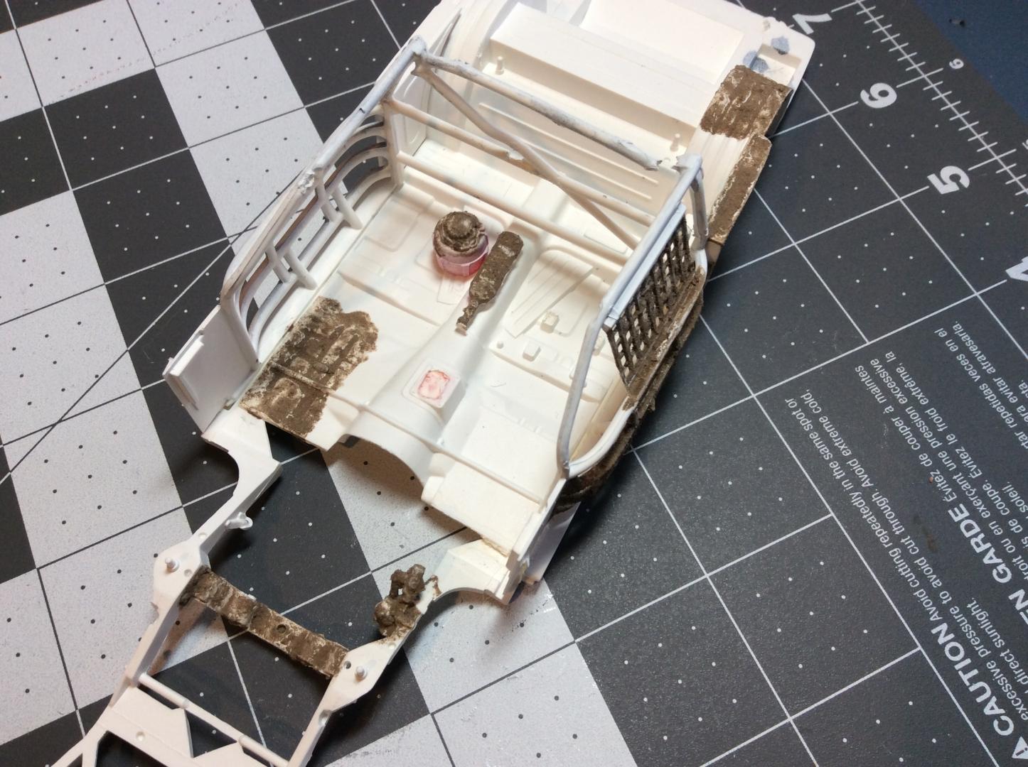

To get a thick, dry mud effect as seen in the first two pictures below, I mixed about a dime-sized blob of body putty, a little less water than putty, an amount of dirt equal to the body putty and water, and about 5 drops of tan paint. To get a thinner, dirt-like effect as seen in the last two pictures below, I added more water, less dirt, and less paint.
1956EE7C-BBAC-4E8A-B896-FAC98ECC87C0.thumb.jpeg.927908be61a633d435dddfda47648a5f.jpeg491E7623-9AF2-4447-B6AF-EABEF524A3B3.thumb.jpeg.0be9c0e1093f81b61755a1a41c803e2c.jpeg235C1E6F-CF73-46B9-B6FC-94A9E9F74EE5.thumb.jpeg.9e06d6632299b075c484feca580c56d2.jpegF35A6F7F-967F-4C11-9A53-E690ED7F6EBF.thumb.jpeg.c25cb21eb246bb80e3d83a23d821e22e.jpeg
