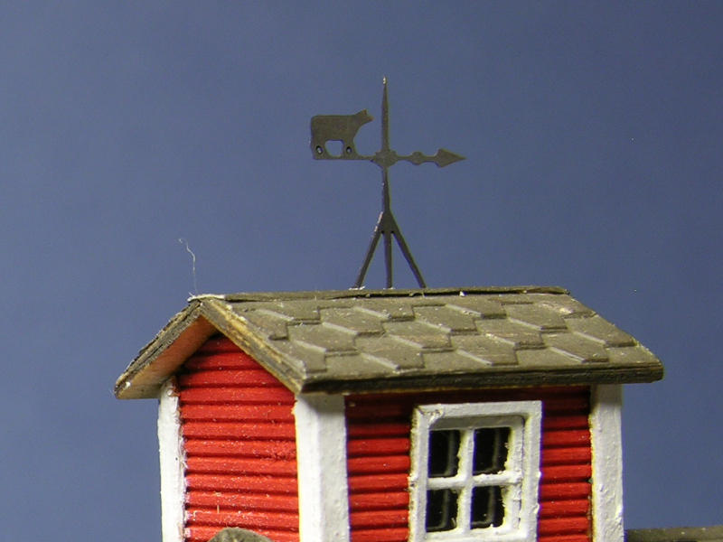

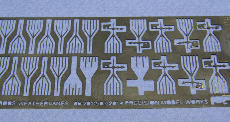

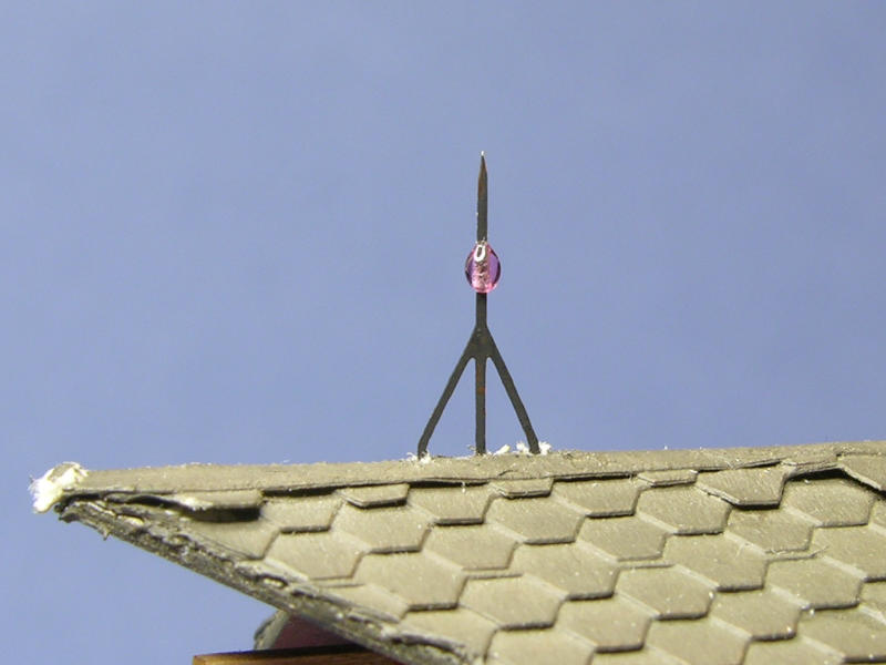

I have been etching electronic circuit boards since my teenage years.  Etching model parts is a similar process.
The only photos I have handy now is weather vanes and lighting rods I etched for an N scale (1:160) barn on my friend's model train layout.
I designed the artwork in Corel Draw, then printed it on a transparency.  Then I took a sheet of 0.005" brass, sprayed with a photoresist and a regular lacquer on the other side. Then I exposed the photo resist to UV light through the artwork (mask). Developed the photoresist and put the brass sheet in Ferric Chloride (etching solution).  This is what I ended up with:
And here they are after being placed on the barn.
