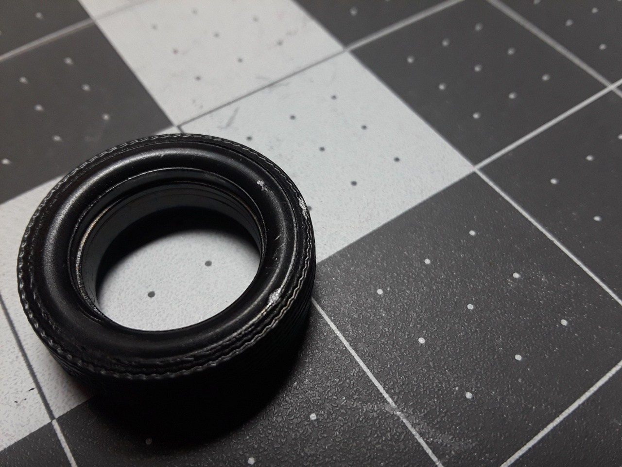

Hotrod 97 Posted May 13, 2019 Posted May 13, 2019 Is there a way to get paint off of tires without ruining them? Here is an example from the '64 Indy Pace Car that I'm rescuing.
Snake45 Posted May 13, 2019 Posted May 13, 2019 Shouldn't be a problem at all. Try rubbing alcohol, lighter fluid, Goo-Gone, acetone-free nail polish, whatever you have on hand.
StevenGuthmiller Posted May 14, 2019 Posted May 14, 2019 Just plain old mineral spirits works for me. Steve
BigTallDad Posted May 14, 2019 Posted May 14, 2019 Or you could just re-paint them black (do NOT use an oil-based paint).
ChrisBcritter Posted May 14, 2019 Posted May 14, 2019 If those are vinyl tires, you can probably scrape it off with your thumbnail.
Hotrod 97 Posted May 14, 2019 Author Posted May 14, 2019 Thank all of you for the replies. Excellent information from all of you. Some rubbing alcohol and a cotton swab took the paint right off.
espo Posted May 14, 2019 Posted May 14, 2019 I have used the "Purple Pond" method in the past with great results.
