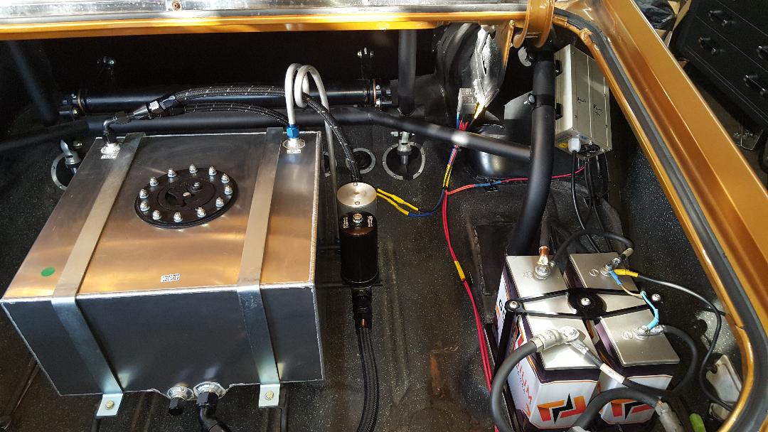

QuikTimz Posted July 30, 2019 Author Share Posted July 30, 2019 (edited) Evenin' everyone...The 1/25 Nova model project has been on a short hiatus for the past few weeks as we have been re-assembling, re-plumbing, and re-wiring the subject of my build...The fresh 565 BBC, custom Lemons Headers, FTI 'Glide, Pro-Torque converter, custom radiator & electric fan are all new mechanicals for the car, so it is very much like building a full scale model: fit - modify - refit -remodify - final fit...We are also installing an ARC 12-switch panel with satellite switch panels in the engine compartment (for valve adjustment & tuning), a RacePak datalogger system and LCD digital dash, and an MSD Grid controller...all the new electronics, modifications to the fuel and cooling system wiring, pretty much predicated removing all of the wiring I did three years ago, and starting fresh...really, the only system that will not require a complete rewiring is the original equipment lighting circuits (it is a street car after all, lol), which I'll have to integrate with the new switch panel and it's fuse/relay panel... I haven't had much time on the bench, but I have made a little bit of haphazard progress here and there...I've been working on a template to bend/build a 1:25 scale, ten gallon aluminum fuel cell with sump that will mount in the trunk (along with the fuel pump and filter setup I'll need to fab), discovered that annealed brass tubing bends MUCH more satisfactorily than non-annealed tubing, and am still trying to develop a bending method that will give me more satisfactory results...the major problem I'm having trouble over-coming is repeatability: I need to create several mirror-image parts for the rollcage and front clip, not to mention the front control arms...many of the aftermarket parts I've ordered for the build have been rolling in...I now have about 80% of the drivetrain collected, including the Fab9 rear kit with PE disc brakes and 3d printed calipers...those items in of themselves will wind up being little "models" on their own...here are some of the things that have come in, the parts they are replacing, and the planned modifications they'll get to more closely replicate the real thing (also pictured if I have them): 1) FAB9 Rear, sourced @ Futurattraction...I need to remove the "rectangular" bracing, and re-brace it with round tubular styrene to match the bracing on the new rear we put in...the rear PE rotors will need to be replaced with ones that more closely replicate the TBM Revolution brakes that we installed three years ago...I need to get the correct rear rim setup before I can begin on this... 2) Monoleafs/CalTracs, sourced @ 3D Model Specialties, these monoleaf sets will be cut apart and spliced together to make split monoleafs with CalTracs...then I can fab a set of rear sliders for them... 3) Front Tires, sourced @ Futurattraction...these are a nice looking copy of a Goodyear DS2 w/o sidewall detailing... 4) Rear Tires: sourced @ Fireball Modelworks, Mickey Thompson 315/60R15 Drag Radial, with amazing sidewall detailing...I'm building the model with these instead of the MT 10.5 Pro Bracket Radials we'll be starting this season with, as the Nova is set up to clear the 315s (if we need them), and I can't find a source for the 10.5s... 5) Weld V-Series Front & Rear Wheels w/beadlocks: sourced @ Futurattraction, these are a beautiful aluminum & PE rendition of the wheels, but through my own inattention, the rears are too wide for the Fireball Modelworks MT315s...I'm looking into custom-machined rim sleeves to fit the tires, and will still use the PE centers and beadlocks...they should look amazing once they're detailed and assembled... 6) Basic "Brodix" Big Block Chevy: sourced @ 3d Model Specialties, I still have a few more bits and pieces to collect (and fabricate) for it before I can begin it's prep, assembly, and detailing... 7) Short tail 'Glide: sourced @ 3d Model Specialties, I'm going to need to fab a flexplate and converter, (there doesn't seem to be anything out there remotely like the ProTorque bolt-together we'll be using this season) along with a trans overflow recovery tank (the black cylinder hanging in front of the trans pan in the photo) and transbrake solenoid... Edited July 30, 2019 by QuikTimz Quote Link to comment Share on other sites More sharing options...
