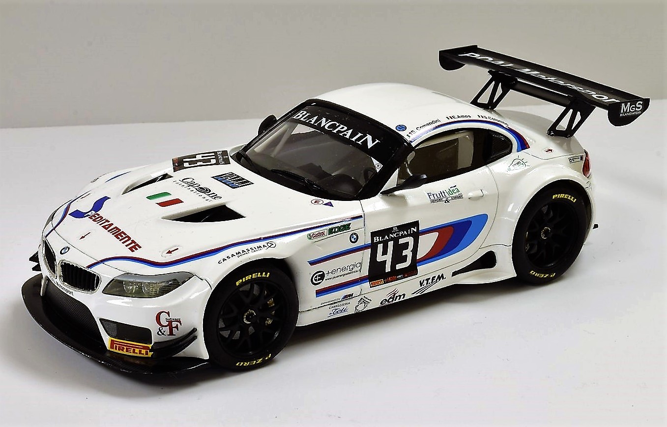

This is Tamiya Gray Panel Liner on a Tamiya TS-26 Pure White paint job. The panel liner is on top of everything, not underneath the paint. It's IMHO just enough to add the depth of the panel line without making it look like you drew them on with a mechanical pen.

this is exactly how i would like mine to look. can you tell me, did you do this with gray on the primer, then paint white, or did you do it after it was painted?
thank you
thank you
It is Tamiya White primer spray bombed onto a molded in white kit. TS-26 Pure White was spray bombed next. Once cured it was hit with 8k & 12k wet sanding and the polishing compound from the MicroMesh set. It was then decaled, once those were dry I applied the Tamiya Gray Panel Liner using the included applicator brush. It's basically super thinned enamel paint, so you just touch the applicator brush to the panel gap and the stuff flows via capillary action right into the gap with no muss, no fuss. It should do all the work for you and you don't need the thing drowning in liner fluid for it work. You can easily wipe off the stuff if you accidentally brush it against a body panel while it's wet. Or clean it up with Tamiya's Enamel Thinner X-20 (not X-20A that's acrylic thinner) if it dried.
