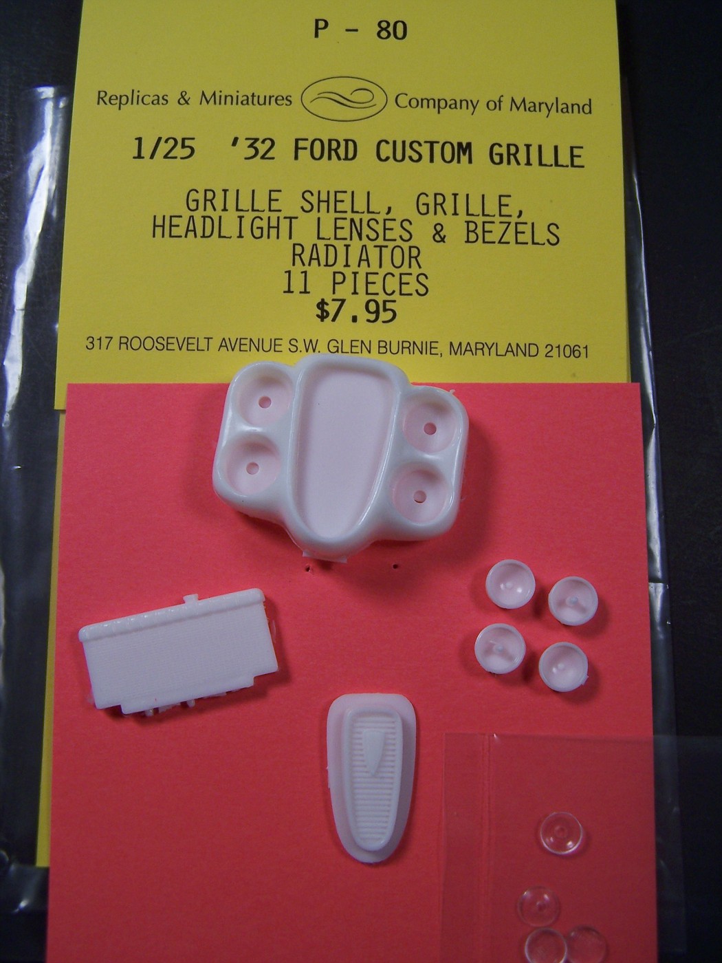

vamach1 Posted June 27, 2019 Posted June 27, 2019 Did R&M of MD make some of the parts in question in resin?
Jon Haigwood Posted June 27, 2019 Author Posted June 27, 2019 12 minutes ago, vamach1 said: Did R&M of MD make some of the parts in question in resin? Thanks Ace. I have two of the newer kits and I do see a difference in the parts from the Classic kit. Thanks for the link to workbench post. I will give it a good read They do have a similar grille shell assembly, Current price is $8.95
Ace-Garageguy Posted June 28, 2019 Posted June 28, 2019 2 hours ago, Jon Haigwood said: ...They do have a similar grille shell assembly, Current price is $8.95 The R&M parts you posted aren't Ala Kart. They're repops from this kit...

Jon Haigwood Posted June 28, 2019 Author Posted June 28, 2019 (edited) YUp ,your right thats why the grille has that wonky insert in it. Edited June 28, 2019 by Jon Haigwood
