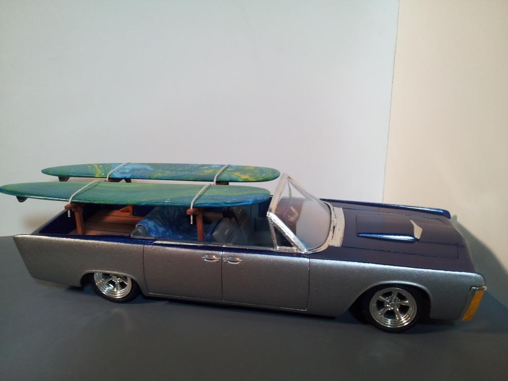

Jantrix Posted November 4, 2019 Author Posted November 4, 2019 14 hours ago, espo said: A few years ago some model builders were doing something like this. They would spray different colors of spray paint on top of the water in a container that was big enough to lower the models body into the container. They would then slowly raise the body out of the water and set it aside to dry. Some would create a swirl pattern on the waters surface or even turn the body slightly as they removed it. The effects you can work on to what ever look you're going for. This I have done before. I did the surfboards on this Lincoln. But it's not hydrographics. Hydrographics is some sort of film that is placed flat on a water surface, and an activator is sprayed on and then an object is pushed through it. It's become very popular for customizing most anything.
