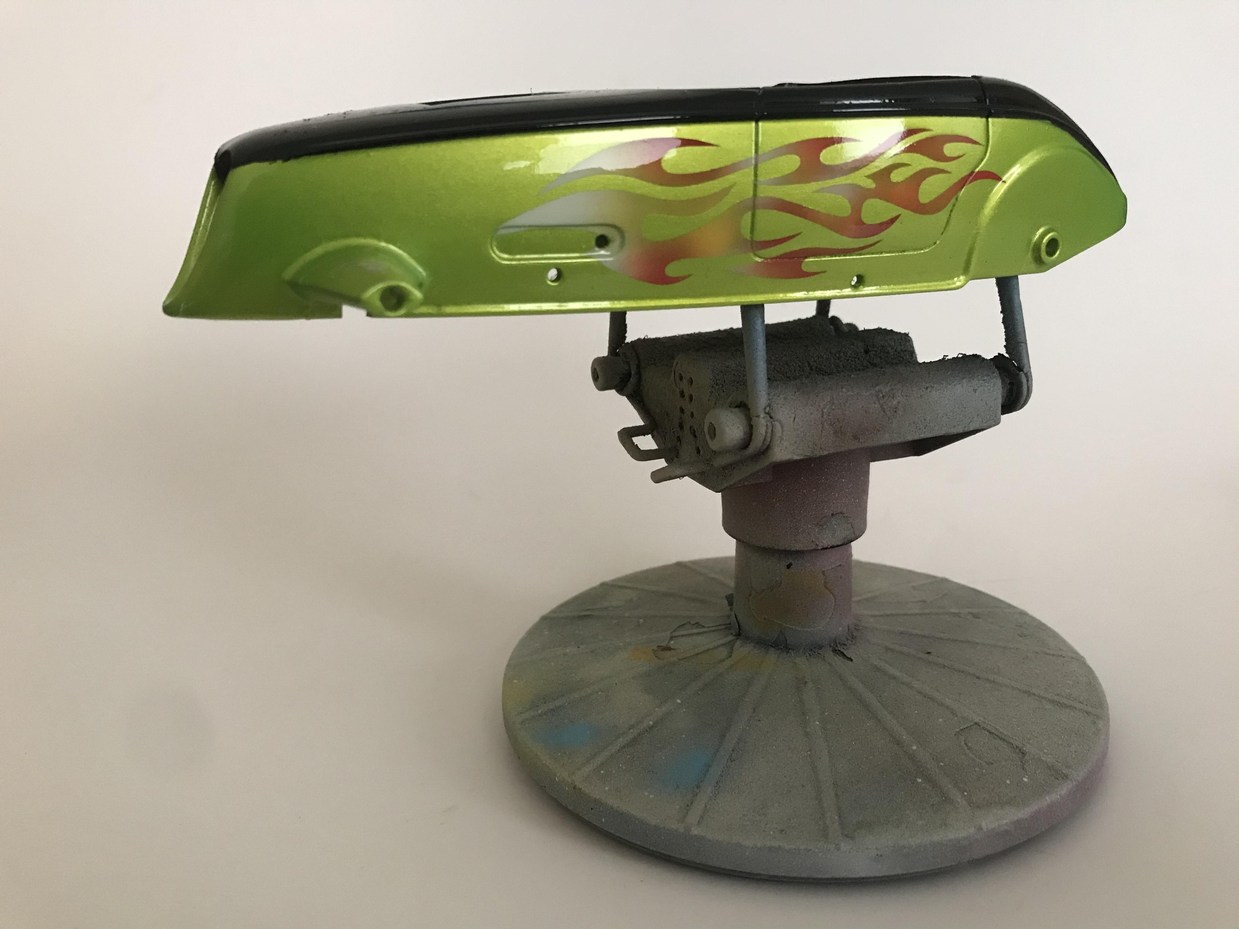

I couldn’t find a thread specifically for tips and tricks on using a scrapbook cutter (such as the ones Silhouette and Cricut sell) so I thought I’d show some of the stuff I like to do with mine.
The most obvious use is to use them roughly as they’re intended and cut either vinyl or masking material for airbrushing or painting.  Here’s some I did recently using airbrush frisket:

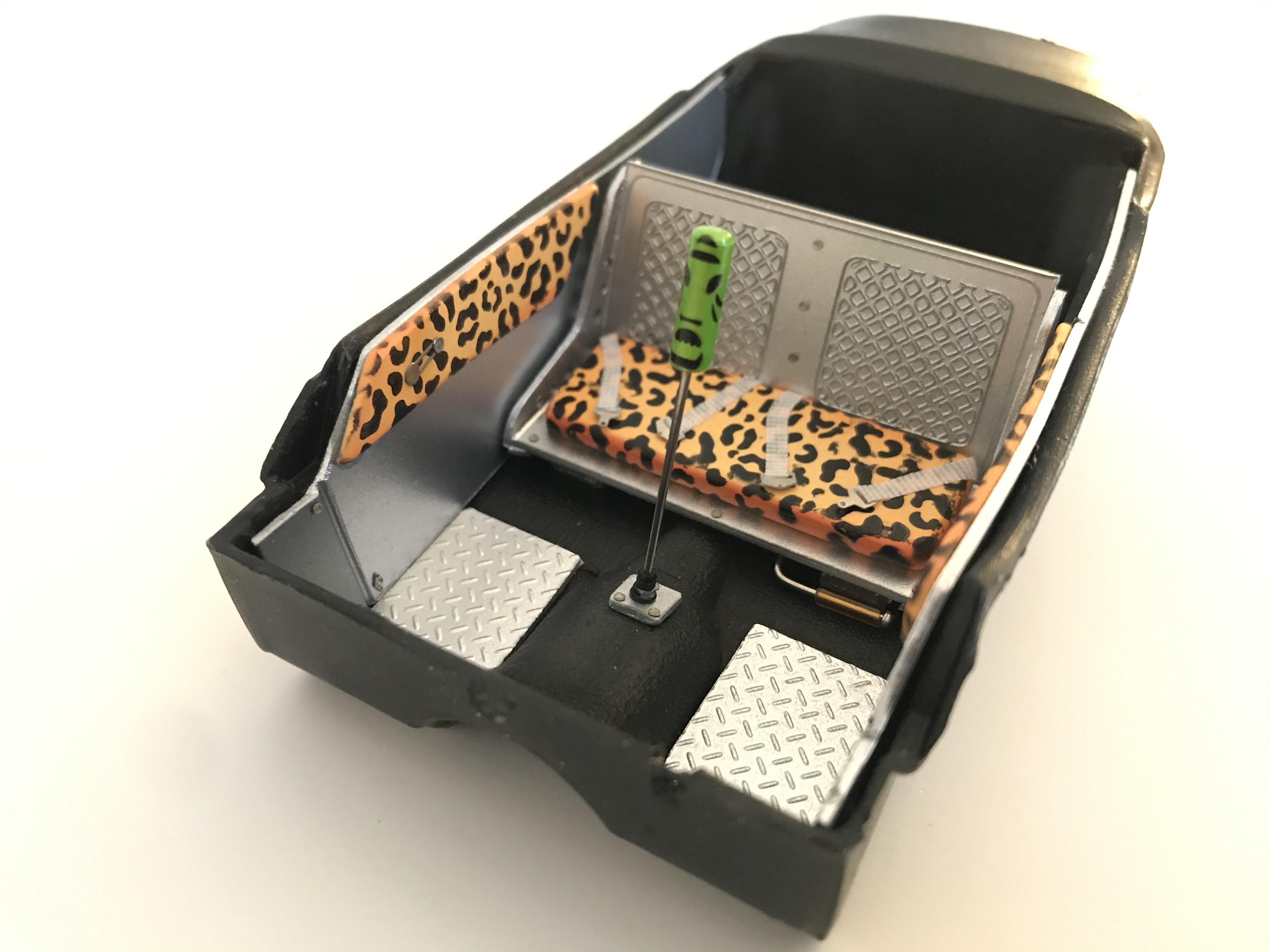

Another project I did lately called for a leopardprint pattern on the interior, so I used the cutter to make a mask so I could paint that:

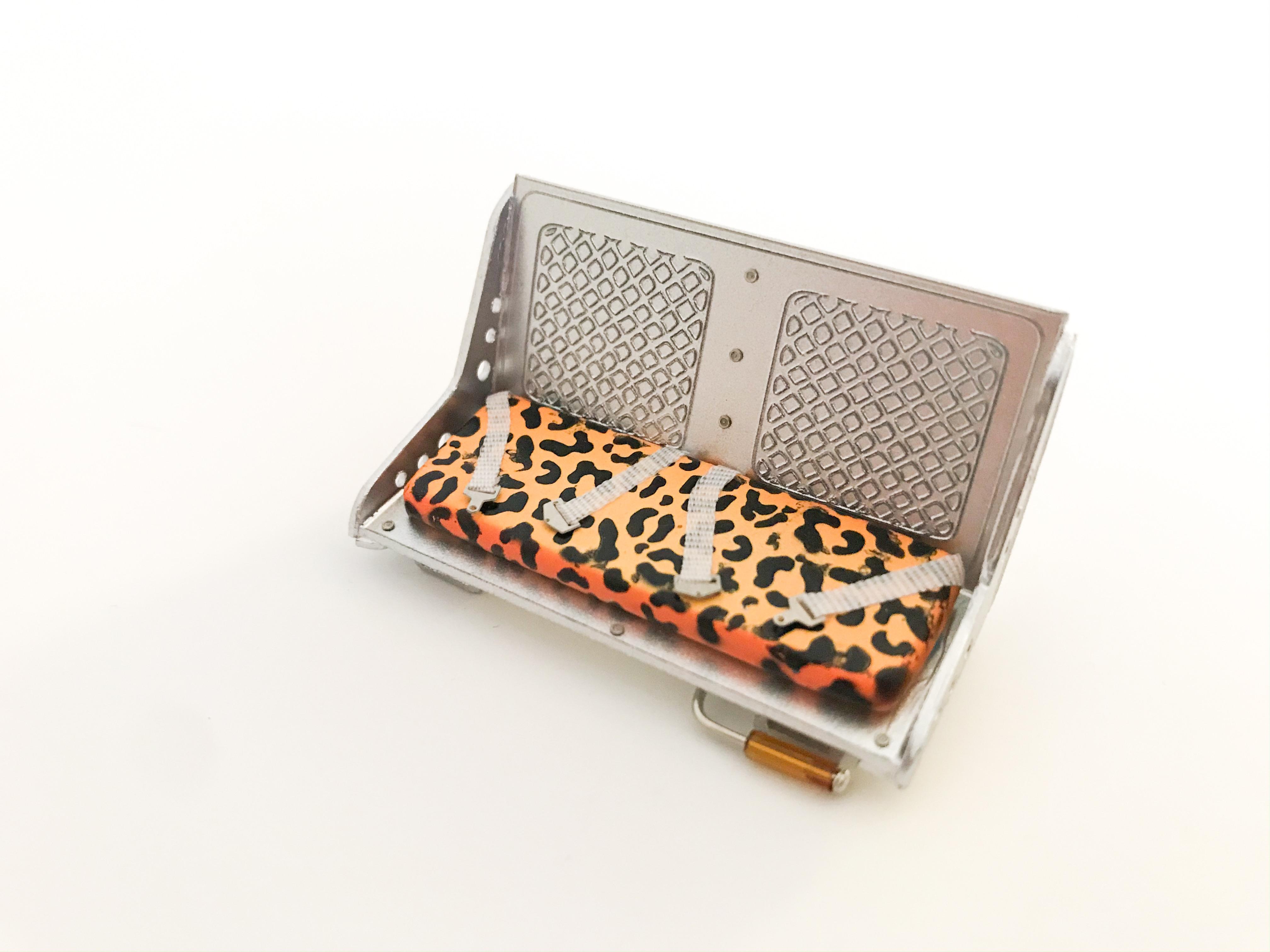

That bomber bench seat was cut on the cutter too - Eric Ritz has done a bunch of MUCH more interesting parts on his (frames, dashes etc) but this was a fun quick project and the cutter did a nice job of that diamond pattern I think!

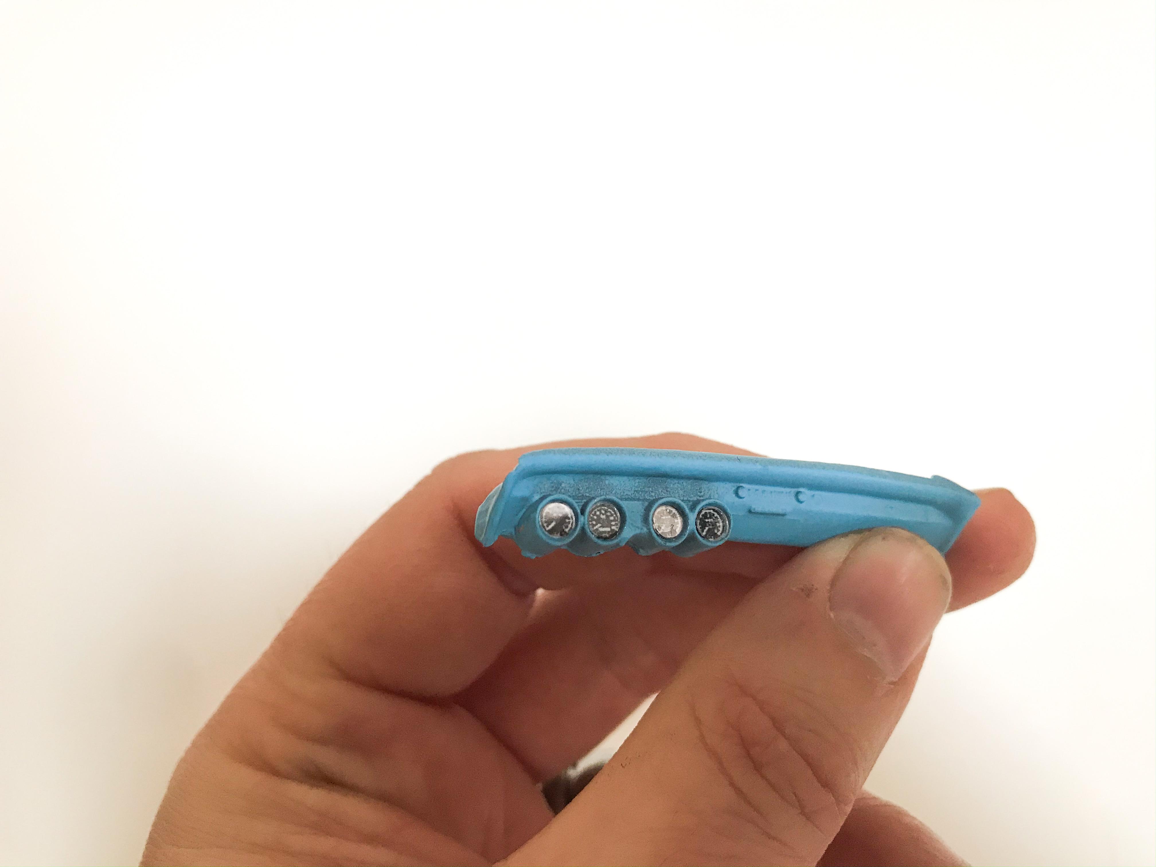

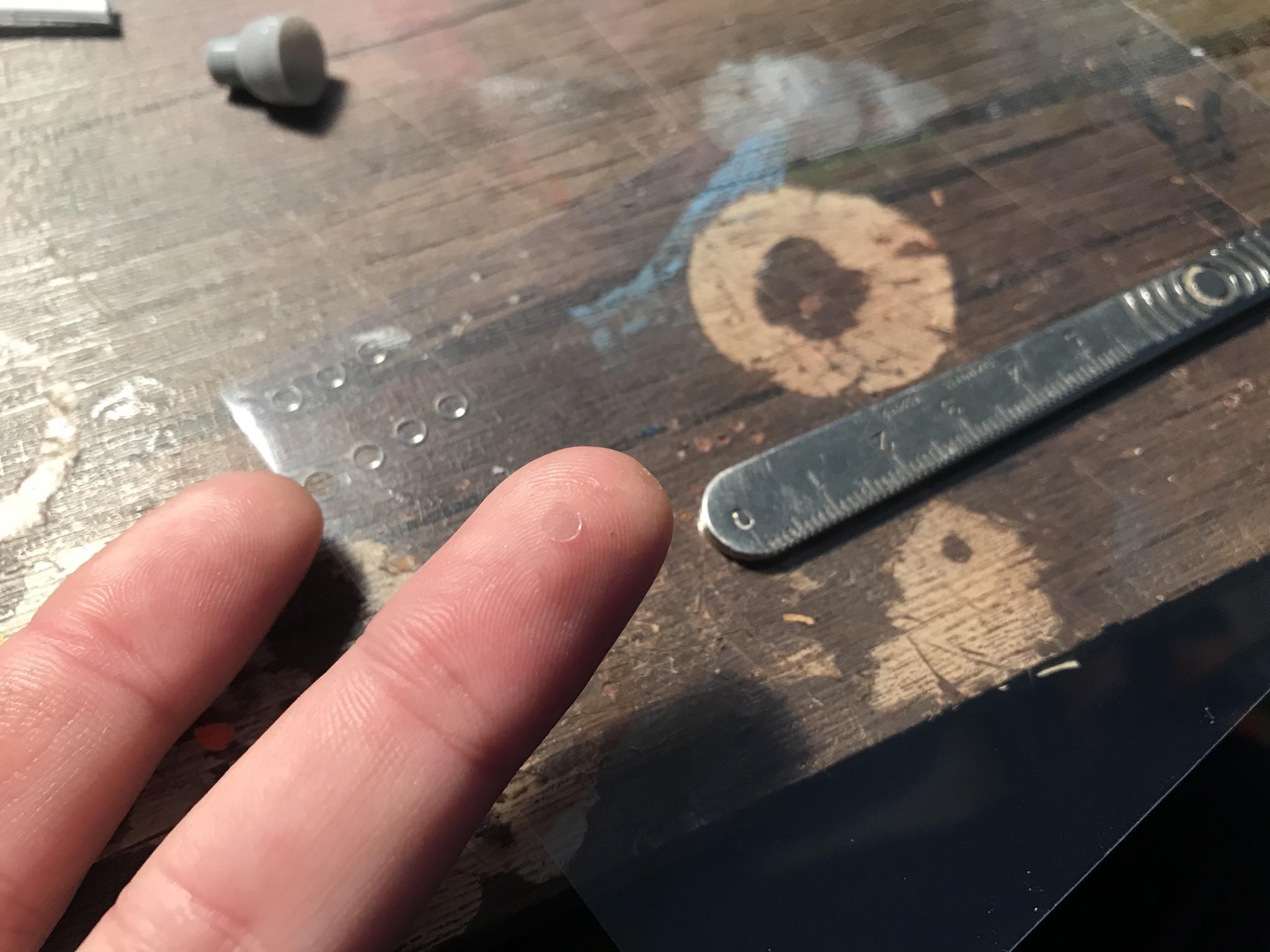

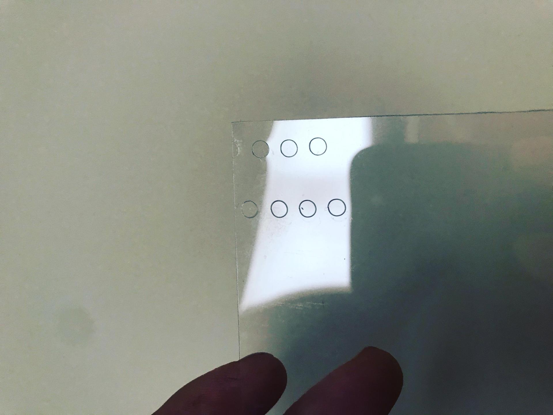

Another thing that you can do with them is cut some thin acetate sheet to make gauge glass (excuse the poor photo - tiny clear parts are hard to photograph!)

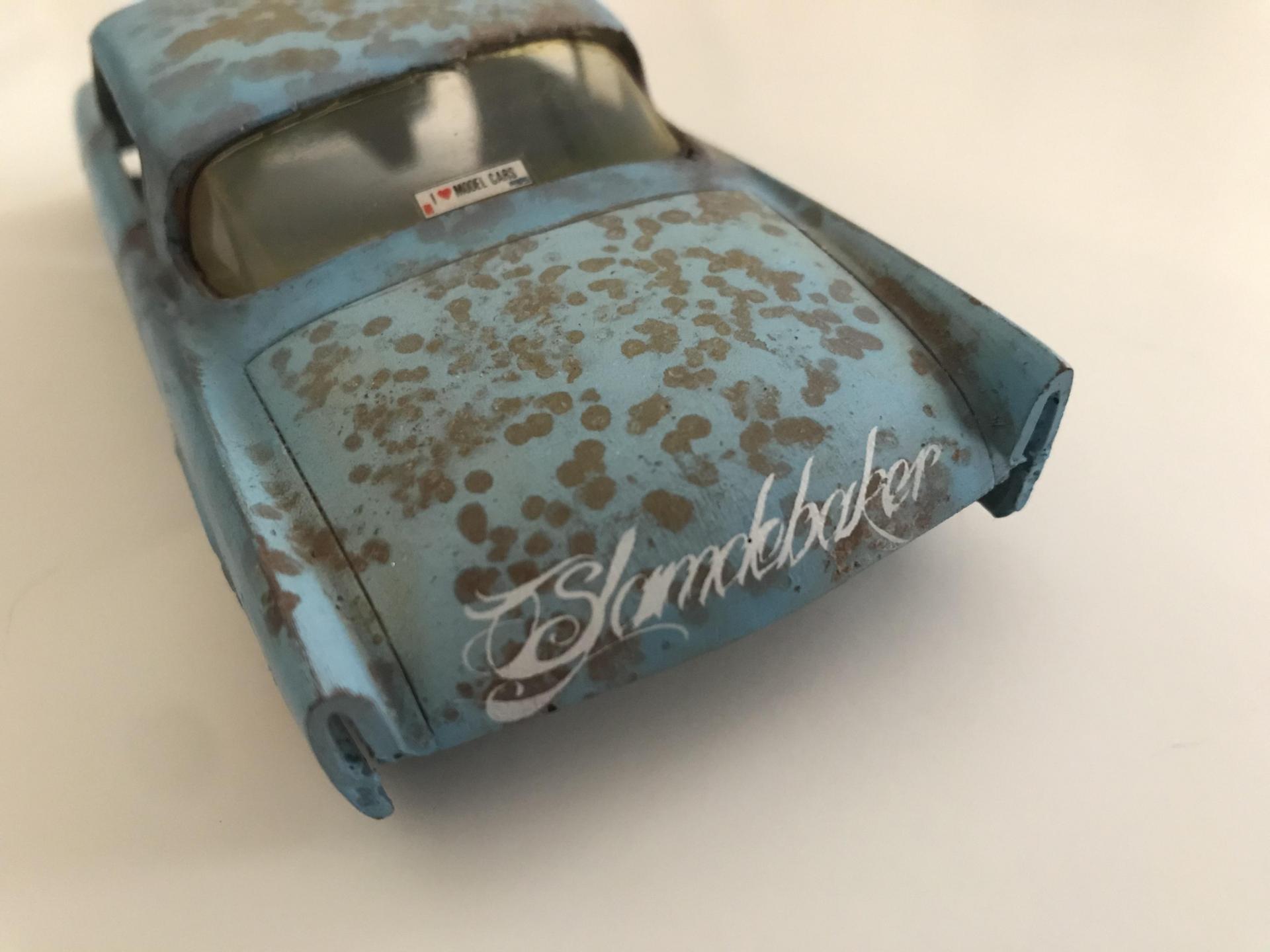

This lettering on the same project was done on the cutter too - just cut a mask and sprayed through it with the airbrush:
