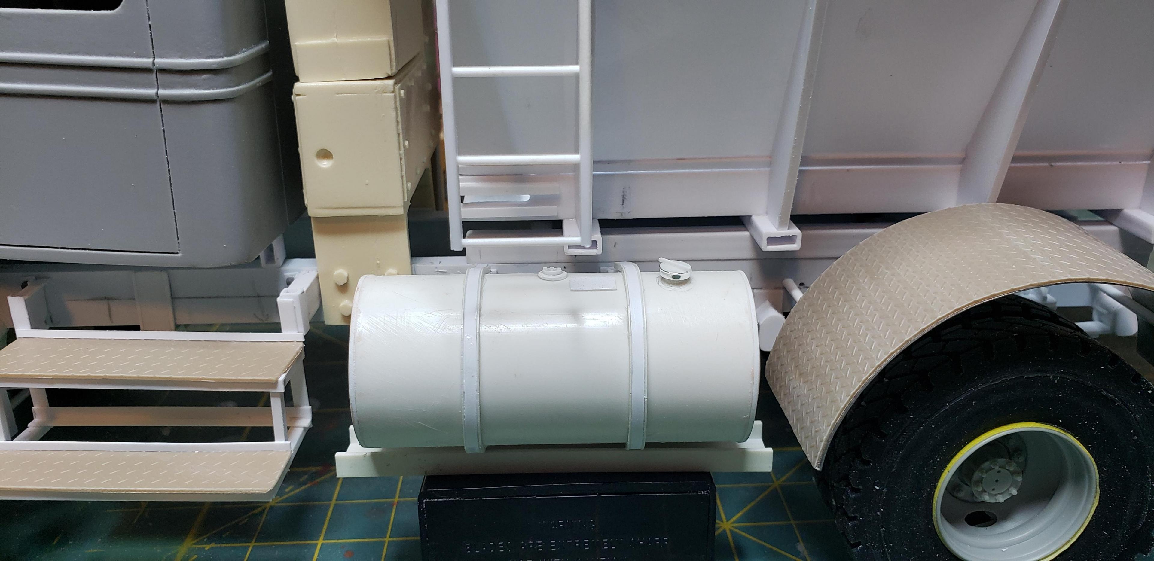

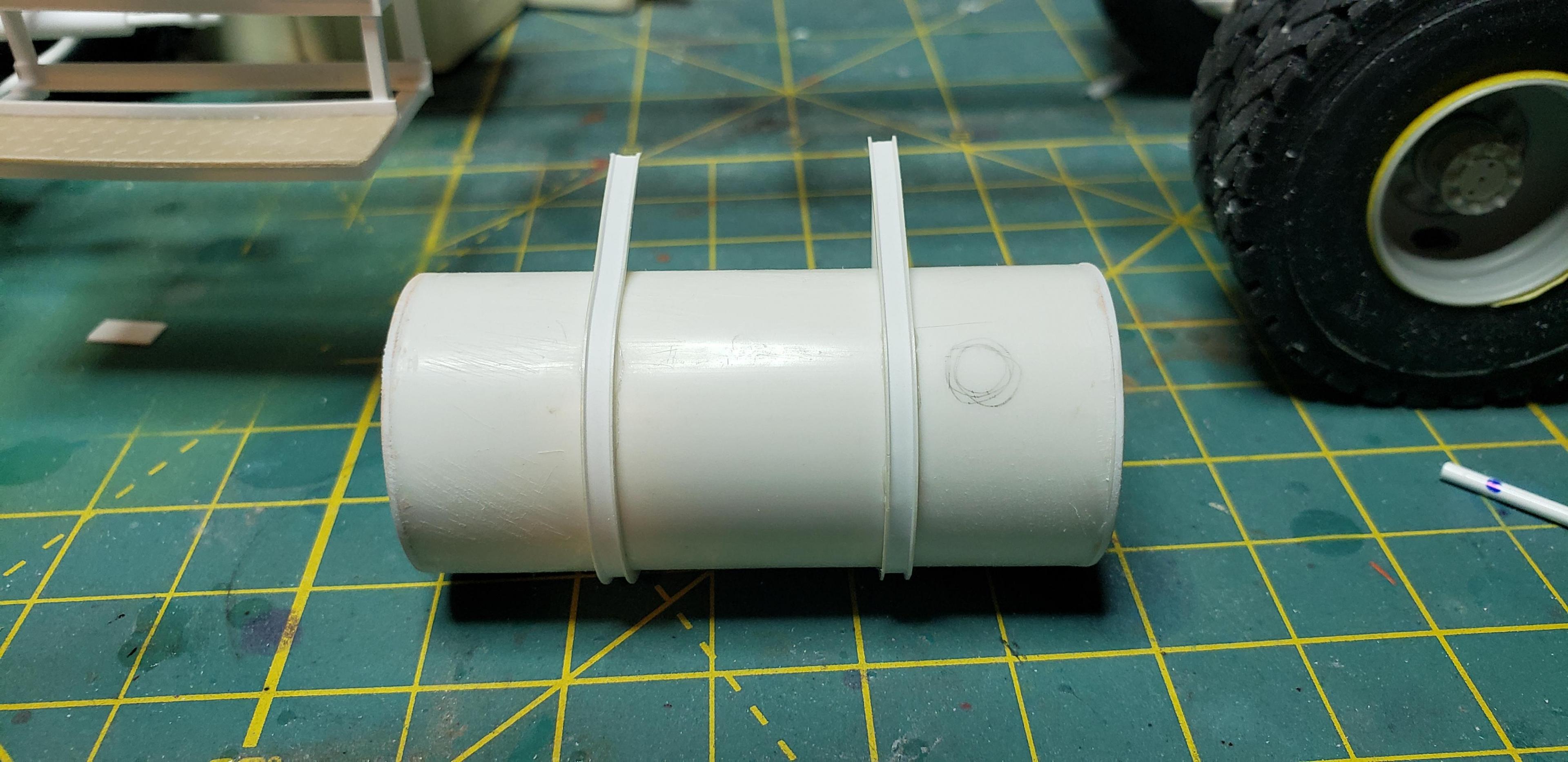

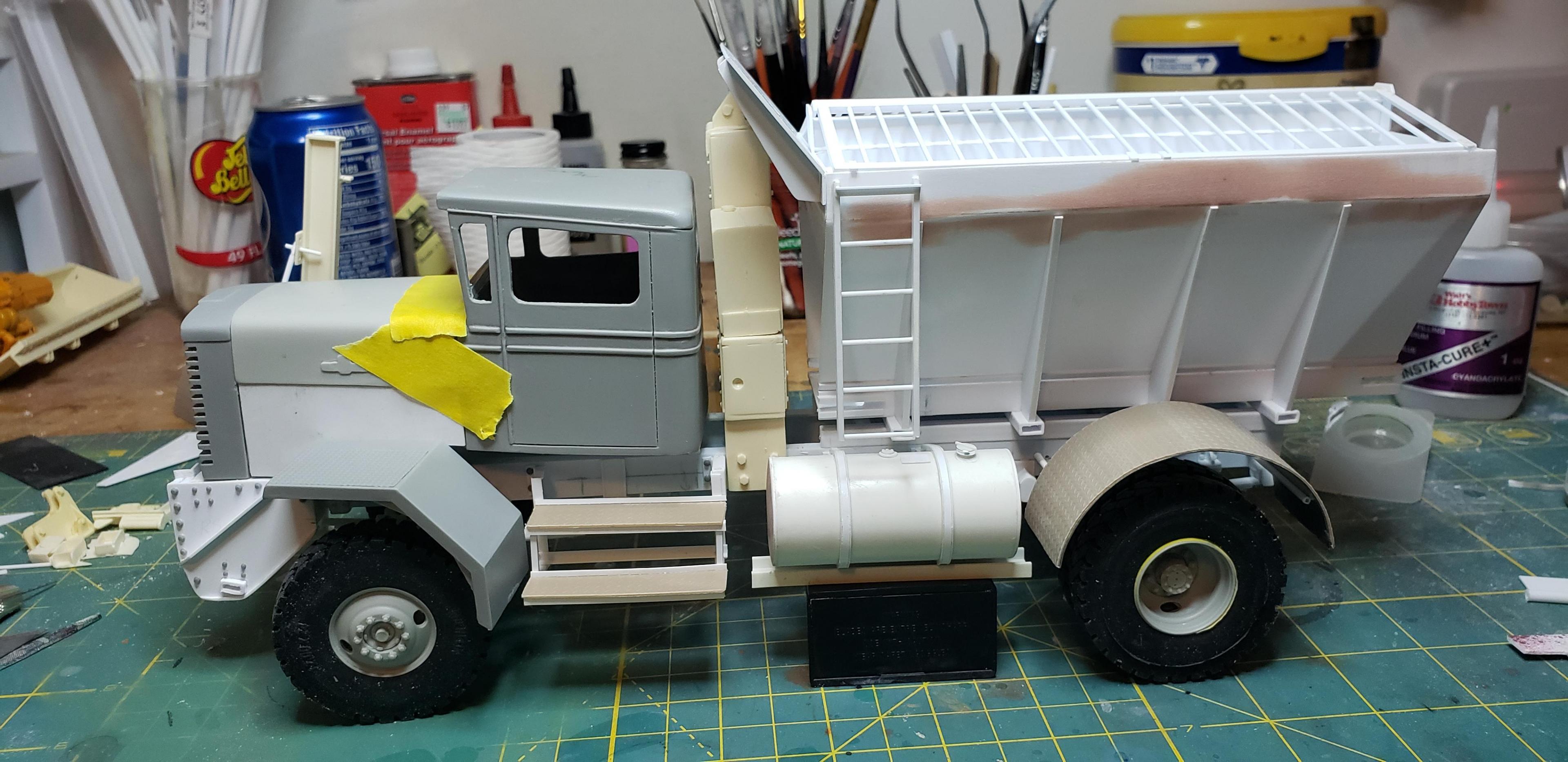

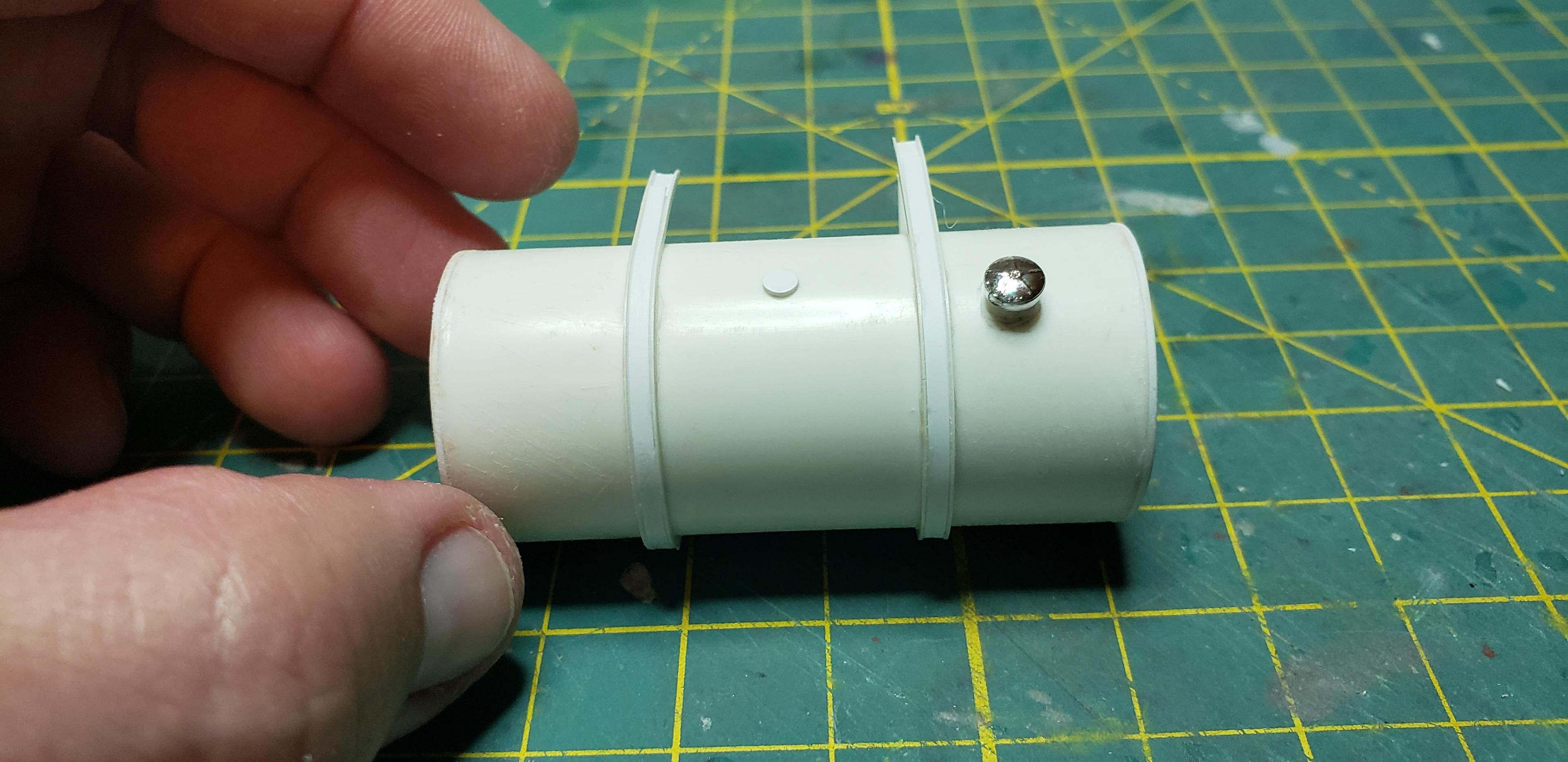

gotnitro? Posted January 16, 2020 Author Posted January 16, 2020 Tossed some plastic together to make a fuel tank and its hardware . Chunk of pvc pipe always works good for smooth tanks ! After a few minutes I mocked everything up to check clearance, seemed okay ! The ladder was from the ALF Eagle..worked out perfect for the sander ladder It's really starting to look like the real truck, several small items to chec off the build sheet..then it's off to primer .
Vince66 Posted January 16, 2020 Posted January 16, 2020 Just need to add yellow tape to the prototype and it'll be a match lol. Seriously looking really good.
gotnitro? Posted January 16, 2020 Author Posted January 16, 2020 2 hours ago, NothingAsFineAsaW9 said: Just need to add yellow tape to the prototype and it'll be a match lol. Seriously looking really good. Thanks ! Mocking up everything frequently really keeps the build exciting for me

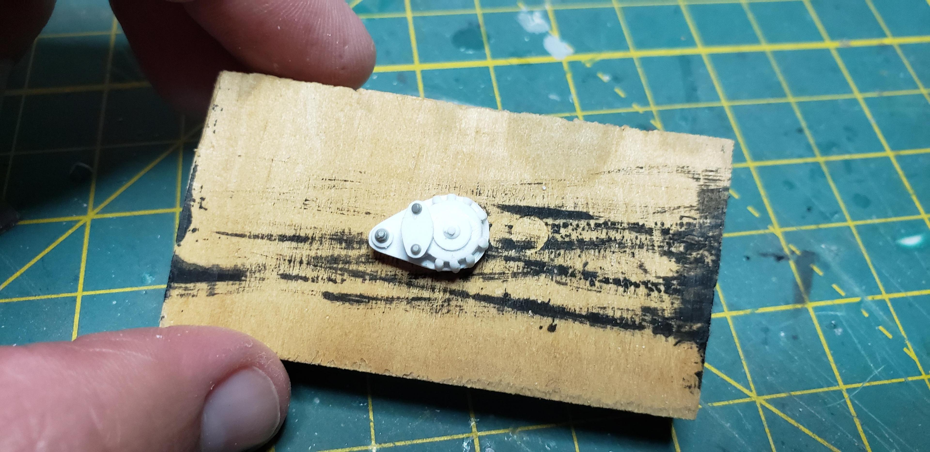

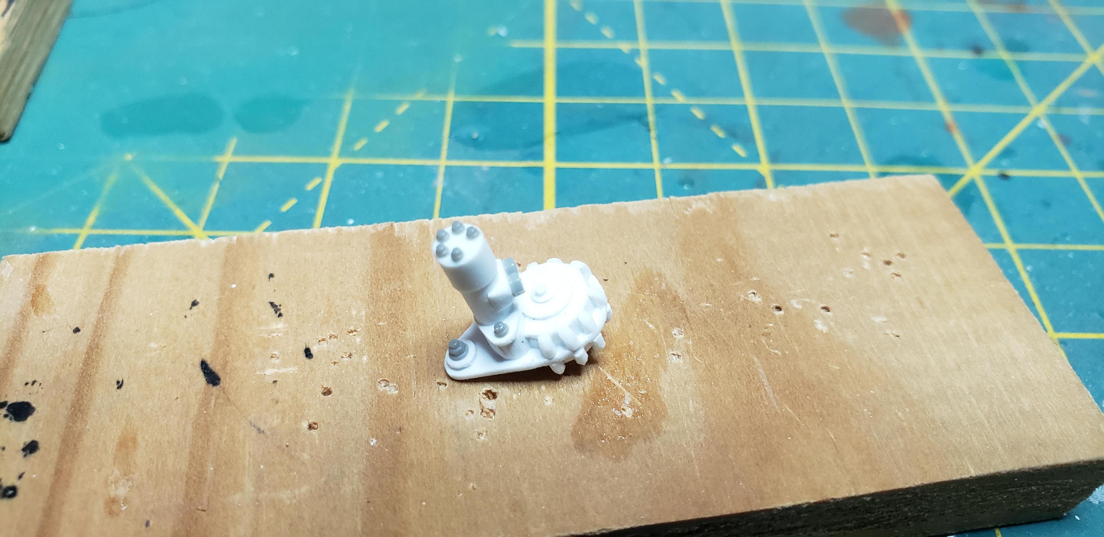

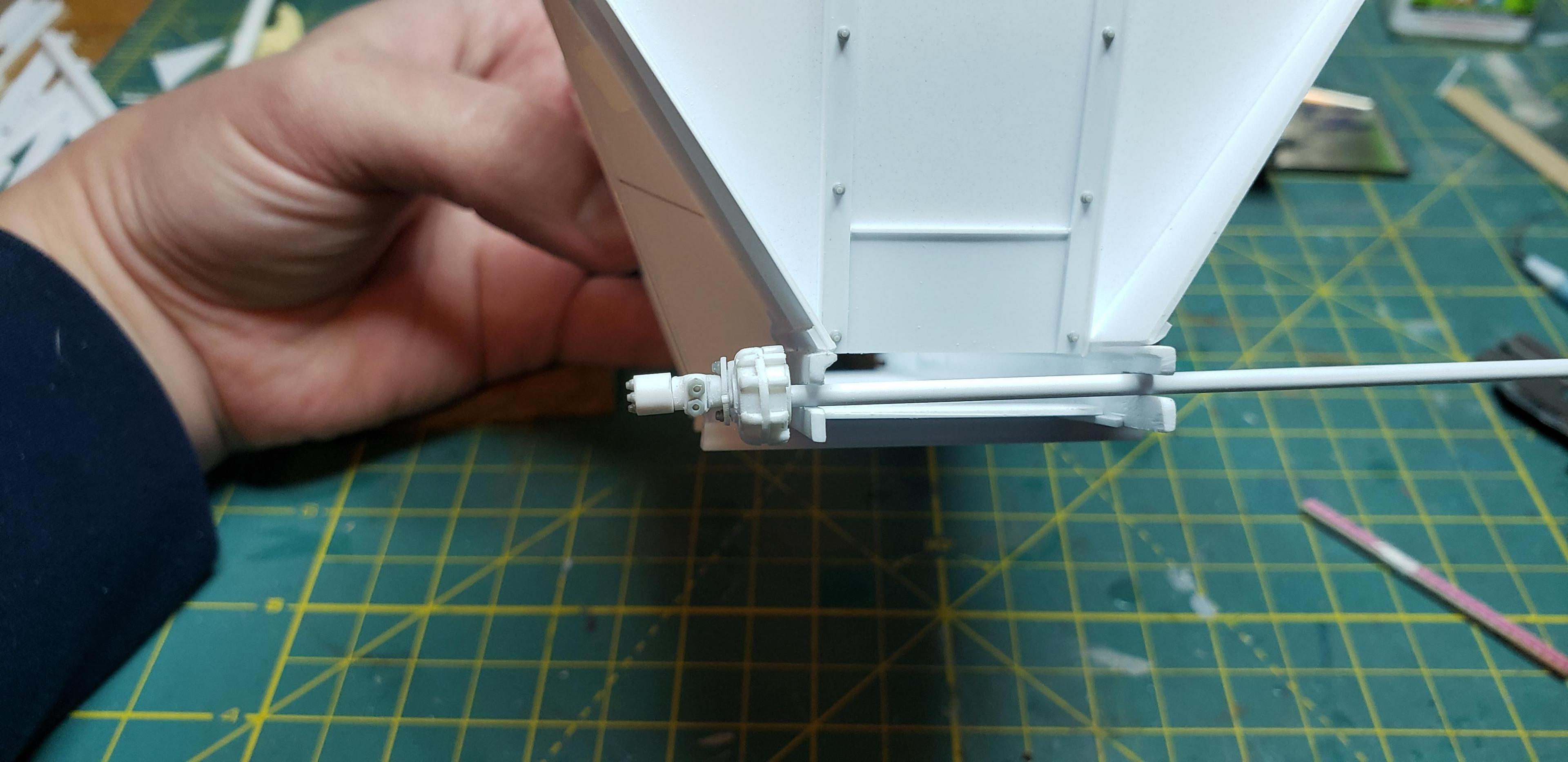

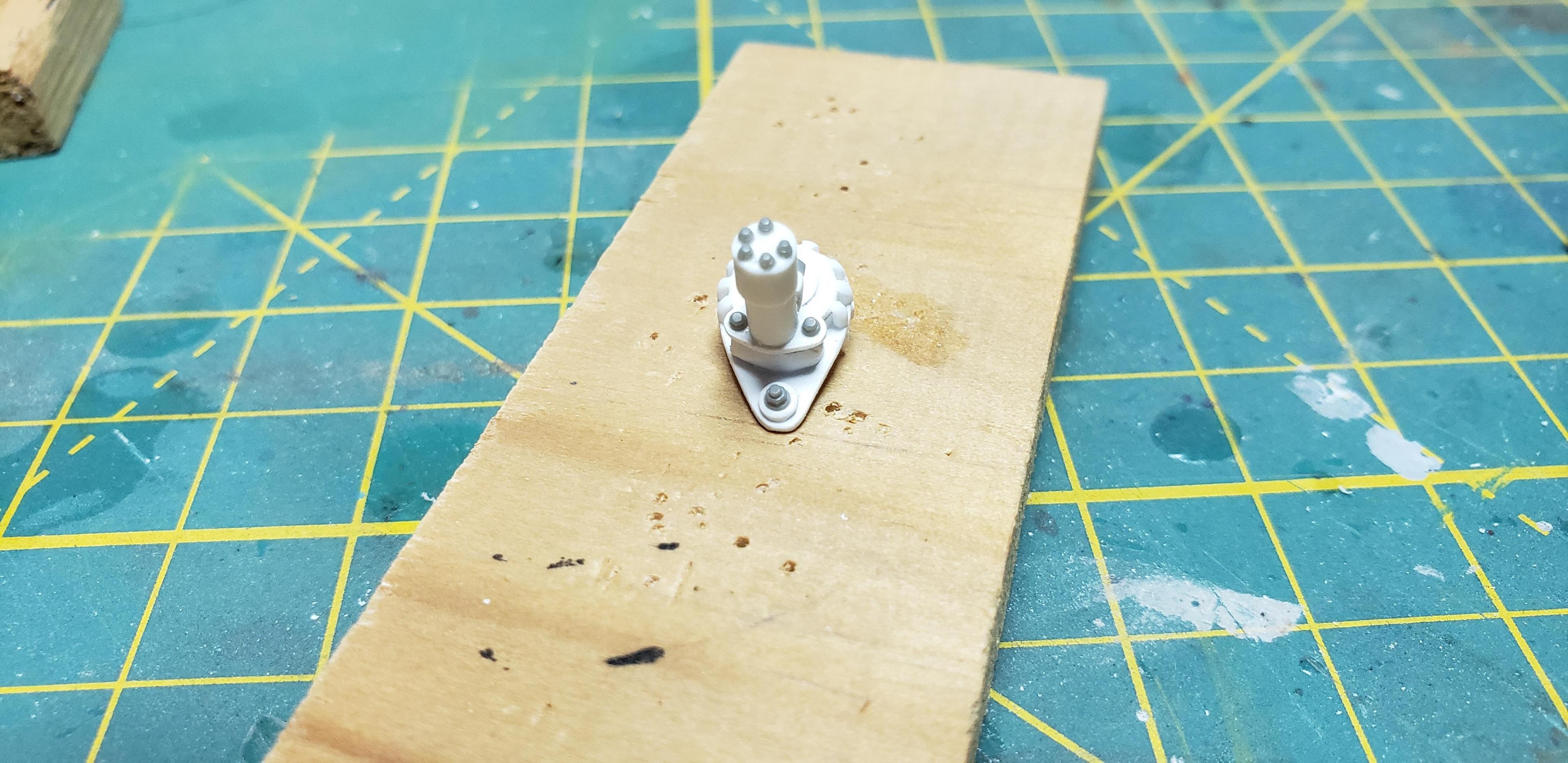

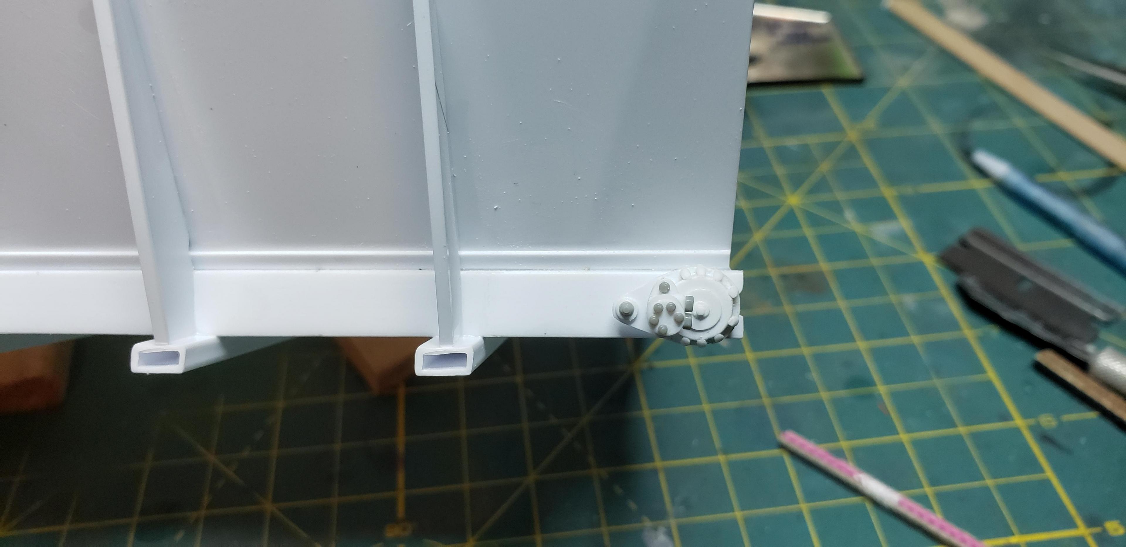

gotnitro? Posted January 19, 2020 Author Posted January 19, 2020 Wknd update ! Small detailed parts ways seem to make a model look real imo..so I spent awhile knocking out the drive motor /gearbox for the conveyor. I'm hoping to use Grante Line chain and sprockets set for the conveyor, this small gearbox should compliment those. I purchased a small punch set years ago, making these small discs easy peasy. Toss on a few meng bolts to wrap it up Next up the chain lift pump !!!
Hermann Kersten Posted January 19, 2020 Posted January 19, 2020 This one comes really good together, the scratch work and details are outstanding. I see you use also the Meng bolts and nuts, i used them many times, they are fun and easy to use for a better detail. Hermann.

gotnitro? Posted January 19, 2020 Author Posted January 19, 2020 12 hours ago, NothingAsFineAsaW9 said: Now that's just Cool. Thanks! 2 hours ago, Tesla said: Meng bolts certainly make details stand out. They're excellent for parts like this where ya need details to stand out . I've used common hex rod too when needed 10 hours ago, Hermann Kersten said: This one comes really good together, the scratch work and details are outstanding. I see you use also the Meng bolts and nuts, i used them many times, they are fun and easy to use for a better detail. Hermann. Thanks, luckily I took several photos of the gearbox . I really like the meng bolts for details. Hex rod works too, but I'm very inconsistent w thickness when cutting em .

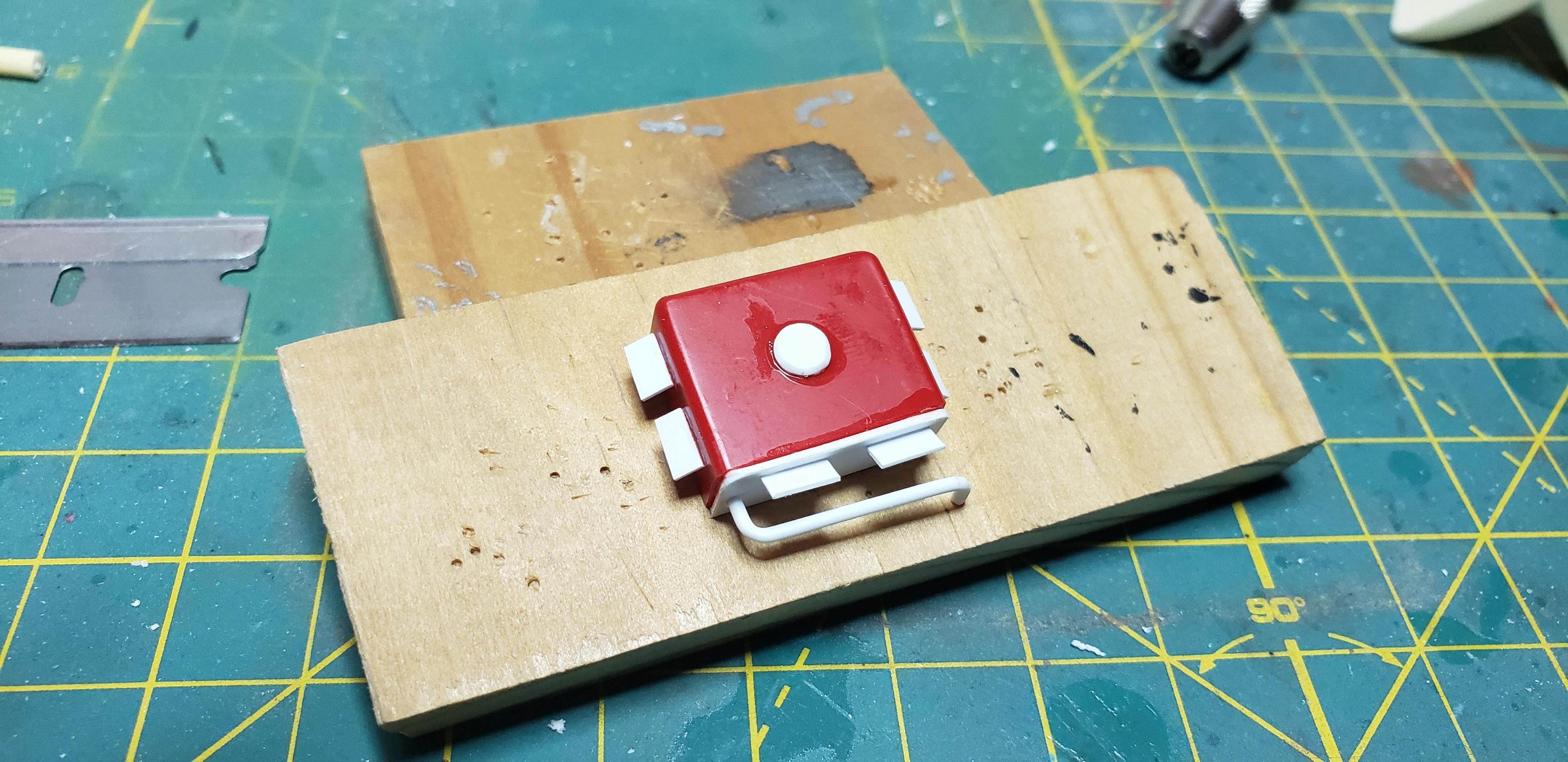

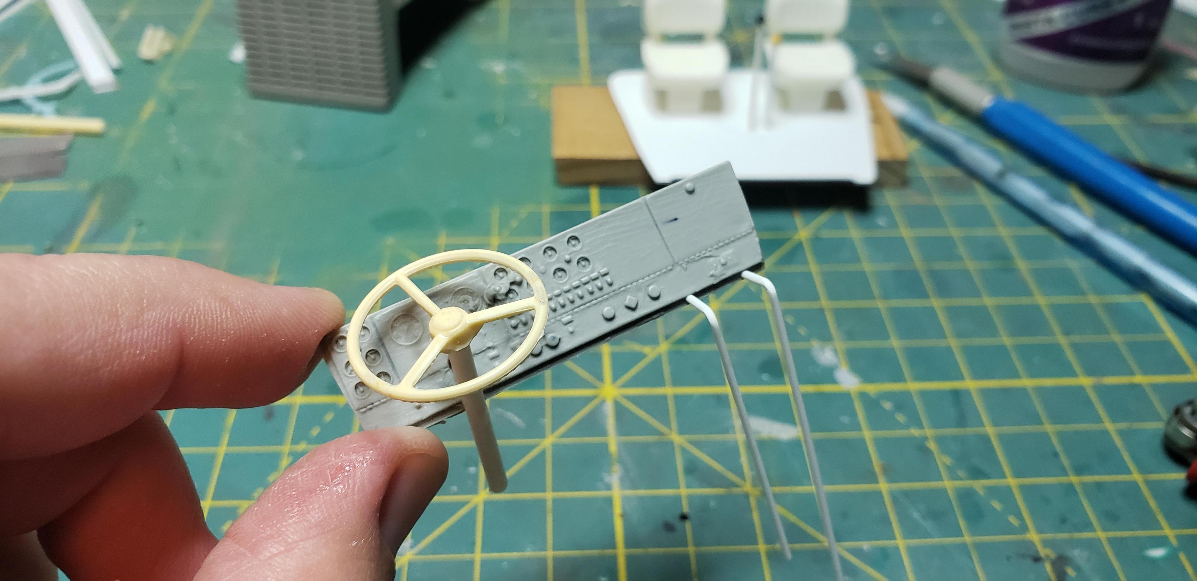

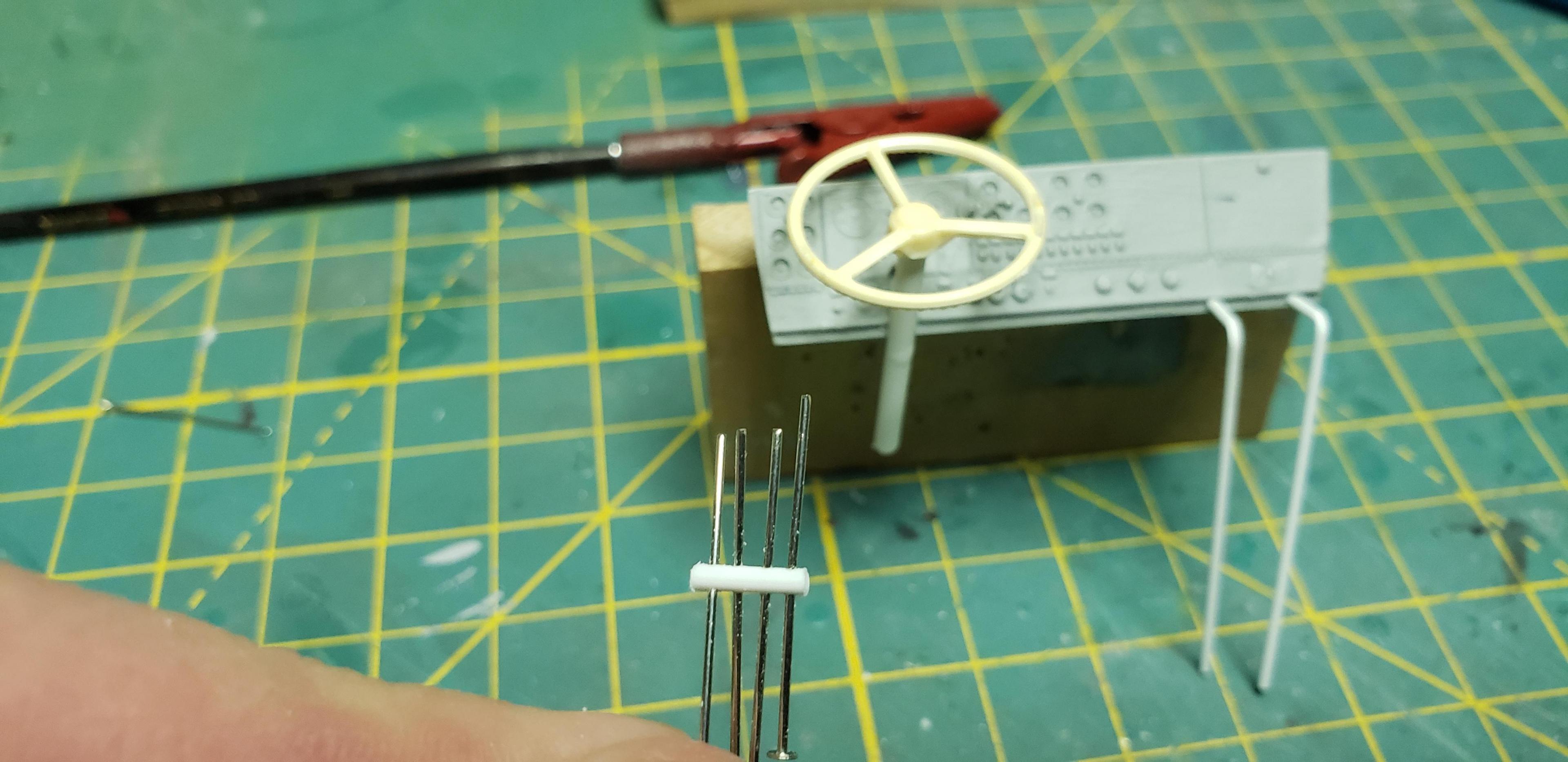

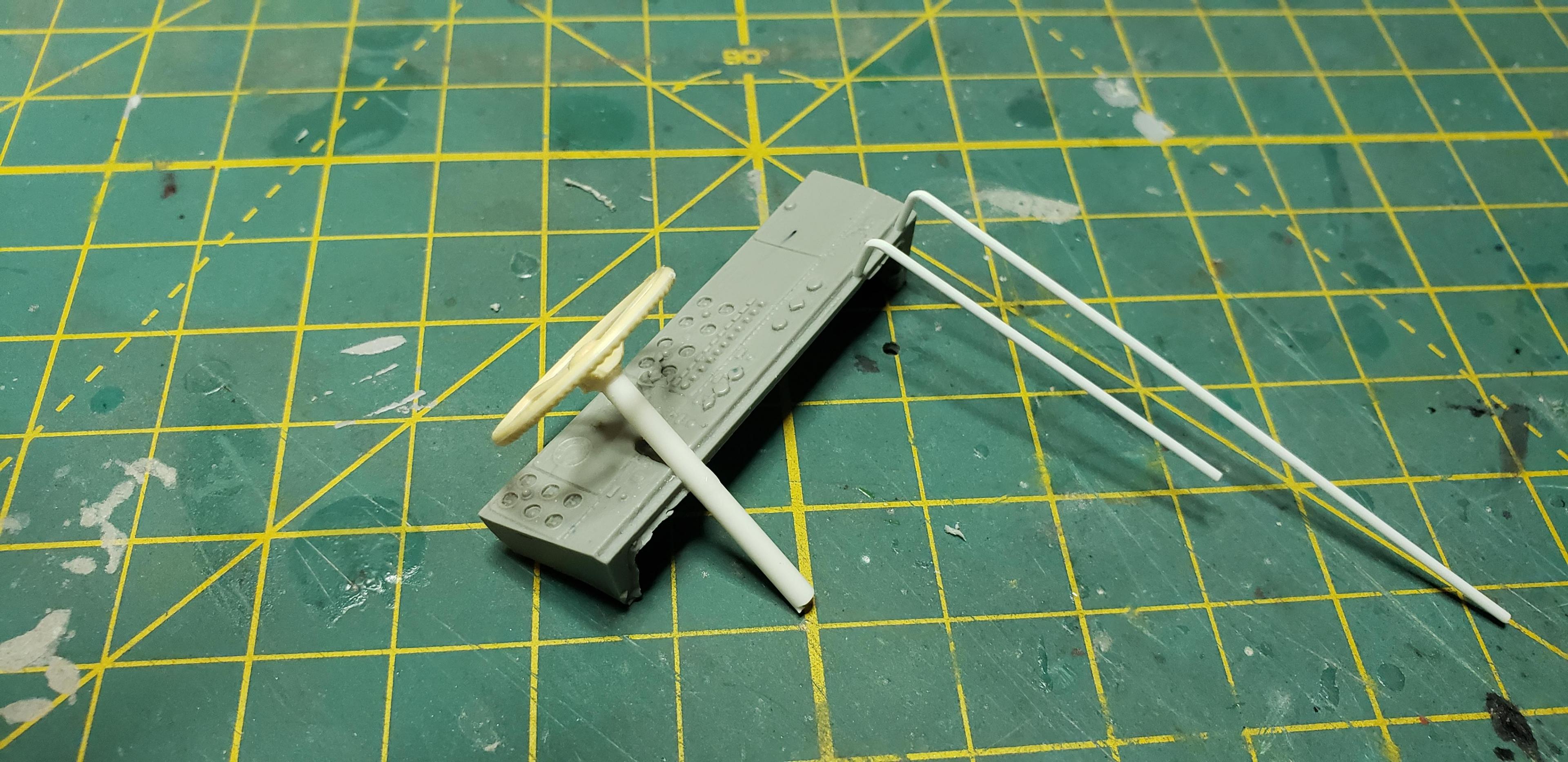

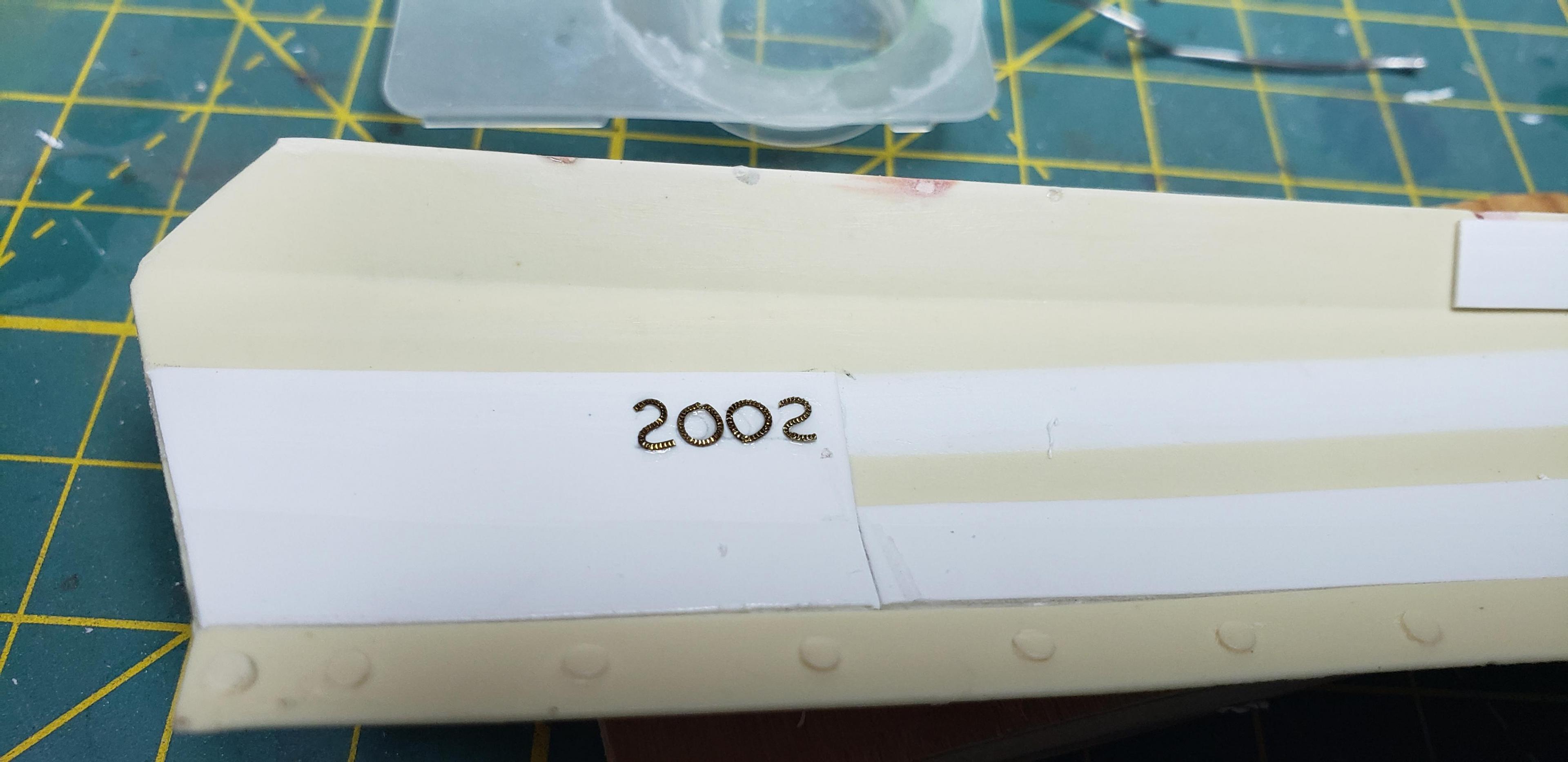

gotnitro? Posted January 26, 2020 Author Posted January 26, 2020 I screwed around with the interior today while we were getting hammered w rain and slush. We've had such a strange winter here in CNY , several feet below average. Digging thru random parts bins turned up a few suitable seats , not exactly like the real one..but the driver / wing man gotta be comfy! Also being an older steel truck, figured they would need something to keep em warm while busting snow.. found this red box inside a dm800 parts truck..hmm..add louvers and pipe it should look okay . The circle in middle was spotted on photos The wing man seat needed hand controls, photos showed bars attached to the dash going down into the floor, w the controls in the middle..first add the bars .. Then patiently drill out a valve to hold the hand controls..I used small diameter tube and brass pins for handles. Later epoxy will make the knobs While I was working on the wing stuff I decided to try recreating the weld date on patch. Using the smaller welds in the ctm set , I shaped the numbers w tweezers and pliers..very impressed how flexible the etch is . Holding them w blade , then slowly touching the edges w super glue capillary action sucked the glue under the welds thanks for following
