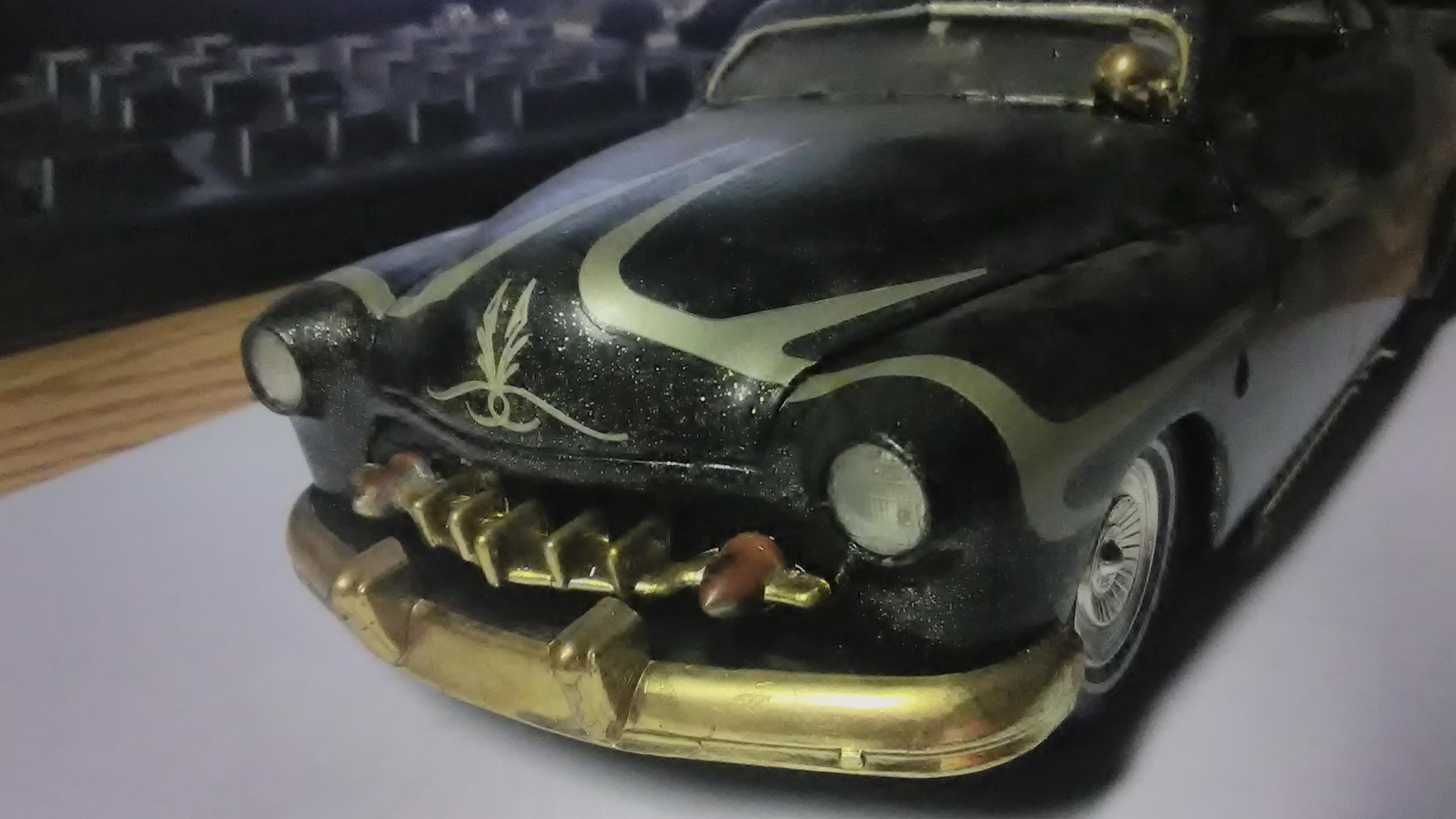

Sledsel Posted December 23, 2019 Author Posted December 23, 2019 2 hours ago, 64Comet404 said: I've clear coated over chrome using Tamiya clear spray, and I have yet to see any yellowing. I have seen yellowing with the older Testor's and Humbrol enamel clears, but the modern lacquers and acrylic clears are much more forgiving. Great to know. Yes, I clear coated the chrome on a '49 Mercury and it yellowed on me. Granted, this kit was done 30+ years ago. Can the acrylic be painted over enamel? I have a kit I cannot find the orange I want in lacquer but will need cleared. The other color is white.
