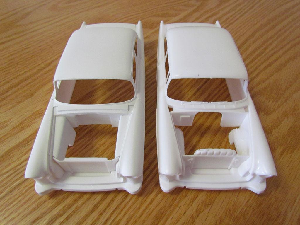

I started building a model of his car using an AMT 55 Chevy.  I used the rear tubbed section from an AMT 1970 Super Bee Pro Street kit that I attached to the 55's chassis.  The 1:1 Cheez Whiz 55 actually has a 69 Camaro front chassis but it would be near impossible to remove the 55's frame rails from it's floor so this is the compromise.
I re-shaped the hood and filled in the vents in the cowl under the windshield as well as removed the wipers and vent windows in the doors.  I also added the half round molding under the side windows using Evergreen 1 mm half round rod.  I angled the ends of the radiator support and cut the top of the radiator so it's level with the support.

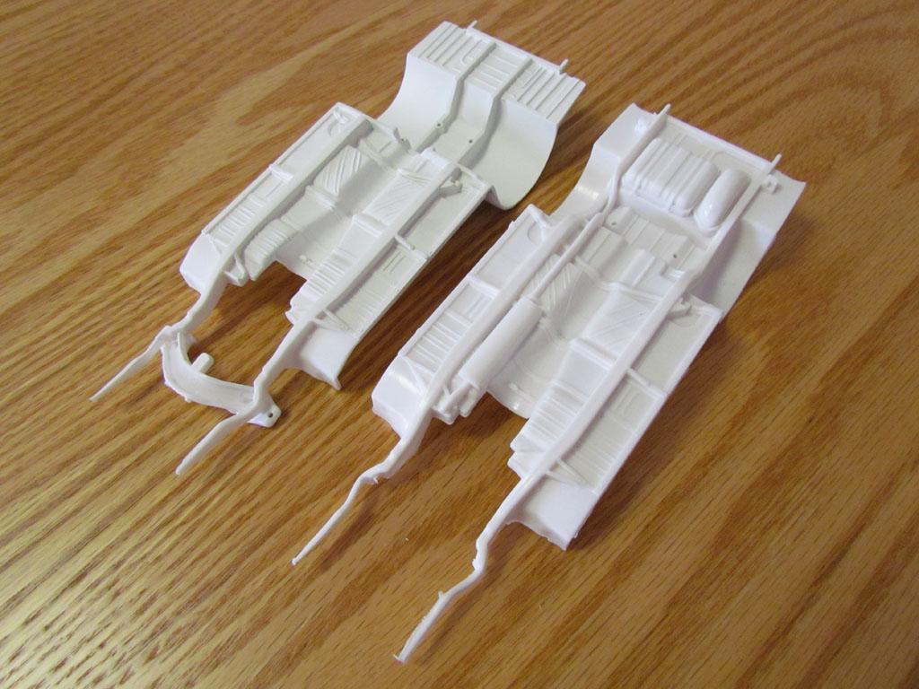

I covered the engine compartment inner wheel wells to make them resemble Scott's car and removed the molded in exhaust from the 55's chassis.
I took some pictures of the modified body next to a stock body and chassis(modified on left, stock on right).

This is going to be a fun build. The Revell '69 Z-28 Camaro kit is being sold cheep at Hobby Lobby especially with the 40 % off coupon and Michael's is doing the same. I'd consider buying one of those kits and just cut off the front sub frame and add it to the '55 Chevy frame much like the 1:1.
Thanks guys!
David - I thought about putting a 69 Camaro front subframe on the 55's floor.  Cutting the Camaro's front subframe from it's floor will be the easy part since it doesn't matter what happens to the floor.  However removing the 55's frame rails from it's floor and filling all those areas in will be a nightmare.  I removed the exhaust and it was a big job.  I had to back fill the area under the muffler and then cut off the exhaust and carve out all the floor's details.  Some of the raised details where the exhaust was had to be added back.  The frame rails take up a lot more real estate on the floor pan.  I don't know if it's worth all that time.  The 55's front part of the chassis lines up nicely and it has an adjustable ride height.  There are 3 holes for the front spindles.  I used the top spindle holes and it sits perfectly in front.  The 70 Super Bee's tubbed rear chassis isn't exactly 100% correct to the 1:1 Cheez Wiz 55 but it also worked out great.  The rear end is a 9 inch like the 1:1 Cheez Whiz 55 and it sits at the correct height.  I didn't have to make any adjustments.  It worked perfectly.  I even cut the chassis rail from the rear of the 55's floor that the rear bumper attaches to and glued it on the ends of the Super Bee's(tubbed rear section) frame rails and it lined up perfectly.  I'll think about it some more but I'll most likely use the chassis I modified.

I was looking at the 1:1's chassis and I think I'll extend the tubbed section rails forward a bit onto the 55's floor and angle the 55's frame rails in to meet them.  This way it'll sort of resemble the 1:1's chassis and I can run the exhaust through the frame's angled areas.  I'll work on this in a couple of days.

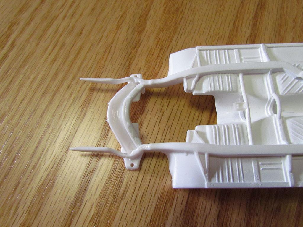

I started working on angling the 55's chassis rails in to meet up with the tubbed section frame rails.  I'll post some progress pictures soon.

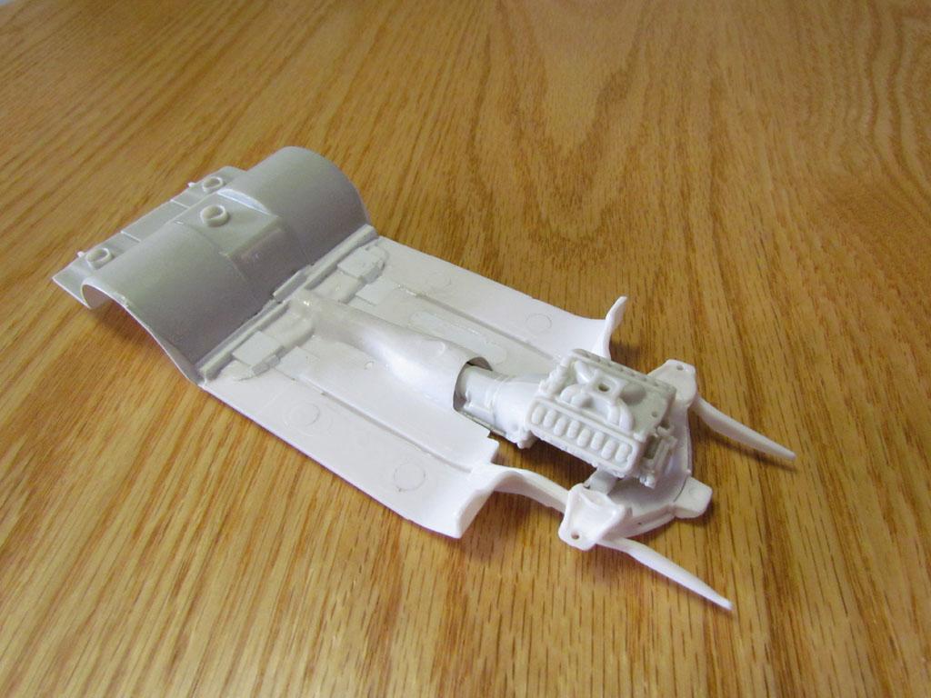

I got some more work done on the chassis.  I didn't want to totally rebuild the chassis.  Removing the molded on exhaust and parts of the chassis rails was tedious and needed to be filled in and re-shaped.  As the chassis is now with the 55 front suspension and the tubbed rear it sits at the correct height.
I cut off the backs of the 55 chassis rails and angled them in to meet with the extensions I added to the tubbed area.  I think now it more closely resembles the Cheez Whiz 55 and looks more realistic than in my earlier pictures when I first attached the tubbed area.  I also added some round tubes in the angled chassis rails for the exhaust to go through.
I'm using the engine from the AMT 57 Bel Air Street Machine kit.  I cut off the rear of the engine cross member from the 57's chassis that has the mounts for the engine and attached it to the 55 chassis' cross member.  I added the plate where the back of the transmission attaches to a cross member I made with 1.6 mm rod.
I'm not sure what transmission it's supposed to represent that's on the 57's engine.  I have a resin Turbo 400 I might use instead.  I bought the issues of Hot Rod magazine, December 1988 and January 1989, that the Cheeze Whiz 55 appears in.  It should tell what transmission is in the car.  I should have them in a few days.
