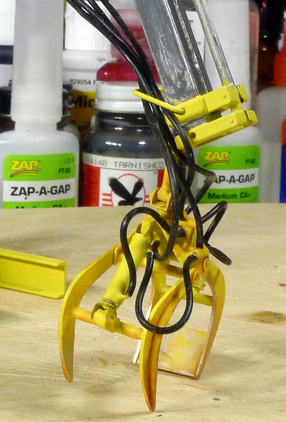

Warren D Posted March 17, 2020 Author Posted March 17, 2020 Final update. The grapple is almost done, need to attach it to the crane, add a little weathering and mount the crane and it's done. Not sure how some of you scratch build these small devices, it was very frustrating.
gotnitro? Posted March 17, 2020 Posted March 17, 2020 Your grapple looks fantastic! It will definitely add another dimension to your build
Tesla Posted March 17, 2020 Posted March 17, 2020 WOW! That grapple came out excellent! Job well done Warren ?
Warren D Posted March 18, 2020 Author Posted March 18, 2020 A few more pics of the grapple now mounted to the crane. It pivots, rotates, jaws work and moves like the real one.
Warren D Posted March 18, 2020 Author Posted March 18, 2020 Calling this one done. Thanks to all for the kind words of encouragement during the build!
