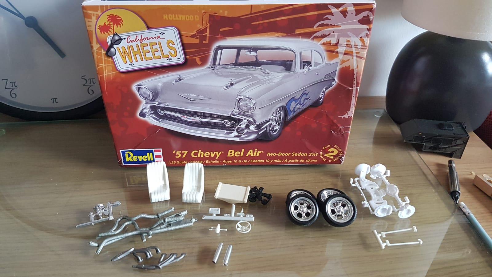

This has sat on the shelf for way too long as a lot of life stuff has got in the way. Now I'm off work due to the C-19 its time to get this sucka rollin'.

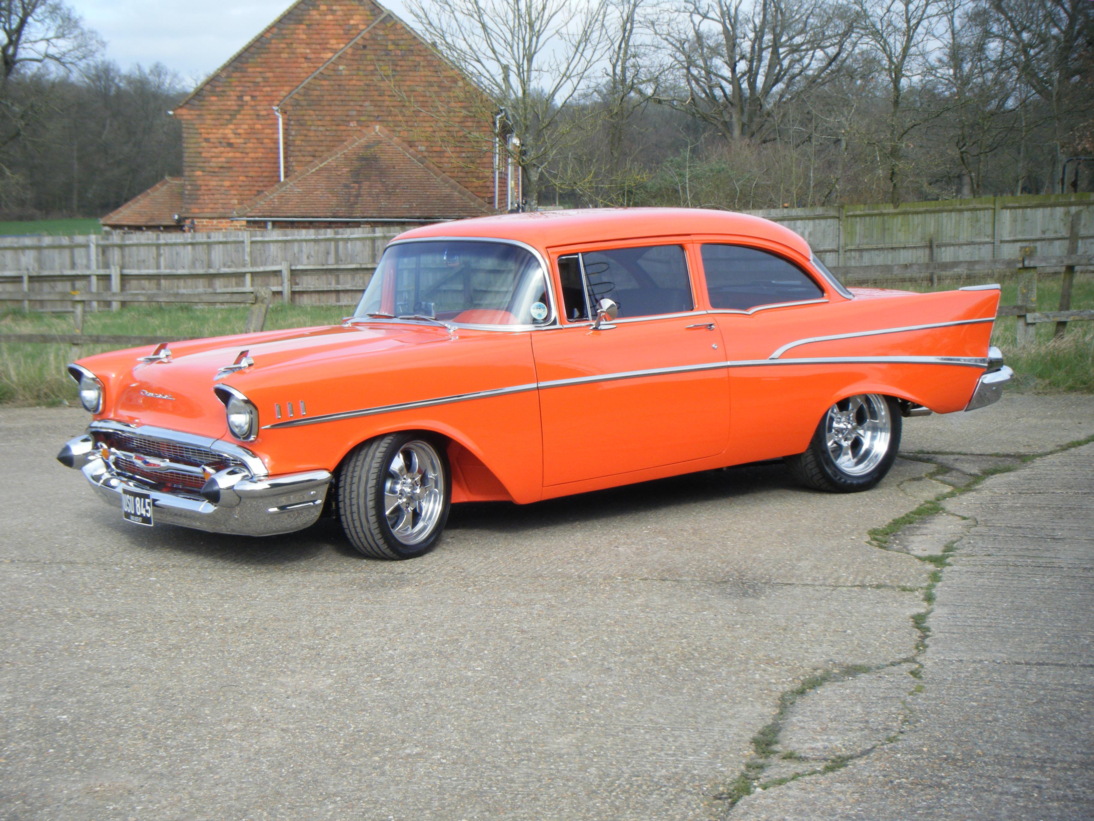

This will be the 1:25 of my 1:1 57 Chevy, known by many in the UK as FTO (F$$$ Thats Orange). As its been on the street 9 years this build is way overdue.
I have a 210 so the bel air kit along with dash and rear 1/4 spears from the black widow 150 and some sanding will provide the start point. Revell was good enough to also include lowered suspension with big F & R brakes, so pretty covered too. Few minor parts like slapper bars to add.

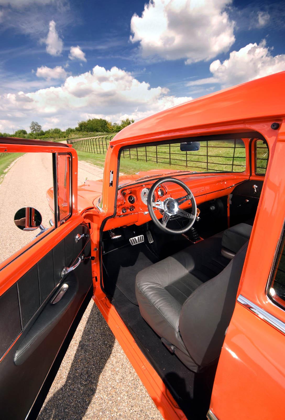

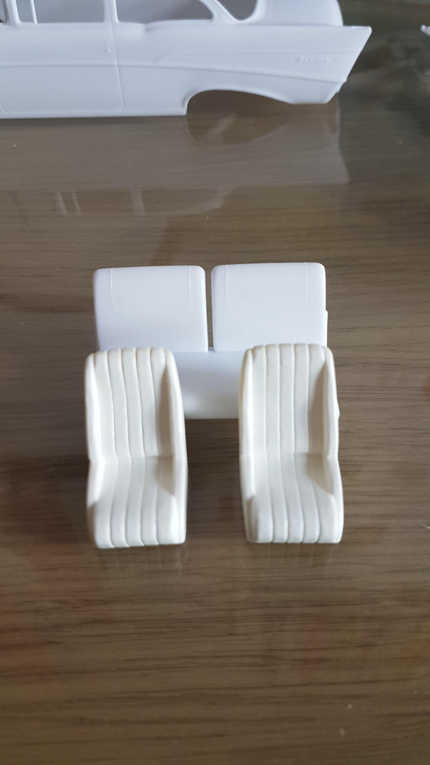

Interior needs modding (anybody have a pic of ths Revell 56 sedan int door panels ?) as my car has 56 int door pulls along with a radio & clock delete dash (150's perfect) and a Glide Engineering custom front bench seat. Bench base but 2 reclinable seperate backs with a centre armrest, hmmmmm ? 2 seat backs from spares box may work.

First let me say that is a beautiful looking '57. You mentioned that you have interior door cards from a '56 in your car. The Revell '56 Chevrolet kit has an interior very close to what the pictures of your interior look like. That kit has the interior called Del Ray that was an upgrade option to the standard 210 interior. The interior side panels may even interchange with your '57 kit. The front ride height can be easily change with moving the front wheel mounting point higher up on the front spindles if need be.
Thanks for ya comment Espo.
My 57 door cars were custom and I used 56 armrest / door pulls with the straight 56 int chrome trims. I wanted a kinda stock but not look.
I will more than likely use the 57 kit interior as most wont be seem once finished.
