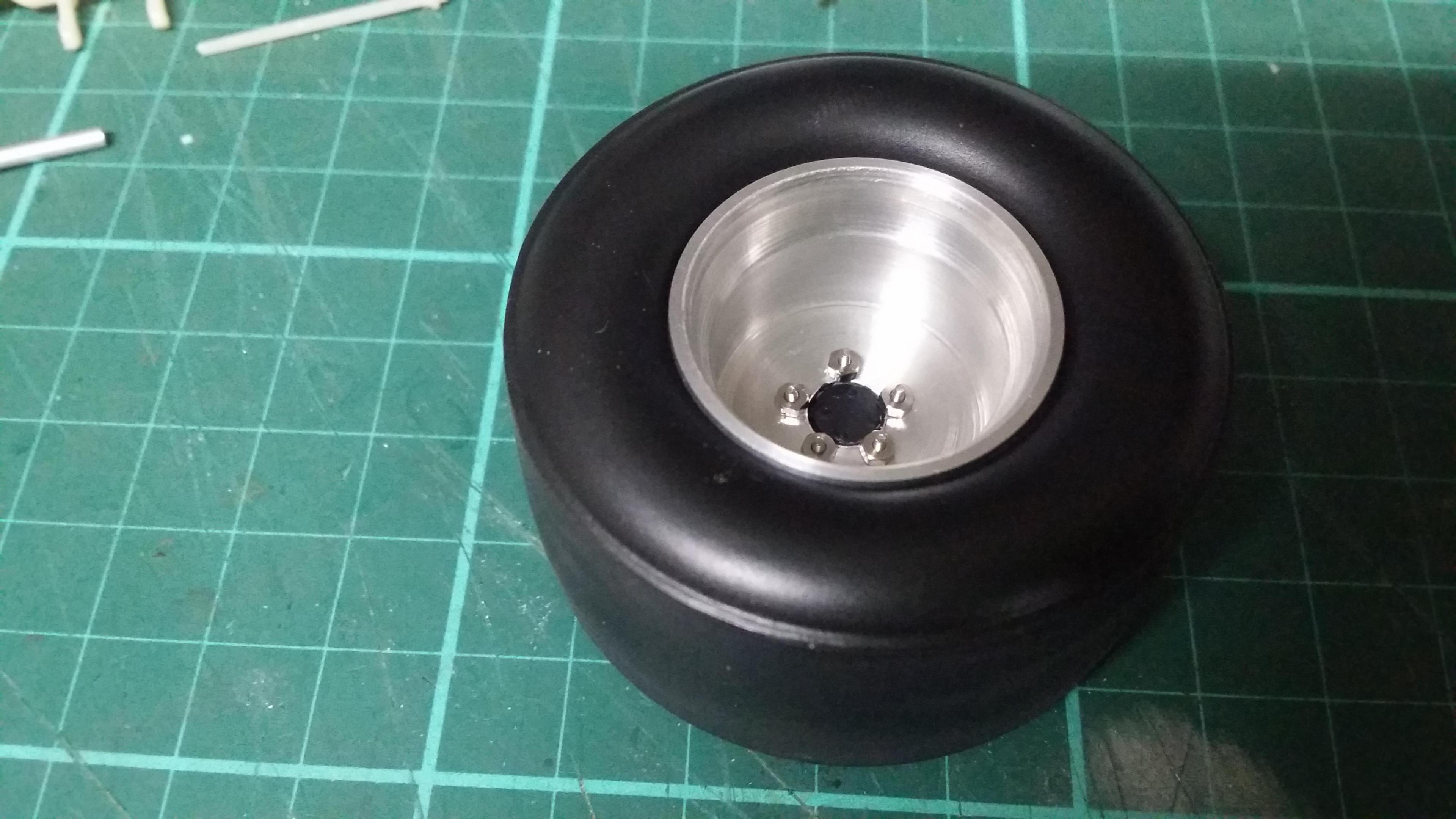

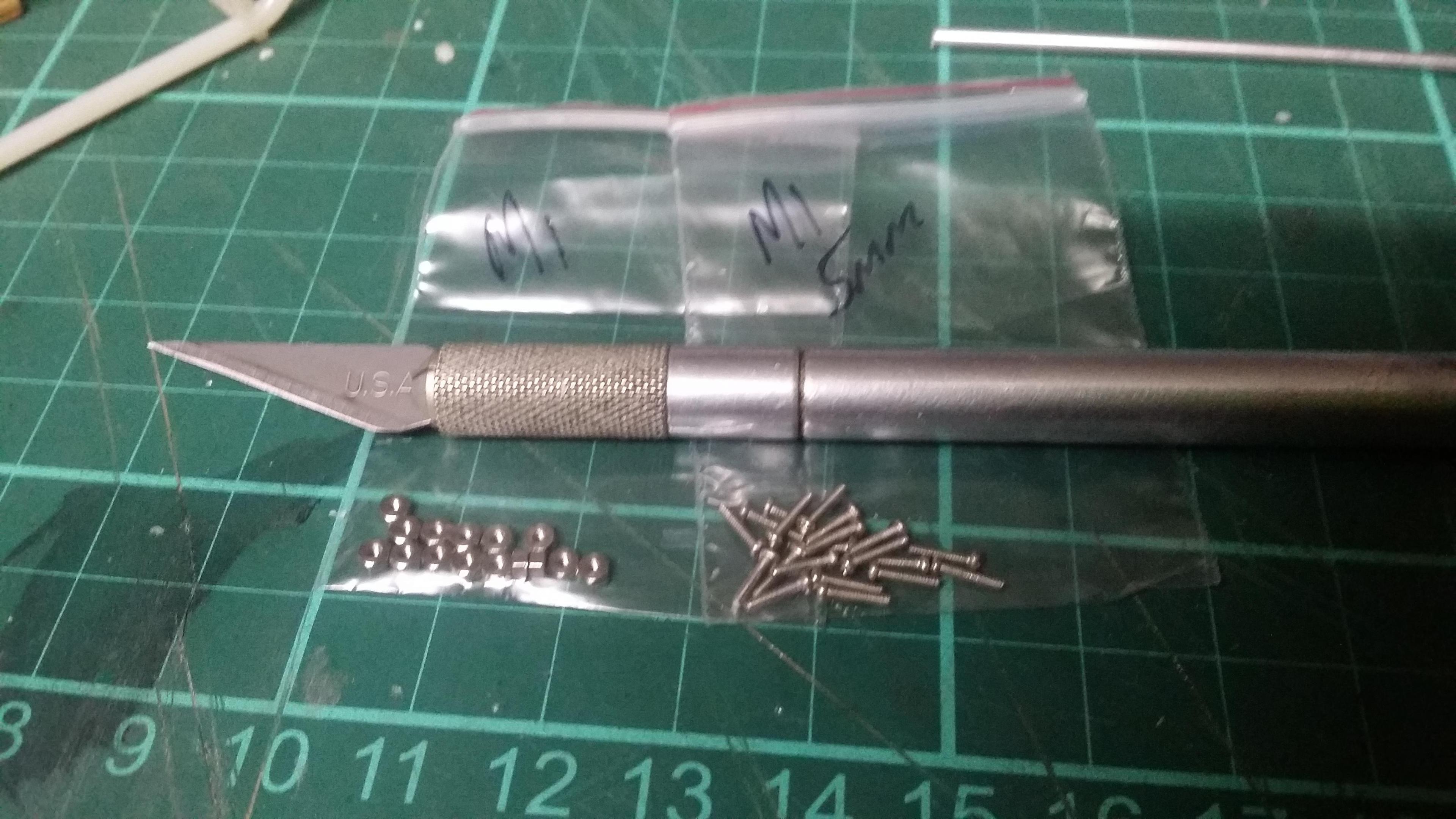

Got wheel studs and nuts done for the rear, the size is metric M1 x 5mm. I just drilled the brake hats using the wheel as a guide.

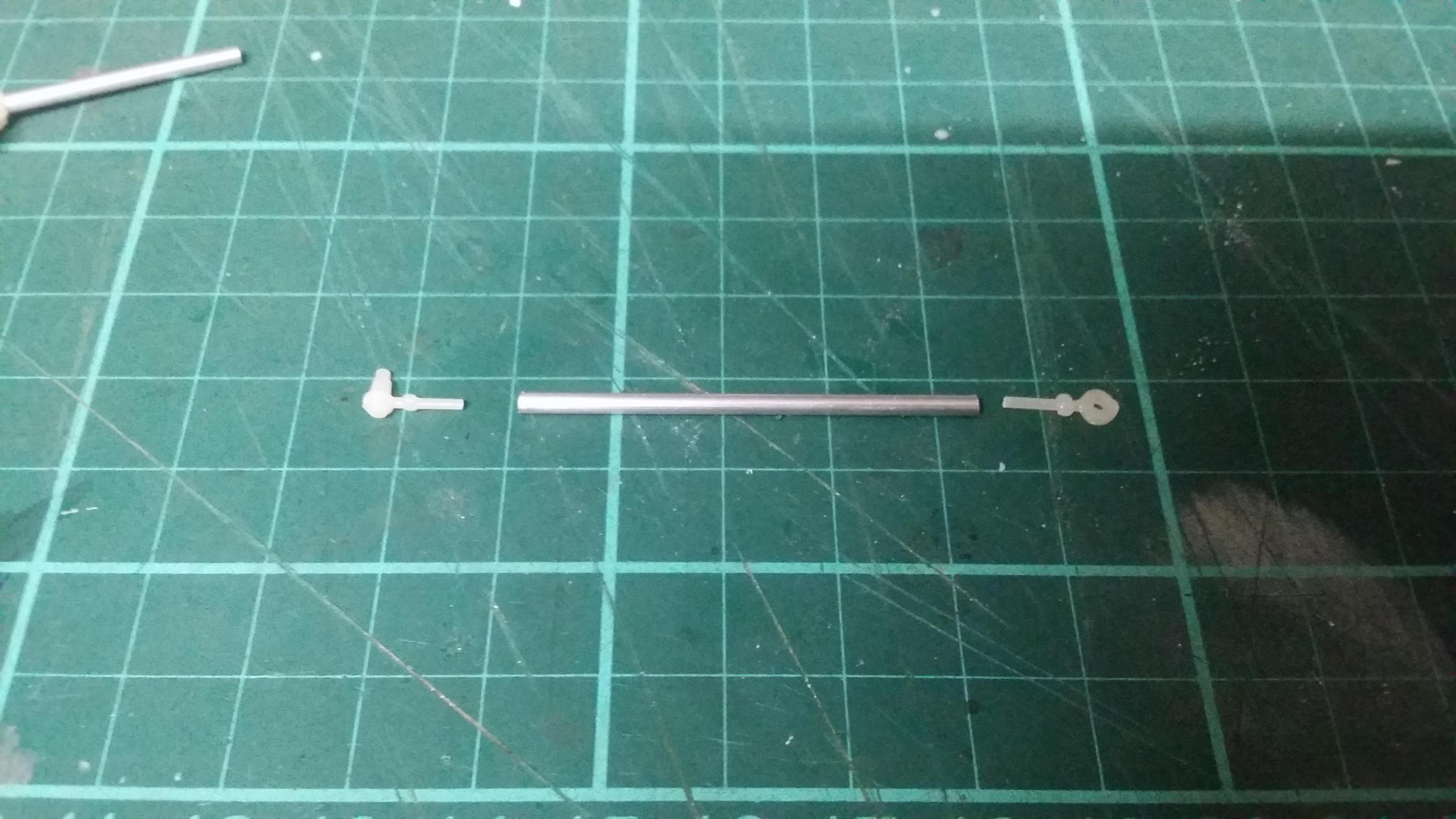

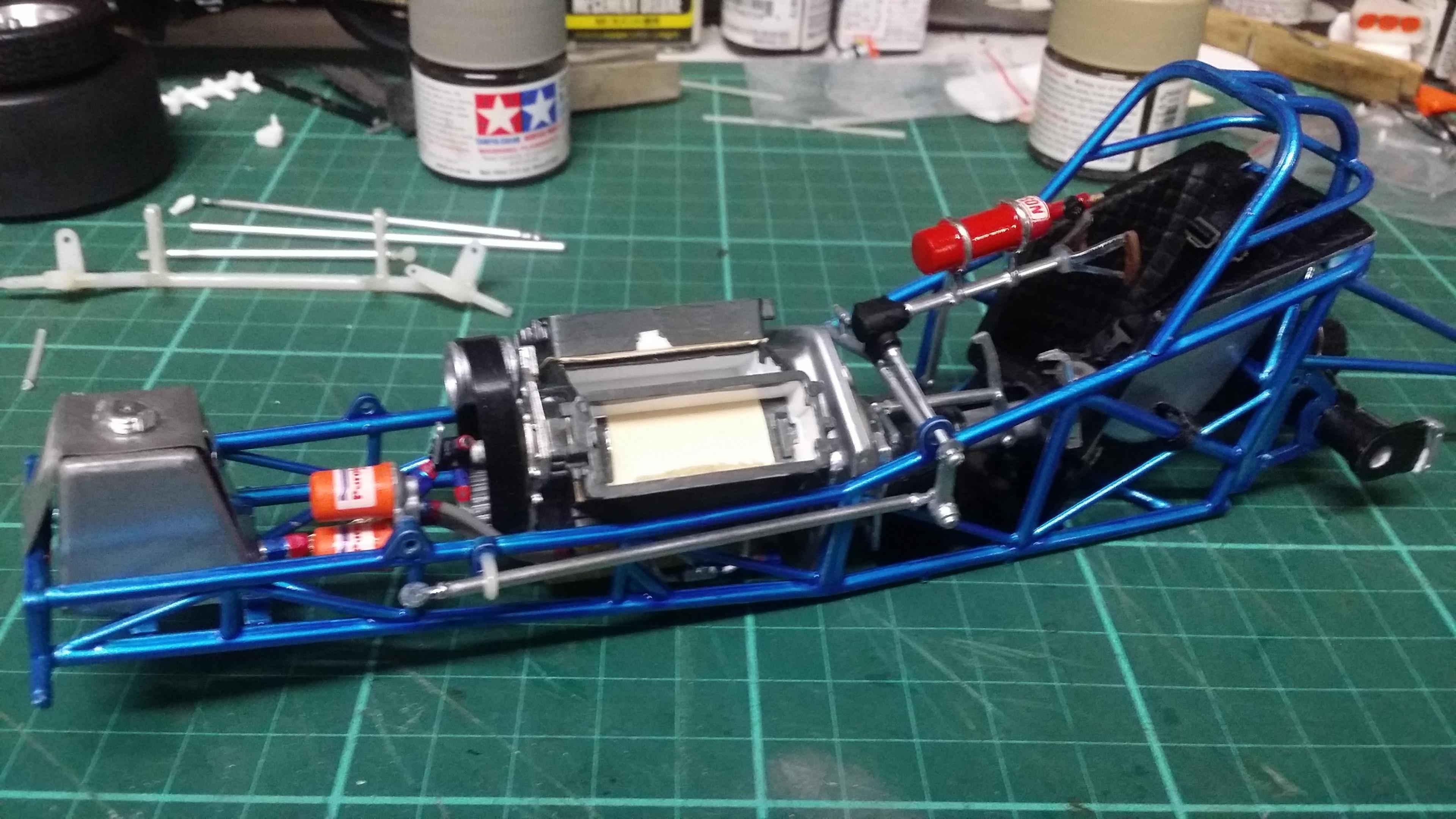

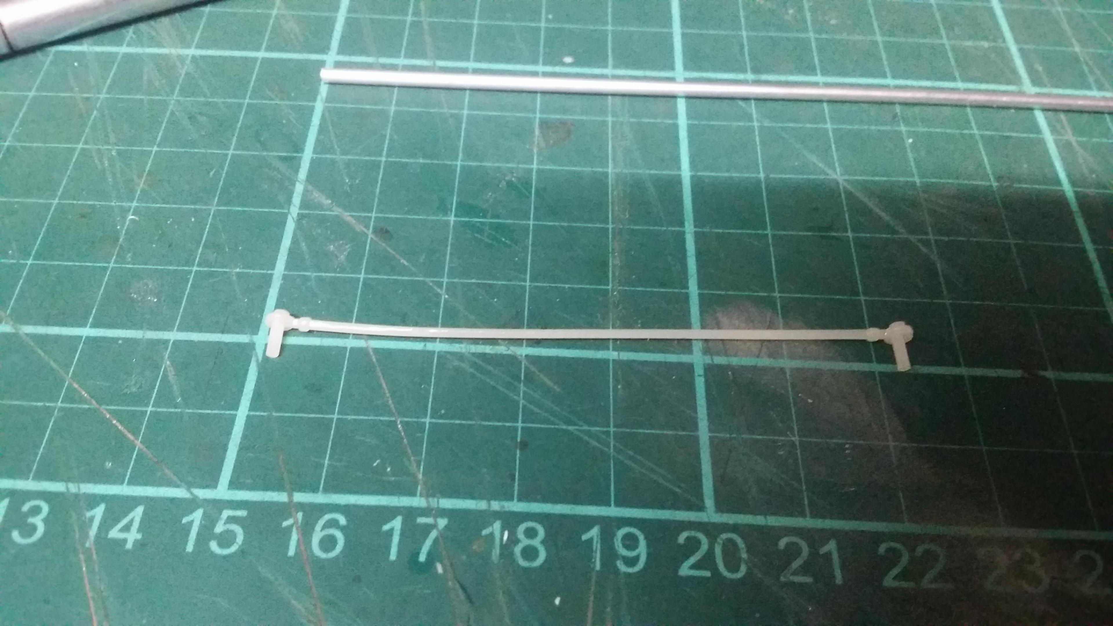

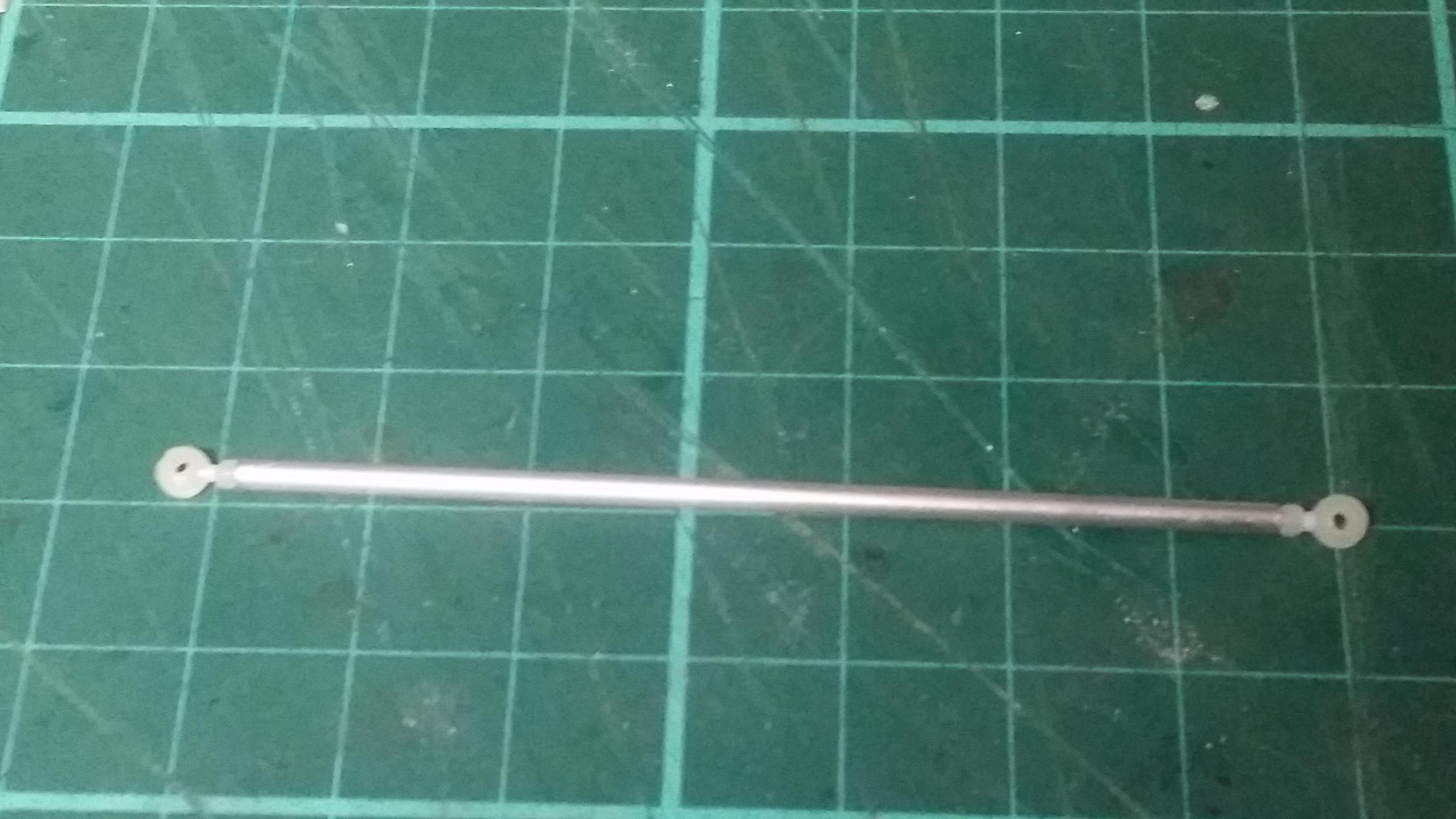

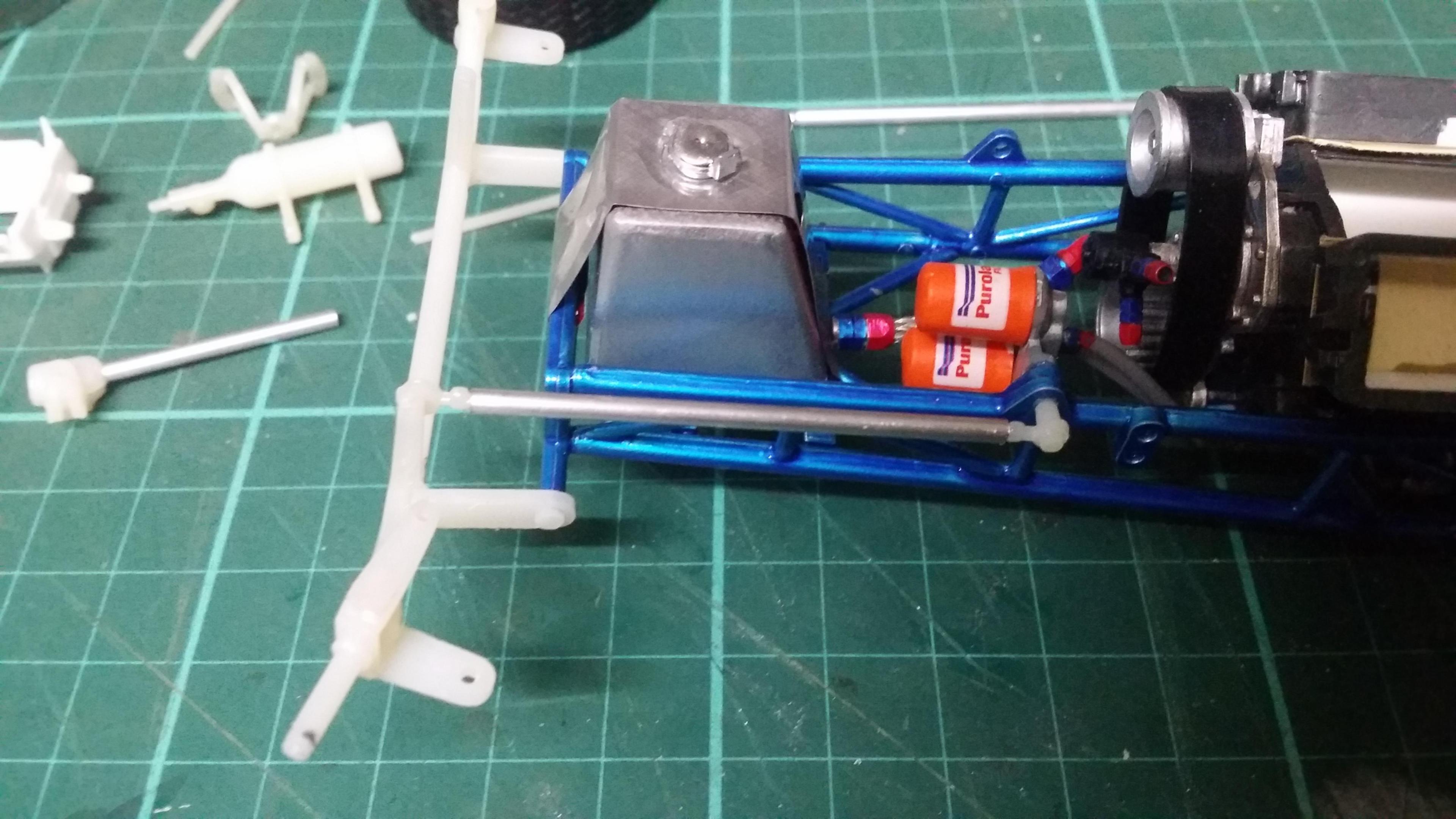

Got a start on steering arms and radius rods. I measured the kit arms by mistake ( they don't fit this model and found out the hard way) so instead trial fitted each to see how far different to make them. Then cut the kit arms leaving a little of the original arm and joint. After this I cut .080" aluminium tube the the length needed and glued the joints in the tube. I think they look much better. Then trial fitted before painting the ends. I also drilled the ends to use nuts and screws. Metric M1 again. The pictures are of different arms at different stages so I hope it makes sense.
A length of the .080" tube replaced the steering box shaft as well.

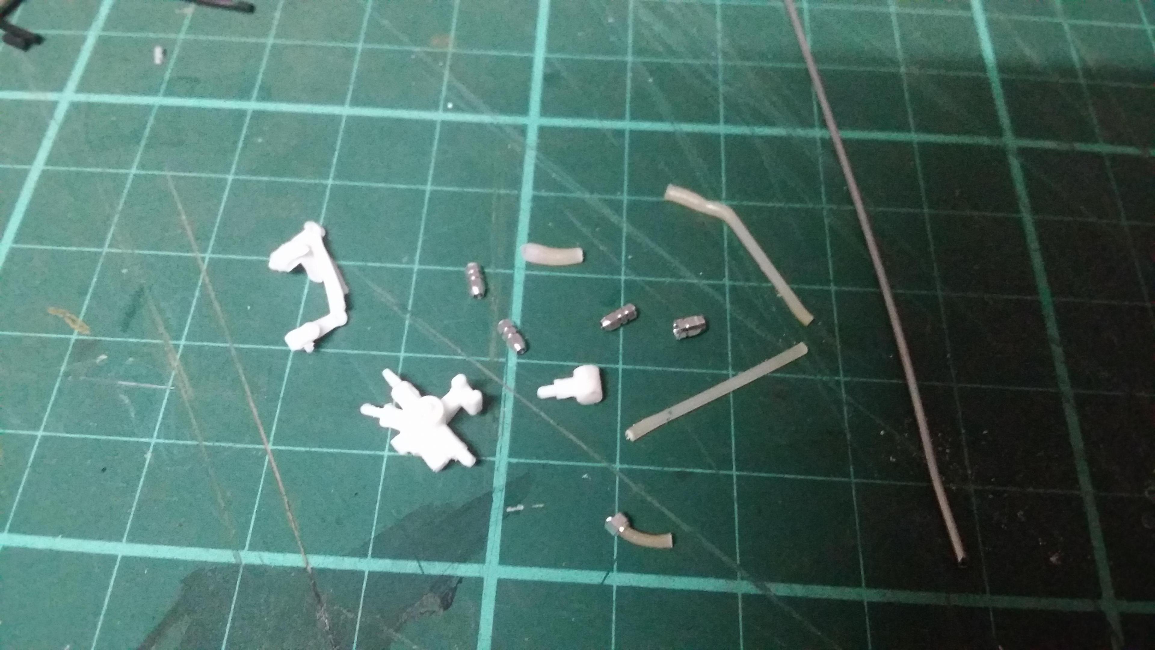

Nothing revolutionary in this update, just painting little plastic parts and sticking them on.

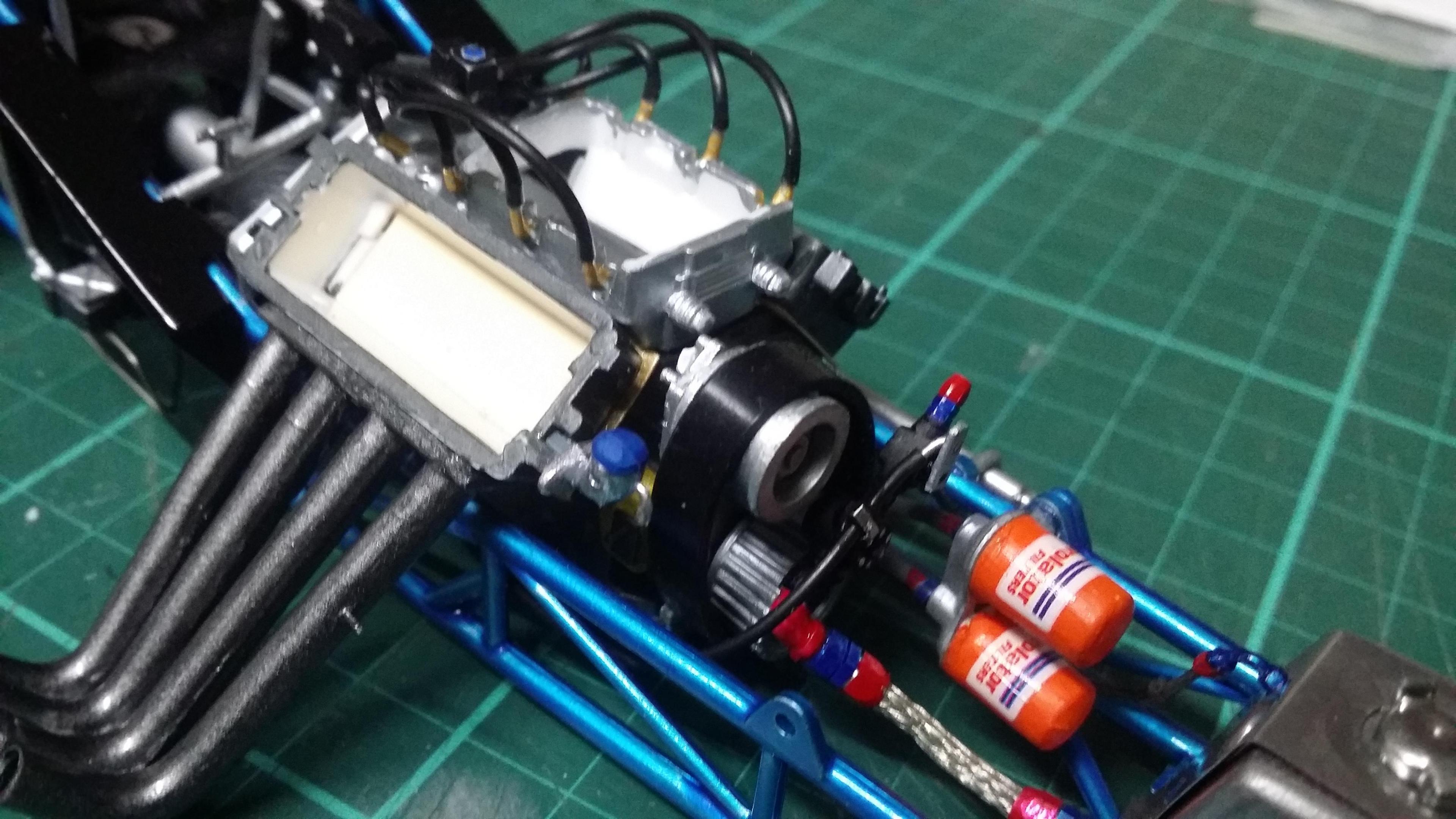

Made a chute release handle and started the fuel shut off lever then run cables for both.

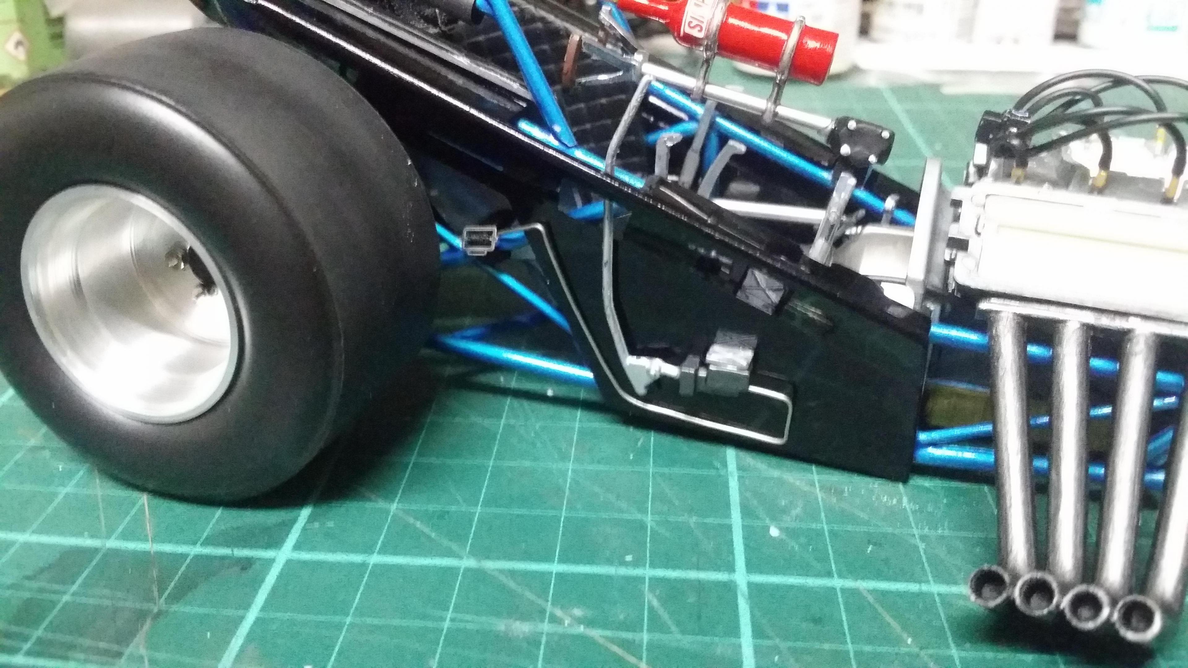

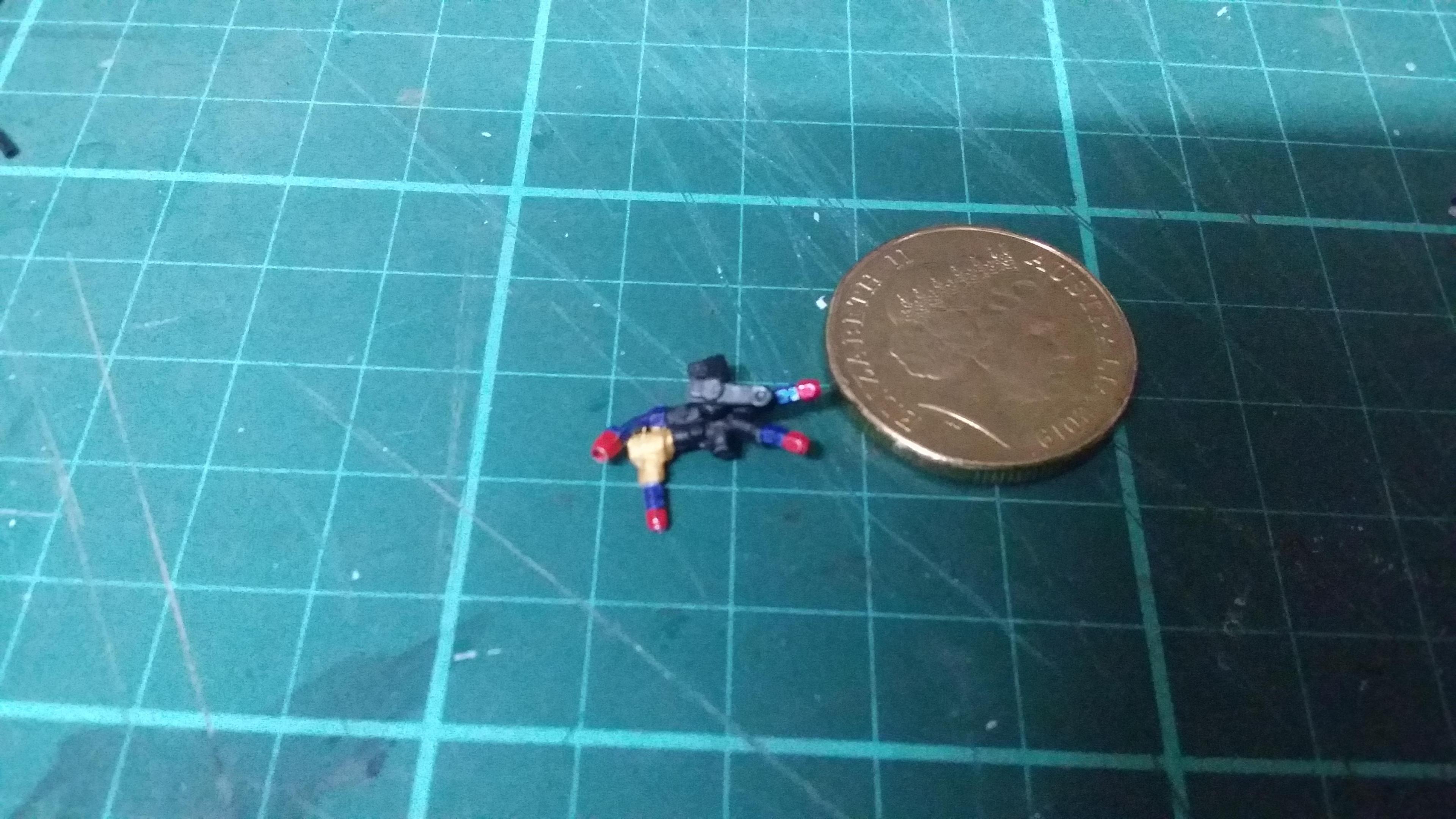

Refined the barrel valve, ran cables for fuel shut off and parachute. Mounted the brake cylinder and ran a steel line from .020" wire. Ran port nozzle hoses and port distribution block. Just used the kit black hose which does look a touch large but I'm not redoing anything on this one.

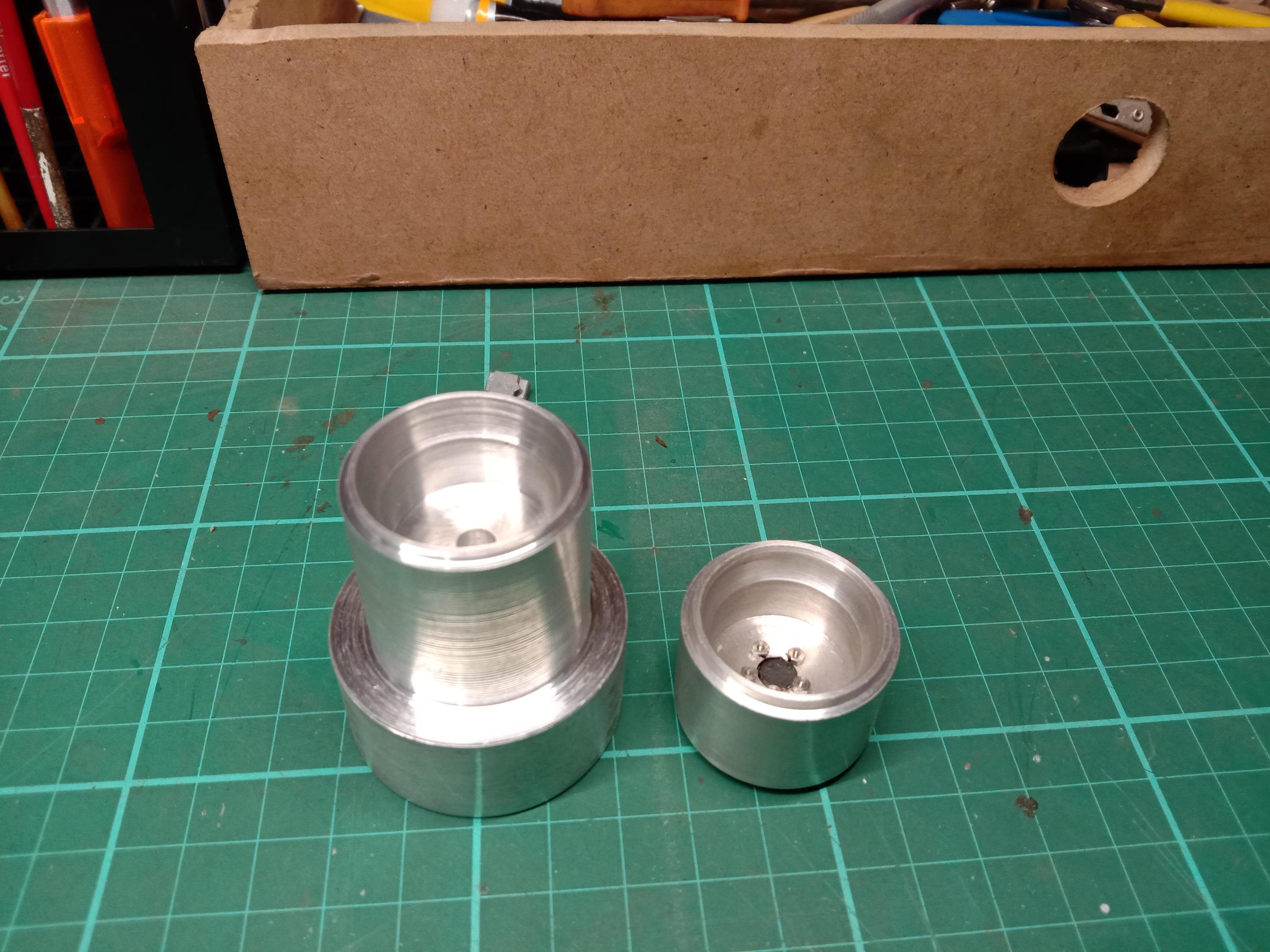

Hi all, it's been quite a while since I sat down with this one, I dug it out last night and I'm chasing up some lathe time to finish the wheels off. Since I started the build I sold my lathe due to massive downsizing and moving lots. However I have access to machinery again now which is nice, I can go further with it. The pic below shows where I got up to a few years ago.
