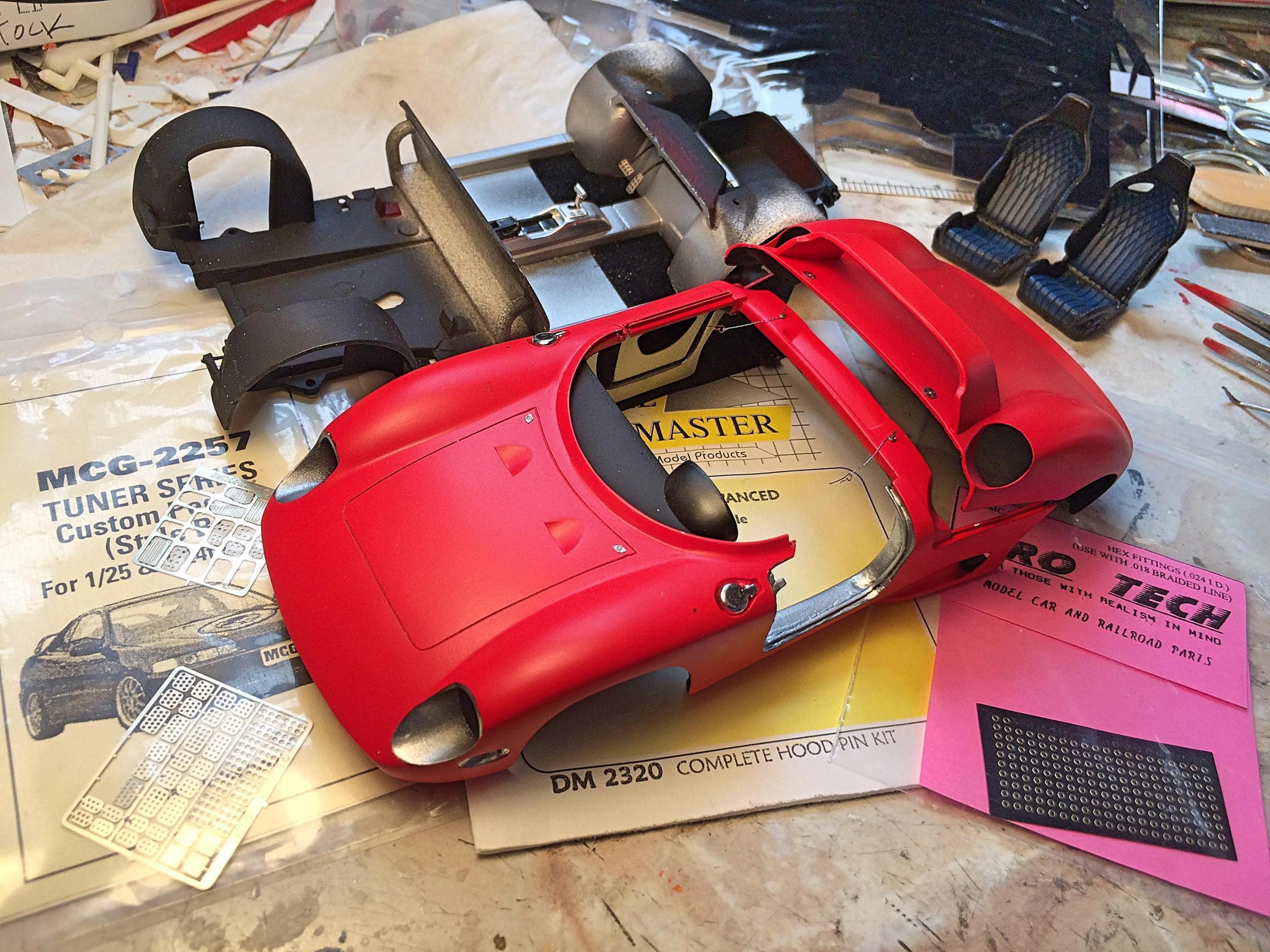

89AKurt Posted April 19, 2020 Posted April 19, 2020 Just because I'm a glutton for punishment, I like the Detail Master set. But it is a pain to get the disk to stay glued on when you play with it.
Exotics_Builder Posted April 19, 2020 Posted April 19, 2020 This is the Crazy Modeler set. but the KA and Aber sets are similar. The one I circled could be an option to not drill in. You could flatten the through tab enough to or trim it to get it to lay flat.
