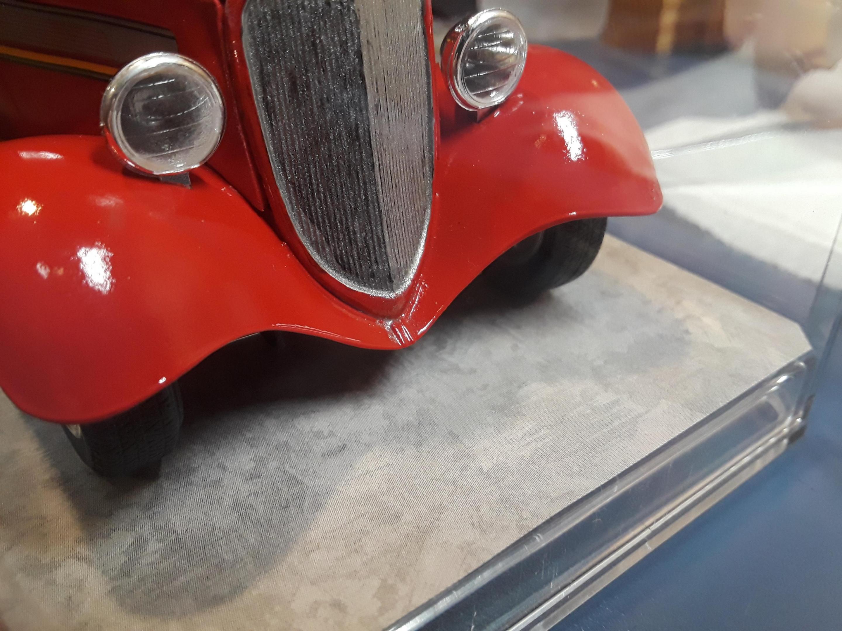

Hotrod 97 Posted April 22, 2020 Posted April 22, 2020 I know that Molotow Chrome Pen and clear coat are not quite the best of friends, but I though that clear coat just dulled the chrome. I just discovered that the Molotow chrome on the grille of my ZZ Top Eliminator ran a bit. I'm assuming that the clear coat is to blame. I used a few mist coats of Testors Enamel Clear Coat for the Eliminator. Anyone else have this issue?
peteski Posted April 22, 2020 Posted April 22, 2020 As I understand Molotow is alcohol based, so I'm not surprised that it gets dulled or even runs when coated with solvent-based clear coat. I would never dream of doing that. Water-based acrylic clear (or Future) would probably not affect it much. Just use Bare Metal Foil my friend! It will never run under any clear coat.
Hotrod 97 Posted April 22, 2020 Author Posted April 22, 2020 Ohhh, that makes sense ? I did not know that it was alcohol based. Yeah, the Eliminator was built in my pre-BMF days... Thank you for the info.
Tom Geiger Posted April 24, 2020 Posted April 24, 2020 I had that problem with black Sharpie that was used to darken panel lines.
SfanGoch Posted April 26, 2020 Posted April 26, 2020 Molotow is an ink, not a paint, therefore, most clear coats will dissolve and/or reduce its chrome appearance. I, along with a couple other members here, recommended Alsa Corp's Easy Chrome. Short of tediously mounting parts on racks to send out to a chroming service, Easy Chrome is the best product available. It doesn't need it because it it is 10000% more durable than Molotow, Alclad or any other chrome finish; but, it doesn't dull or lose its reflectivity if clear coated. Sure, it's pricey. It still works out to be less expensive than sending parts to get re-chromed or the anguish created when you watch Molotow Chrome turn into a nasty mess.
Oldtmr Posted August 13, 2020 Posted August 13, 2020 Alclad 11 Chrome and Polished Aluminum are also alcohol based. They recommend using their Aqua Gloss Clear over those as a sealer before any topcoat. That may work for the Molotow pen as well.
