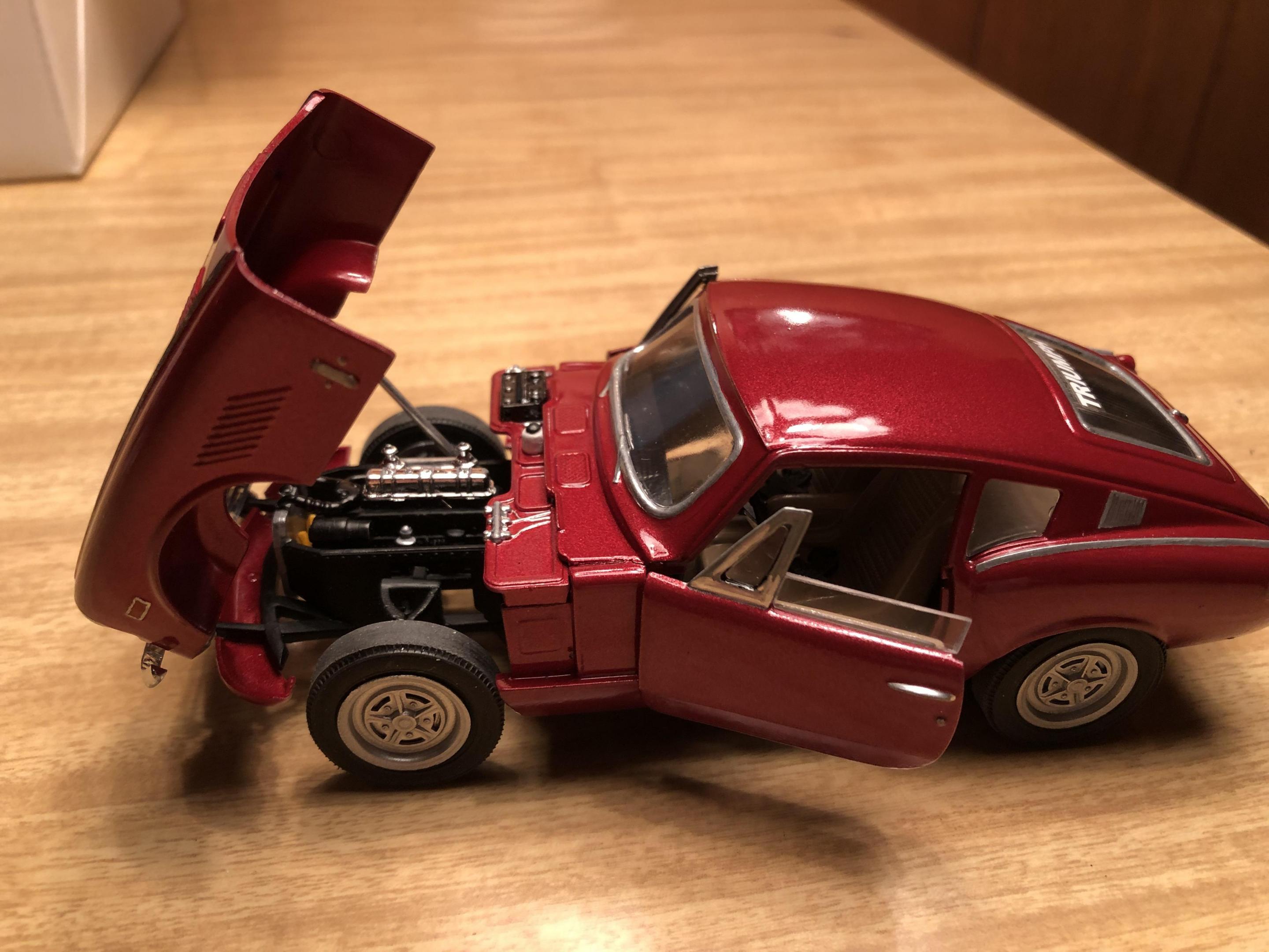

Safire6 Posted May 12, 2020 Posted May 12, 2020 All I've ever done in regards to modeling is to build them. I have never had to take them apart. I want to remove the wheels that are on this GT6+ that I built 2 years ago and replace them with something more period correct. The rear wheels pulled off pretty easy (apparently I did not use much glue on them.) However the fronts are a different story. Testors tube glue was used. What do you guys use to "melt" glue? TIA

Safire6 Posted May 15, 2020 Author Posted May 15, 2020 Hi unclescott, I haven't tried to get the wheels off yet but I think I'm going to try thats4u's suggestion first. It is a Lindberg 1:25 scale kit. I'll let you all know how things go with the wheels when I get them off.

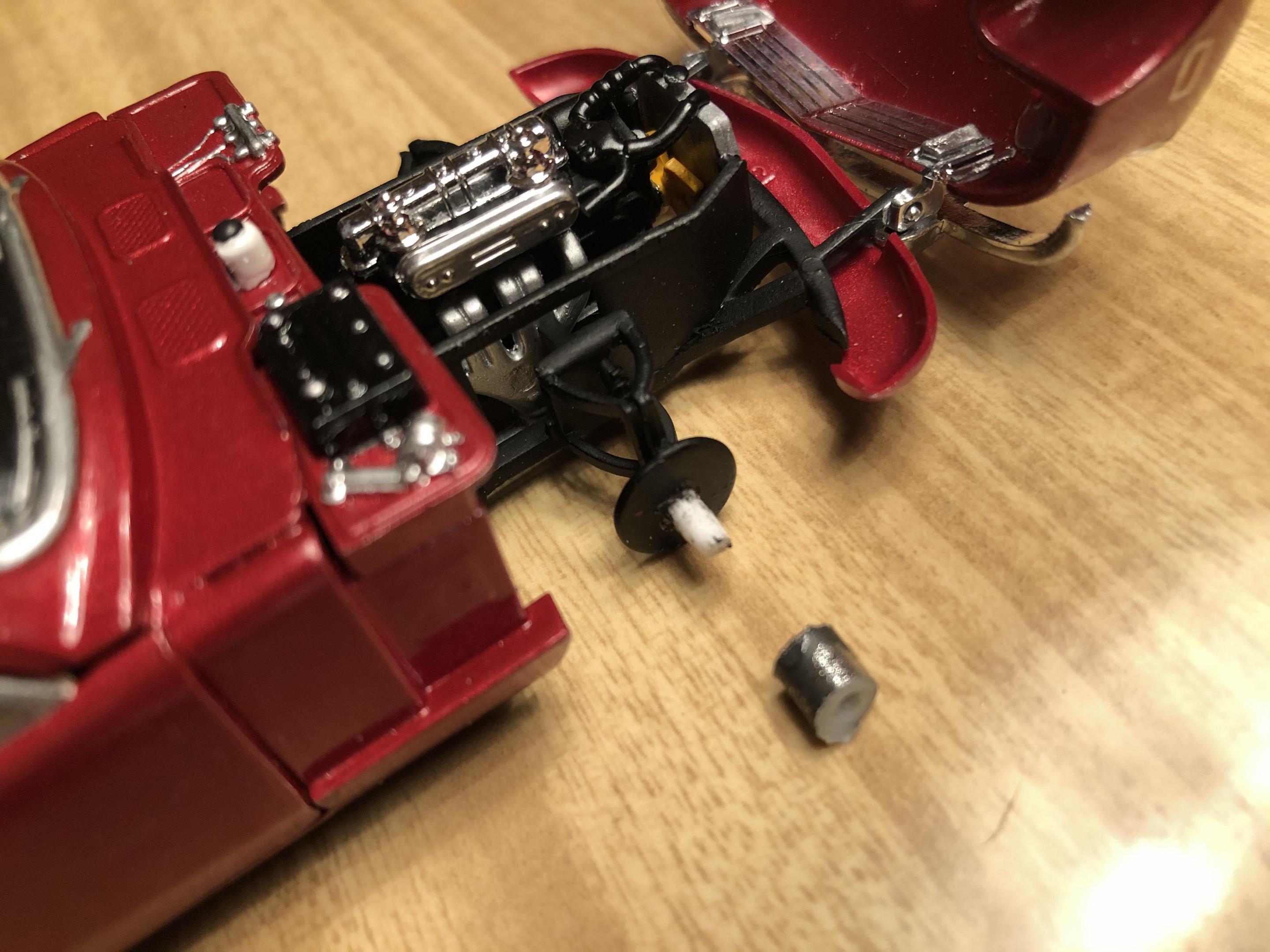

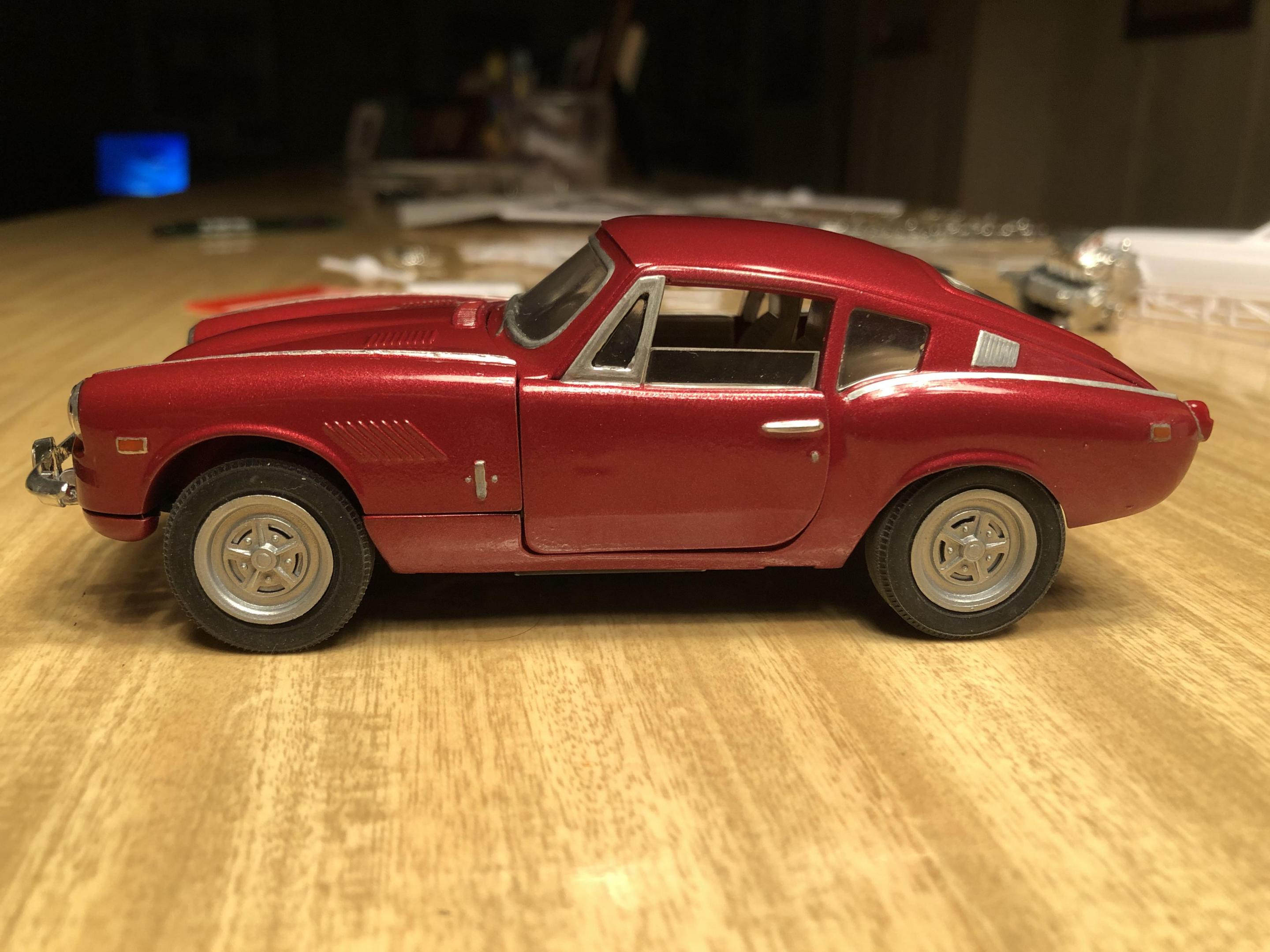

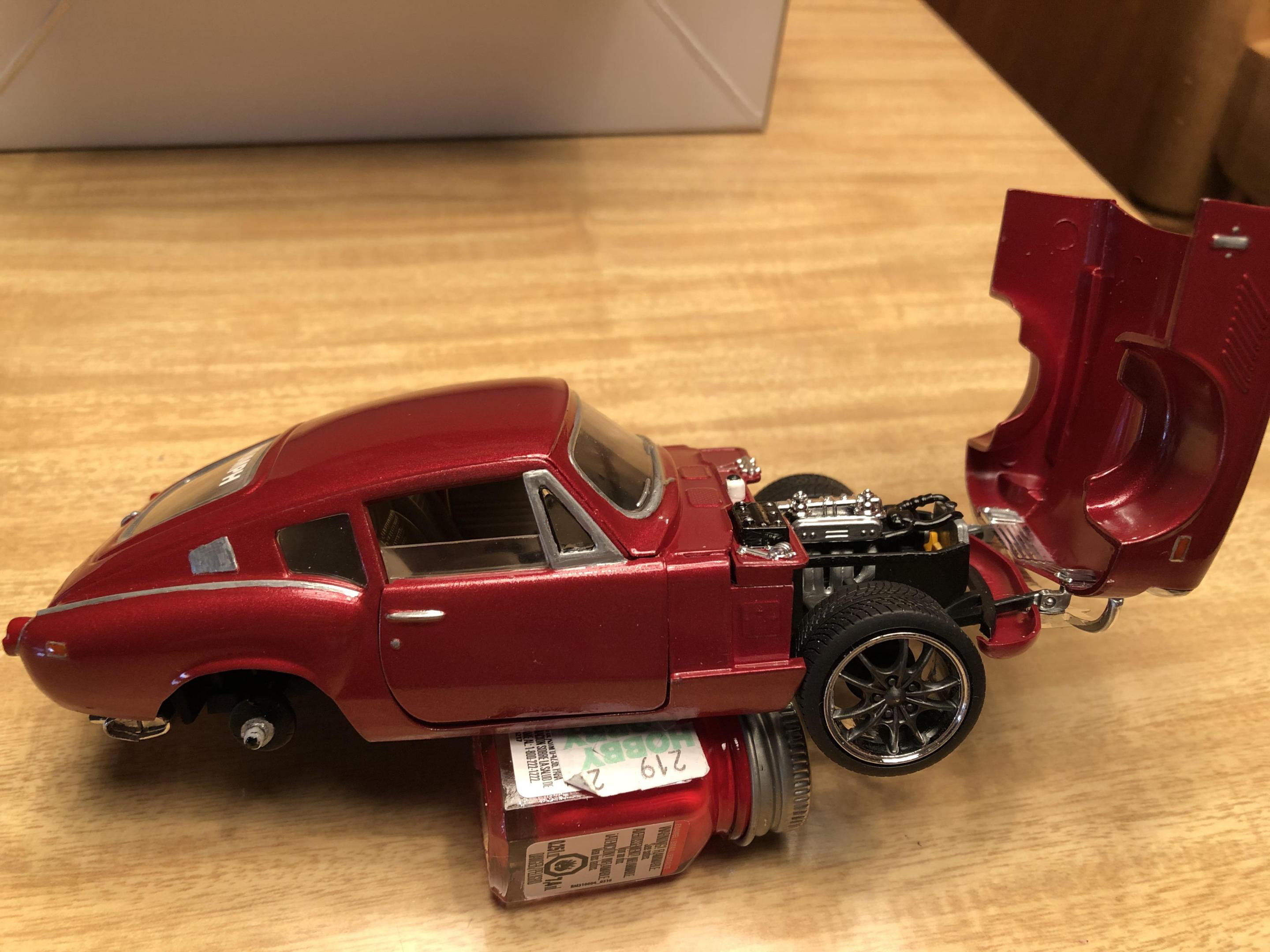

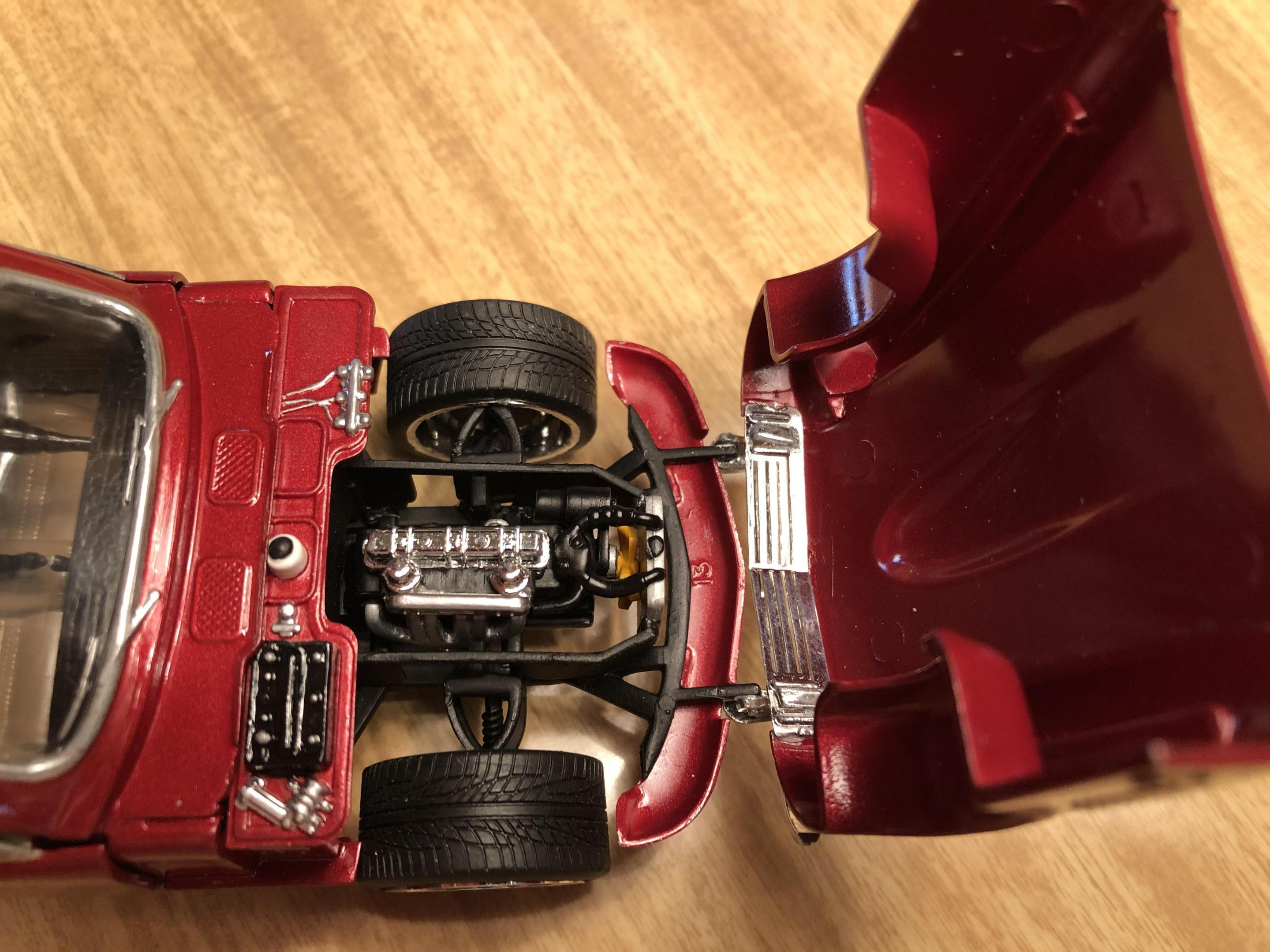

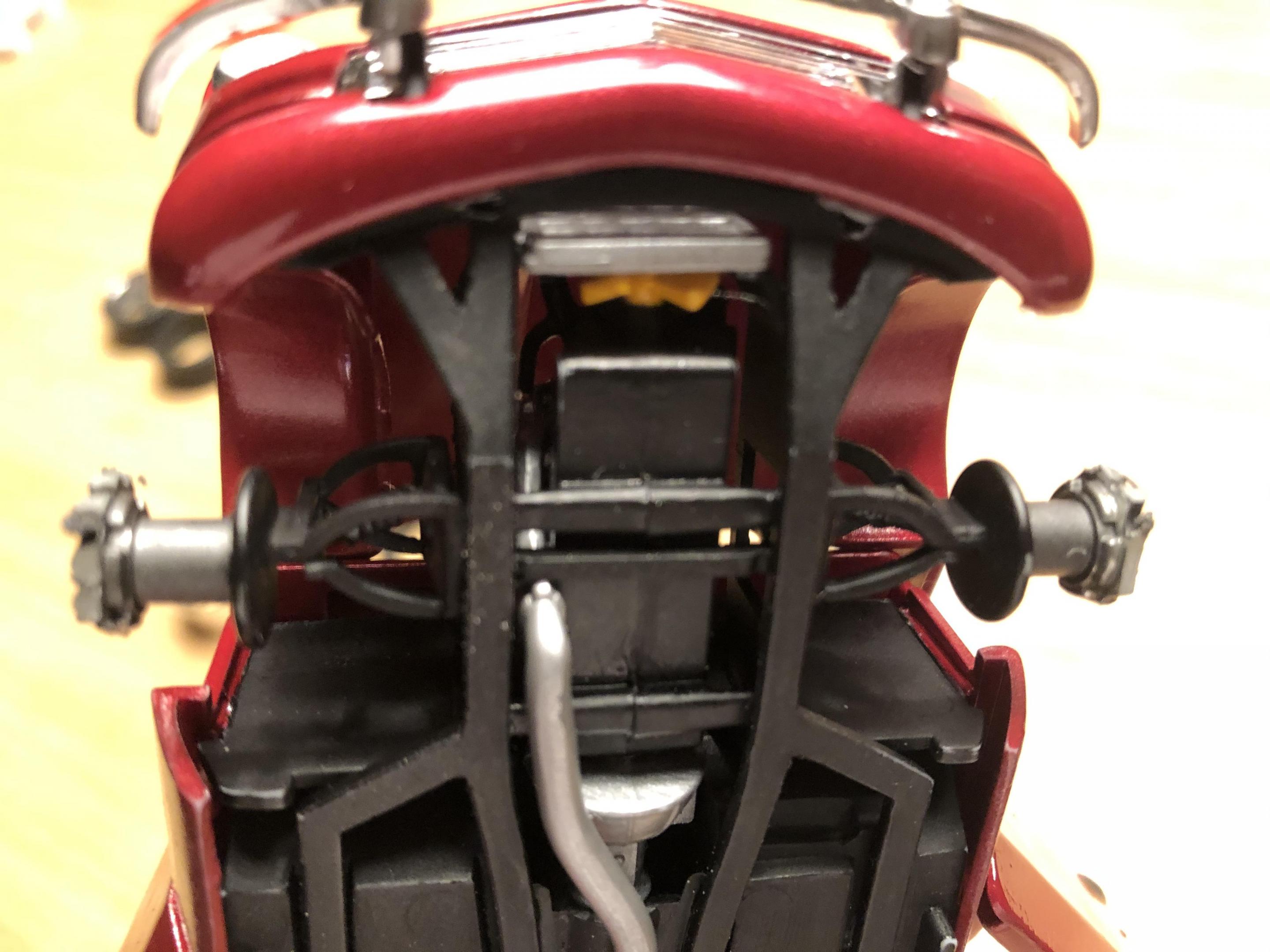

Safire6 Posted May 21, 2020 Author Posted May 21, 2020 So here is what I did to get the wheels off. I cut through the spokes with a small Dremel tool cutoff wheel, leaving just the hubs. Then I cut through end of the hub with the Dremel leaving just a short length of hub. I carefully applied liberal amounts of paint thinner to the glue joint with a small brush and let it sit for a minute. Then I slowly rotated the hub until it started to move a little and kept applying paint thinner until the hub came off. The kit wheels and tire were attached. (No tread at all on the tires.) Now it looks more like a proper British sports car!
